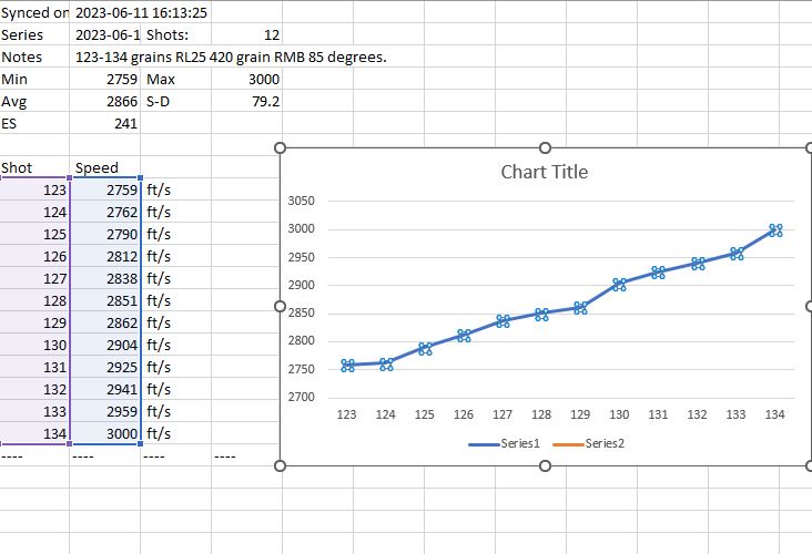

I did a pressure test with RL25 with 420 grain Parker Productions (Formerly known as RMB) this weekend. I loaded them .025 off the lands
At 134 grains I saw pressure signs start to show on the brass. No heavy bolt lift.
From what I have observed with Retumbo and these bullets they seem to like the 2850 range. So I will test the 128-129 grain charge next time I get to the range.

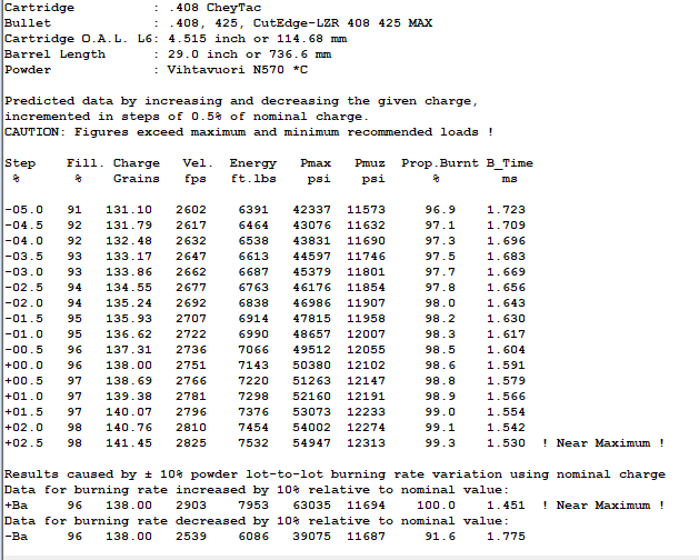

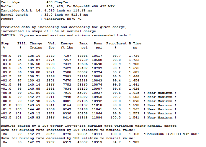

Here's a back of the envelope calculation from QL
Provided the CEB Lasers get to me on time I’m planning on doing a pressure/Satterly test starting at 134 grains of N570 and working up in .5 grain increments with the bullet seated .025 off the lands. I’m thinking I’ll find my node at the 2830-2860 mark. My plan sound reasonable? Any advice or recommendations you have would be appreciated.

Yeah, based on what I'm seeing in QL with a COAL of 4.515". You're above 95% case fill and still under 53000psi. Of course that's using some assumptions and actual load data would be better, but.....408CT ;)
What do the numbers look like with a COAL of 4.590? That’s my COAL at .025” off the lands.
STOP! DON’T LOAD ANY FURTHER! That COAL is going to make it EXPLODE!
Actually it’s not going to make much of a difference on the low end
I’m starting at 135 grains with that COAL. Think that will be ok?

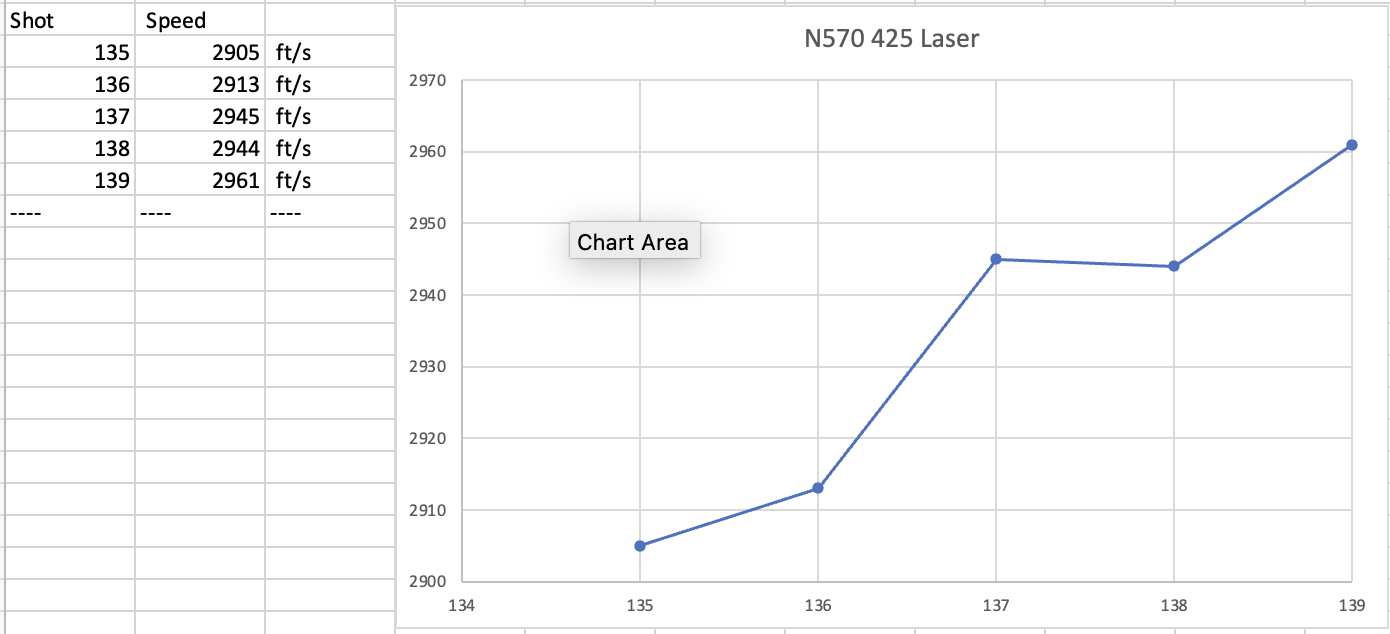

Started at 135 grains of N570 and stopped at 139. No heavy bolt lift but some marking on the brass.
Looks like a potential node to start working at 137-138 grains of N570. Maybe I should try another test from 132-136 and see if there is anything in the 2800 range?
Retumbo seems to have a possible load in the 130-131 range it seems.

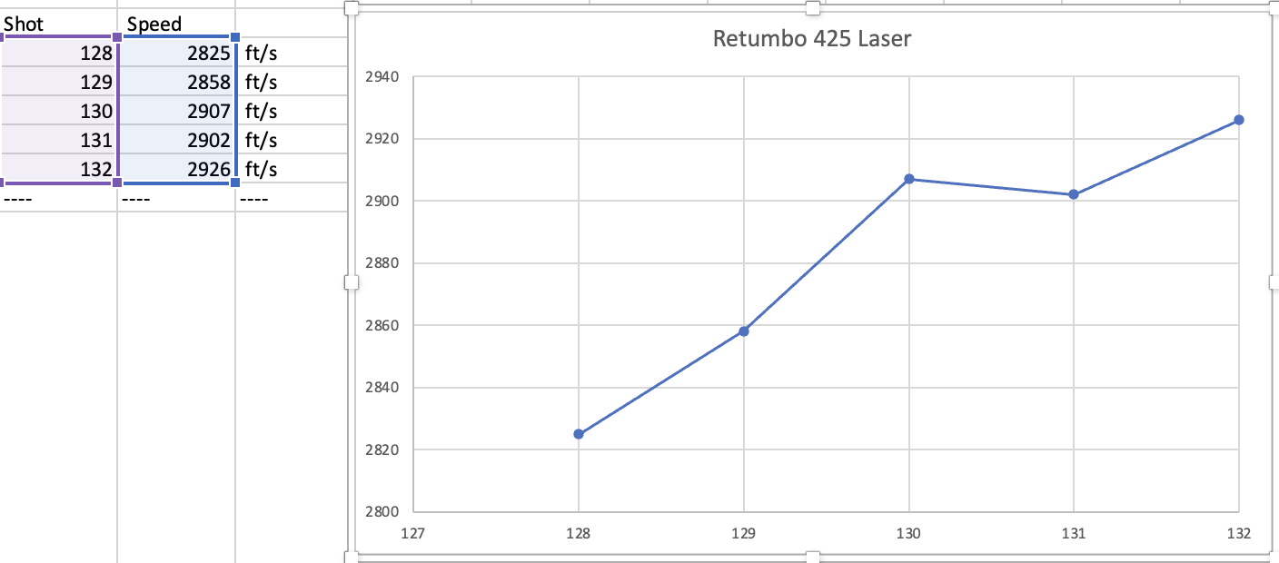

If those are single shots, you’re not looking at a node. You could run the same test five times and get different curves.
But if you’re seeing pressure marks on brass, then just avoid anything at and above that charge weight. If you like the velocity in a certain range, then start testing with 3-5 shot strings in 0.5-1.0 grain increments within that window. Don’t worry about groups so much, but note any obvious standouts (good and bad), and just look for consistent velocity.

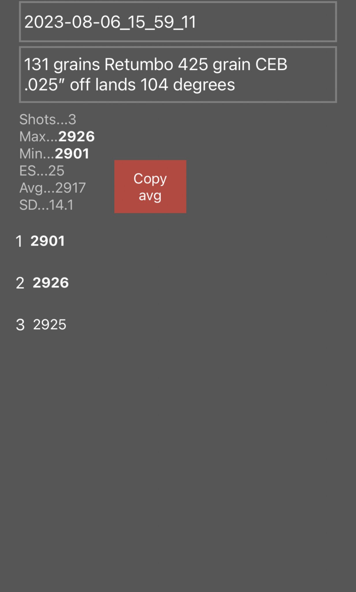

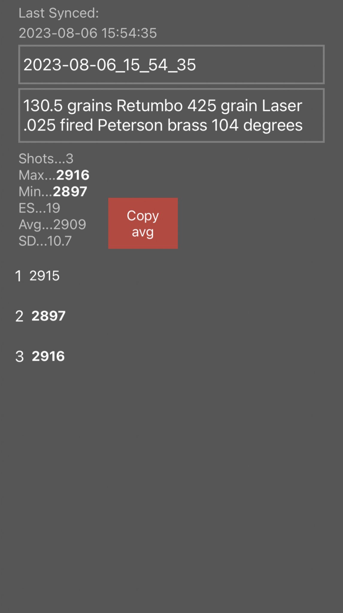

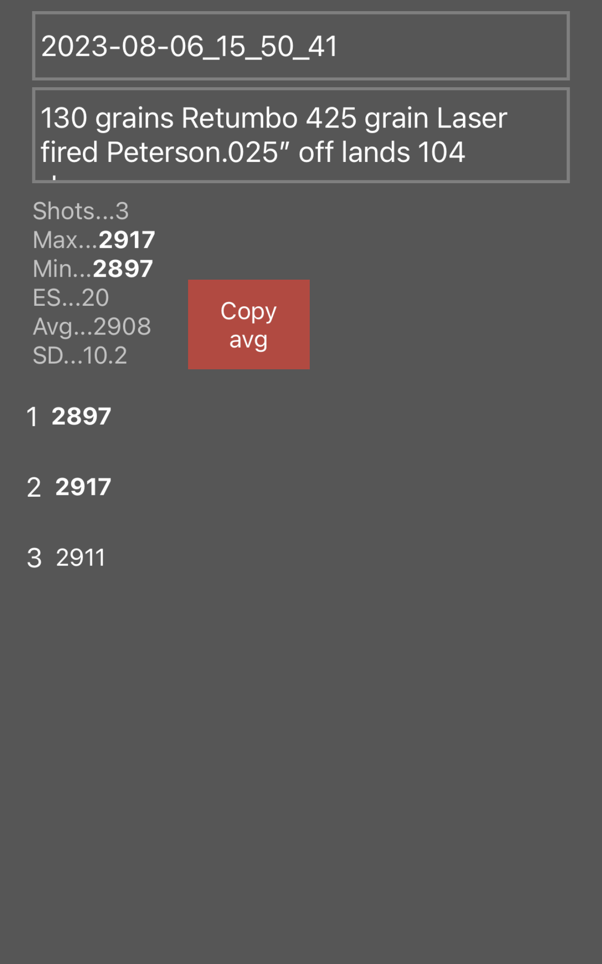

With 130 grains of Retumbo I get 2907, with 131 grains I get 2902. So I’ll test a group if 3 at 130, 3 at 130.5, and 3 at 131.

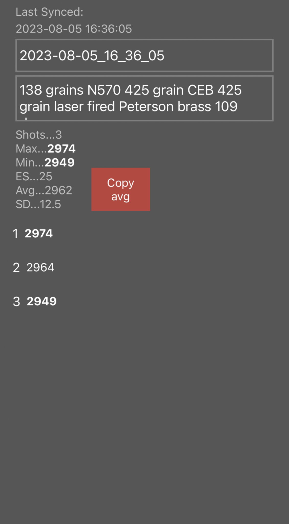

For N570 137 gets me 2945 and 138 gets me. 2944. So 3 at 137, 3 at 137.5, and 3 at 138.
Could that work or am I missing something?

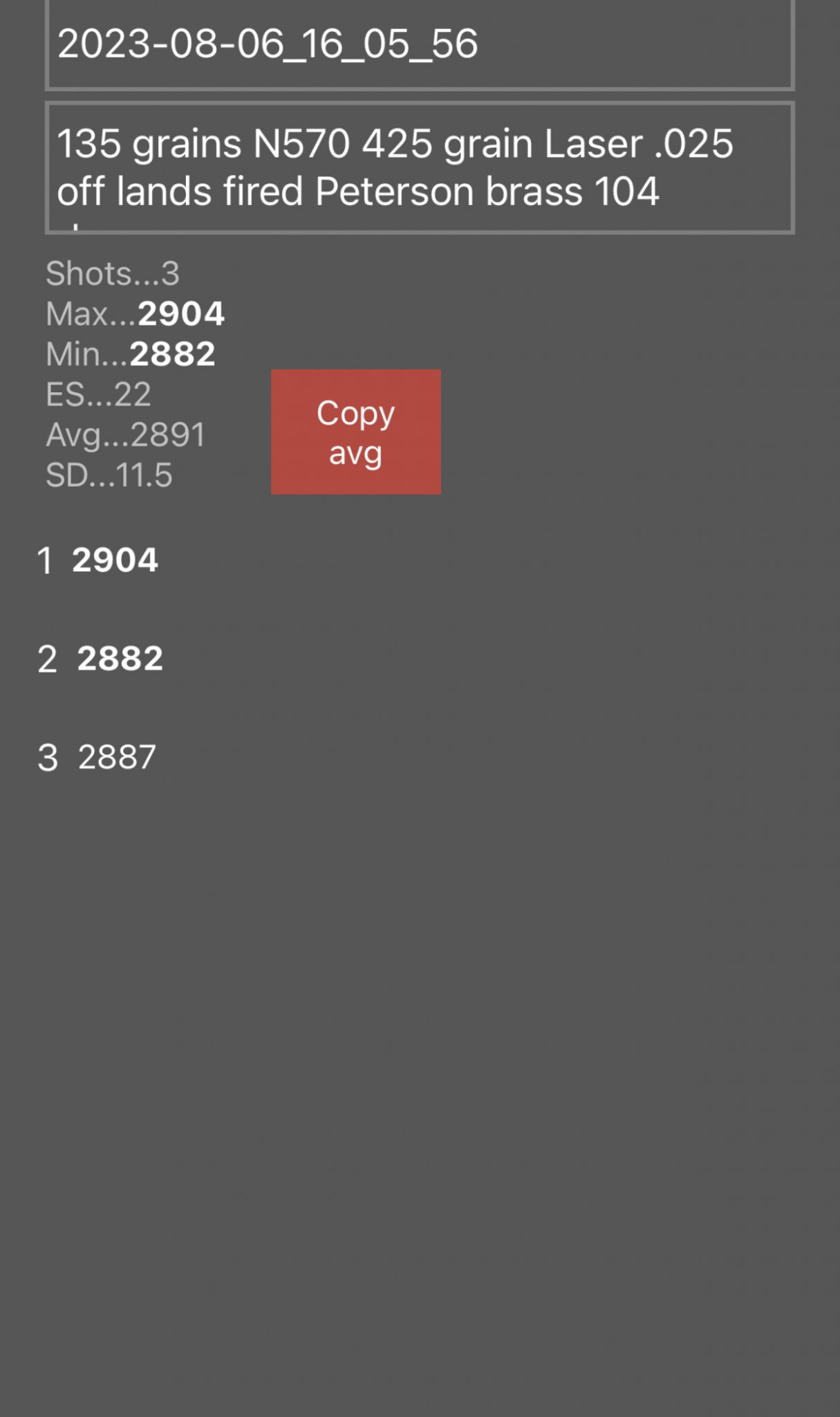

Looks like my gun does not like N570 & 425 grain CEB lasers at speeds over 2900

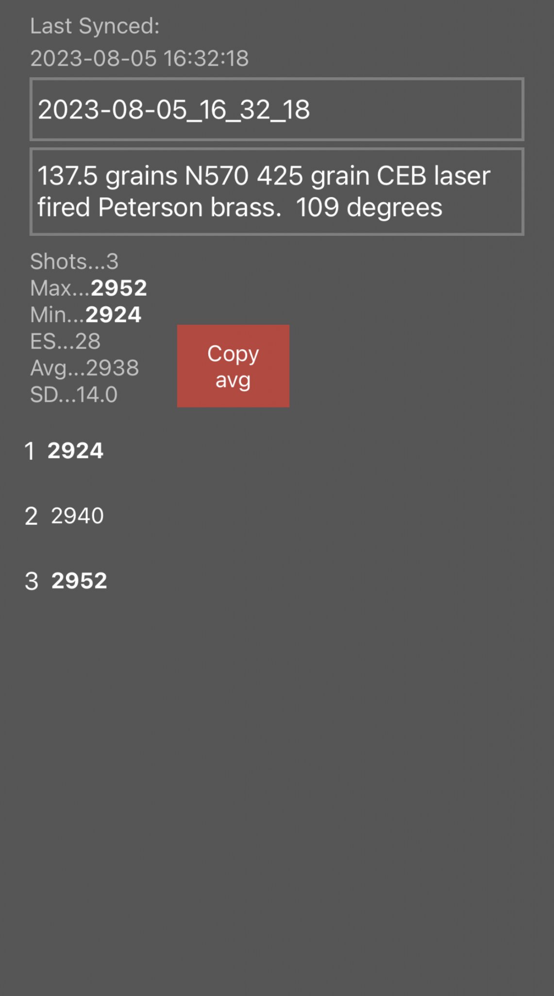

So @Dogtown odd thing happened when I was testing Retumbo & N570. I would have two shots that would be really close to each other, velocity wise and then one that would be waaay off.
Looks pretty normal to me - I see that kind of behavior often in 3-shot groups during load development.

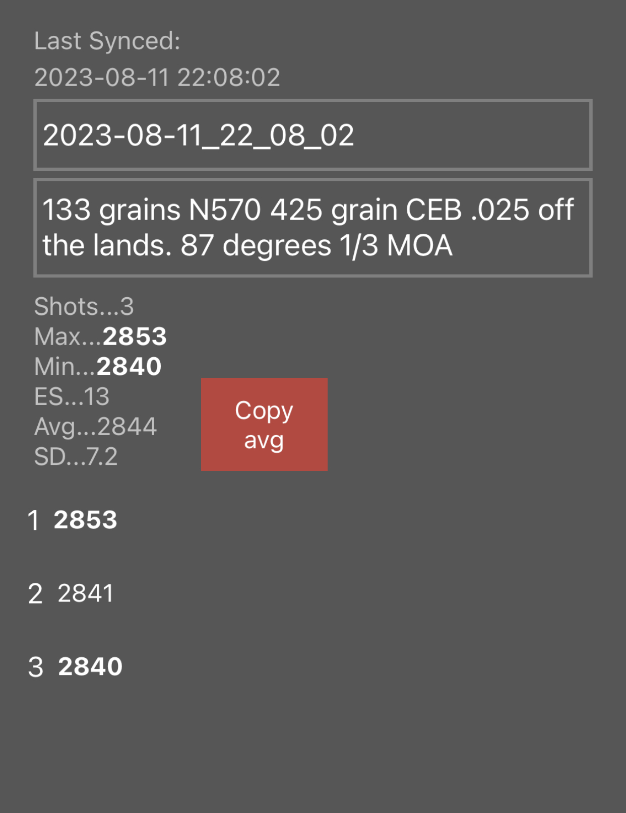

Everything grouped less than an MOA but only one of them was about 1/2. Hopefully there is a velocity node at 2830-2850. So far it seems Retumbo is the superior powder.
Again, 3-shots is the absolute minimum for any kind of statistical analysis (you can create a line from two points, but you need three to create a curve from linear data). You might just try shooting a 5-shot group with that 1/2" group and see what the SD is like. It might be that you get four that are very close, with one outlier. In that case, your SD will drop with a 5-shot group vs the 3-shot group you got.
Use 3-shot groups to get a ballpark idea about stuff (charge weight, seating depth, etc). Use 5 or more shots to do the actual analysis. I know it sucks with big-bore components, but that's the price of admission.

Looks like 133 grains of N570 is about the best I have to work with with that powder
I’m going to try seating them .005 off the lands next, maybe that will tighten that group up a bit more.

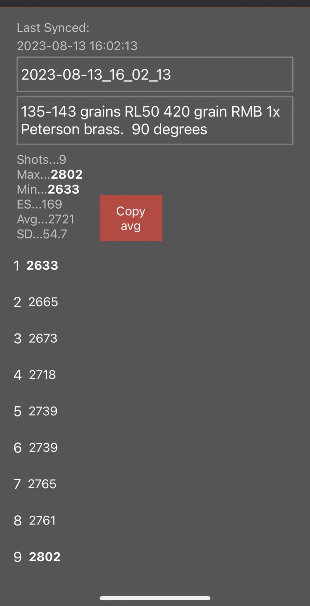

Tested RL50 135-143 grains. No pressure signs so I think I’ll try 144-150 next time to get to 2850

I took that 1/2” group and seated it .003” off the lands and it tightened up to about 1/4-1/3”. ES stayed about the same.

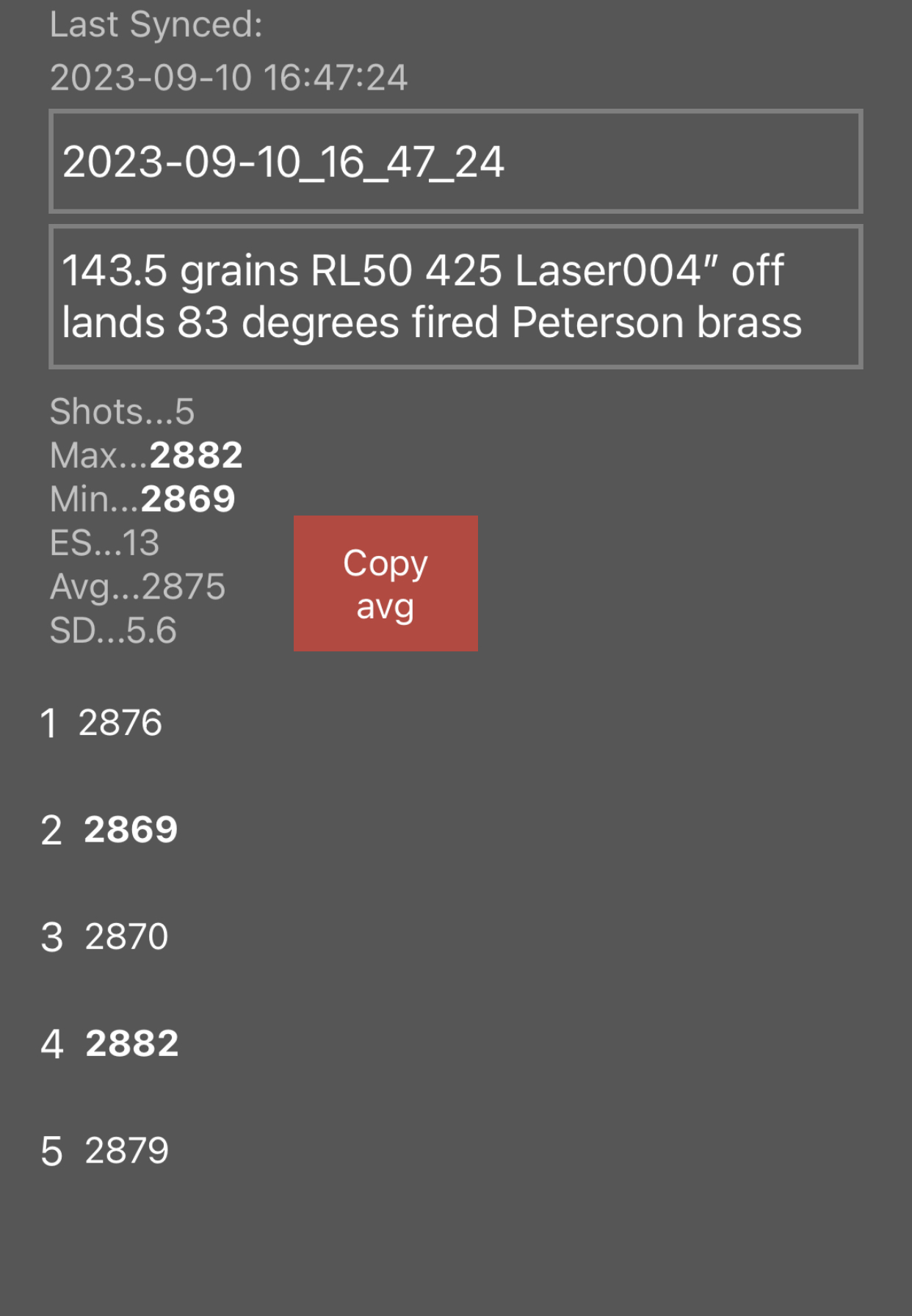

CEBs seem to do ok with 143.5 grains of RL50 behind a 425 grain CEB Laser .004” off the lands.
Problem is it grouped at only just under an inch. @Dogtown do you think seating them .025 might improve things or make it worse? Or would it be better to keep the same seating depth and drop the powder charge down .5-1 grain to get the bullet at that 2850 range all .408s seem to like?
