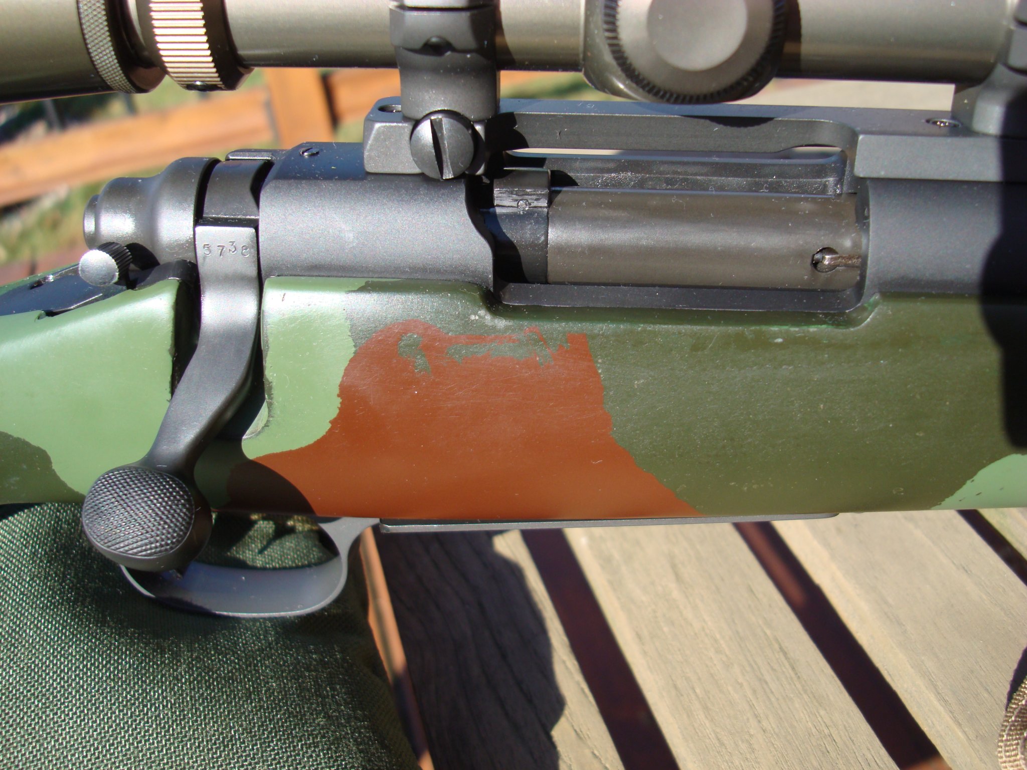

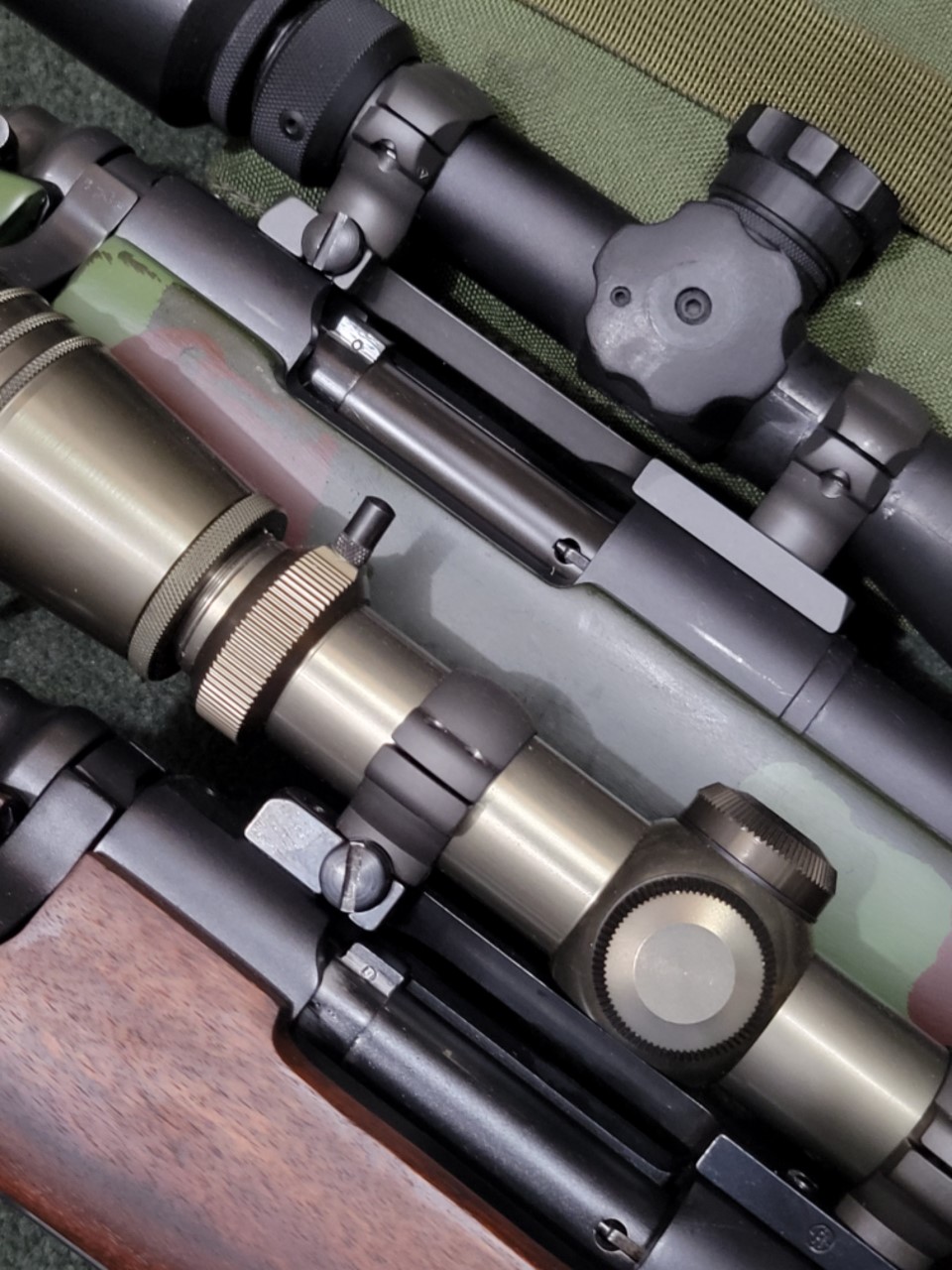

I had Bill Corley clip / lug slot a 40x rimfire for my M40A1 clone build... I have experienced no ill effects.
I also have a spec-built M40 / 40x . 22lr clone he did the machining on for me that shoots lights out.
I can post some pictures later when I'm at my computer if you would like.
