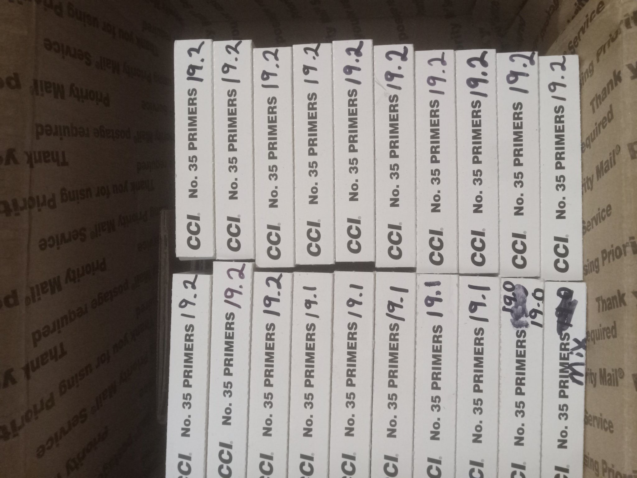

I sort all my primers into like weights and if you weigh your friends brass it might shock you as to the variation.

Edit: all the primers are good we just shoot them in like batches.
