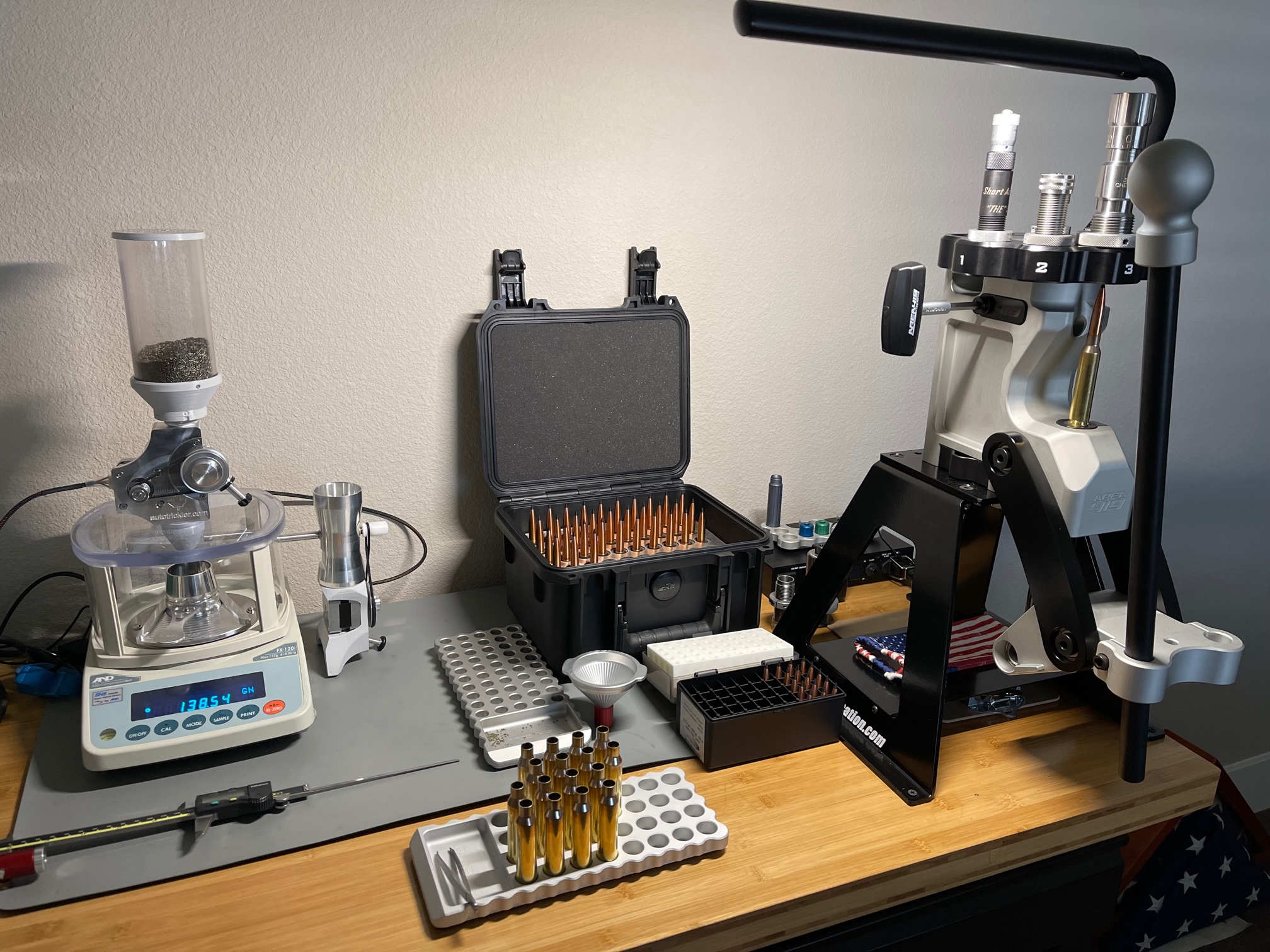

You guys are not going to be able to use zero press for 375 Cheytac.
Cheytac, case size dies are typically going to be one and a quarter or one and a half inch dies. As the poster above said, step up to a larger press. (It is a great excuse for buying a Prazipress.) indeed, I’m not sure I have ever seen is 7/8 inch 375 cheytac die. From the area 419 website:
  • The turret head allows the press to work with multiple die-attachments (7/8 thread currently, 1-1/4 thread, and future unreleased stuff) without goofy thread-stacking adapters
Not a lot of material to spare looking at a 7/8” 338 die, to accommodate reaming for the 375CT case
Reactions: spife7980
I see you are correct and they do make 1-1/4" turrets now!

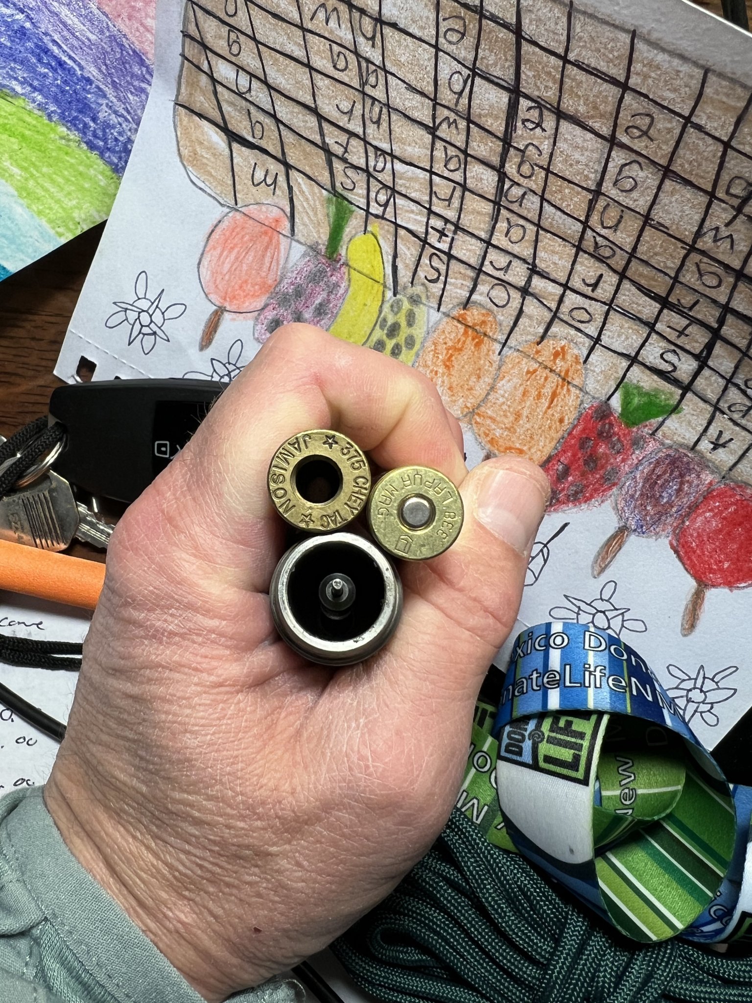

OAN, I'm looking at some precision expanding mandrels. This is my first leap into over bore(30 cal prior). Is this a thing with these larger cases? I would think so. I haven't started reloading them yet, but the new Peterson is coming in at .370". that is more interference than I normally am accustomed to(.0015-.002). I super appreciate any input.
I have never yet fallen into the mandrel expansion crowd.
I have loaded thousands of 375 Cheyenne tactical rounds over the last 11 years and done fine with just oversizing the neck and pulling through an expander ball in my Dave Veers dies. When we had inferior brass, especially Jamison, the next would split a lot if you didn’t kneel after every firing but now that we have Peterson, you’re not going to have to worry about that.
I would just roll with it, and maybe lube the projectiles at the junction of the boat tail, and the bearing surface with some lanolin wax
