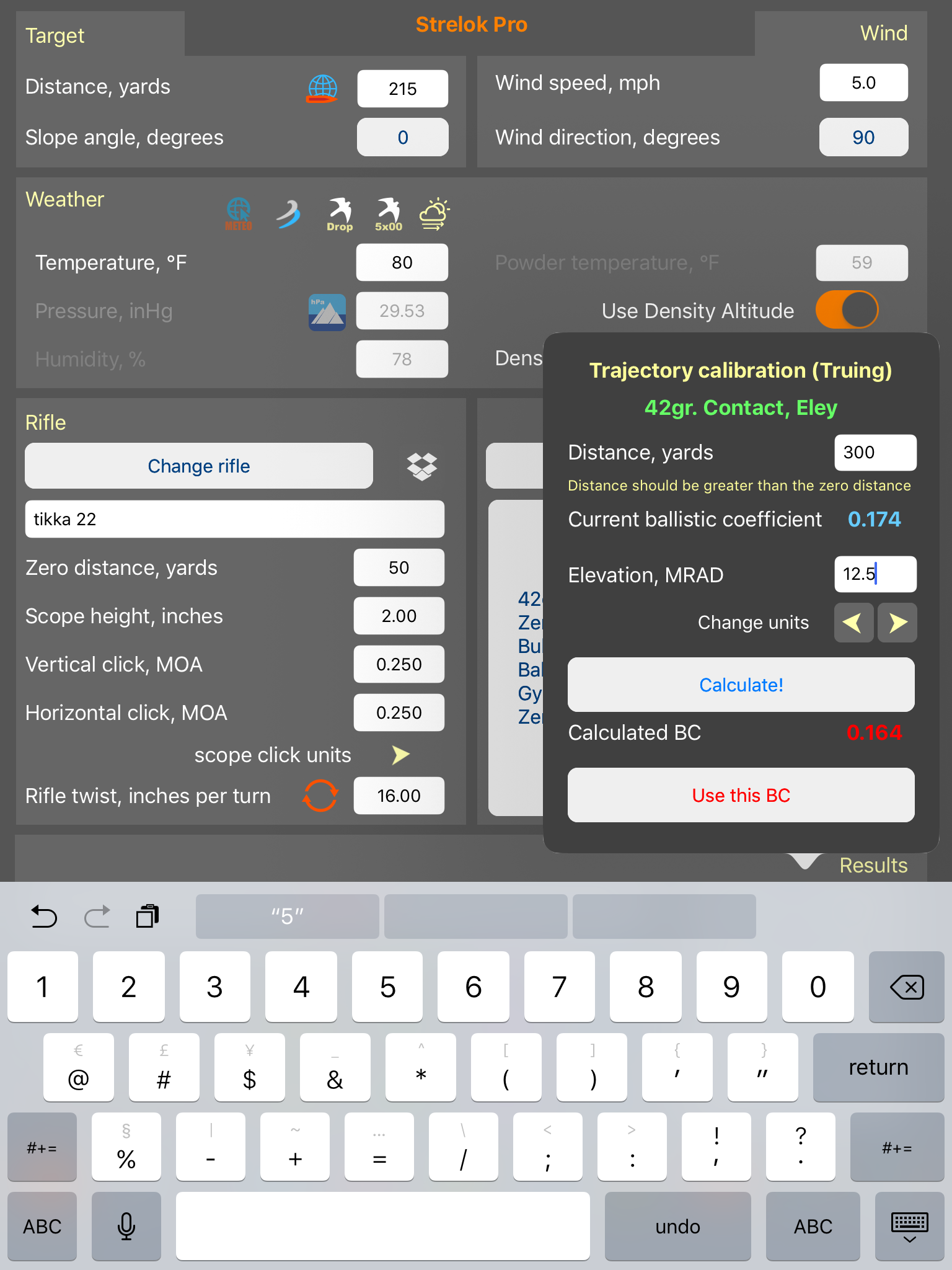

This is on my pad but my phone app has it too. All the way at the bottom right if you open one of those icons that say BC or speed you will put in your yardage and your actual dope. Then hit calculate either by velocity or BC and it will re calculate that based on your dope. Then you just click use this BC or velocity and it recalculates all your dope based on that. It has always been dead on for me.

Here is what I got on Strelok after putting in your actual dope and truing your BC. This is based on an altitude of 1000 ft though. Does it look about right?
Really, it seems to me, the only way to get an accurate BC to put into one's ballistic app is to get measurements from the firing of your own gun. This way many of the variables with regard to a particular barrel and cartridge load are eliminated (kinda like finding the best load when precision reloading).
That’s the whole point of that feature on the app. You get a starting point for your velocity and BC. Then you go out and fire the ammo out of your rifle. Based on the actual dope you get with your rifle you recalculate your BC and velocity for your rifle and generate a new range card.

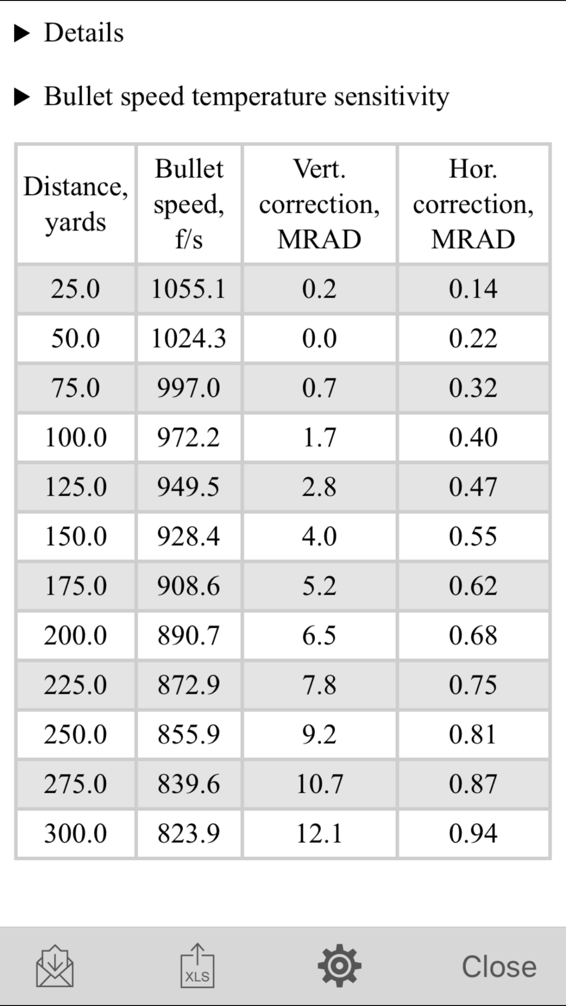

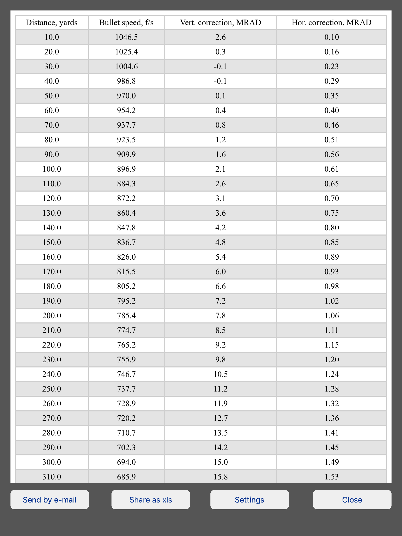

-- From futzing around with a million numbers, (no strelok pro, using shooters calculator)
CCI SV
I have .115 BC, 1070 FPS, 1.76 sight height
For Eley Target
I have .150 BC, 1105 FPS, 1.76 sight height

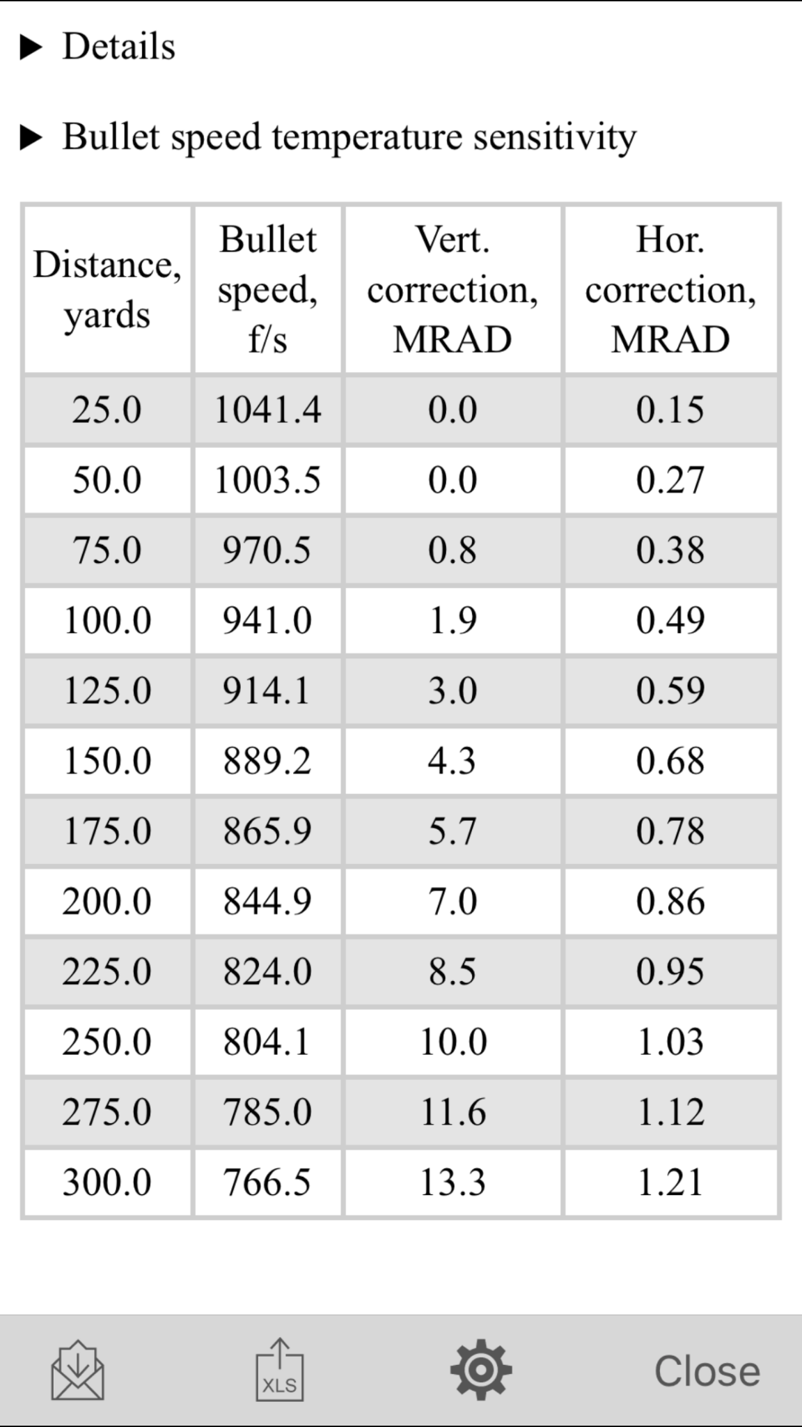

My numbers match up with yours for Eley target and they are consistent with the numbers I got with Eley Target. The first one is the numbers for Eley target. Compare them with the numbers I get with Eley Contact. I verified all these numbers as well and they are accurate. It’s a pretty significant difference.

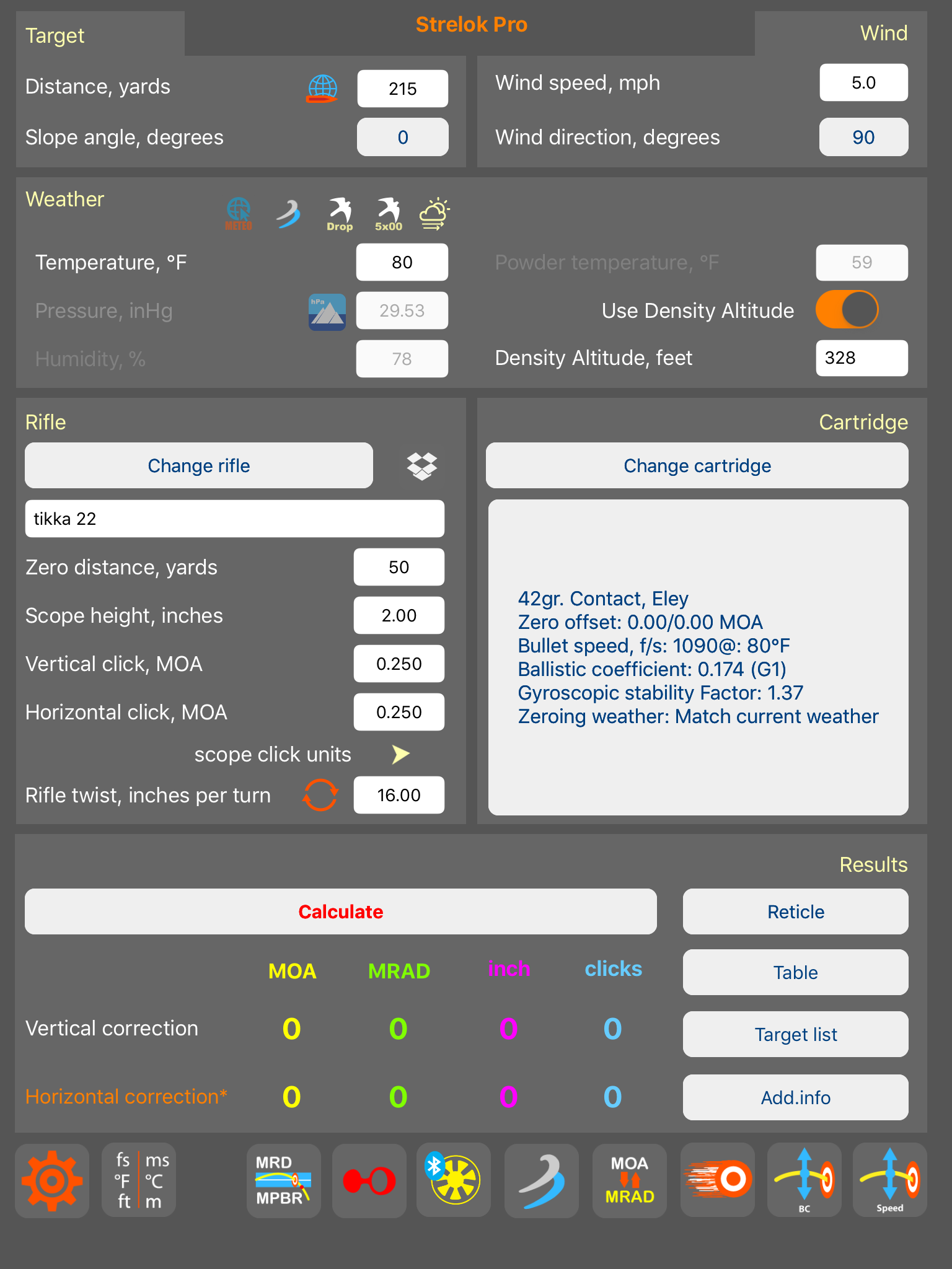

Wow that eley contact looks pretty promising. What bc velocity are you entering to get that chart?
I'll have to look for some. I see these bulk boxes of 300 rounds and then I see the normal 50 round boxes. And some say semi auto.
Reactions: Graywolf.260
I’m using a velocity of 1090 and a BC of .174. The numbers are accurate too. It seems like that extra 2 grains of weight make a significant difference in the BC and it is getting the same or higher velocity. We have been using the Force in our semi auto rifles with some pretty impressive performance as well. If you check LAX ammo you can get a 500 rd brick for $48 which is pretty cheap for decent ammo.

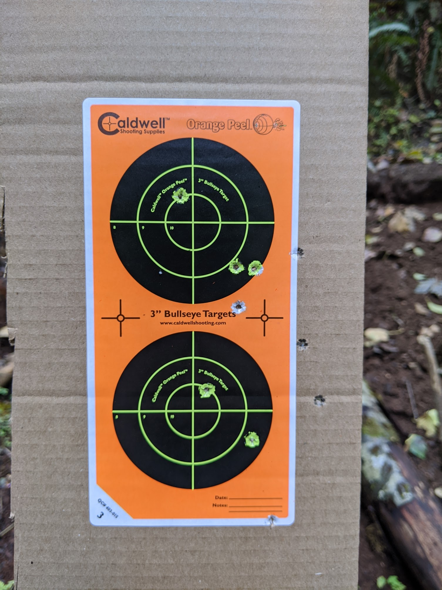

Went out to the range and did 100 & 200 with Eley Contact and Eley Target. New lot of Eley Target, and did a clean test at 99 yards and 203 yards which is where the target hanging is at.
Zero @ 25 for both.
New Lot of Eley Target
2.0 mils at 99
7.6 mils at 203
This gives me a BC of .145 & MV of 1090.
Eley Contact 42gr
2.2 mils at 99
7.8 mils at 203
This gives me a BC of .152 & MV of 1060.
For 100 yards, I did 5 shot groups, and they both shot the same around 1.1" to 1.8" groups, averaging 1.5".
For 200 yards, the groups really opened up. I did 3 strings of 10 as I was testing out my zero. 5-6 inch groups. My shot on the 4" gong hit about 80% of the time. I guess technically still good enough for most 22 rimfire matches.
