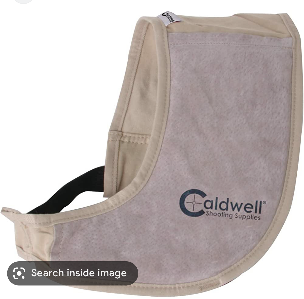

1677353927032.pngAnd nobody shoots BPCR without one of these….😉
Reactions: Modoc

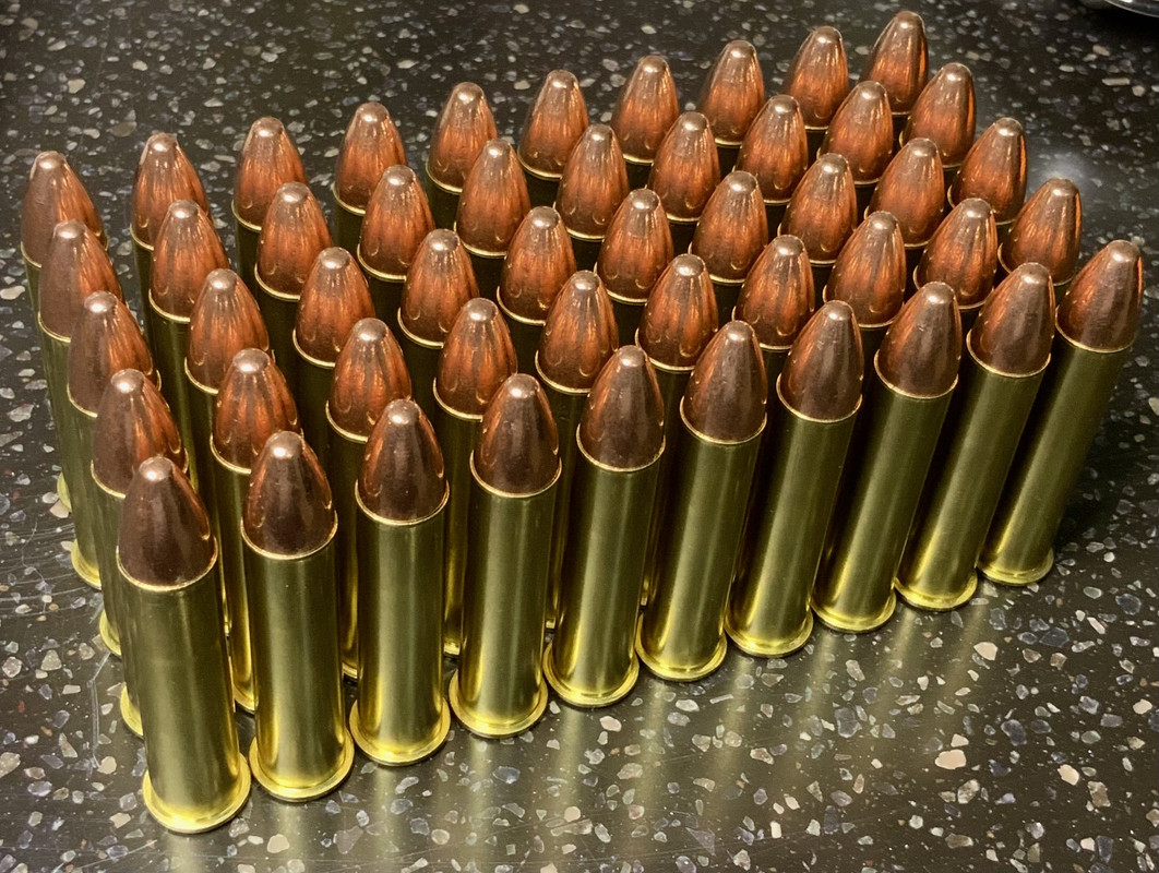

I’m using smokeless (IMR4198) in my Chiappa 1874 Quigley Sharps. I’m not using a real heavy bullet, nor is it cast. Here’s what works for me with the 34” 1:18” barrel.
IMR4198 38gr, CCI BR2, Campro 450gr Spitzer (full copper plated) bullet (2270fps), CBTO 2.200” (+.005” jump)
I know it’s not tradional, but it is a lot of fun. And using smokeless means none of the BP cleaning necessities.
