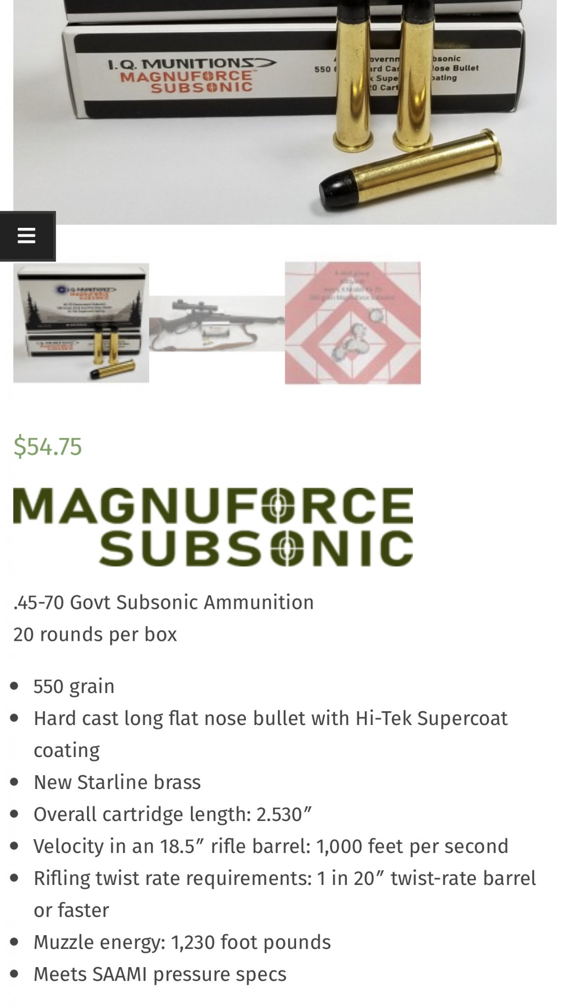

I have been looking at some 410 Hornadys, but ran across these 550 grains. What’s your thoughts on them? 550 seems like a lot!!
