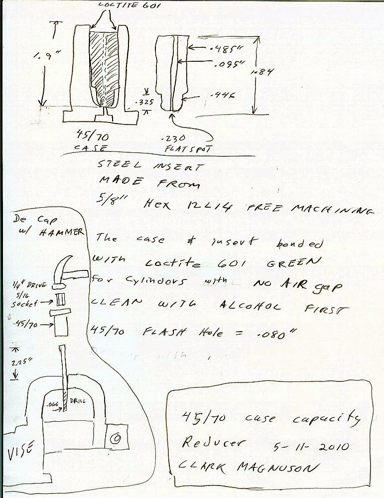

45-70handirifleSteelinsertcasefillerwithprimerhole155gr458RBcastbullet400fpsBBgunlike19pounds14pounds.jpg

I have been getting from a 45/70: 400 fps 155 gr 1 gr Bullseye with a 20" barrel.
This makes the sound of a BB gun.
This will stop a 14 pound or a 19 pound raccoon with a body shot, in 2 seconds.
This is WAY better than a Ruger 10/22 with expensive suppressor. It they are way up in the tree and moving, a single quiet body shot is easy to get. Then get the other ones.
The trick is the case filler gets the peak pressure up, the expansion ratio up, the efficiency up, but the escapement gas is kept below one atmosphere above ambient by the low powder mass and large barrel bore volume.
