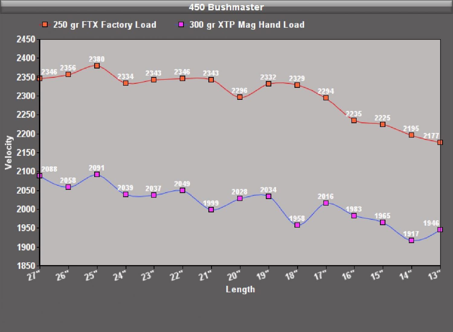

I have a buddy looking at getting a .450 bushmaster bolt gun specifically for hunting. Max distance would be 250-300 though that would be rare. The Ruger American comes in a 16” and a 22” barrel. I’ve seen where the 16-18” jump gets around an extra ~100fps with 250gr hornady ftx.
What I can’t find is data on the 22”. What is the continued gain from 18-22”? Is there any?

I was running 2333 for an average on a 22" custom barrel with Hornady factory custom ammo 250 ftx (brown box) I have a 16 Ruger as well and IIRC I was right around the mid 2100's with that rifle and the same ammo.
Reactions: BCX
Thats pretty good almost 200 FPS gain in 6 inches.
It is, but keep in mind it's a custom barrel and not a factory barrel on the 22". FWIW, the factory ammo box listed 2200 fps but I am not sure on the test barrels length.

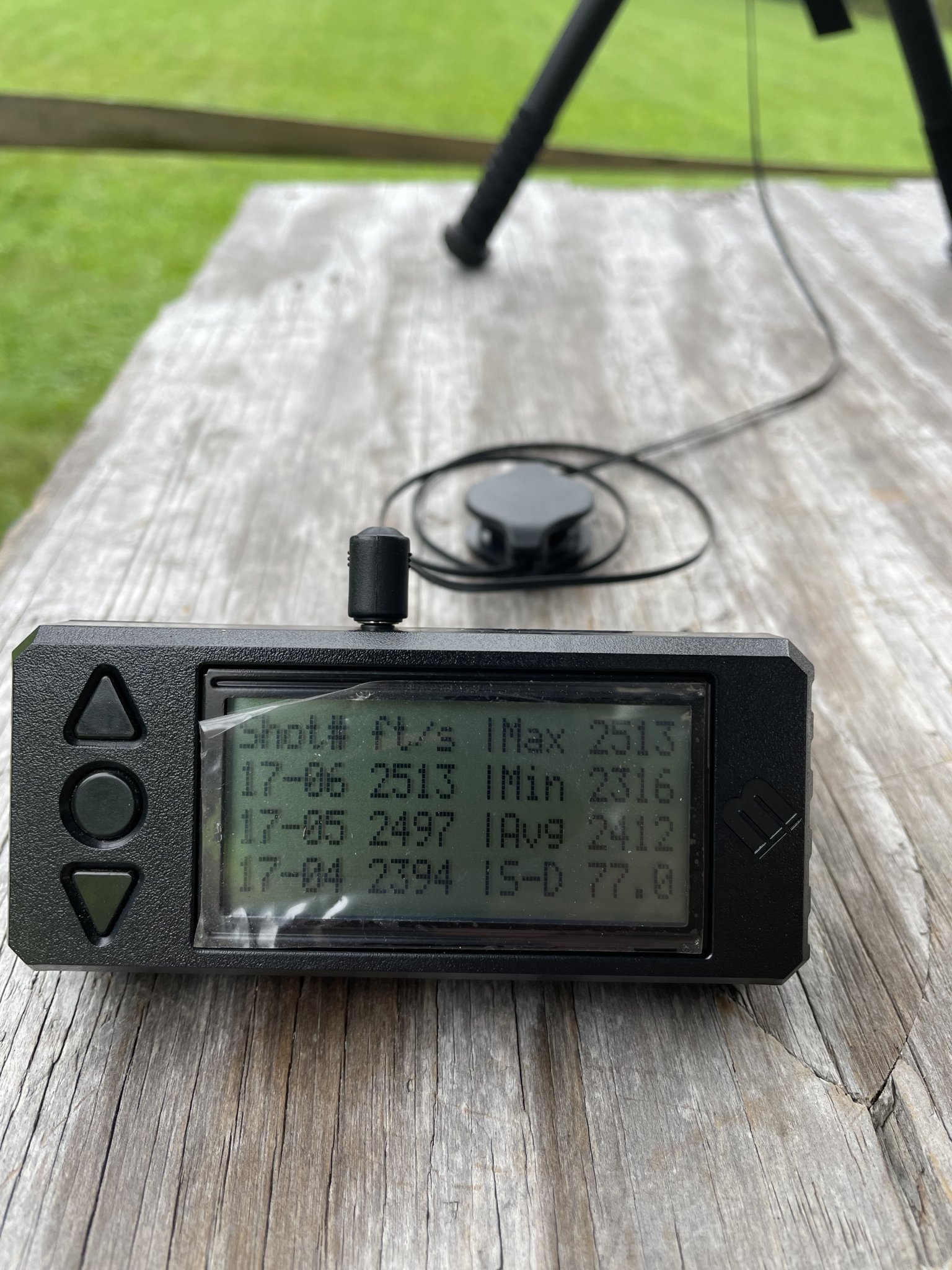

Finally got around to doing some load development w the BCB 240 HV w H110. This is the pressure test run .5 gr increments on the new rifle. The load that hit 2513 fps showed the start of primer cratering.
Reactions: HenryTheAce

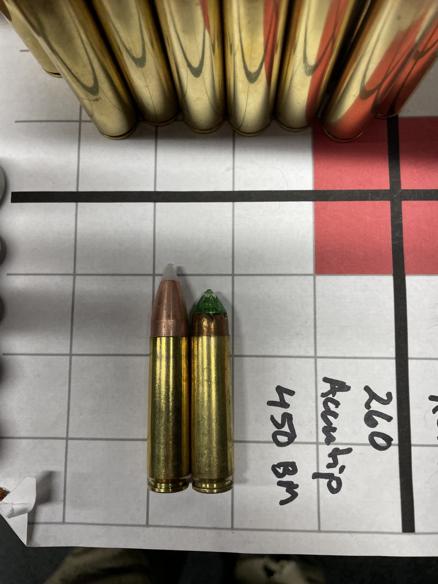

BCB 240 HV handload vs Rem 260 Accutip for comparison
Let me know how your load dev go, I'm quite curious about the accuracy potential of the 450BM with a Bartlein tube.
I’m going to retest this load. I may have pulled the 3rd shot. BCB 240 HV handload.
