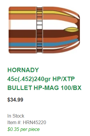

    Hornady makes two different 300gr 45 caliber XTPs. They have the groove in different places for 454 Casull and 45 LC. The 454 is why they are labeled Mag vs not labeled Mag.
    Xactly. The mag version is hard and can withstand high pressures of the 454. I don’t think Xtreme anything should be used in 454 heavy loads.

    And now I'm glad I asked. I'm certain you are completely correct and that I am a complete dumbass. I will put those aside for my .45 Colts.
    These are correct then right?
