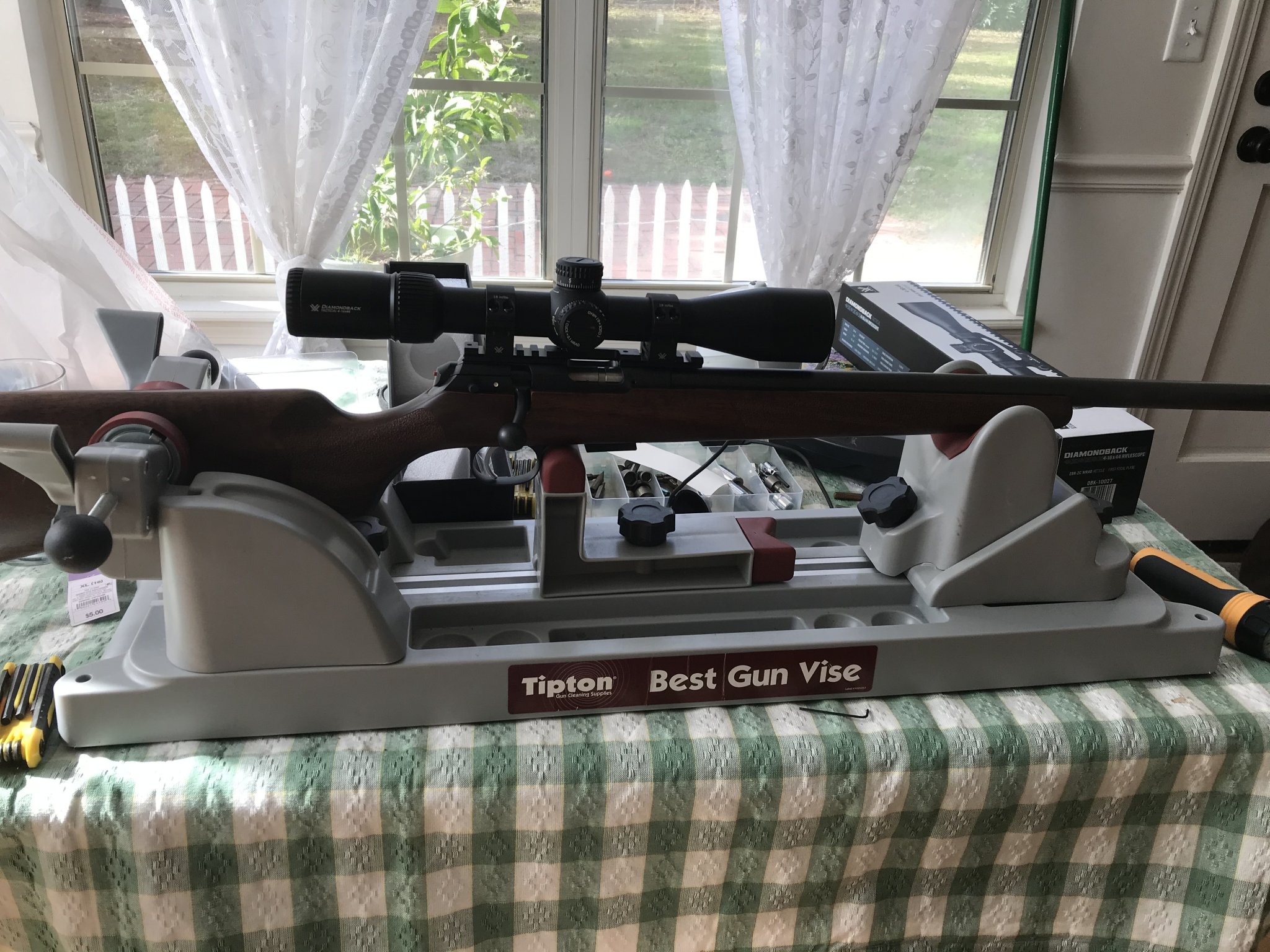

    I've got a 457 ProVarmint and I went with a Area 419 30moa rail and Seekins low rings (0.82") with a Athlon Argos 6-24x50 scope with room to spare between the barrel and objective bell. Granted that rail is approx. .5" tall so surely that helped. Not sure it would've fit with a standard rail being .25" tall or so.
    Hopefully soon I will be able to take it to the range
