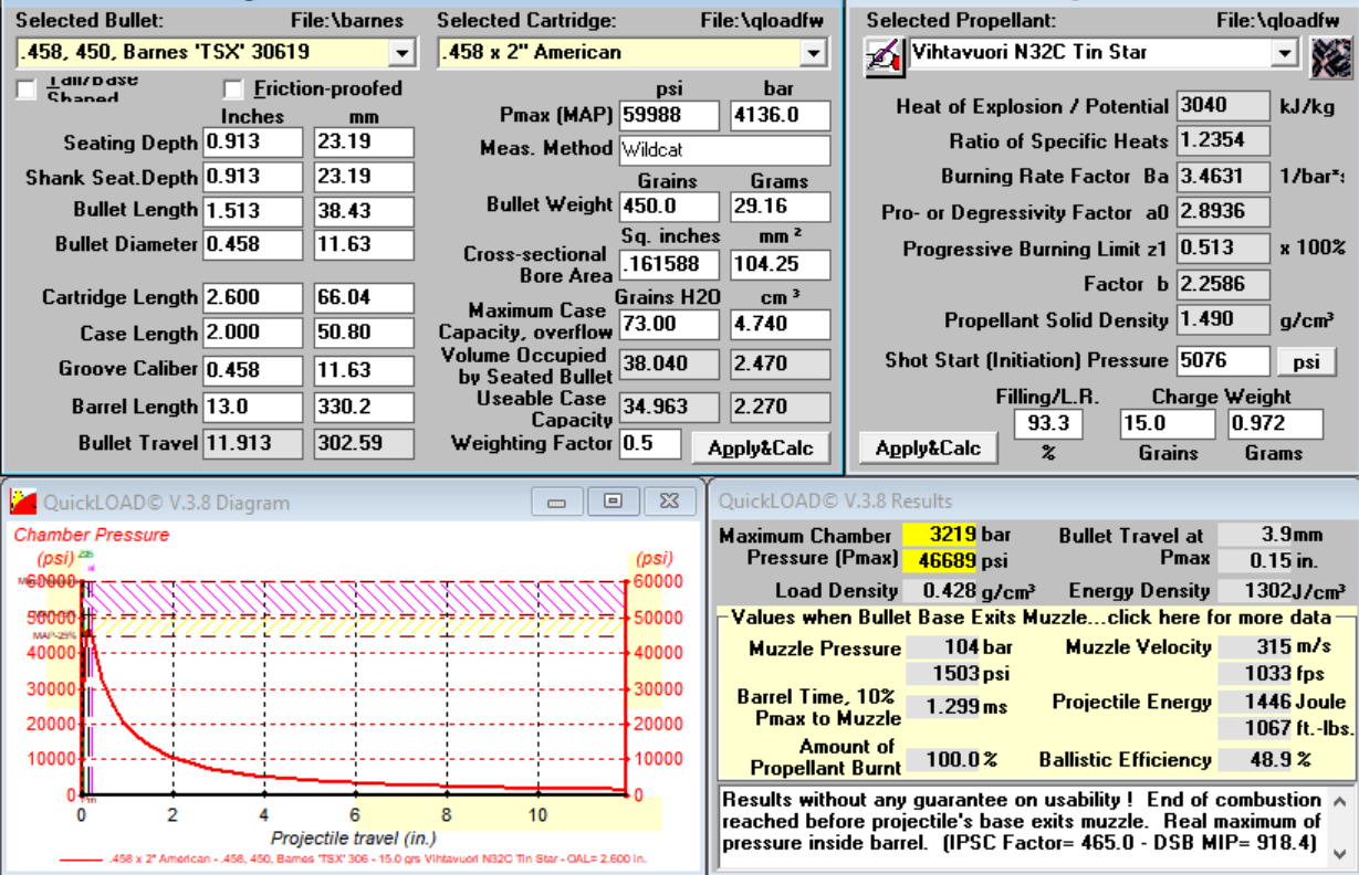

This is what I'm getting from quickload using Barnes 450gr
So my question is would there be a better 458 subsonic caliber more suitable than .458x2 ?

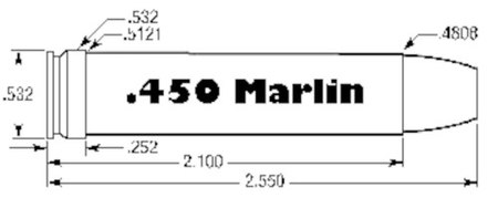

You making brass from .458 Win mag or .450 Marlin?
Mike
Less trimming with the .450 Marlin. Different belt thickness than the .458WM
