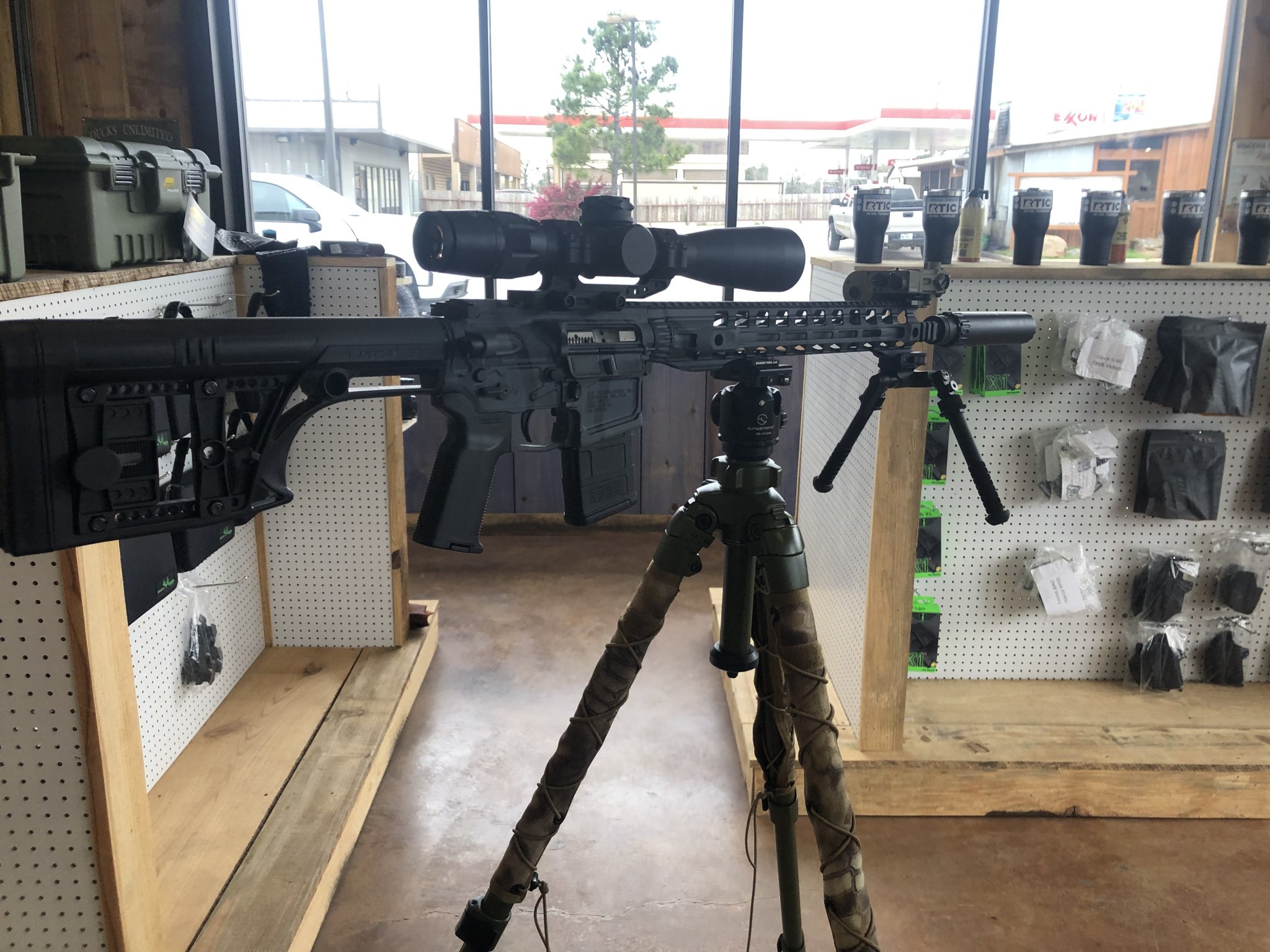

So I just got done building a precision AR in 5.56 and im trying to find a factory load the rifle likes but im finding it hard to find heavier ammo other than hornady. Black hills is sold out everywhere. So ive decided im going to start reloading my own hunting/match ammo. The bullets I choose need to do both interchangeably if possible. Need some suggestions on bullet seating depth, bullet selection, powder etc. not super new to reloading but ive never reloaded for a semi auto platform.

I have a noveske 18” lightweight spr barrel. 1-7 twist. 5.56 chamber its actually cut for the mk262 round
