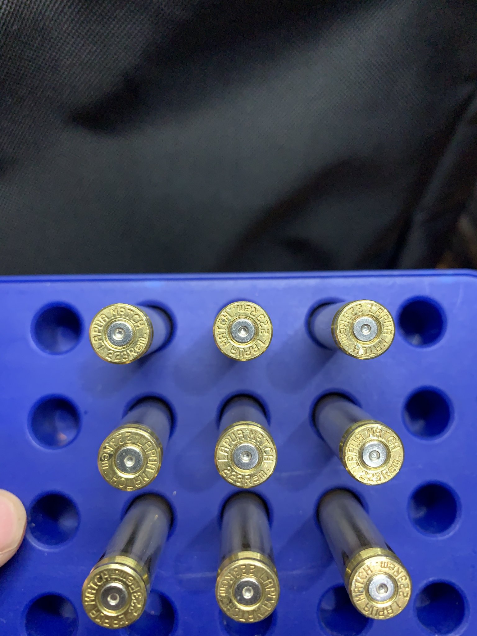

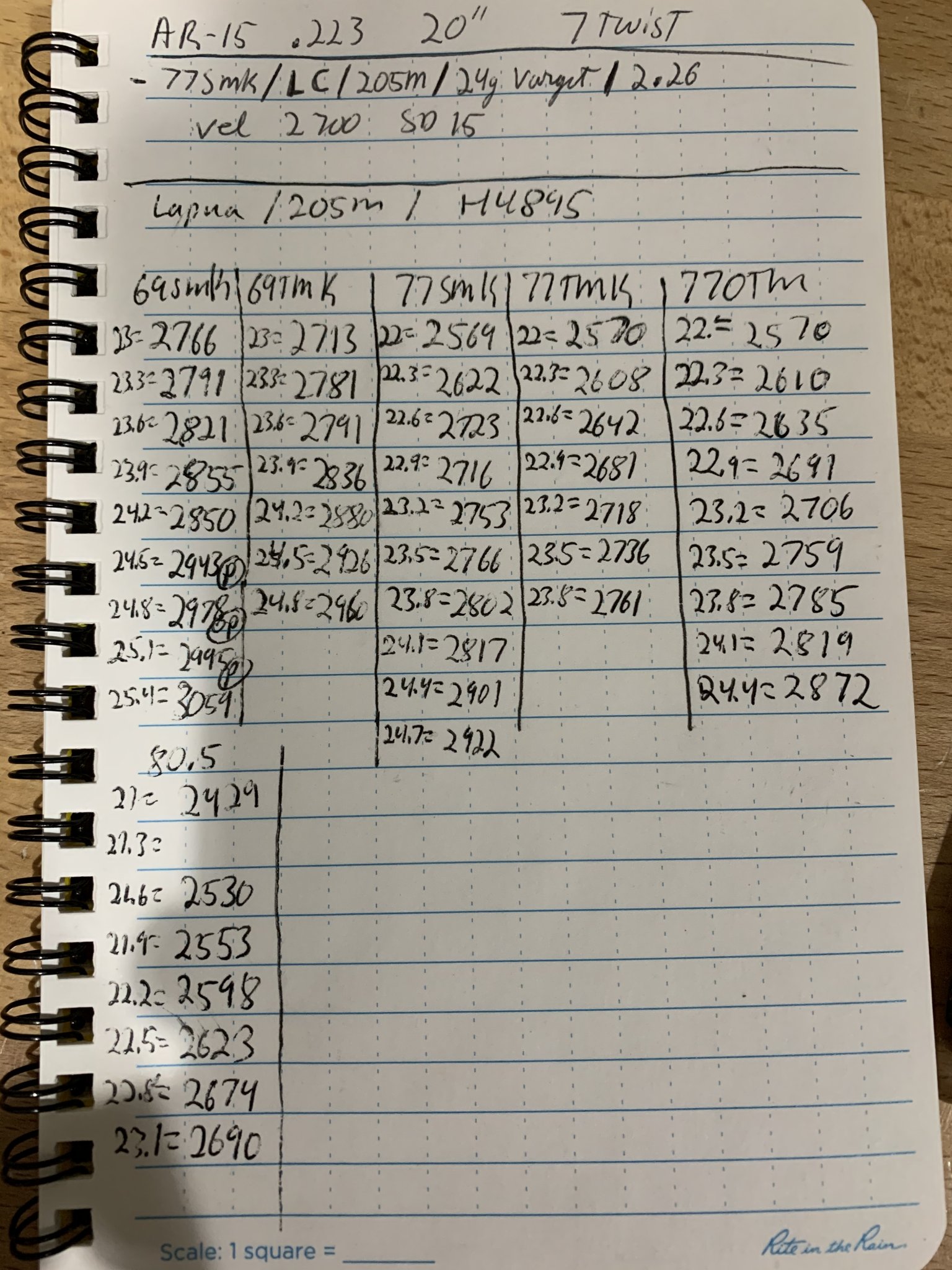

Just ran some lapua brass (once fired in a bolt gun) with H4895 in a 20 inch Bartlein spun up by craddack
Brass showed slight ejector swipe but want to tune the buffer system before ruling out the 23.5-23.7 area with the 77 and the 24-24.2 area with 69s

Magnetospeed.
Did you find pressure on the 77gr loads? What chrono did you use?

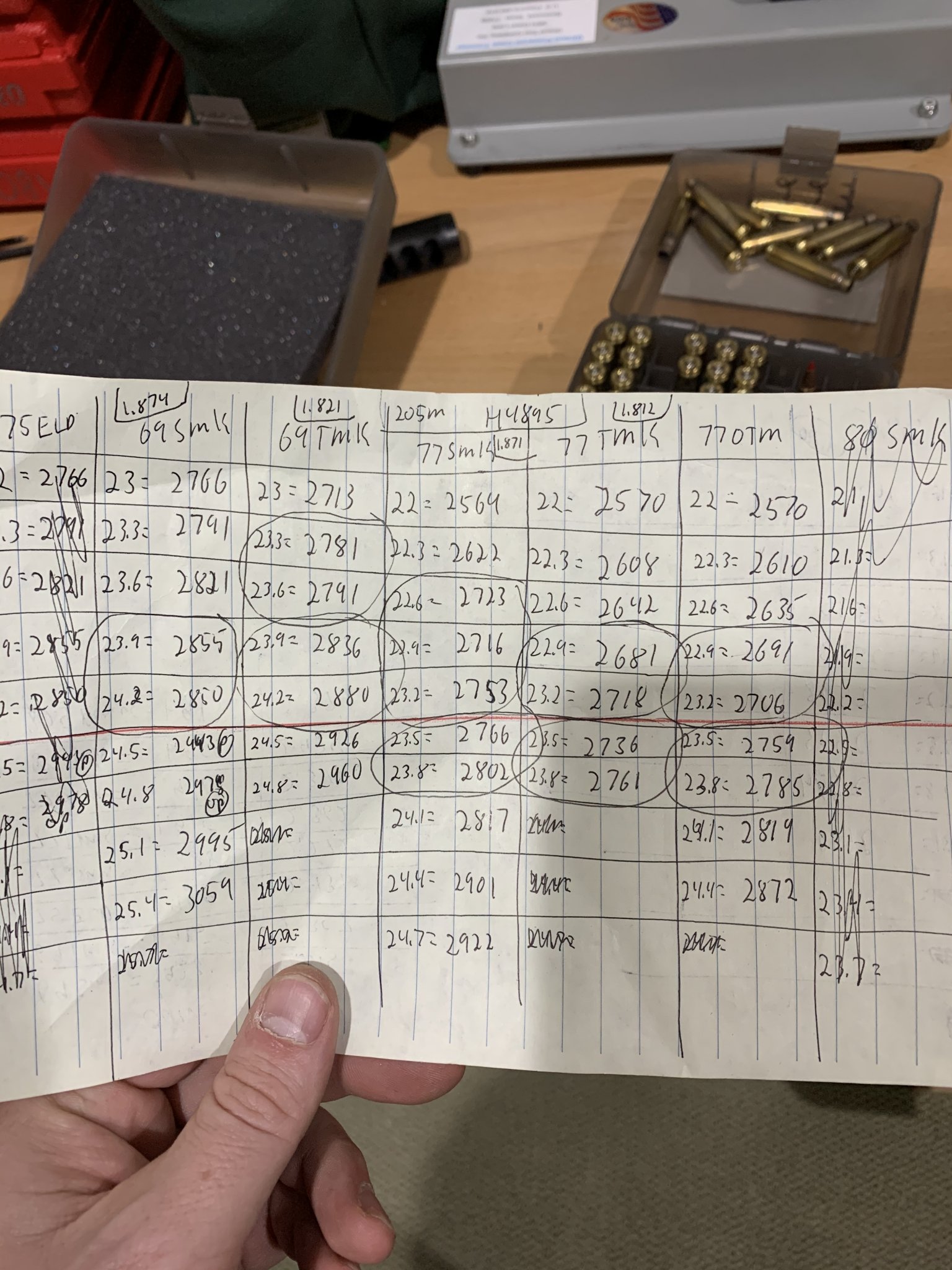

I used a magnetospeed. I had light case swipe on all loads past the third shot on each ladder but am going to mess with the JP buffer and gas block before ruling anything out. Primers were 205m and looked perfect on every shot on the ladder.
Currently running a standard spring and two tungsten weights
I’m going to end up in the areas circled below
Reactions: jLorenzo
Yea thats hot as hell in an AR...24.7gr varget is on the hotter side in a bolt gun loaded out to 2.49"....let alone a mag length AR round
Yeah I still want to test it with some hotter weather. Did it at an indoor range that stays in the mid 60s so all my data stays similar over multiple trips. Planning to end somewhere in the 23.5-23.7 range. Where I ended the 77 tmk ladders seemed to be a nice area.

They were slightly compressed the last two loads on the ladder but stopped because it started to be too compressed. I used my AD 120 and a 6 inch area 419 drop tube to throw charges so that may have given me more room to get powder in than normal.

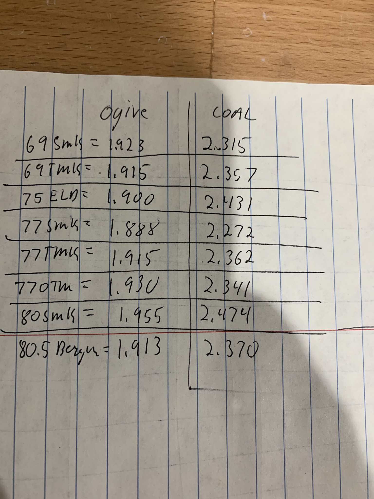

Measured the chamber in my 223 and came up with the following. 75 eldm was a non option after measuring
ASC SS mags get you out farthest I know of (2.315) I run them in all my precision AR's.. Very well built SS mags

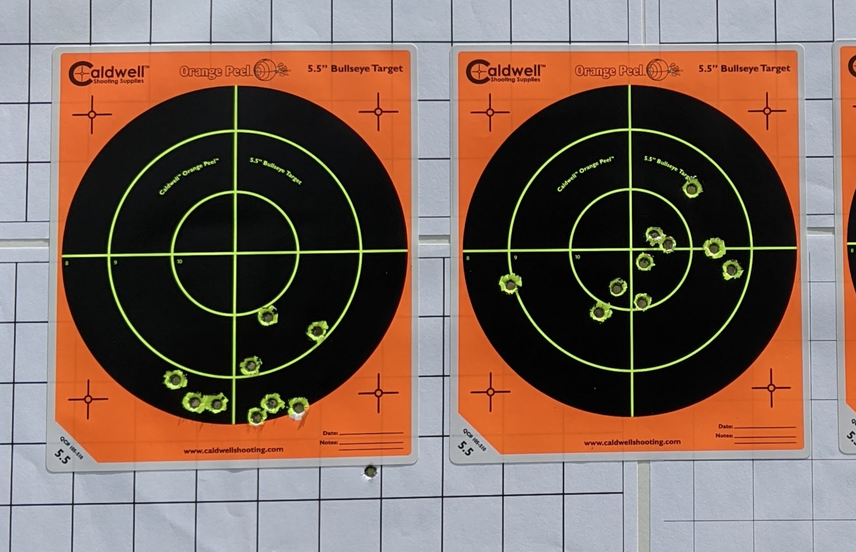

It was pouring out and had some decent result as well as some poor trigger control but happy with the outcome
I’ll measure later after the target drys
