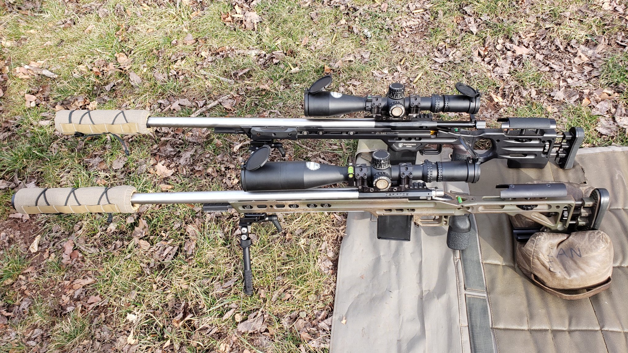

OpsInc 12th model
338 ultra
I actually shot my 338 ultra gen 1 next to my Magnus both on 223 bolt guns. While close I thought the Magnus was quieter so I asked 2 of my kids to sit out on the porch about 15yds away and slightly behind from my shooting position around the corner of the house so the sonic crack wouldn't be as noticeable. I shot both rifles 3 shots back to back and both kids thought the Magnus was noticeably quieter. Not scientific but definitely interesting and impressive for the Magnus.
Reactions: BlueLacy and BurtG
I have a Sig762QD can and use it on a 300BO and all my ARs And a bolt gun in 223. I tired a 5.56 can and couldn’t tell the difference in sound. SIG556 v SIG762 and I went with the 762 because I’d only need one can.
That's because the .308 bore suppresser has less gas escaping with the smaller .223 bullet, compared to the .338 bore suppressor. This is a non-scientific example of why pistol and the multi-caliber cans are less effective than a .30 caliber or caliber-dedicated suppressor on the same rifle.
That's not always true. Design has a lot to do with it not just bore diameter.. It was surprising because the 338 ultra gen 2 tested quieter than the Magnus with a 223 bolt gun. I was thinking the Gen 1 would be on par or not noticeably louder than the Magnus.
Correct, but you were comparing 2 very similar cans, and the .30 caliber was quieter… Therefore… Bore diameter of the can played a bigger role, than simply volume, or baffle count and design.
338 Ultra Gen2 is about 3 dB quieter than the Gen1 on 338, while the 338 Ultra Gen2 is about 2-3 dB quieter than the Magnus on most .30 cal or smaller calibers. Some cartridge combinations make them +/- a little different.
