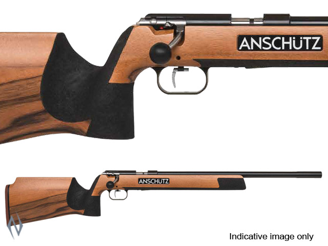

Old anschutz rifles had a bigger diameter on the end of the muzzle. Thr original claim was for iron sight mounting, so it would align with the receiver easier.
Turns out (supposidly, old folk lore) that anschutz lied. They drill, profile, then button reamed their barrels. The lump at the end would have half a thou or so constriction, acting as a choke.
