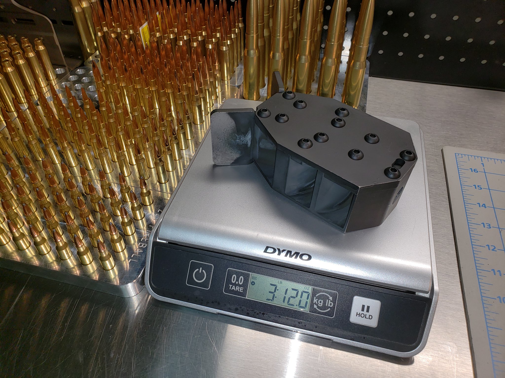

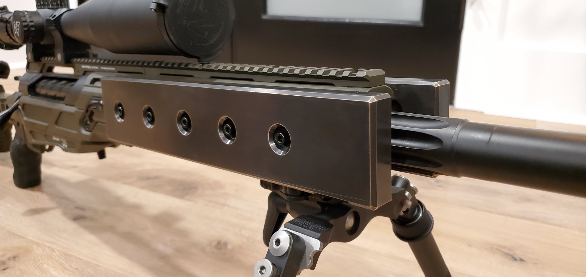

Couple options:
  1. Sell your rifle and get a heavier one
  2. Learn a CAD program & design some chassis weights
  3. Befriend a machinist who can do option two, pay them with lots of 50 BMG sessions
I went with option two, but it is not compatible with the AI platform or I would forward you the plans. A a few members on here helped me get them machined and gave tips on drawing plans.

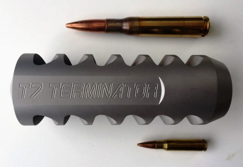

You might consider a Terminator T7 brake besides adding some weight.
The standard T7 thread is M36 x 1.5
The dimensions are 62mm, 2.44 ” diameter, 180mm, 7.09” long, weight is 1.695 Kgs, 59.78oz
A 50 BMG round above & 308 round below.
Eye protection is always recommended shooting. I feel those shots in my teeth after some of my hotter loads using the AR50 break.
You might consider a Terminator brake besides adding some weight.
And I thought my Terminator T6 was badass… you win. :)

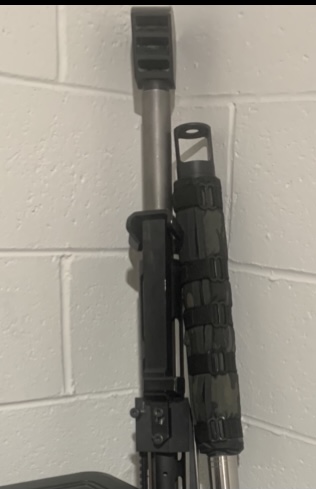

K&P clam shell IS the best. The armalite brake is next and a FCA suppressor with indexable muzzle brake is easy on the ears and recoil at the same time.

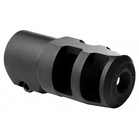

I have Marks 1st and 2nd Gen muzzle brakes. Neither are as effective at recoil management as the AR50. Mark was cool enough to give me one of his Shark Brakes and it was a definite improvement over his previous brake but still, after a long session of shooting the .50 BMG you felt it.
I can't remember which generation the 2" diameter three gill shark brake was but I feel it is fairly comparable to the AR50 brake. both my 50s weigh about the same and side by side the differences isn't much.
-Alex
-Alex
2nd Gen. 1st gen looked like holes drilled/machined in it.

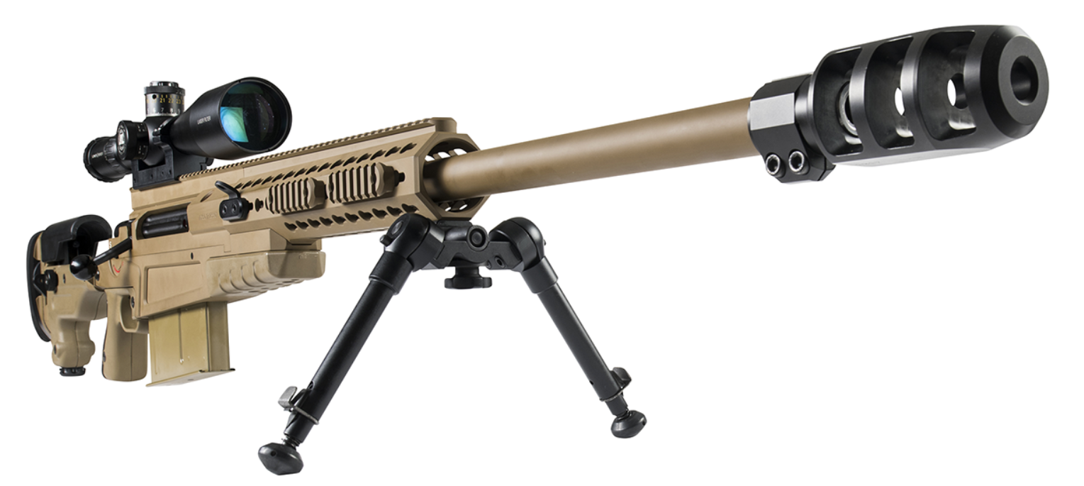

From a 2022 article. Reminds me of the Badger Ordnance FTE except bigger.
