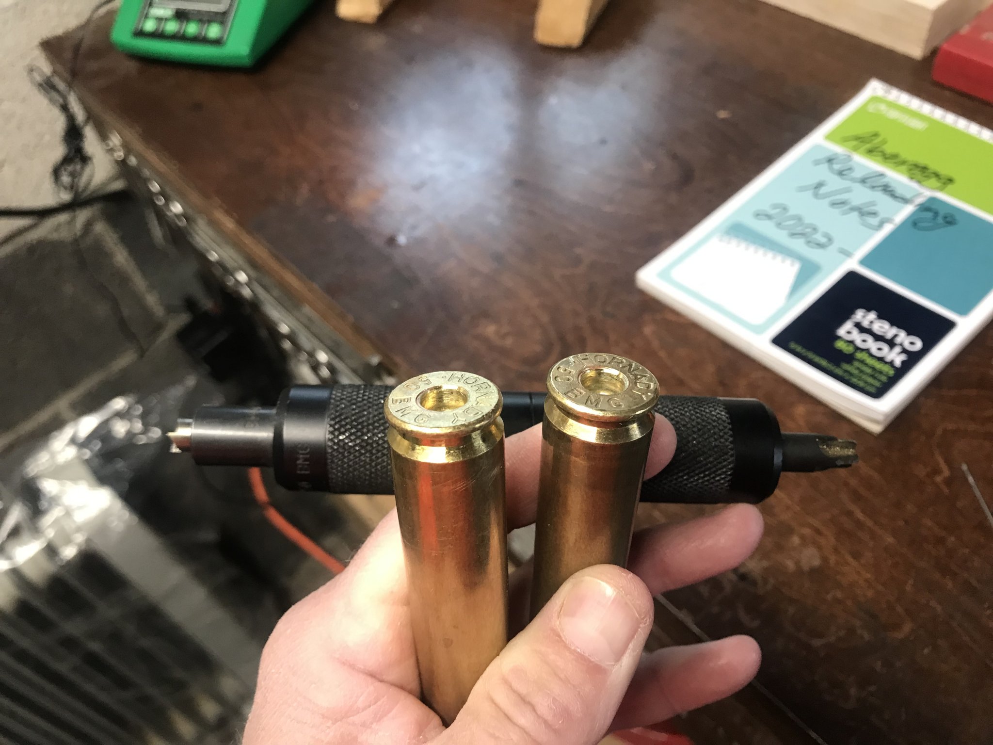

More info on primers for 50, assuming you're learning. Seating 50 bmg primers isn't so plug and play compared to smaller cartridges. No fun throwing away 20 dollars in primers because they didn't seat right. I highly recommend getting a go/no go gage and the K&M reamer. You will also want a chamfer tool that isn't too steep
Make sure the go gage slides in without tons of effort. Edges should be chamfered enough to prevent hang ups. Use the K&M tool with a hand drill until brass shavings stop coming out. Can take a number of passes before the depth is cut deep enough.

If you guys are talking about removing the crimp from once fired factory loaded ammo, there is no better tool than the Lyman tool. I’ve tried everything. The Dillon Swager didn’t work. Nothing else worked
If you guys are talking about removing the crimp from once fired factory loaded ammo, there is no better tool than the Lyman tool. I’ve tried everything. The Dillon Seaver didn’t work. Nothing else worked
I've been trying to buy one for a year. Have yet to find it in stock somewhere. Seems like it is out of production at the moment.

I hate to say this but I have used a drill with a bit and a drill bit stop to remove the crimp. Then deburring tool to clean it up. I can't remember the drill bit diameter off the top of my head.

Here is the chamfer that the Lyman tool makes. It’s the end on the right. I test how far to go with the PP uniformer on the left of the tool. When it barely fits I’m done. A drill bit may work too, esp if you could wind one the exact diameter of the pocket.
