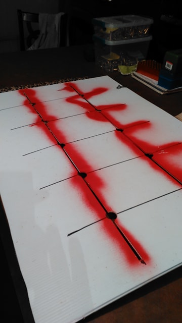

This is a template for a steel plate, if you measured your target out, and placed your aimpoint dots level across the board, one for each charge. You now can run a combo OCW-Ladder all in one. If you do not understand what I am saying, PM me.
Reactions: VDVSNIPER
