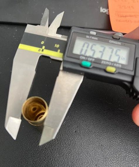

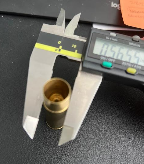

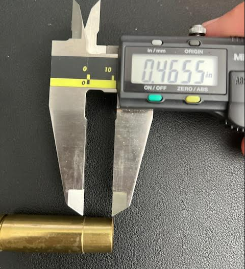

So what angle cutter do you use for cutting the shoulder. I'm working on making some dummy rounds for my Smith to use when chambering my barrel. Thanks in advance.
Yeah, it's using a .500 Linebaugh(?) pilot on the cutter, I think.
OD below shoulder
OD above shoulder
Length of neck
Trying to do this while holding my phone means these aren't 100% exact, but should at least get you in the ballpark.

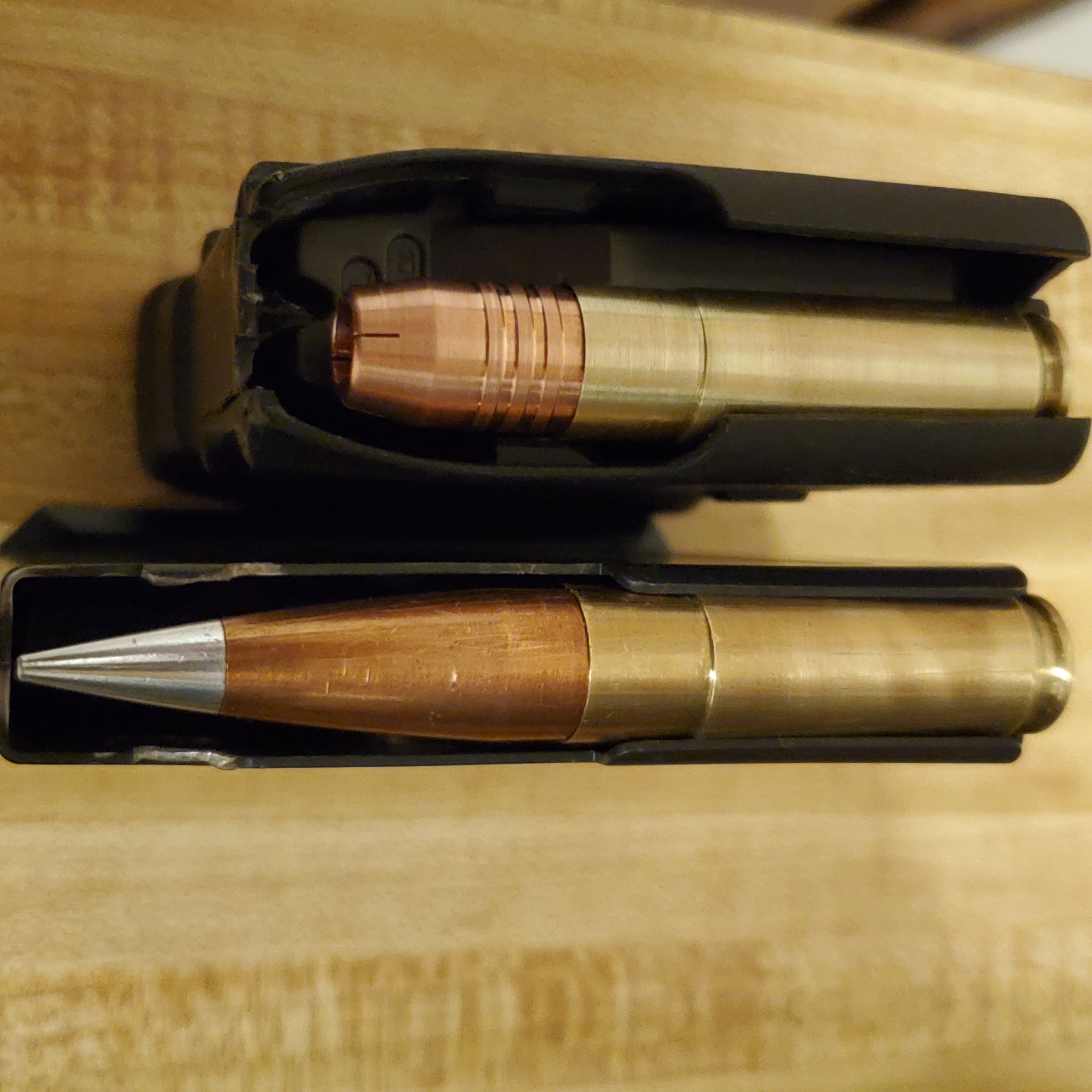

I use the standard 510 Whisper reamer, so I trim in mill and turn in lathe, easy that way. It has about 90 grains of capacity in case ya want to go super sonic it gets over 5000 ft/lbs of muzzle energy with the lighter 350 to 500 gr bullets. And AR 10 capable mag fed with these "lighter" bullets...but ya have to turn new extractor groove. Picture of 510 whisper 350 gr cutting edge for AR 10 or 750 Amax for magnum bolt gun. It's all easy with a lathe and milling machine...but that's like cheating compared to hand tools.
