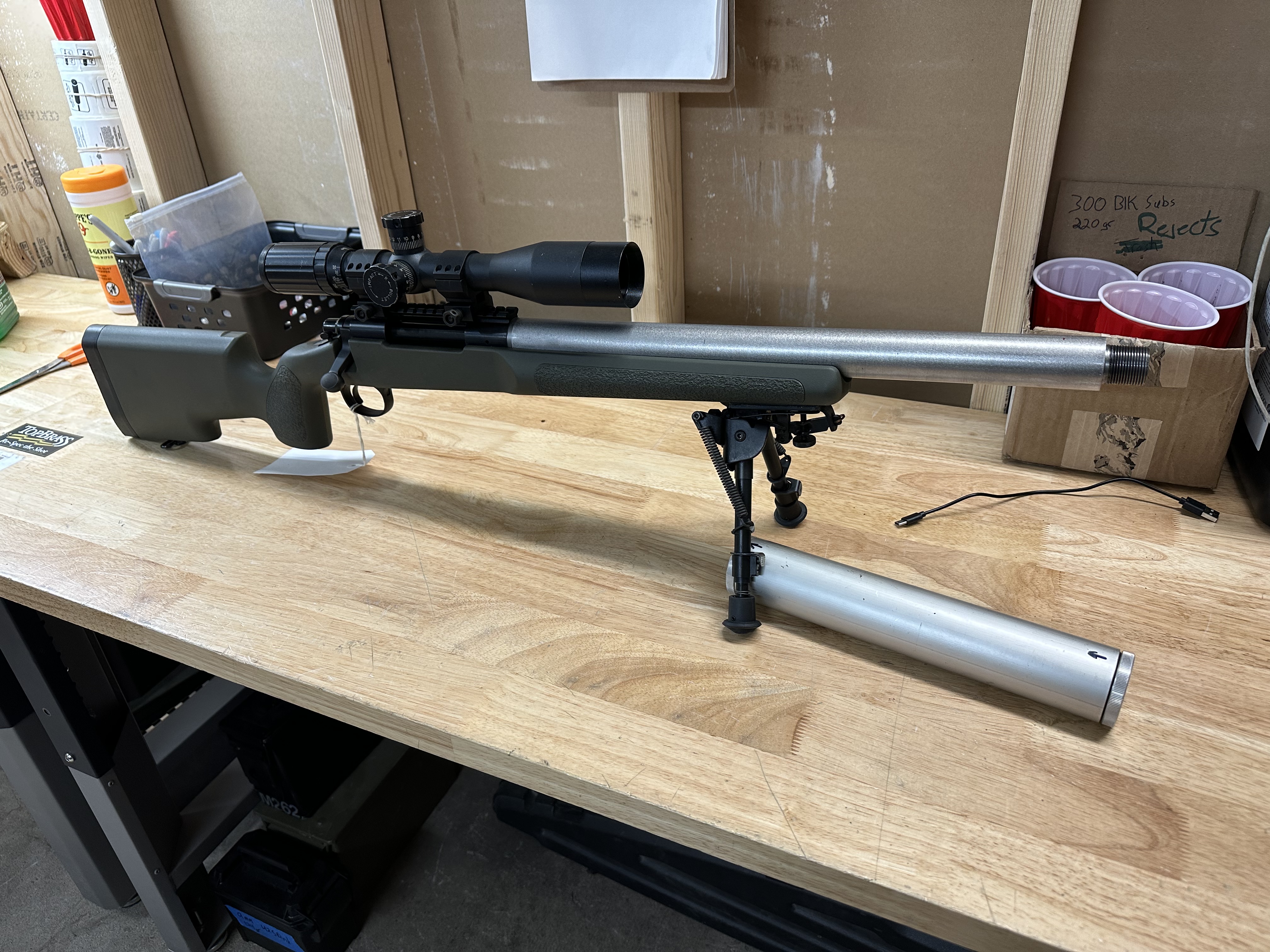

I ordered a .50 cal barrel and am having trouble deciding if I should chamber it in .50 whisper or .50 110 win. It will be in a rem 700 long action that used to be a .338 win. I have a new bolt coming.
Barrel is 24" 1-5 twist
Cutting edge has a 1002gr. Bullet I want to send at 1100fps. Rifle is strictly for sub sonic target.
I'm sure the .50 110 will do the job but trying to cut down on c.o.a.l so I can run my 3.6" accuracy international mags.

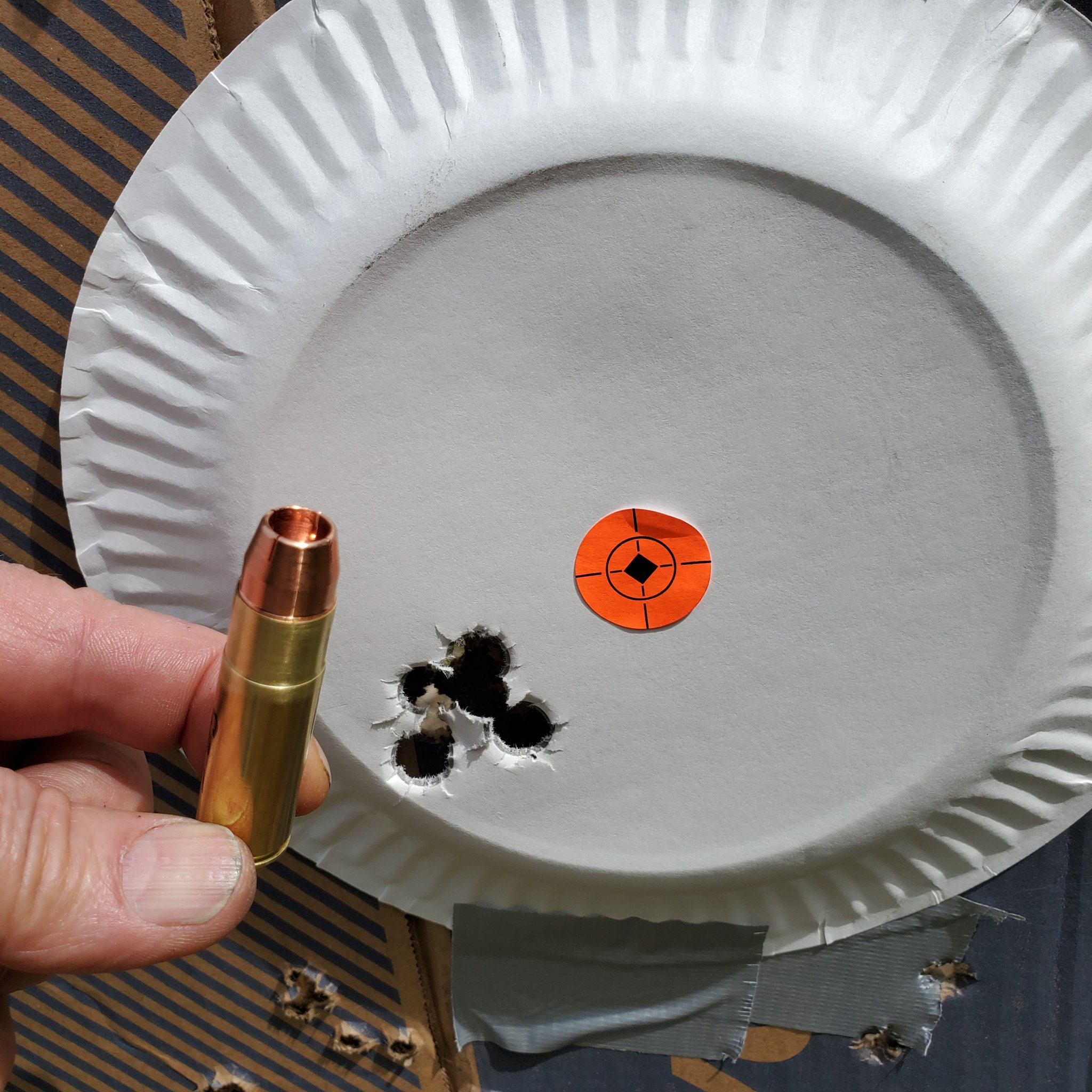

The 510 Whisper is not only for subsonic use.
Here is a .510 Cutting Edge 350 gr bullet at 2447 fps, for 4700 ft/lbs of muzzle energy.
Should be good for most hunting applications, at moderate ranges.
Reactions: sardo_67

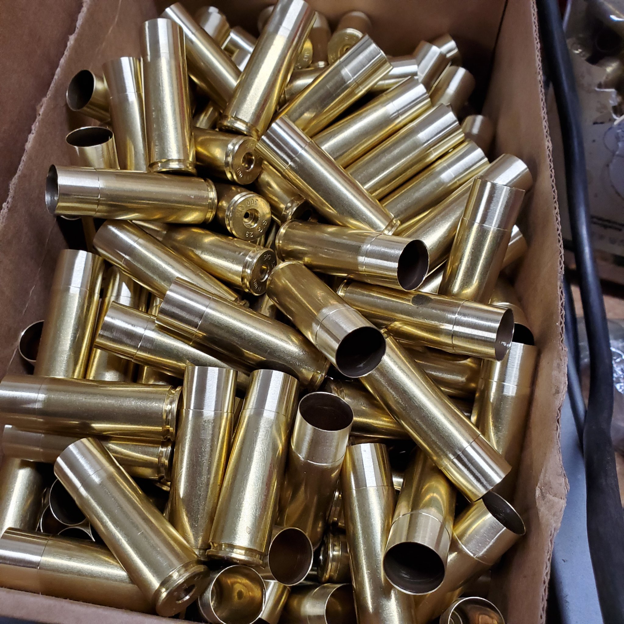

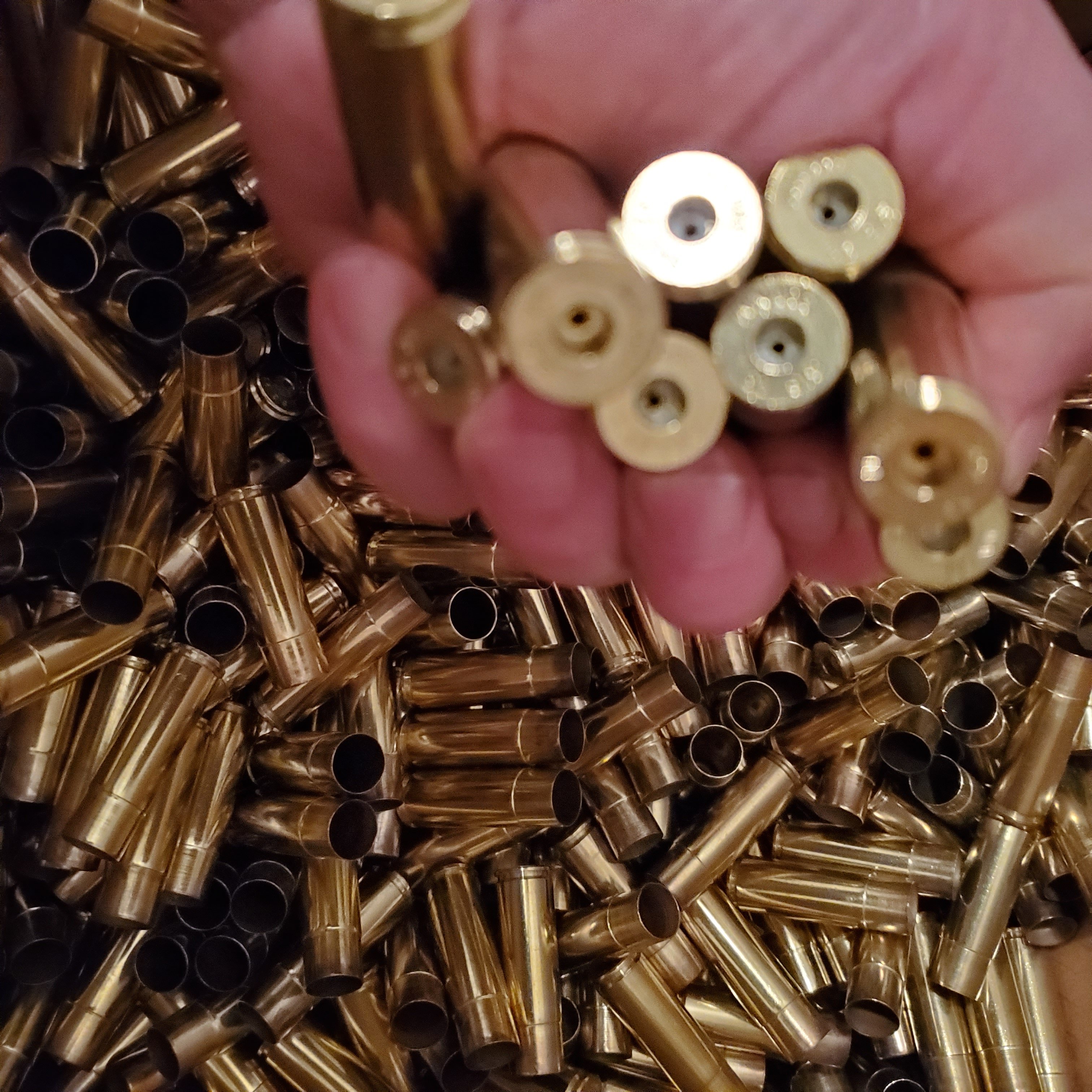

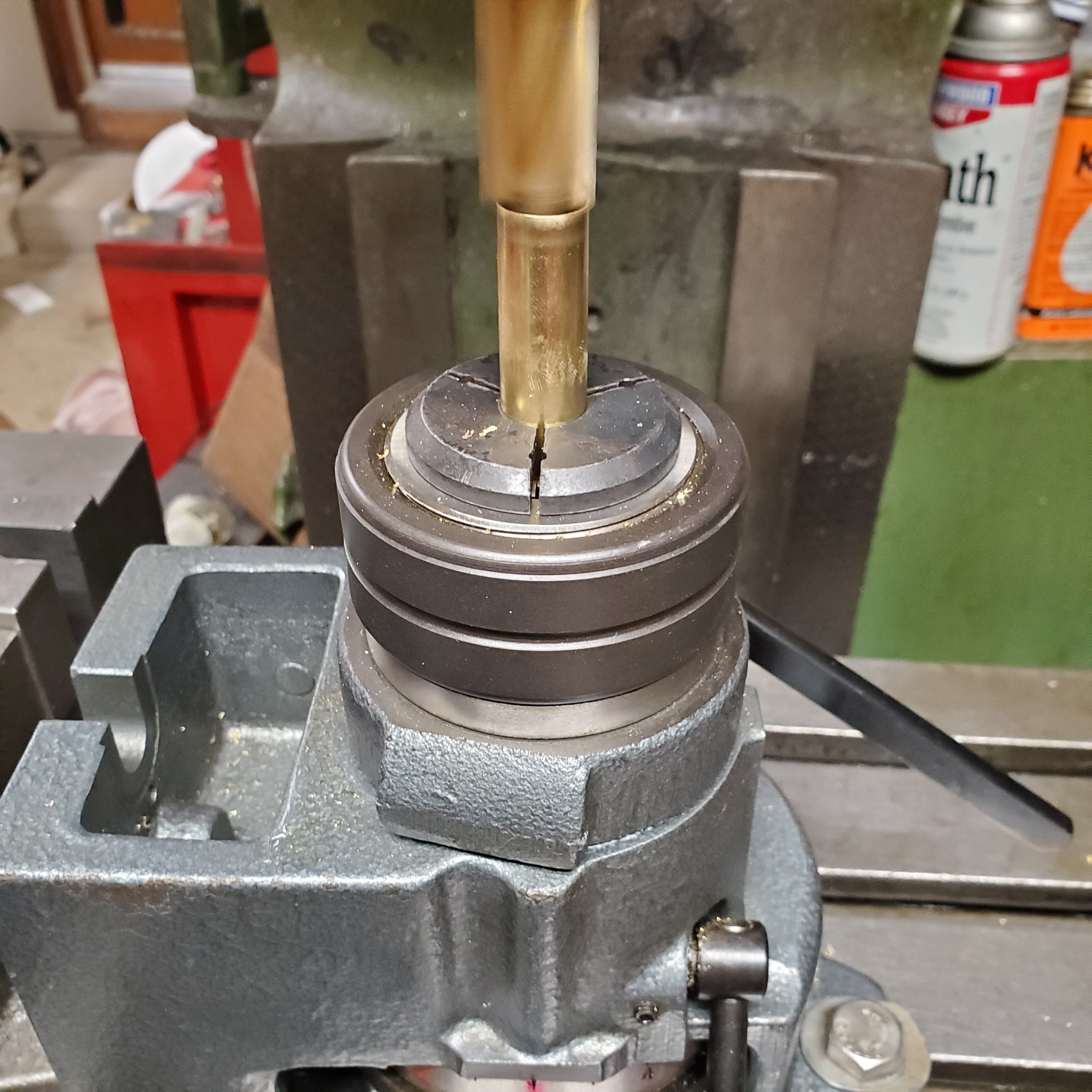

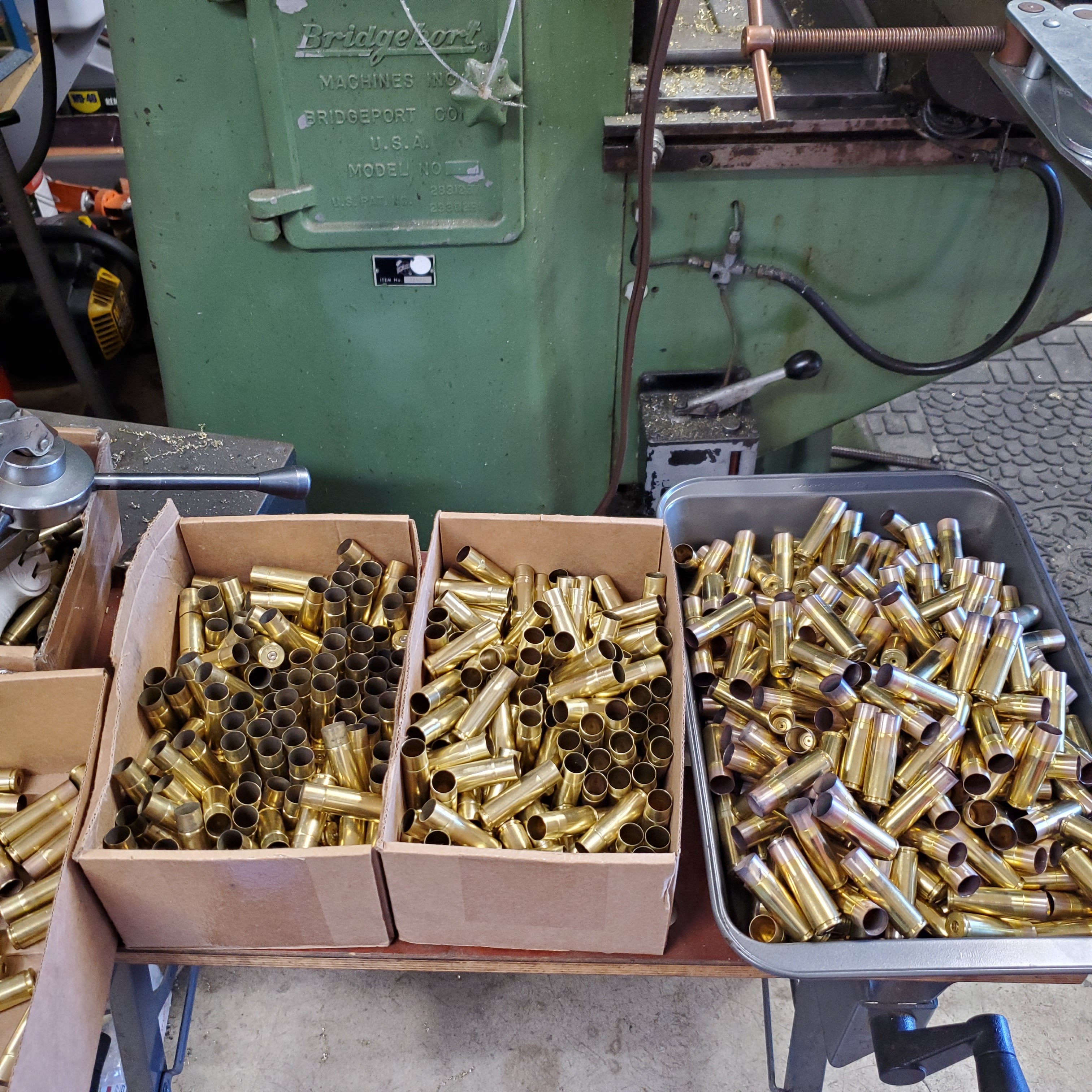

Came in for a break, I just finished 200, 510 Whisper pcs of brass ready to be sized.
I have a total of 300 completed.
Cost is about 53 to 63 cents each. And a few hours of time.
It's actually a relatively easy process.
Mechanize it and it goes faster.
Probably make close to a thousand pcs and be done with it.

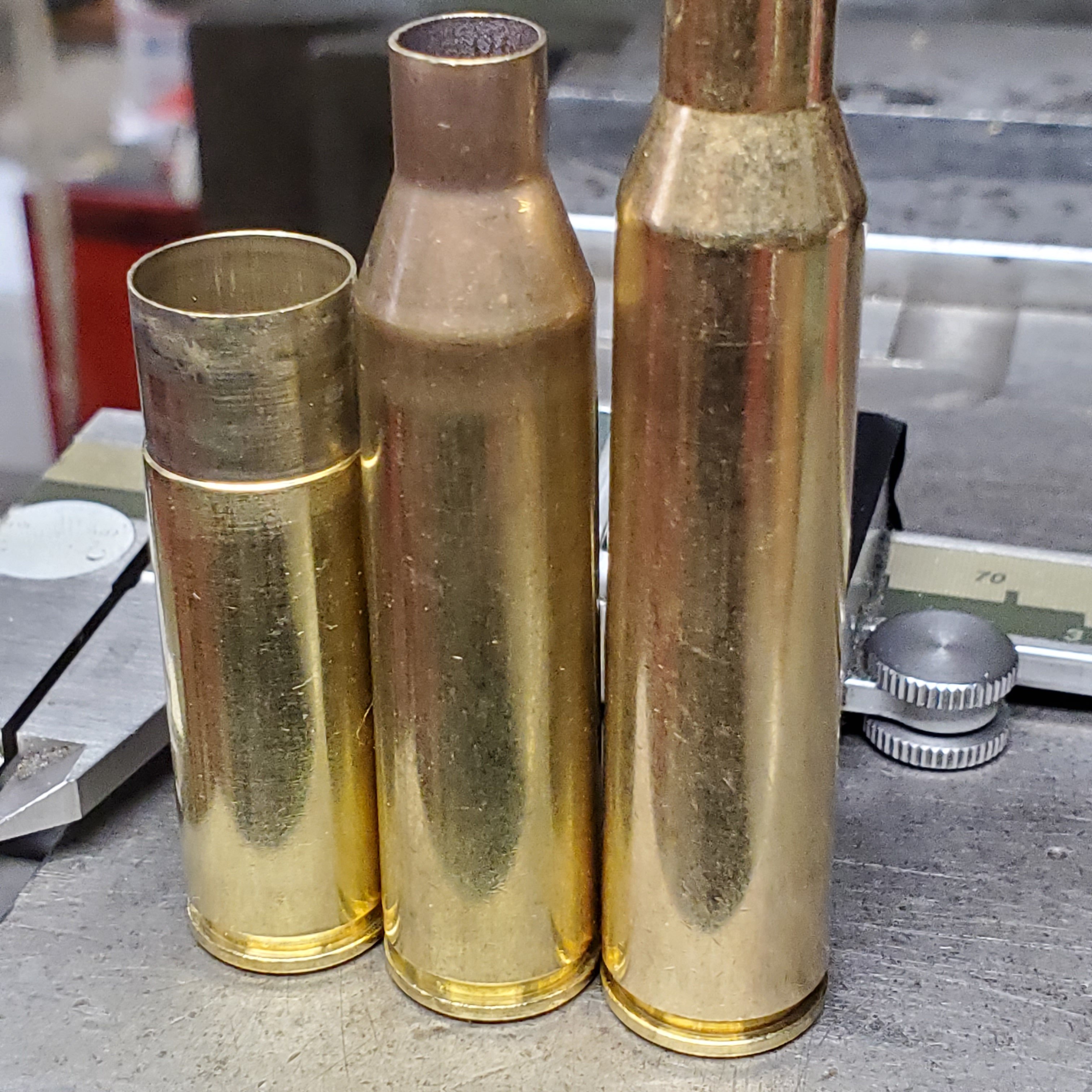

I have just started testing the .510 Whisper, as I spent so much time getting the 8.6 Blackout to where it is a useful cartridge now with the 6.5 twist.
The 510 whisper is very useful, just as it is, its a pretty good design.
It will shoot long heavy bullets over 1000 grs in subs or 350 gr copper bullets to 2450 fps and 4700 ft/ lbs of energy for large game, or shoot clear through an elephant if desired.
The 50 bmg APITs will pop at muzzle velocities as low as 780 fps range, 100% at 100 yds, and are fun to shoot.
I shot more of those than any other bullet. ...double the speed and one starts to notice the recoil.
So today, if ya wait for others to make your brass, you'll have a long wait.
Reactions: db2000

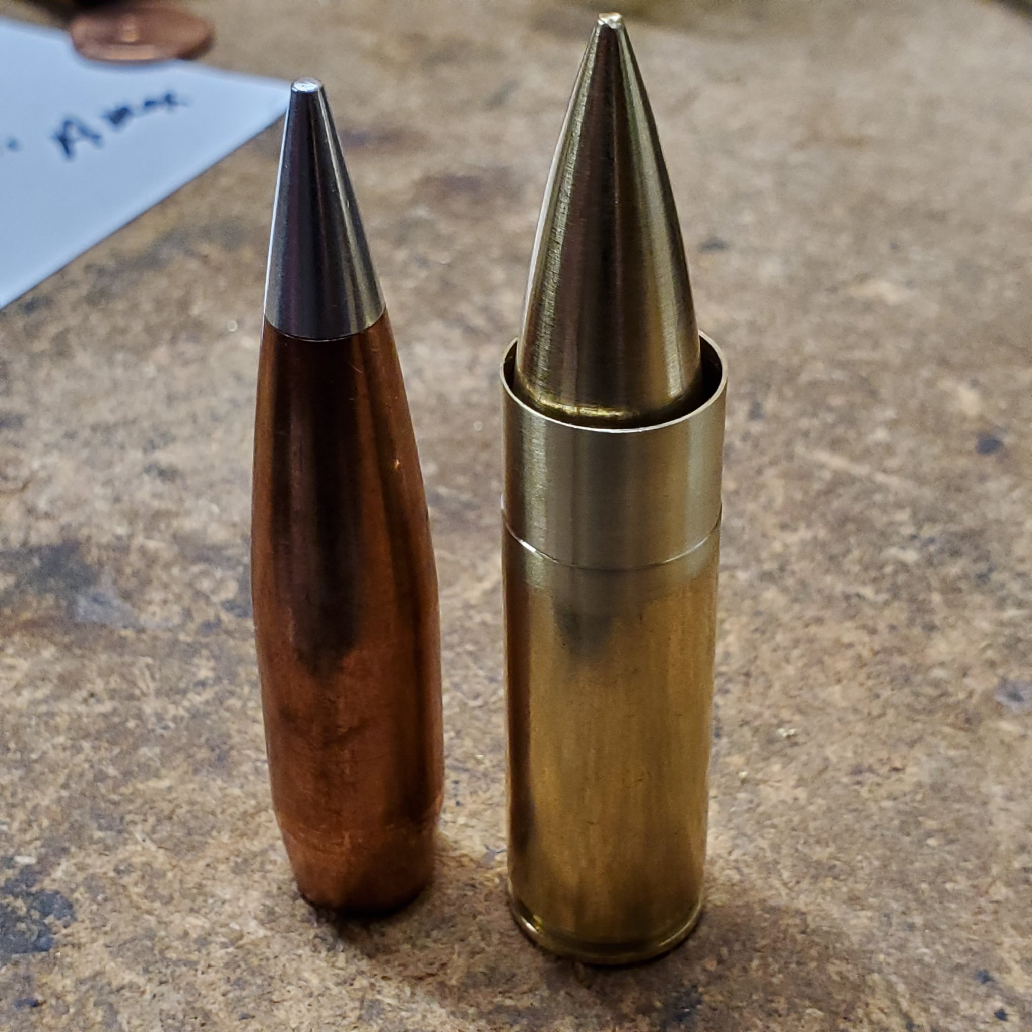

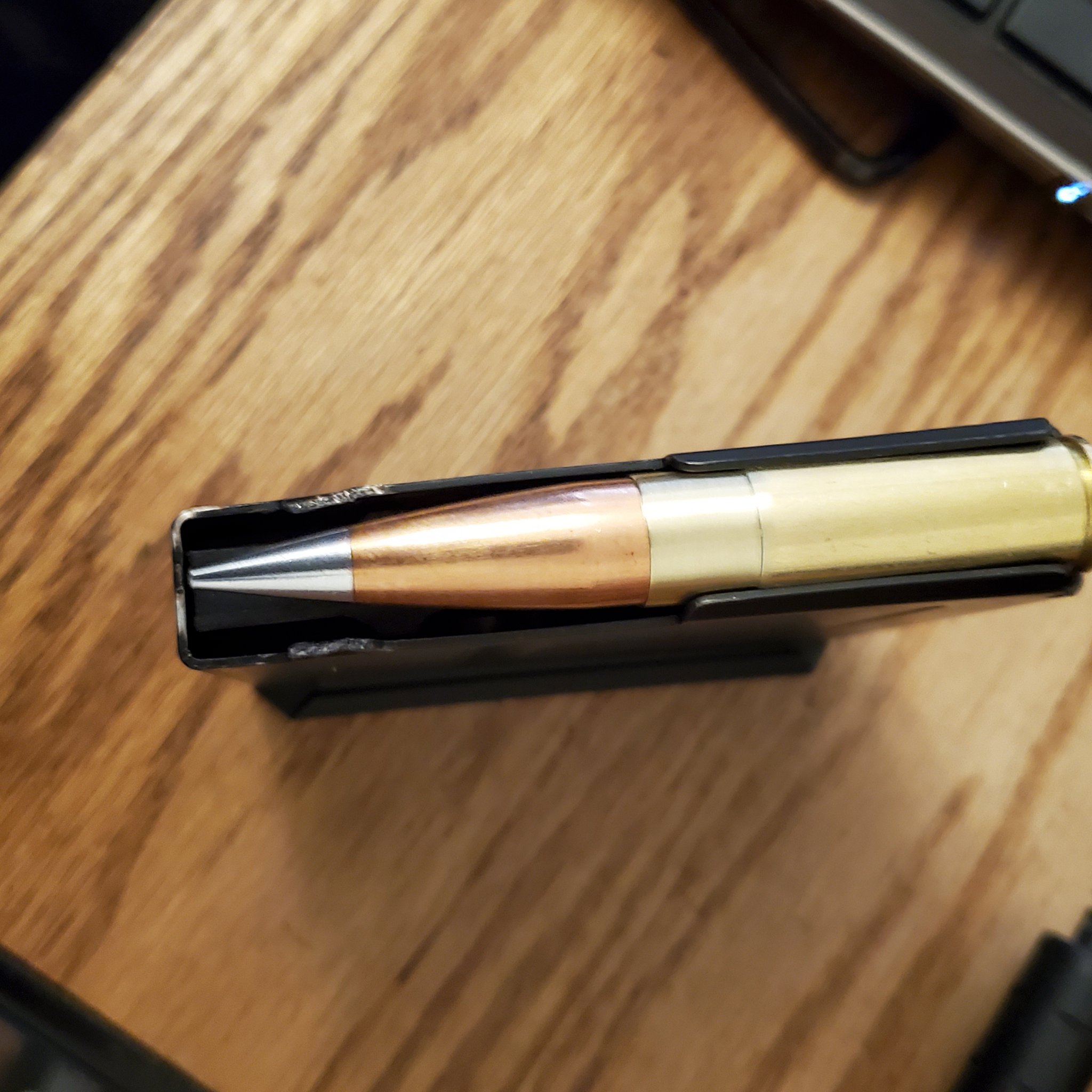

Got a pic of a loaded 1000gr round? Just curious what that looks like. The 8.6blk is crazy long at 350 gr
Nope, but they are in stock $2.72 ea.
Only a bit longer than the 750 Amax, with a huge BC, and 1002 grs. Will probably order a few just for fun.
Here are a couple of pics of the .510 Whisper 750 Amax 49.3 gr H335, compared the tiny 8.6 Blackout with the 350 gr Maker..big difference.
Maker also make a pointy 750 gr sub bullet for the 510 Whisper...may have to give that a try.
Just for your late evening enjoyment...
Get yourself a .510 Whisper, its very versatile.
Reactions: db2000

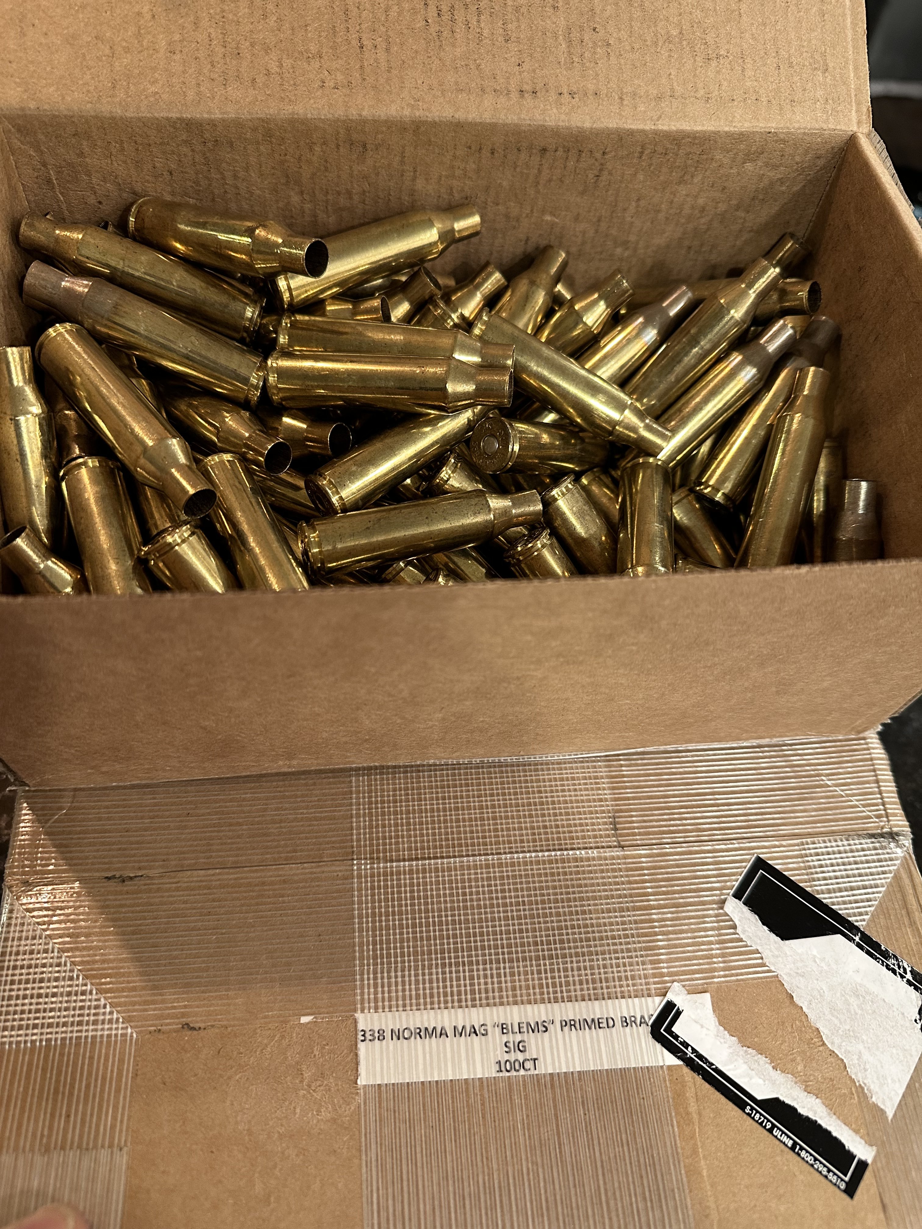

What brass are you using to convert?
I just bought a rem700 long action 338 a guy rebarreled to 510.
I use 338 Lapua but mostly 300 norma mag because it was on sale so I purchased 8 hundred and 2 hundred Lapua Mag.

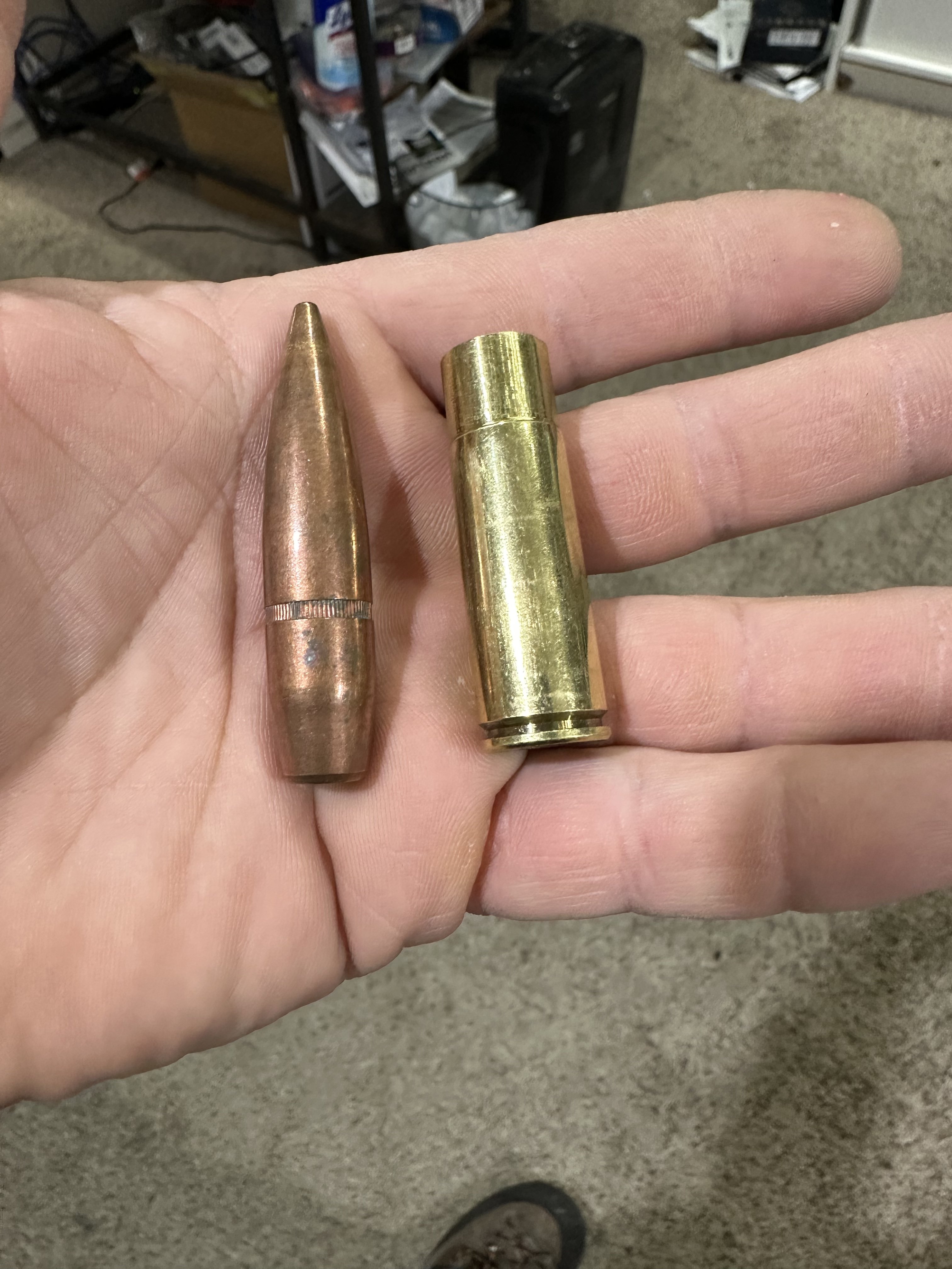

They look like this....the 300 Norma is almost perfect.
Reactions: sardo_67
No I'm not interested in selling any, but you can always ask.
My 300 Norma cases were a real buy, brand new for around 55 cents ea.

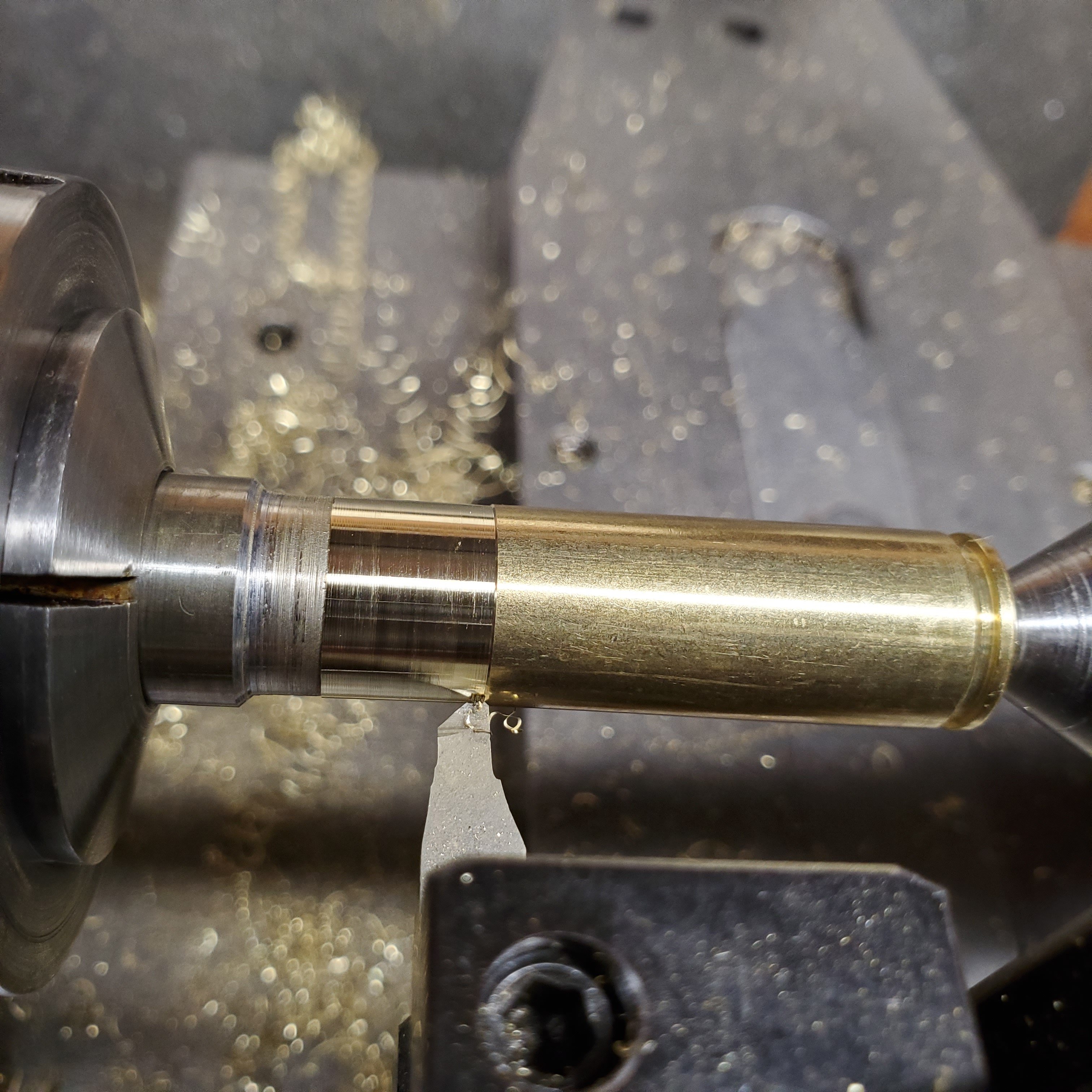

I already cut all 800 cases of the 300 Norma brass up into 510 Whisper plus 200 Lapua 338 L Mag cases.
I used machine tools to accomplish the task...so it goes much faster then with smaller hand tools...but still an amount of work to make 1000 510 Whisper cases.
The ones left at AR, the 338 NM with the heavy crimped warning $5 more per hundred, looked better than the ones with body scratches, like a few shown had been dragging across a concrete floor. Or order 1 of ea to see what they look like.

Ahhhhh ok I see. I have access to a full machine shop as well so it won’t be too hard for me.
Do you know if the 338 normal magnum brass can be converted? It’s currently 50% off
Reactions: 45-90
Yep, 338 Norma mag, 300 Norma mag, 416 Rigby, 338 Lapua mag brass can be converted to 510 whisper....all are based on the old 416 Rigby case...but may have slight differences in internal capacities when fireformed...

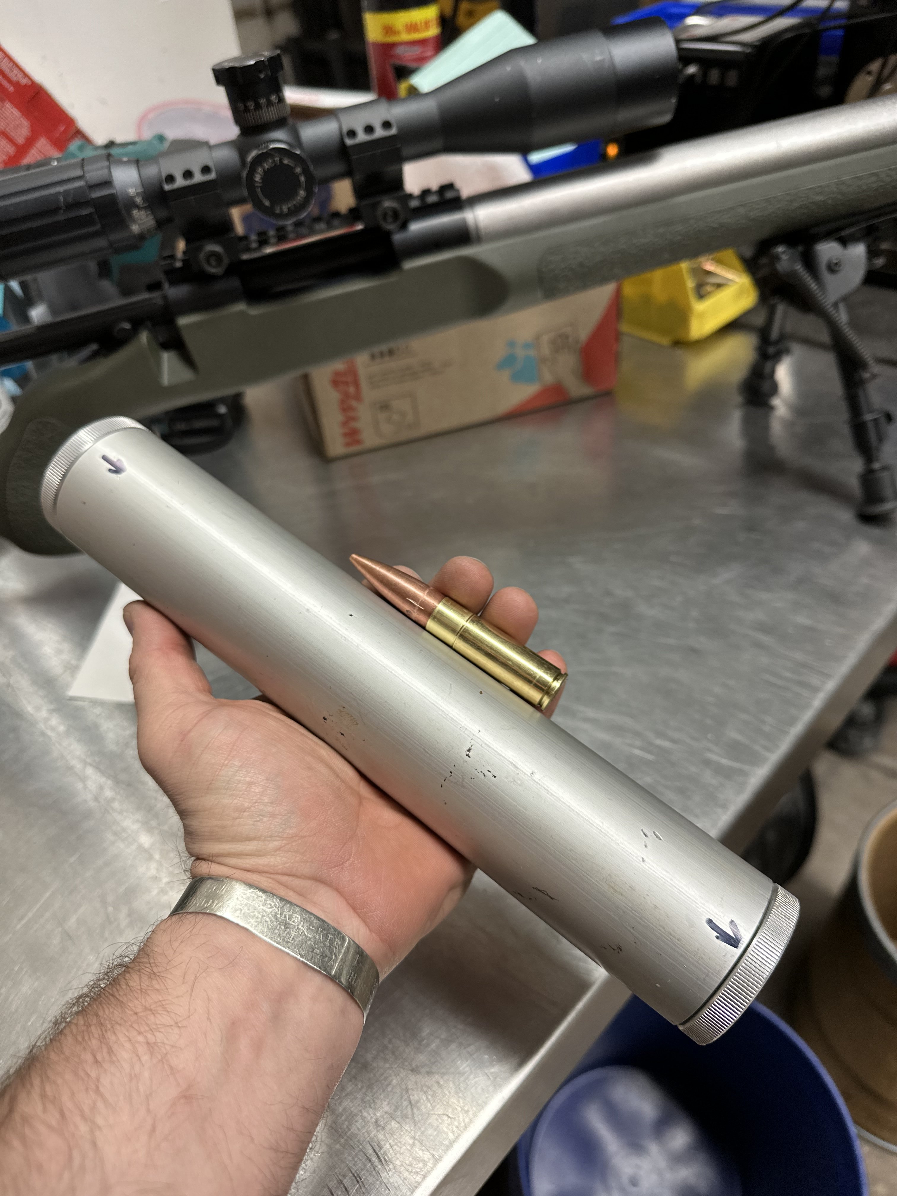

Did the form 2 on a NAPA fuel filter to start the can and made a dummy round.
I had a thread a while back asking if .510 was considered a bottleneck cartridge because of the shoulder.
