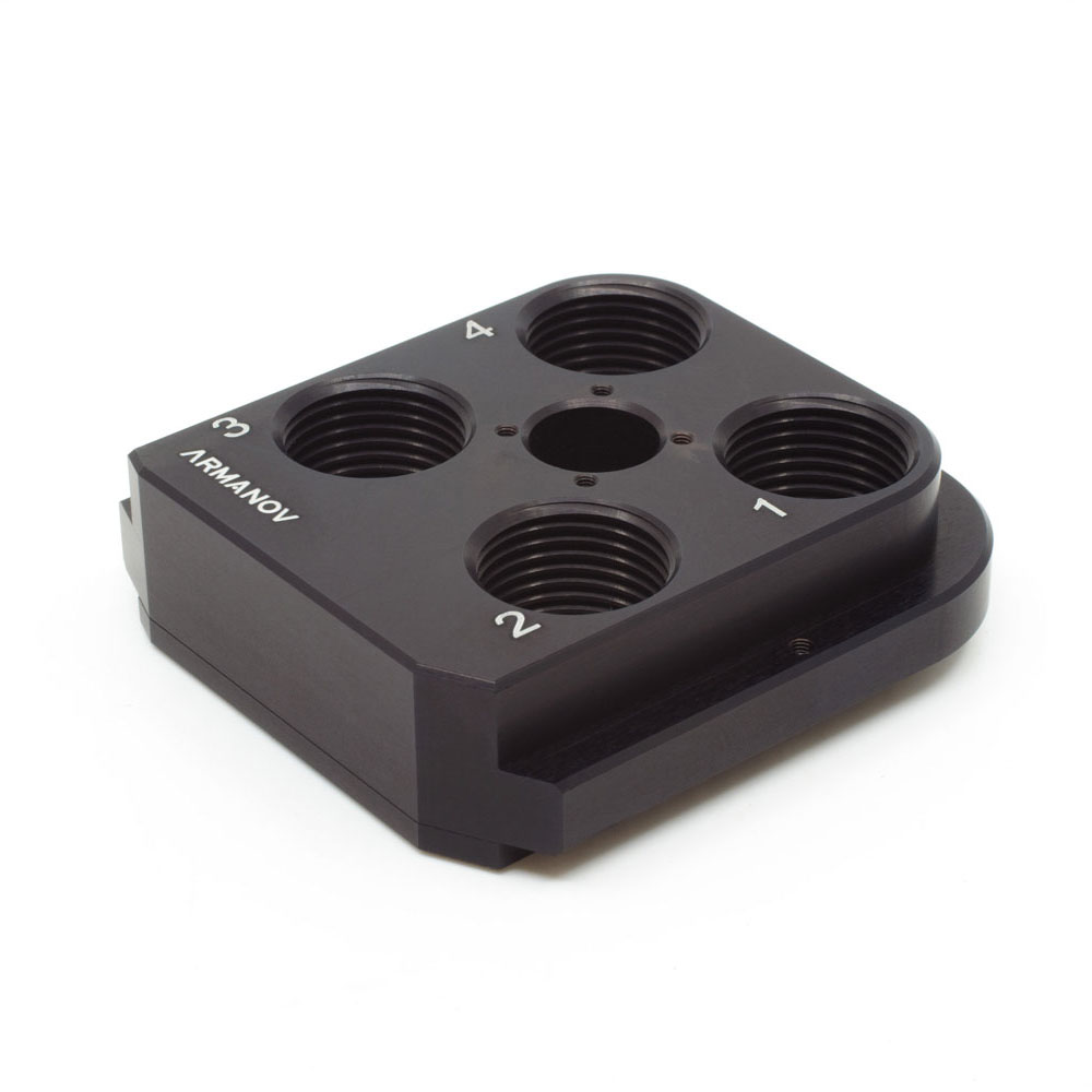

The whidden toolheads are nice, but only float two stations (and you don't get to pick which two). The non-floating whidden heads are nicely machined as well - I don't notice an appreciable difference in performance between the whidden floating head, and a non floating head with a #17 o ring below the lock ring.

Are all the whidden toolhead and bushing upgrades to remove toolhead play better suited for the 550 or does it not matter at all if installed on the 750? The manual indexing on the 550 is a bonus to move the case in either direction but the extra station and case feeder on the 750 could be useful for case prep and then loading on a 2nd pass. With either press i will be hand priming and using a funnel to drop powder measured from my RCBS chargemeaster. So in short, can the 750 produce the same quality round as the 550C with the uniquetek upgrades?

Whidden tool heads are crap. I bought several and they were wildly out of flat. I had to take them to a local machinist and have him skim cut the upper surface so they wouldn't rock in the press. The free float thing is cool, though, so I converted my Dillon tool heads to floaters. It's super simple to purchase the correct size roll pin at the hardware store and stick one on any station you care about. I found some aluminum die nuts (or whatever they're called) that were wide enough to let me drill a matching hole. Too easy.

Finally, I tried the business of bolting the tool heads into the press instead of just using the locating pins that come with it. I could not see any difference in the tolerance on seated rounds. If I don't have a cartridge under the sizing die (the last two rounds of every session), it'll seat the bullets 0.005" too deep. If you run a micrometer seater, it's easy to just back it off 0.005" for the last two. The tricky part is remembering to set it back when you're done. :rolleyes:
