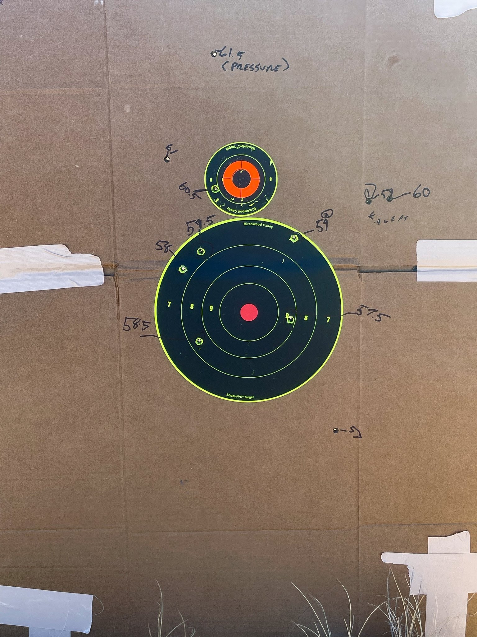

Did my first single shot ladder test in a long time. Am I safe to say 60.5 is the middle of a node?
Caliber: 6.5 RPM
Powder: 7828 ssc
Charges: 57-61.5 in .5 grain increments
Primer: fed 210
Case: Weatherby
Book max; 61.2
Distance: 580 yards
Wind: 20-30 mph gusts. Mostly tail wind
Upper and right 59 was my sighter shot

Hmm windy conditions doing a ladder makes this a bit hard.
You can try it again with better conditions or stay with what you have. With the last option, I would look into 58-60.5 area.
Reactions: diderr
It all looks promising in that range. 61.5 gave me a plunger bur. Everything below that was all golden pressure wise. And if 7828 is as sensitive to temp as they say I’d rather stay lower. This is a hunting rifle and probably won’t get shot much above 70 degrees ambient temp.
Yeah, you need to stay a little below pressure in your gun.

Kinda loose and hard to say. Probably too windy.
The waves start at 59 and go to 61 when you imagine the vertical uncertainty of any three steps in a row. I would keep trying.
Suggest what was said above, or repeat with finer steps in less wind. Good Luck.

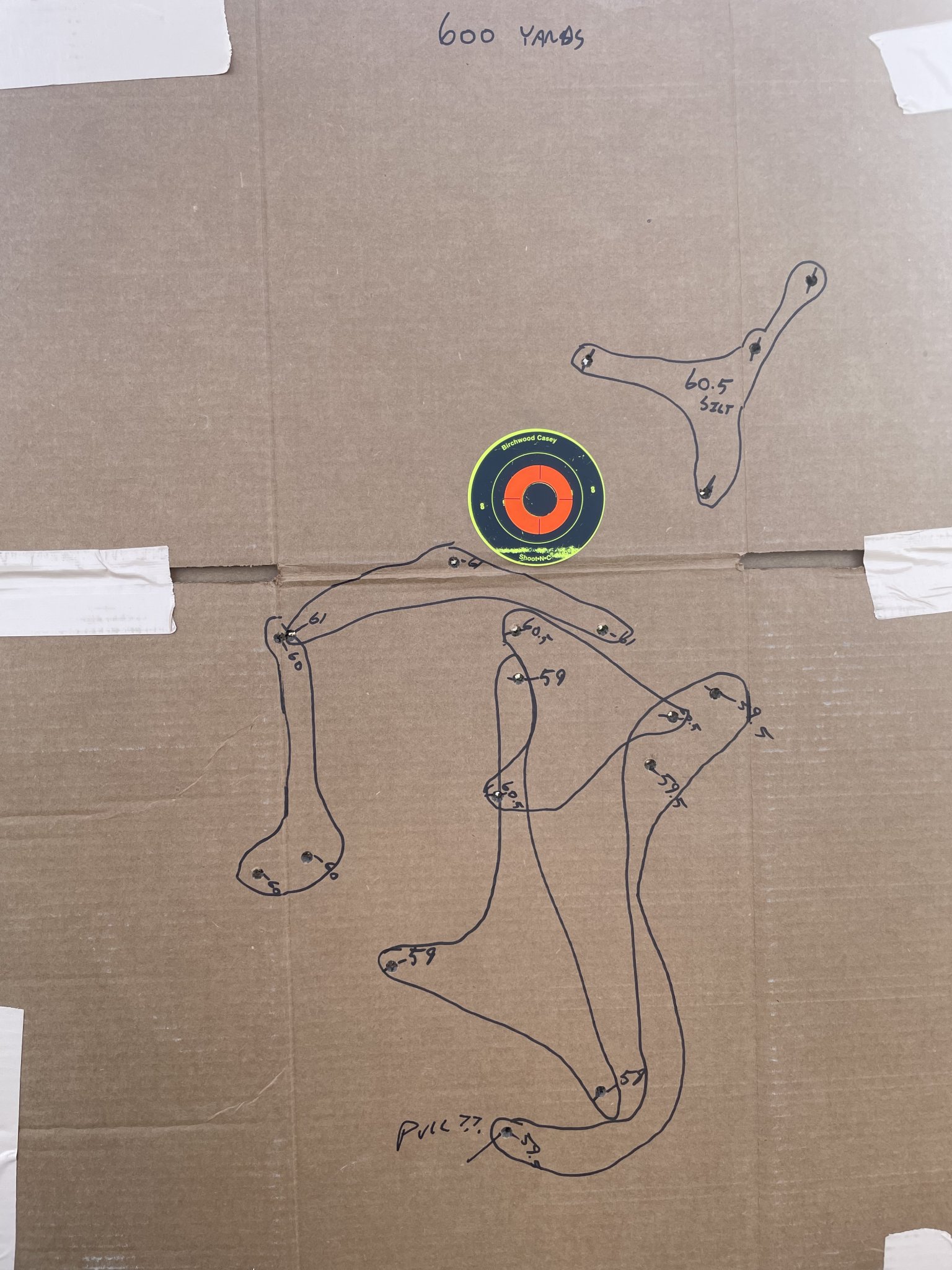

I did 3 shot groups at 625 yards today. 59, 59.5, 60, 60.5, 61. I used 60.5 as my sighters moved my scope down and left after the upper right group. Both groups with the 60.5 yielded .6 moa. ES was 10 at 2,948 average. My 1 shot ladder was trying to kill 2 birds with one stone. Give me a safe pressure window and maybe give me a hint at what to look at.
I decided to stay with 60.5
This is a hunting rifle and .6 Moa off a bipod and rear bag is plenty for me. These are loaded at max COAL for the mag. I can easily visit seating depth next
I’ve been chasing a load for this gun since I’ve had it. Started with us869(horrible powder) then sourced 4 pounds of the 7828. With the barrel life of this round is like to get some good practice and a few animals on it 😆. I have a 28” proof waiting then it will become a 6.5-284
