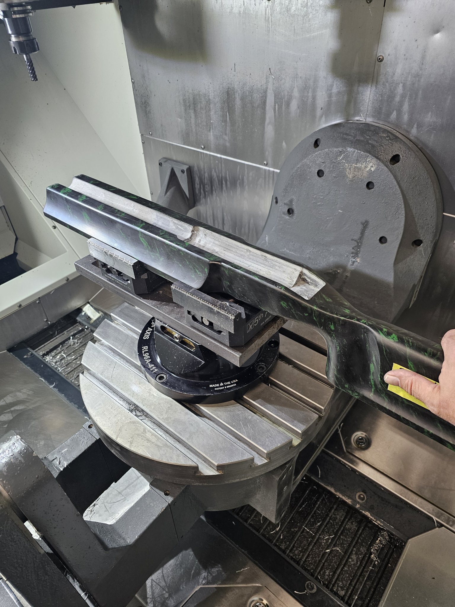

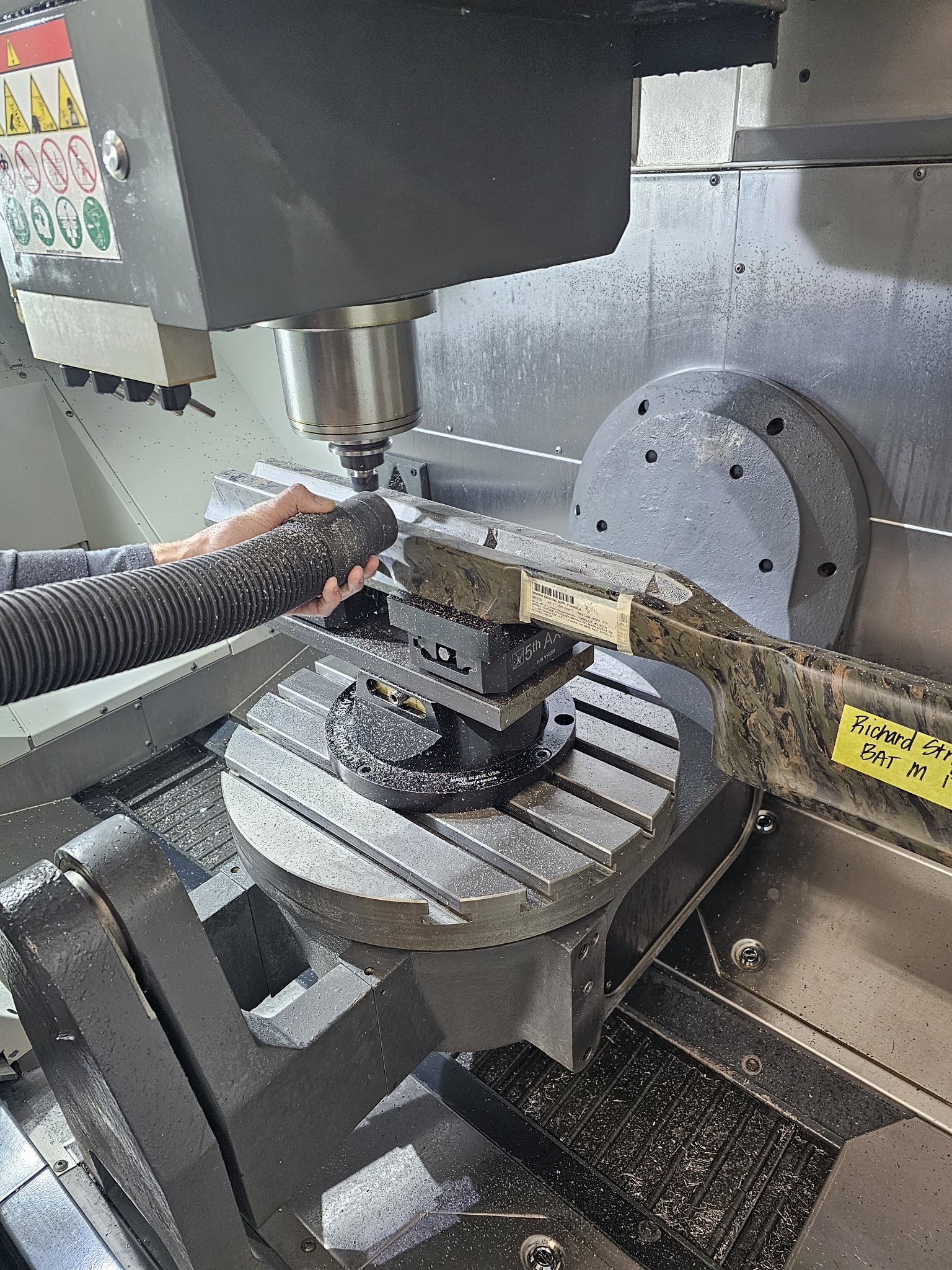

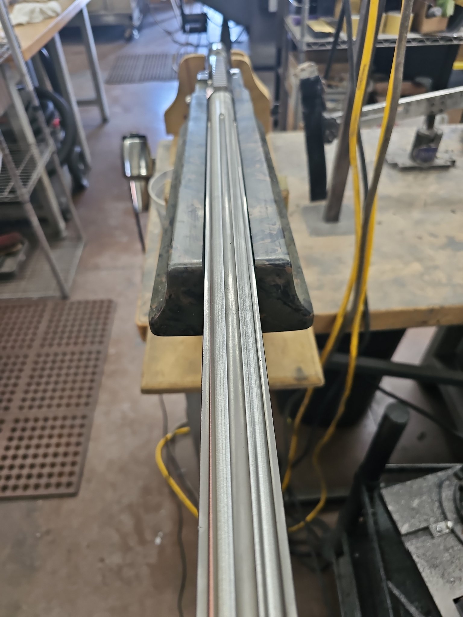

    The dern thing wouldn't fit in my usual workholding so this. . .
    50 cal stuff.
    Now I want another 5x because setup is the shizzle.

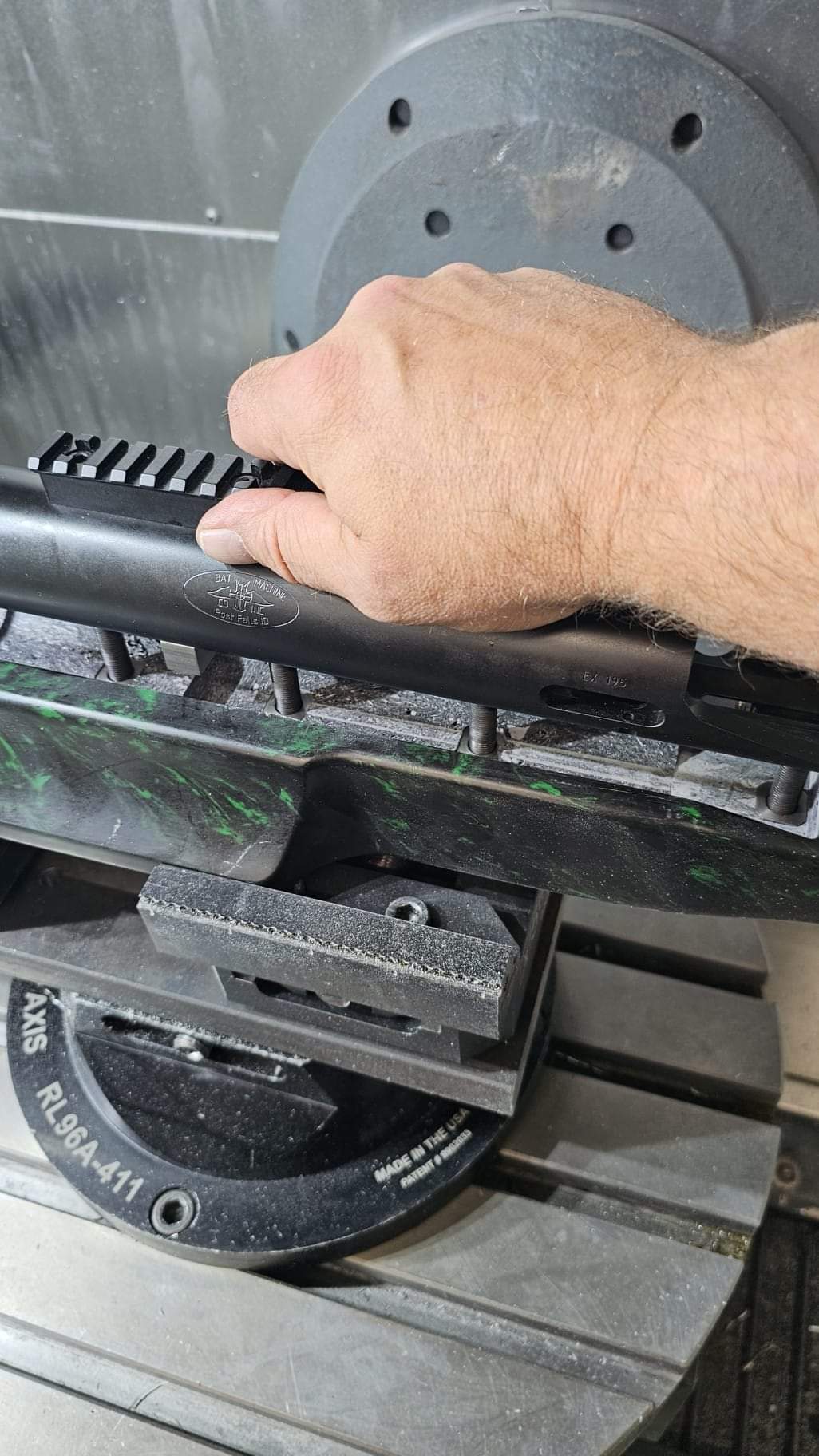

    All done with that one. Now for the encore...

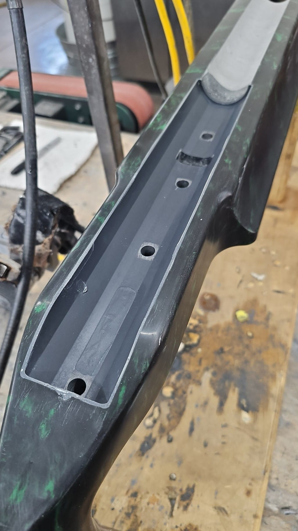

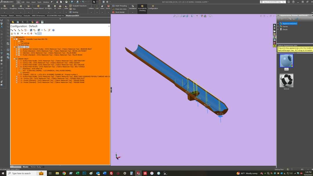

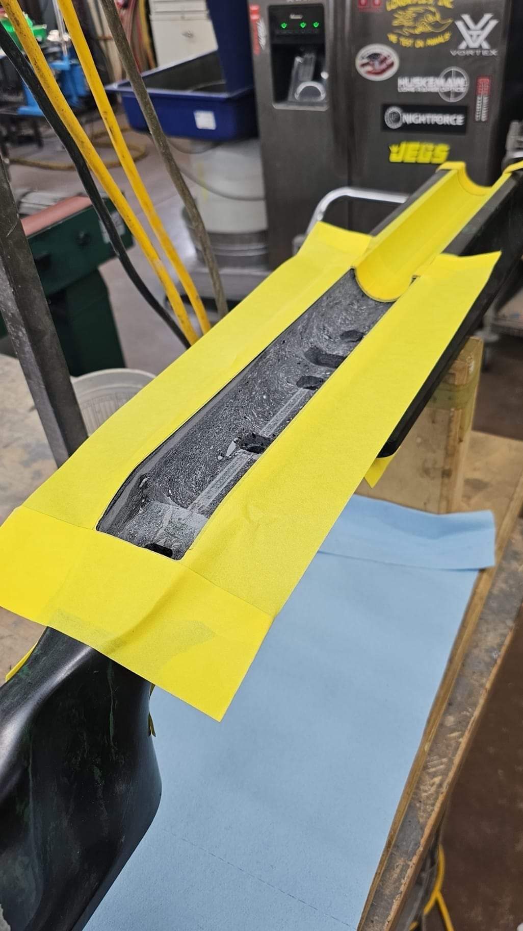

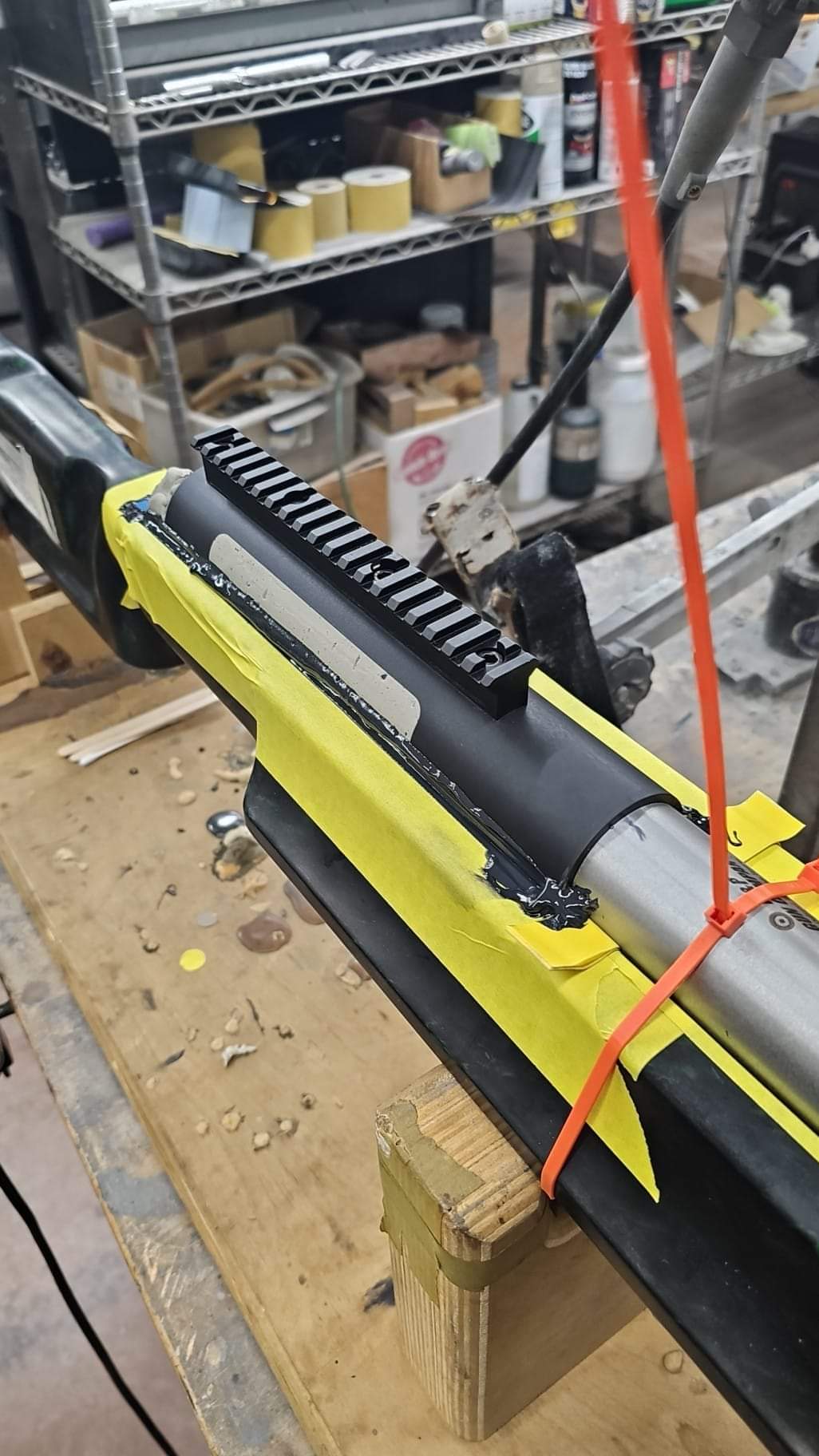

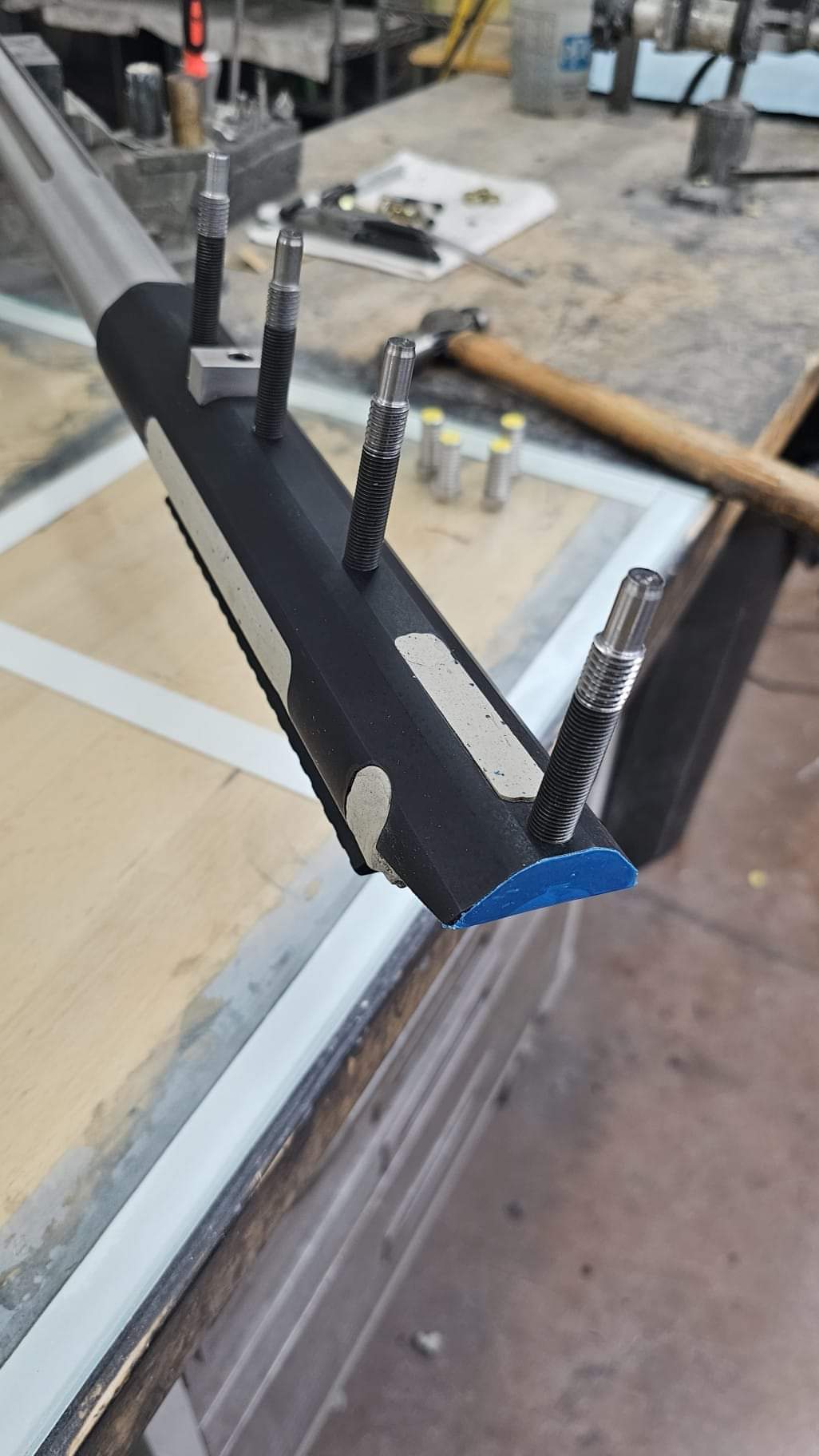

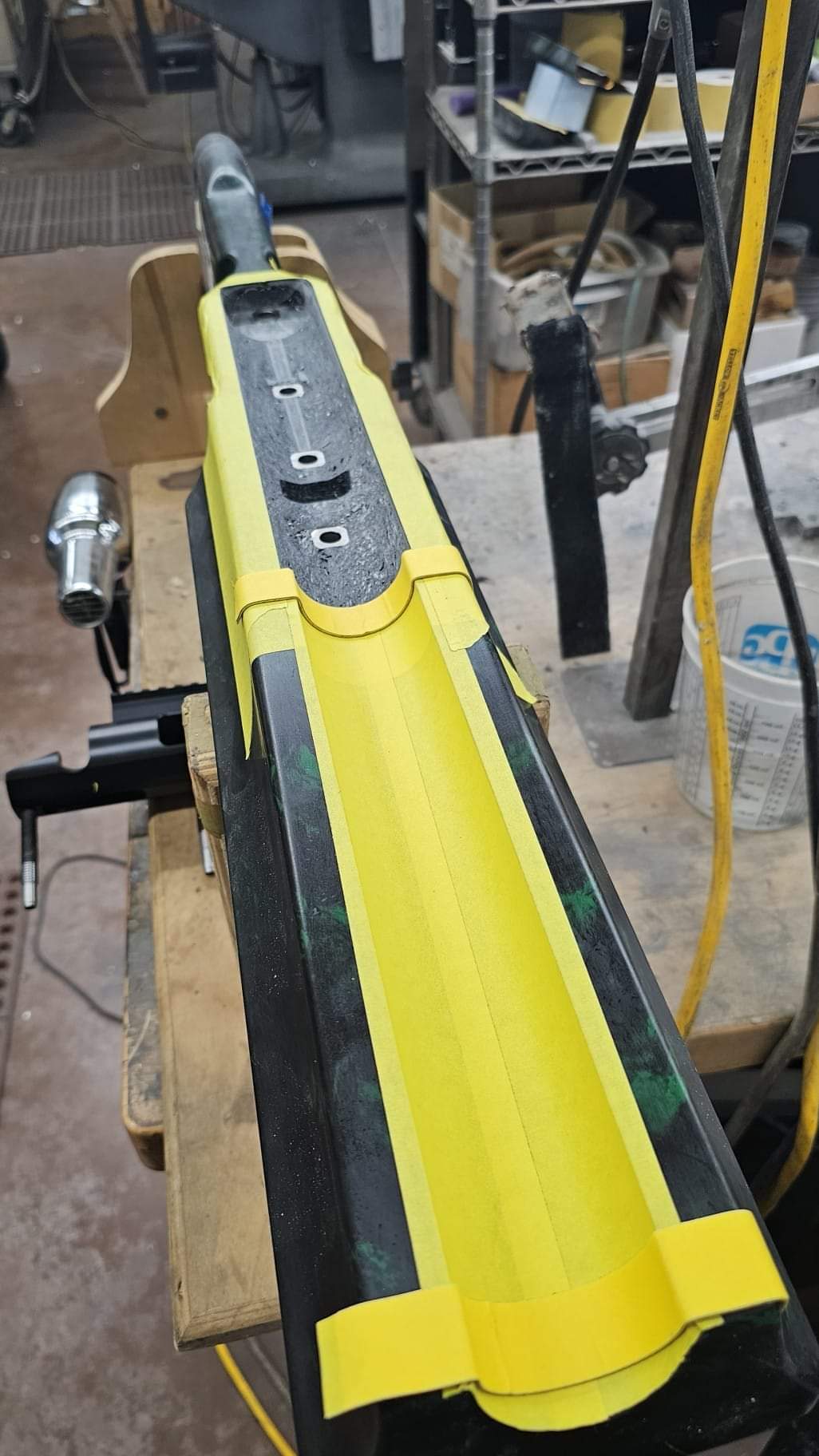

    The encore:
    BAT 50 was today's project.
    Inlet n bed. It's going to "cook" overnight.

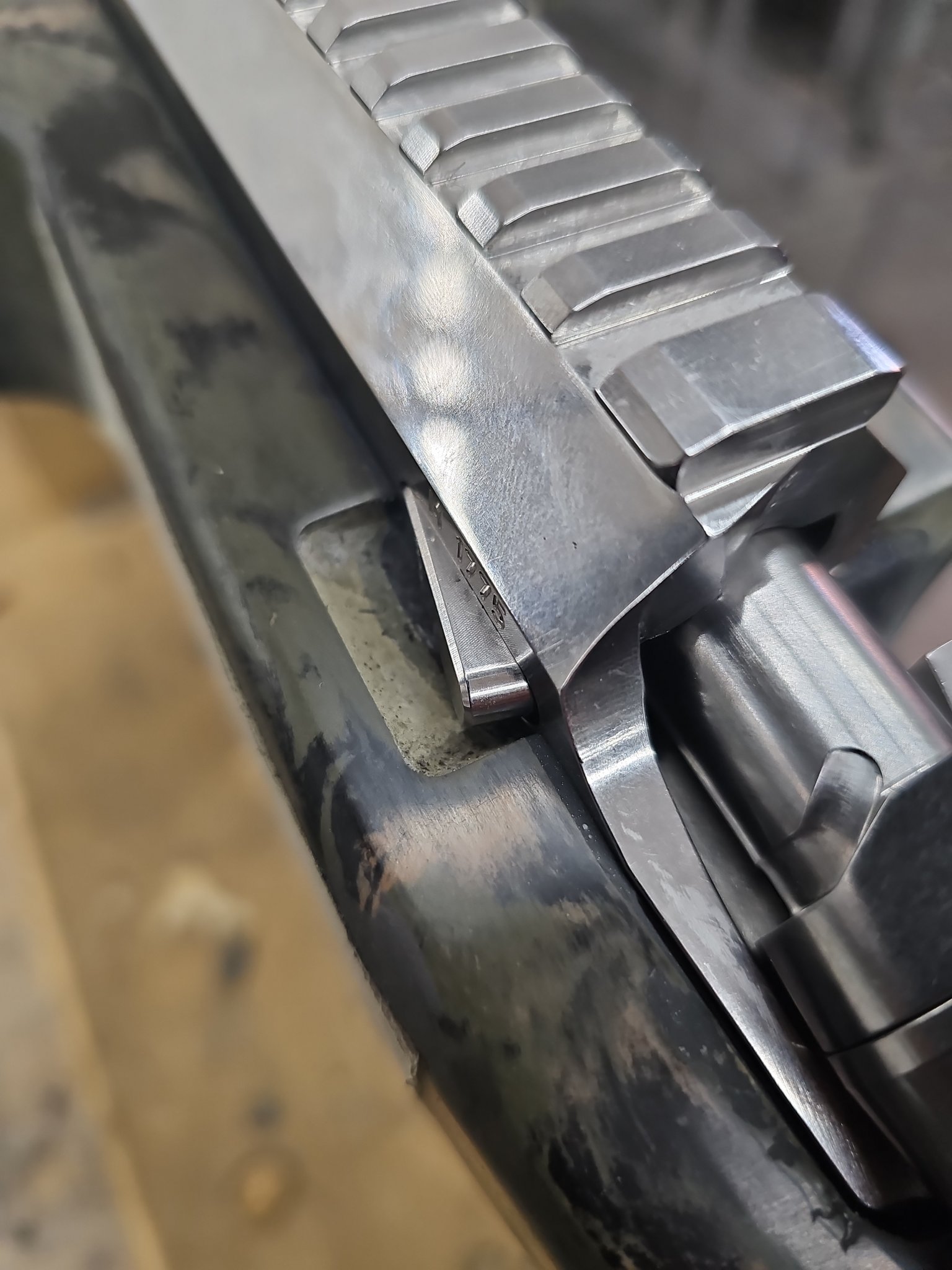

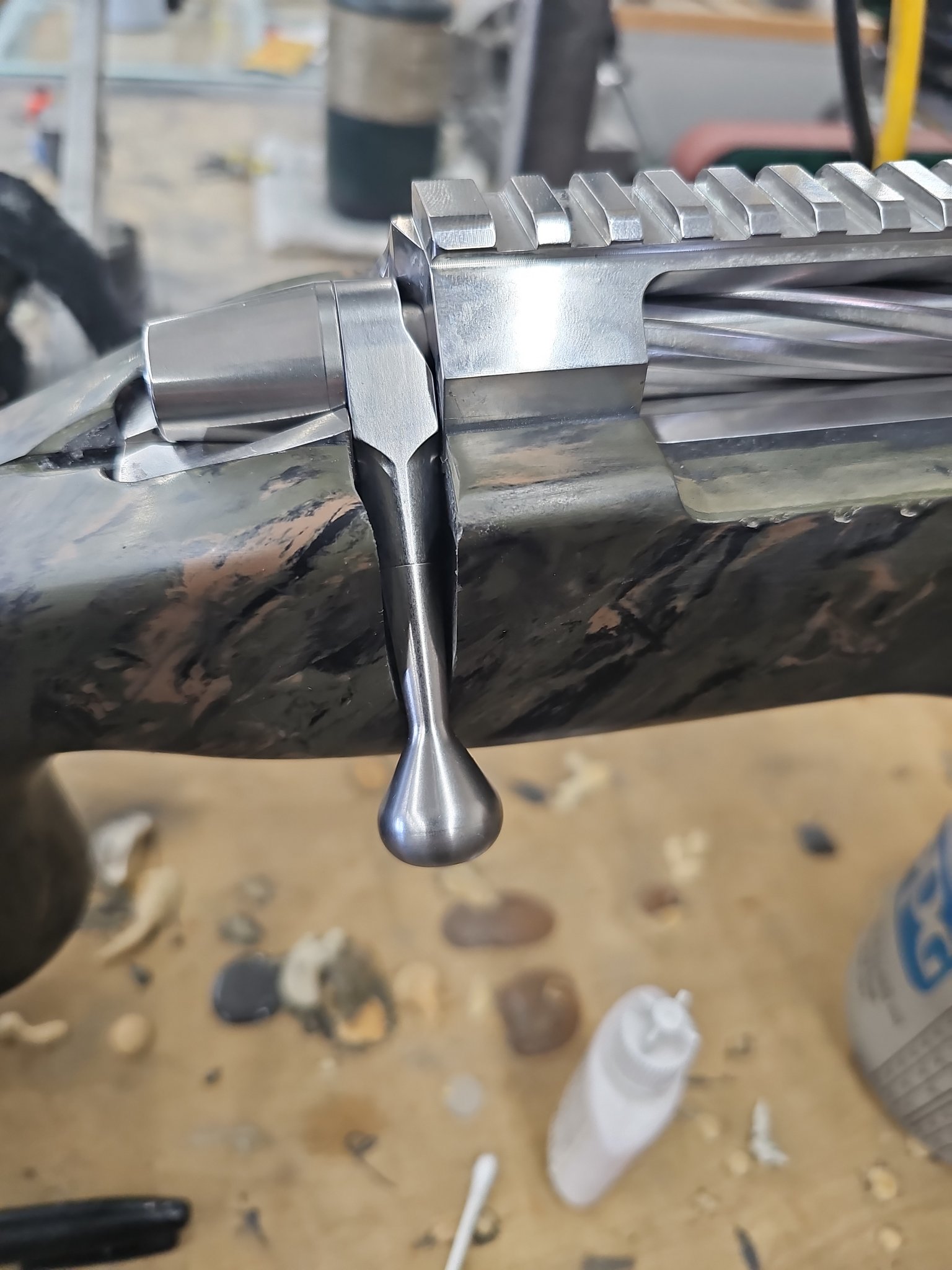

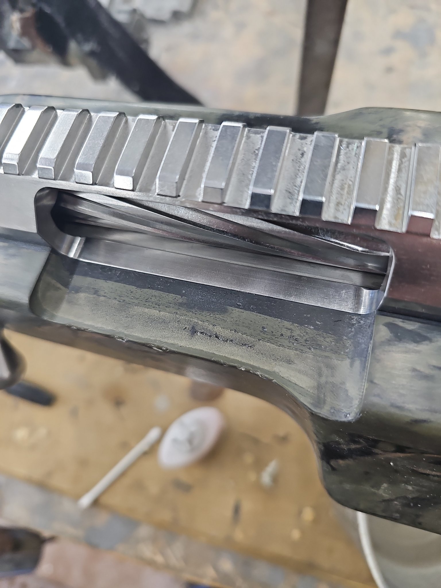

    Nice work. That rear tang fitment annoys me way more than it should. Old McMillan stocks or new ones ?

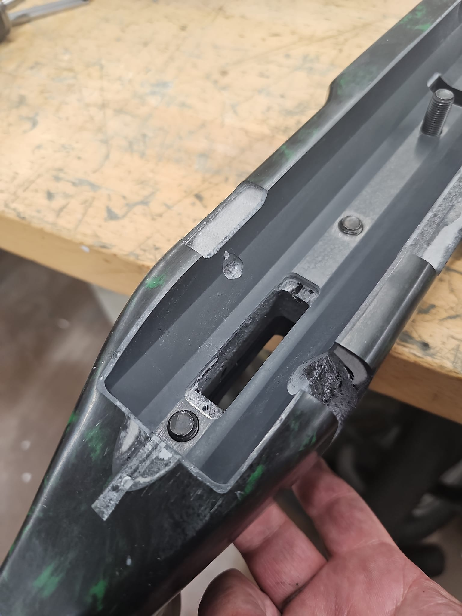

    This is all client-supplied stuff and no paintwork on the exterior, so it is what it is. On the first gun, it's a 300WM plopped into a "railroad tie" sized stock so its not surprising at all that the tang is buried a bit. When I encounter this I finish the tang the same way I do on a Palma Rifle. Machine a clearance feature around the tang and the channel that the bolt runs through.
    Reactions: iceng and Balor

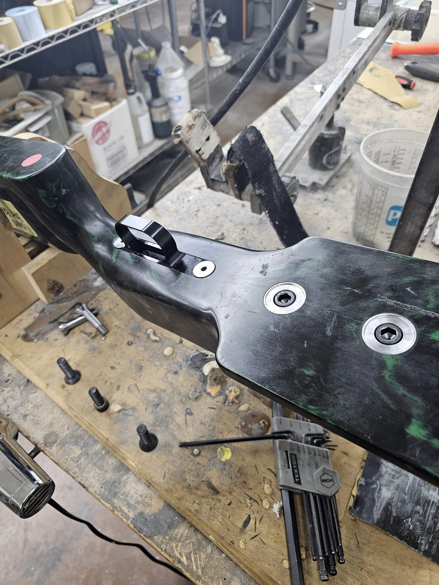

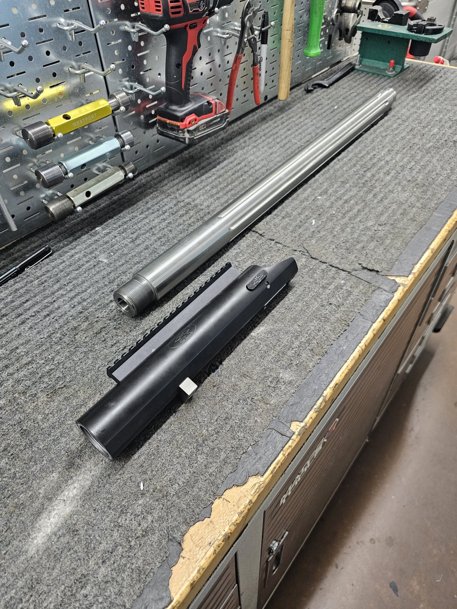

    "Fitty Kal" stuff:

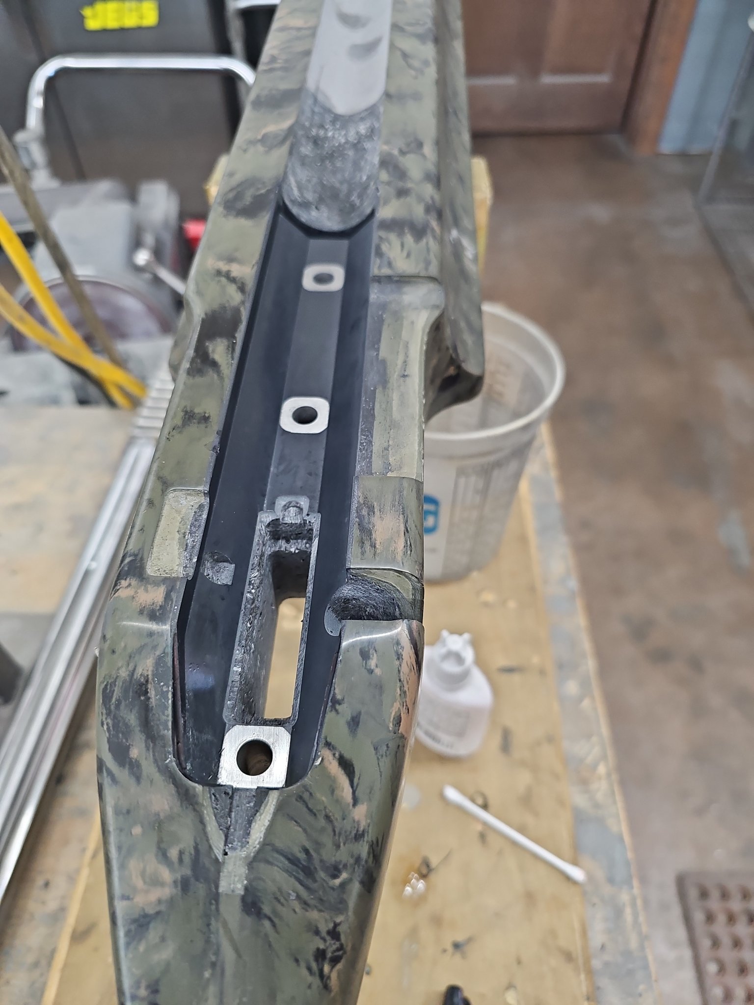

    Right after bedding:

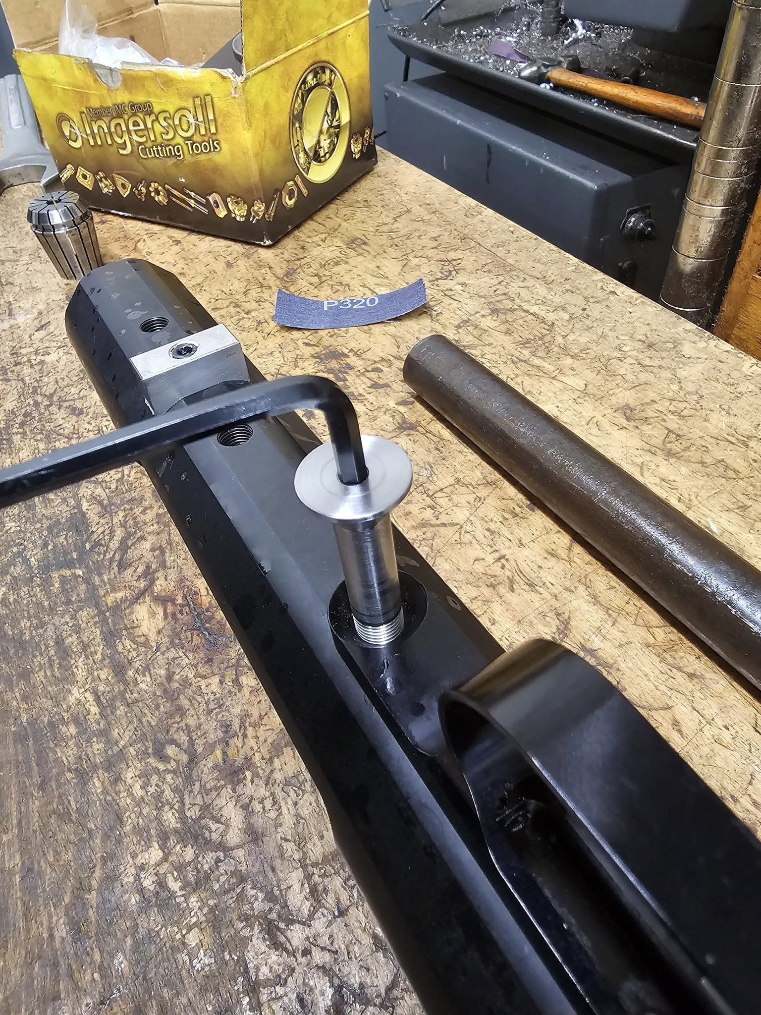

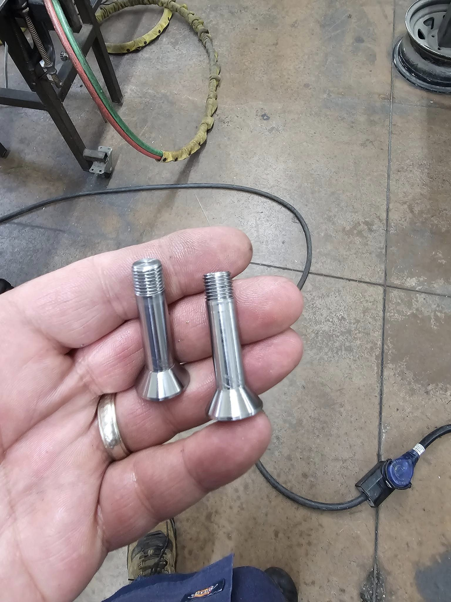

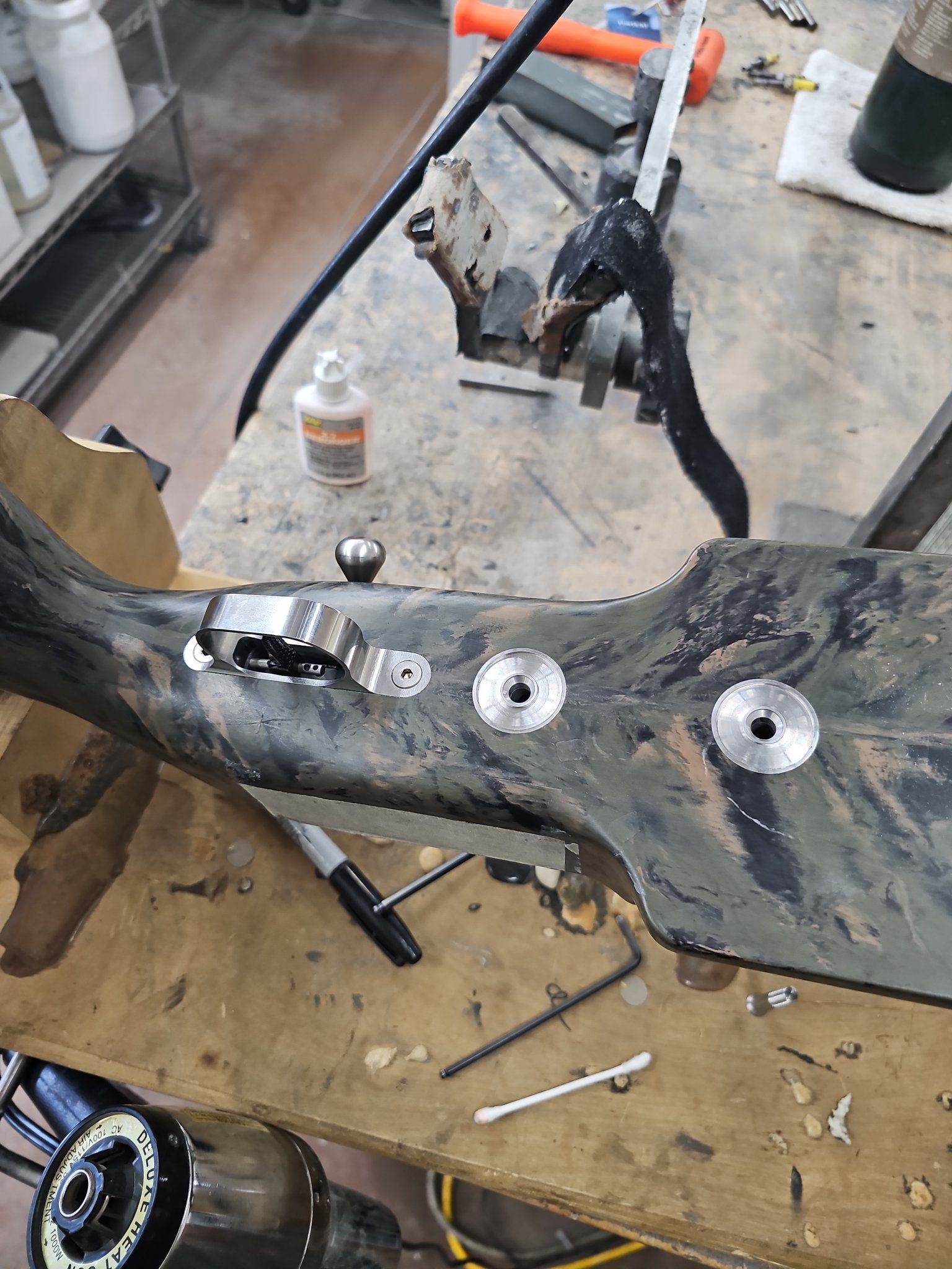

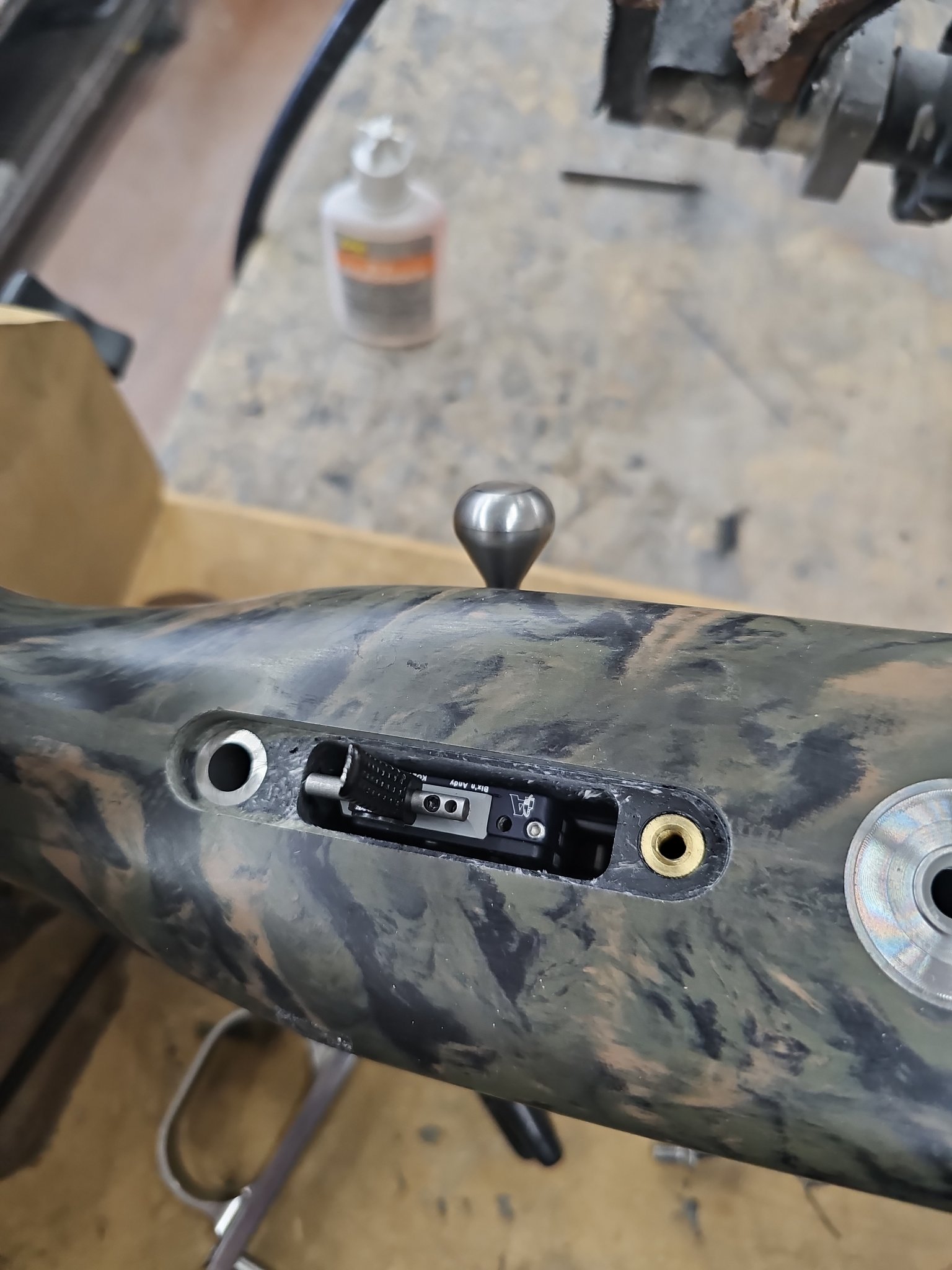

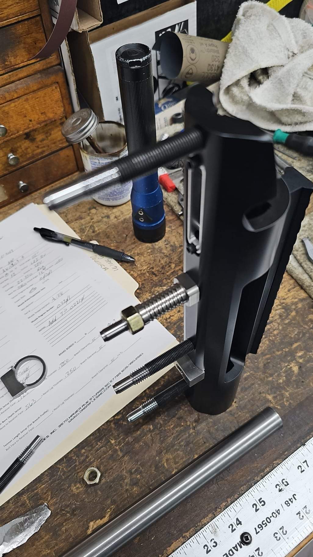

    Post bedding inlet work. Dern trigger guard screws are too short.

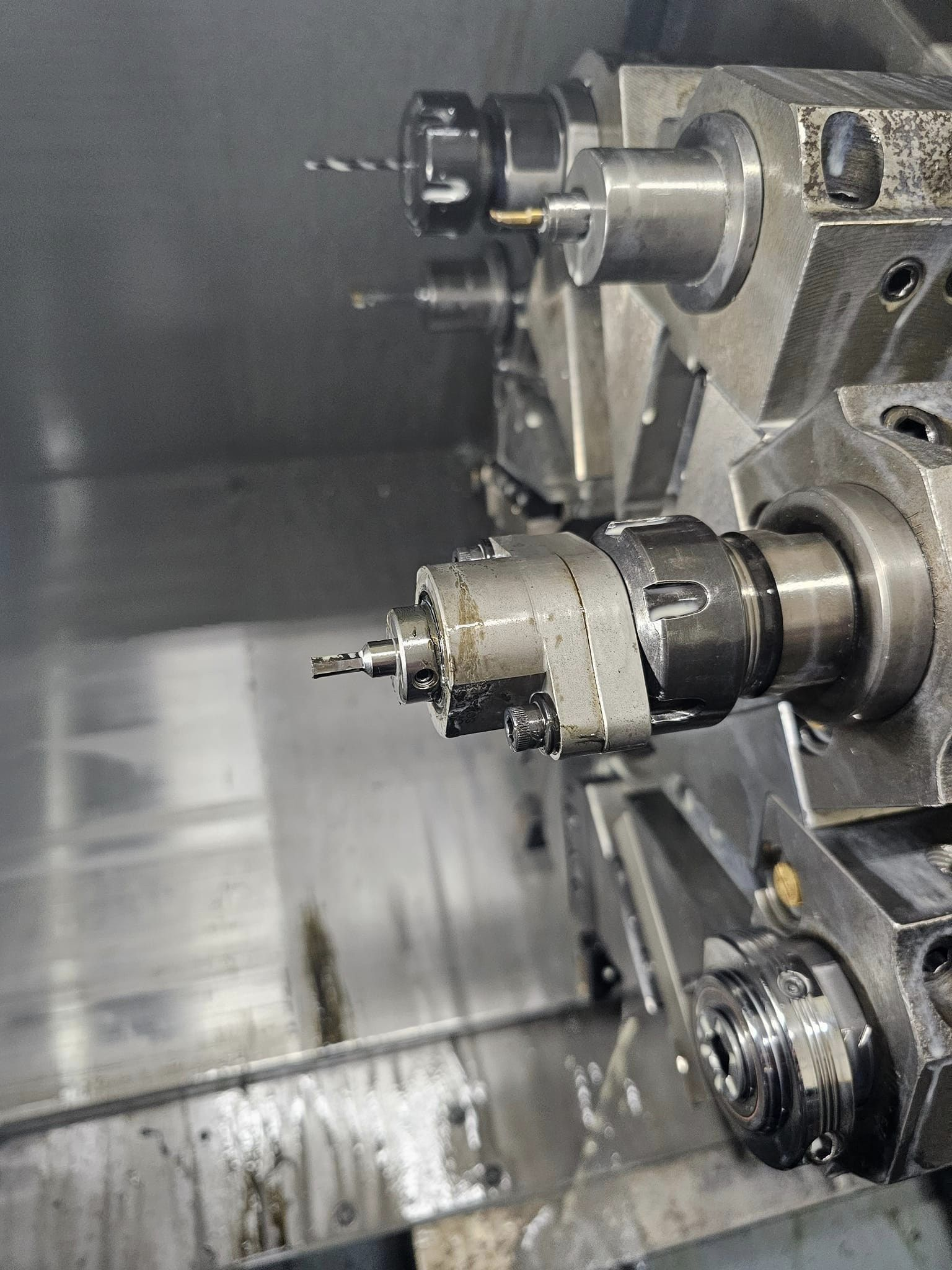

    Nobody in town has anything even close so....fire up a spindle and make some.
    Rotary broach for the allen key socket:

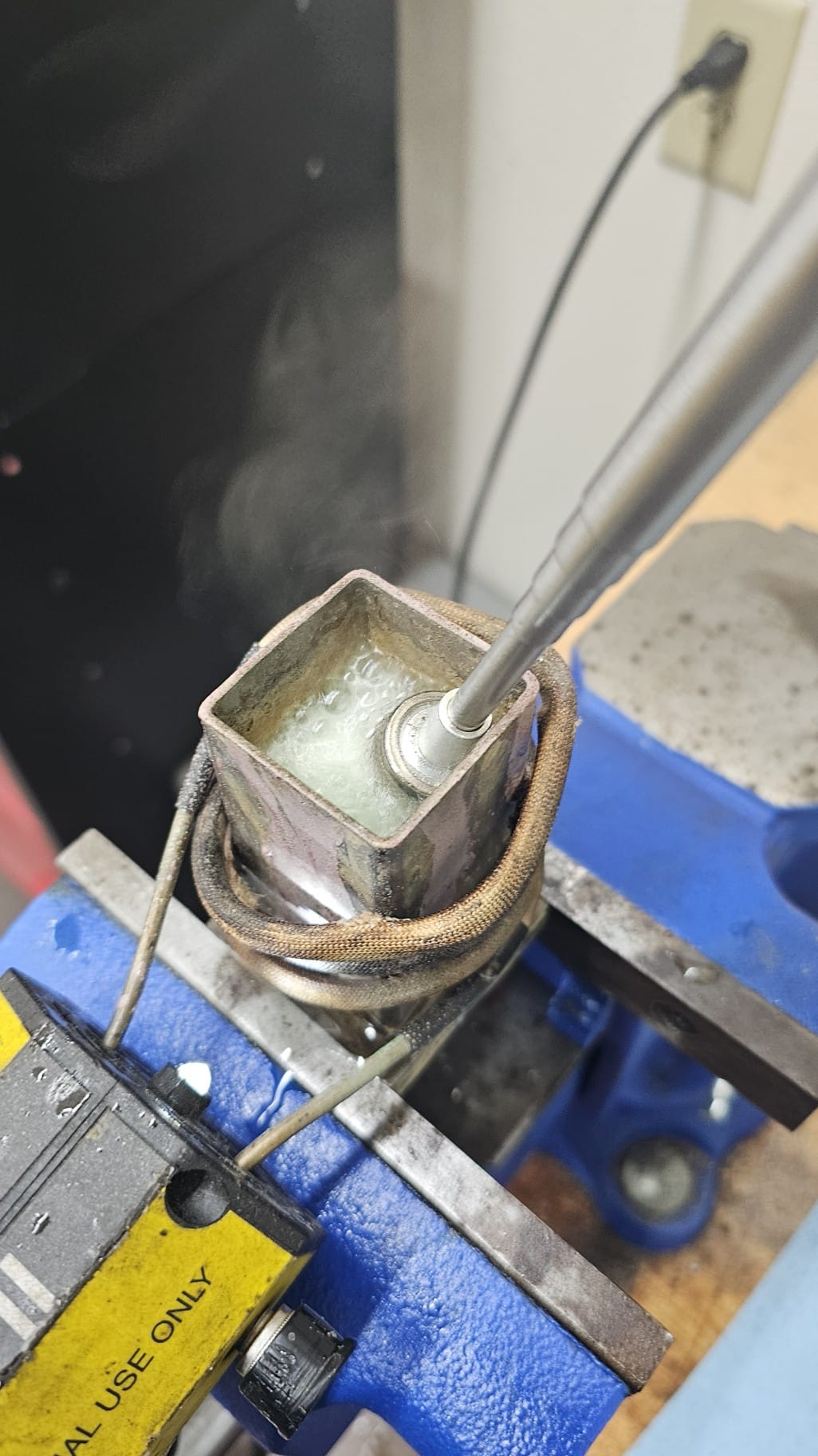

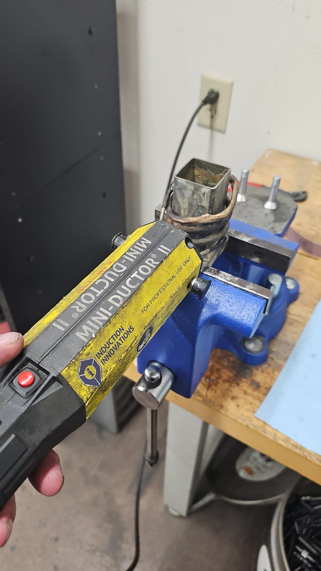

    Warming up some park solution with an induction coil makes quick work of turning a screw black.
