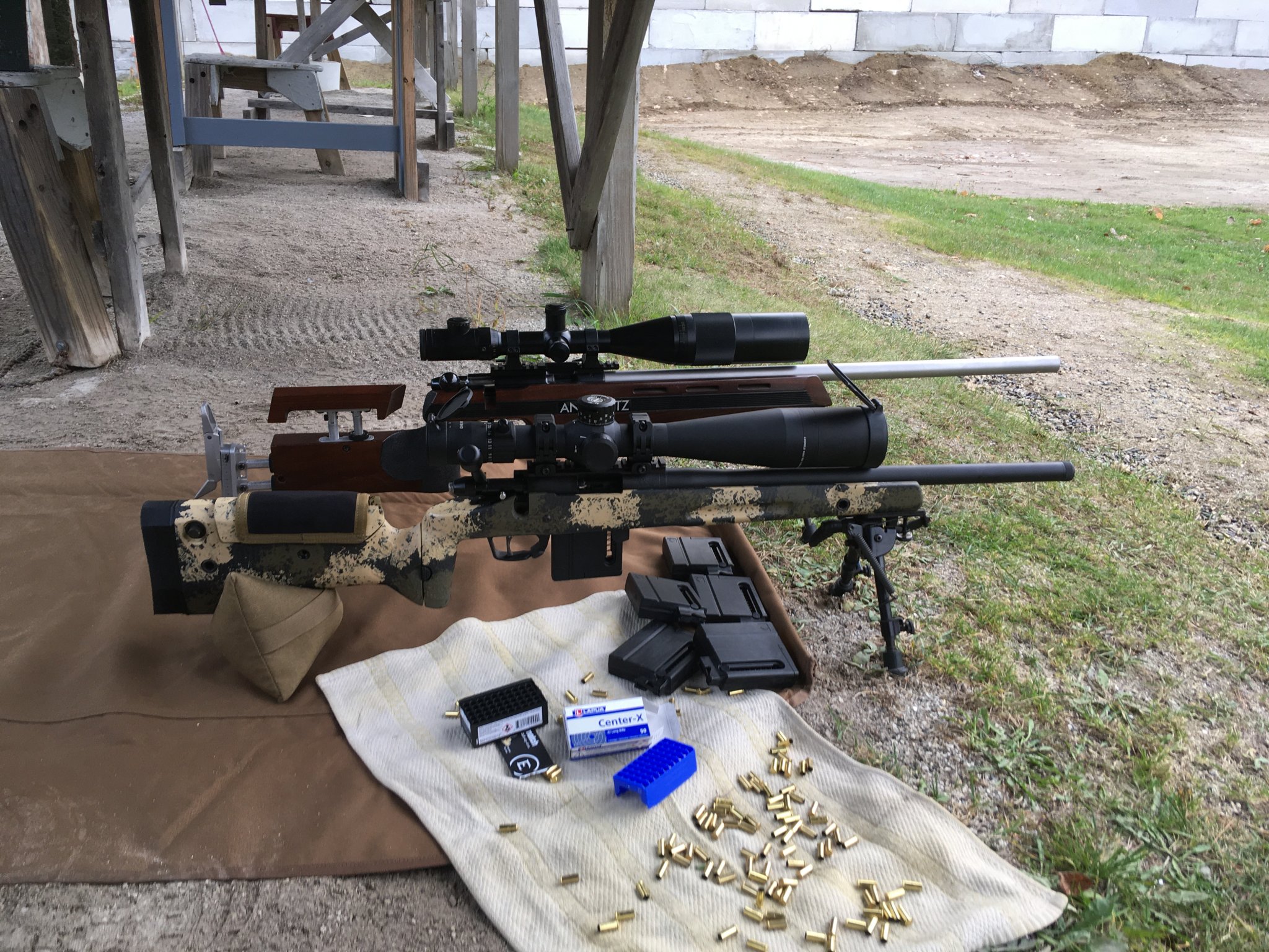

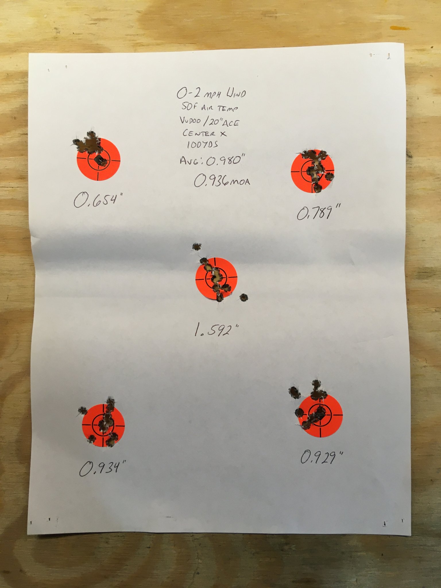

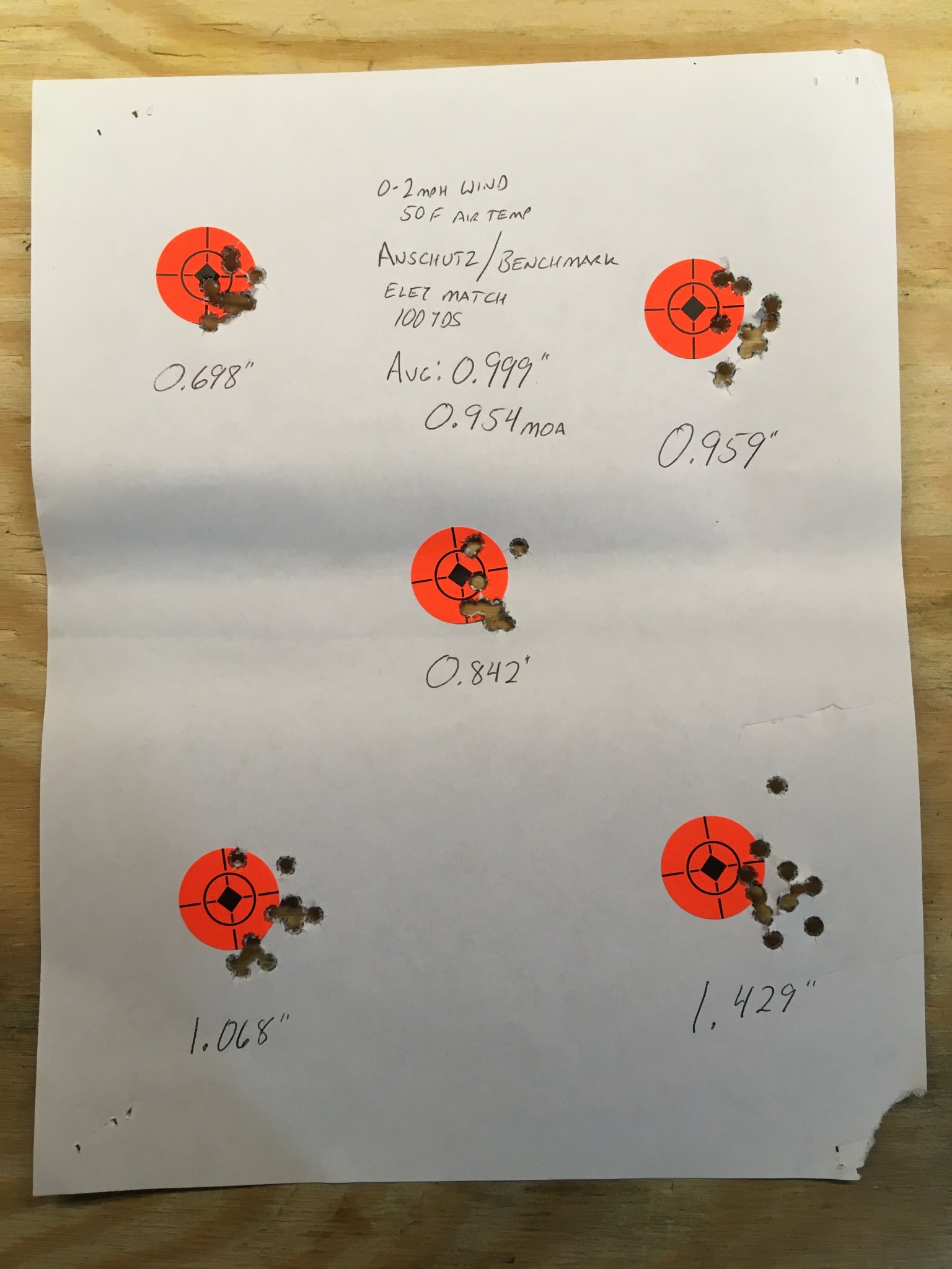

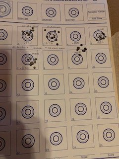

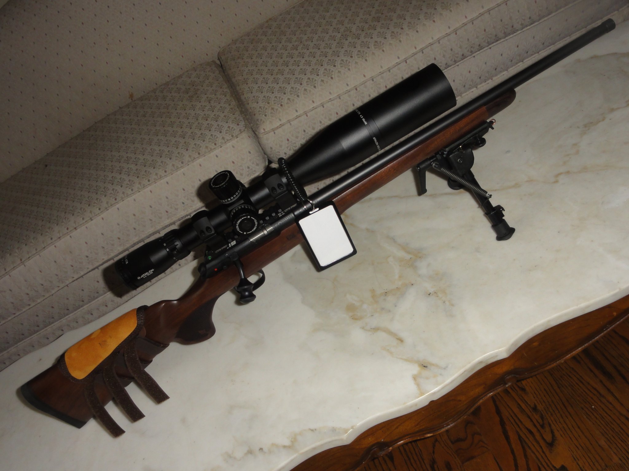

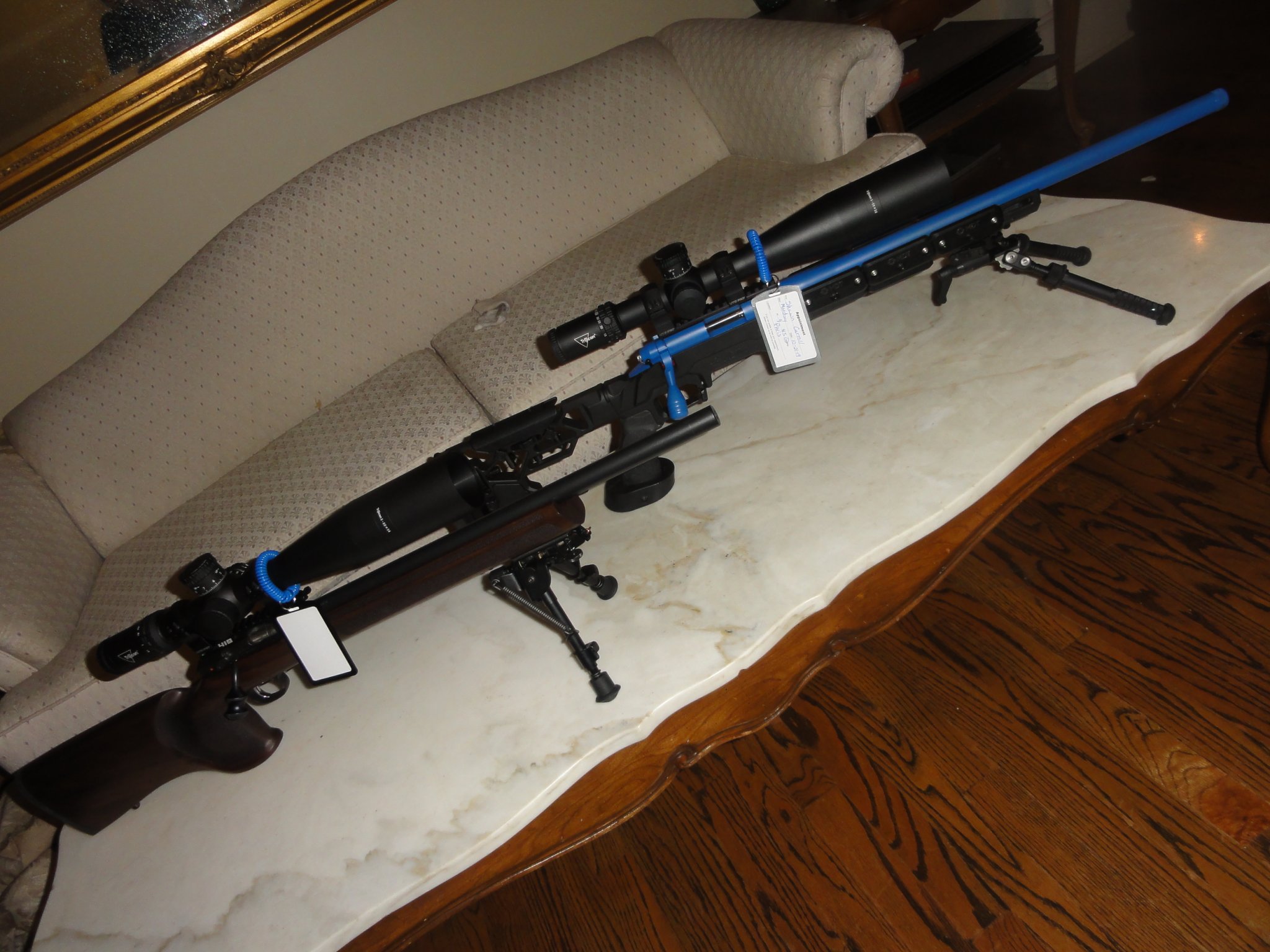

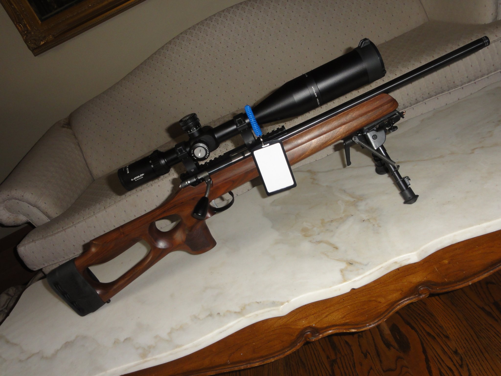

    Here is my submission to get this started. I shot it with 2 rifles today and it was pretty hard to hold it together for 50 rounds never mind 100 rounds. The conditions were pretty good today with light winds that were mostly calm, but I think I may have been caught by one or two sub 5mph gusts. I feel like I can do better, it is funny how my first group of each target (the top right) is considerably better than the rest. Fatigue definitely plays a role in this challenge! I did not rest between groups, I shot both targets in less than 30 minutes total including loading magazines! I also feel like sub 60f air temp 22lr looses its cutting edge accuracy, so there is room for improvement there too (but here in Maine I don’t expect to have a chance to shoot in 60f or higher temps for at least 7 more months...).
    First up is my Anschutz that has a Benchmark 15t 3 groove installed by Mark Penrod:
    Next is my Vudoo V22 with a 20” Ace:

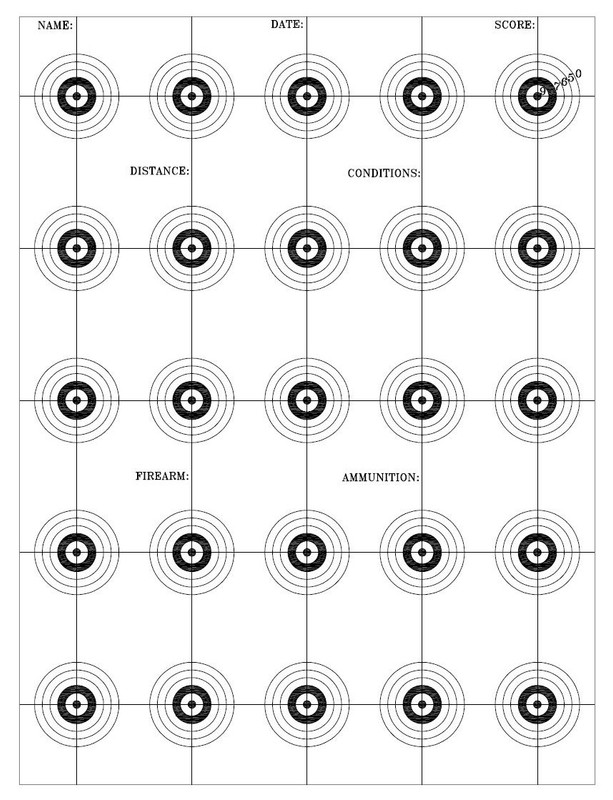

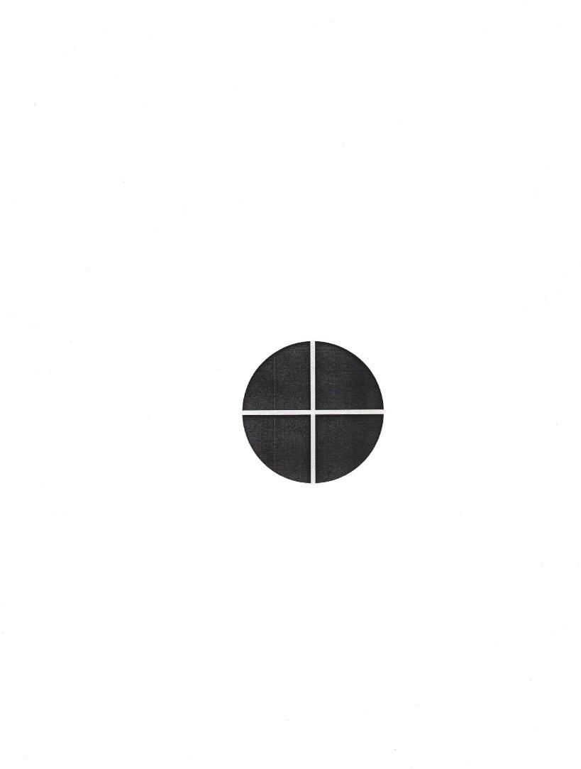

    Score is 10 down to 5 with zero for anything outside the 5 ring.
    Best edge scoring
    Download, open, print actual size 100%
    Exterior border measures 7.5x10 inches as a check
    Center dot is 0.10" diameter, each ring is 0.10" larger
    5 ring is 0.55" diameter
    No, it won't be easy, basically a 1 moa scoring zone for each shot.

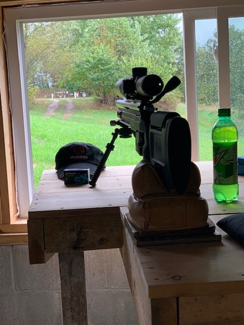

    A couple of questions. First did you use a rear bag in addition to the bipod as the support system? Or was it a bipod and your shoulder as the support system?
    Secondly, I presume your POA was the center of the disk for all shots. What I find interesting is the differences in the offset of the group centers from the POA. Could even a slight wind cause that?

    Or we can just print 8.5x11 to keep it cheap...
    Best edge scoring

    I use a Tab rear bag when I shoot prone:
    you can see it in the picture I posted of the rifles, it’s under my Vudoo.
    yes POA is the center, the Anschutz has a scope on it that came off a different rifle and that ends up slightly right of center at 100 yards & I just have never bothered to adjust the zero because I hardly ever shoot it. The wind was coming in around 7 O‘clock which accounts for the slight vertical in the groups.

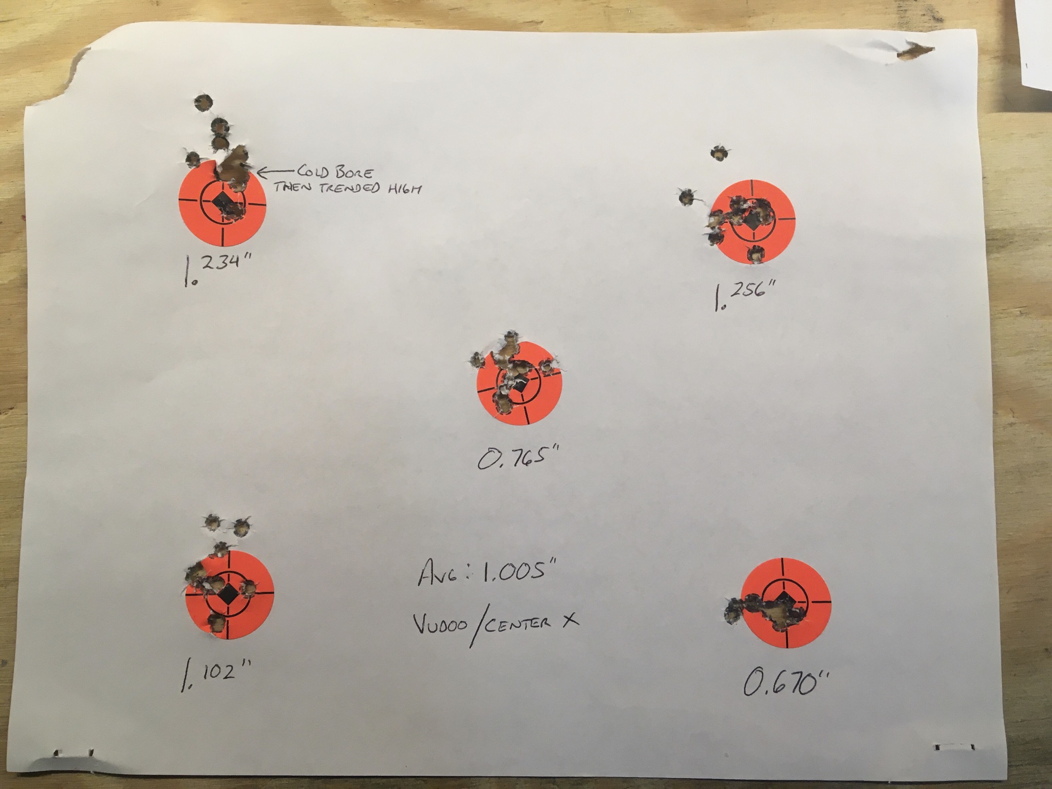

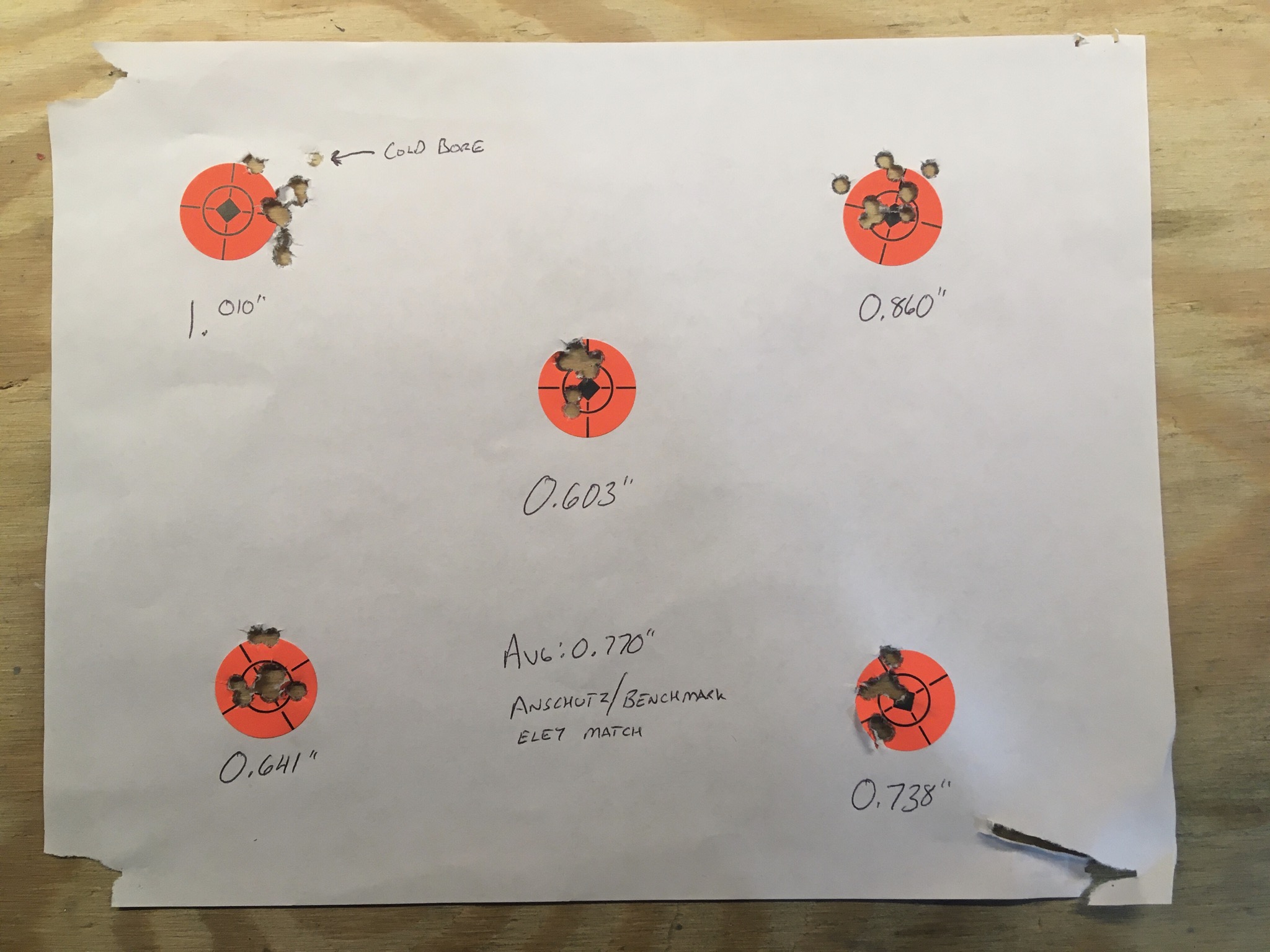

    I had a quick trip to the range after work today and only had about 45 minutes until sunset. I rushed this a bit more than I should but I wanted to get 50 rounds down with both rifles. It took me less than 30 minutes Including setting up targets, getting the rifles out, loading magazines, & shooting both targets.
    I shot the Vudoo first (left to right top to bottom) and you can clearly see that it took me a bit to settle down. I was happy to see the cold bore right in the group, I was 0.1 mil high and adjusted after the first group.
    I had settled down a little by the time I shot the Anschut, but as you can see I didn’t start shooting decent until I had 15-18 rounds down. This is all on me today, I should have slowed down. There is more accuracy in this Anschutz

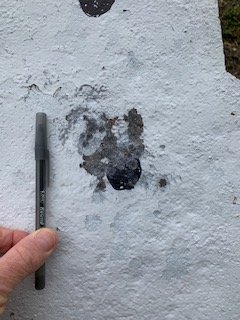

    I had just installed a Nightforce 7-35 on my Vudoo and was shooting a few groups at 100 yards. The first 2 groups were with SK Biathlon. I wasn't very happy with the second group, so I switched to Midas and shot a group. Then I realized I was halfway to a 10x5. oops I meant 5x10. ;) Average was 1.1588 and best group was .870. Shooting out my garage window. Front bipod and rear bag. The picture of the rifle still has the Vortex scope.

    Which gun do you like the best.... If you could only have one?
    that is a question I ask myself so often...
    I have been shooting Anschutz rifles for a long time and truly love them, I love blued steel and wood. Also if I had to only shoot 1 discipline for the rest of my life it would be 3P rimfire so again that is another vote for the Anschutz. In my mind when I’m not shooting I like the Anschutz better, but when I go to the range and shoot them both side by side the choice is easy Vudoo. I have listed the Anschutz for sale and got a lot of great offers but I could just never sell it. What I am going to end up doing is selling my Vudoo barreled action at some point and building another one exactly how I want it (longer unthread barrel in a faster twist, like I built my Anschut). my only hesitation is that my Vudoo shoots so good.
    For specifics as to why I like the Vudoo better the action and magazine system is just so damn good. It’s unlike any other rimfire I have ever shot or owned.
    JBell.... I too love blue steel ad the beauty of wood, there is nothing like it. The only problem with it is, I sweat a lot and the salt and moisture get onto the stocks. The check riser on my CZ Royal is not as a riser but something to protect the wood. And my Annies have a rubber butt pad that is not for LOP but to give the butt pad some gription. The standard butt pad is a hard, slippery. For me, the biggest downer with my Annies is the mag release. The bottom line is that I like all of my guns and am glad that I don't need to pick just one. If I had to pick one scope, that would be easy.... it would be my Trijicons. They are 5 - 50 x 56s
    Reactions: jbell

    This picture is 30 consecutive shots at 140 yards. I was chronographing and used this Pepper Popper as an aiming point. The cap of the ink pen including the clip is 2 1/2". I like to shoot a lot of shots in a group.

    jbell, if you want a "shoot for score" challenge at 100 yards, and for it to be a challenge, why not shoot a PSL, ARA or USBR target? 25 bulls but you could designate the top row for sighters, and shoot 20 for score. Readily available and would be a challenge at 100 yards, instead of the normal 50 yard distance.
    Just a thought.
    Take care!
    Reactions: BigRed308
    Good idea, I have been thinking about a score challenge. We had one years ago but it died quick. The trouble with a score target is needing people to purchase targets to keep it all equal.
    Ahh, good point. I am a Co-Director of a monthly Postal Match and I coordinate the creation of targets. I attached an example I made for the 6x5 and 5x10 group size target a couple of posts back today. I have a couple of targets that may work well at 100 yards if you are interested, and they can be modified to meet your needs. Just let me know and I would be glad to send you a few examples, and modify as you think is needed so we can post a score target for everyone to download, print and shoot. I would be glad to help as needed.
    Take care!
    Reactions: jbell
    As an third alternative I have attached the targets I created for my supported shooting. Simple dot shooting, 25 dots 0.5" in diameter for 50 yd, 25 dots 1.0" in diameter for 100 yd and one dot 2.0" in diameter for 200 yd. The initial COF will be first 25 shots at 50 yd, then 25 shots at 100 yd and finally 25 shots at 200 yd. Once have mastered ballistic turrets will go 50, 200, 100, 50, 100, 200...or some such. Being optimistic initially will have two scores, one point if bullet hole is entirely within the disk, zero if not. If reality intervenes and score is embarrassingly low, then one point if edge of bullet hole touches disk, two if entirely within disk and zero otherwise. Initially no time limit but later could be.
