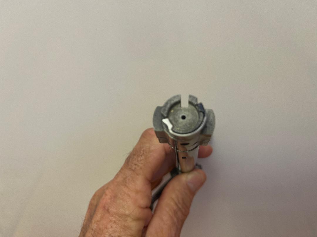

My gun is a 1959 Savage that belonged to my dad. It has a mechanical ejector so there isn't an ejector port to look for swipes and overpressure. It does, however, have a rectangular (almost square) groove that extends to the bolt face. Can that cut be used to look for signs of pressure much as one would use an ejector port? I'm hoping not to have to rely solely on my primers to indicate pressure.
