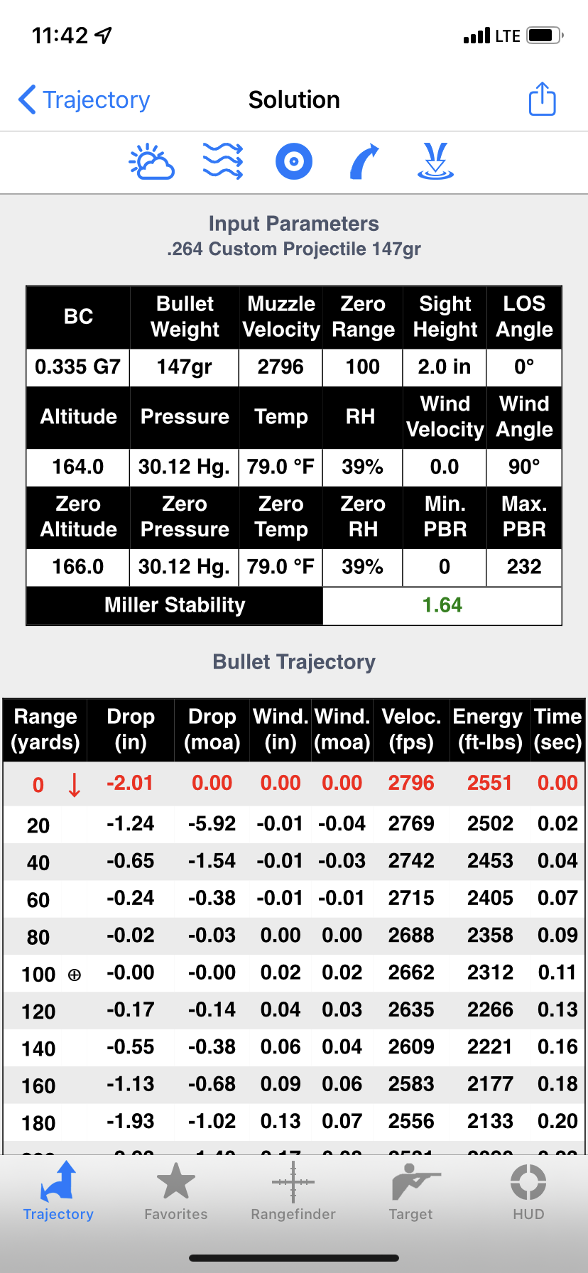

So I worked up a load for my creedmoor with 147 eldm and tested them out at range the last two times I went. I used the g7 bc of .335 from the Brian Litz book and noticed it didn’t seem true with my rifle. I’m new to the eldm bullets always shot Berger’s before and their advertised bc has always been spot on for me. Chronographed with LabRadar same day I was about half moa low to what my ballistic app said at 250,280,300,400,500,600,667, and 820 yards and around 1 moa low at 900 and 1000 yards. Tinkered around with the bc on the app leaving everything else the same until the drops matched my real world drops and came up with .310 for the bc. Is it possible for bc’s to be different in different barrels or atmospheric conditions or do I have something else going on?

Since he was concerned about G1 didn't mention G7, AB mobile shows .315 G7 for 147 ELD-M so in the ballpark of your .310

I wonder why the applied ballistic book had .335 listed
