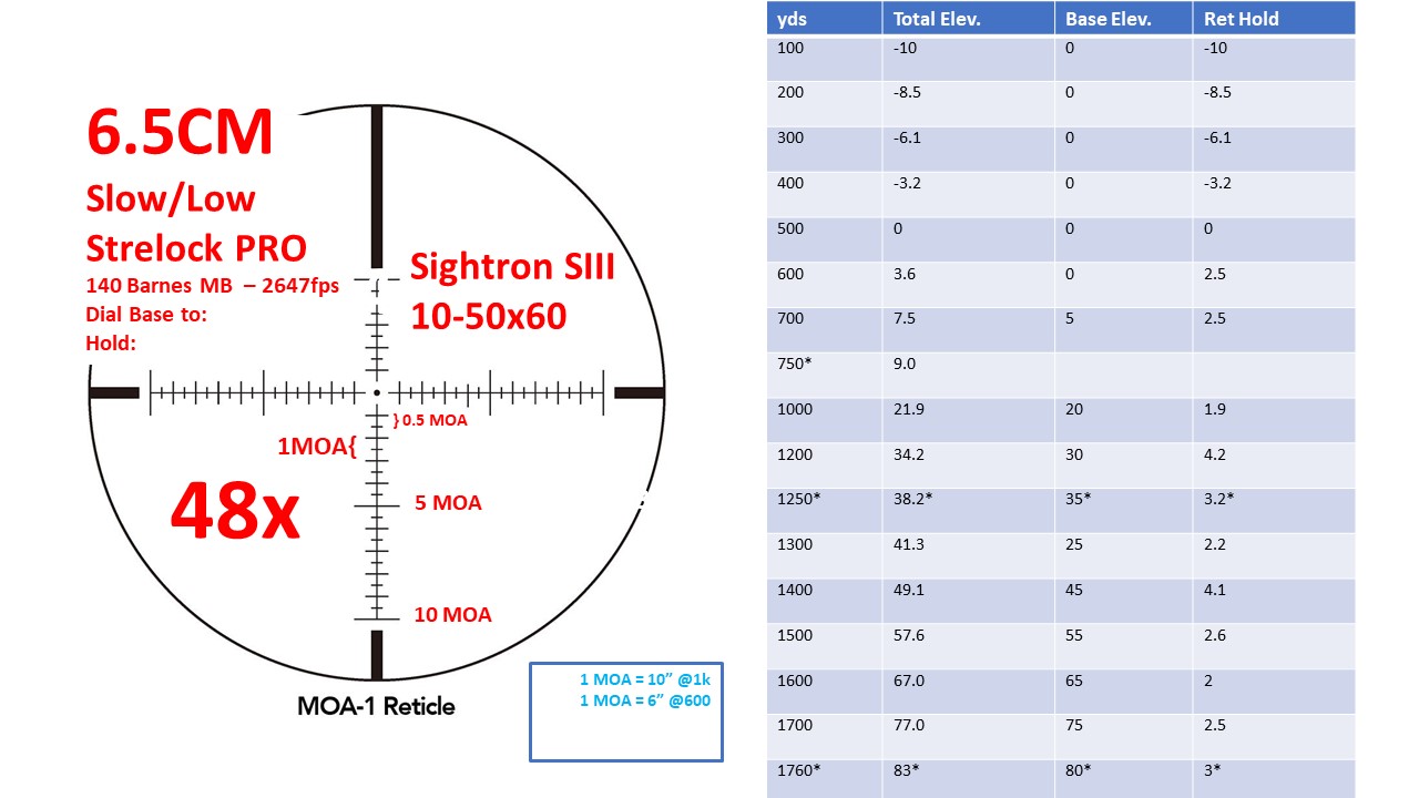

prepping for the 600 yd match this weekend with new dope cards! I usually laminate these.
