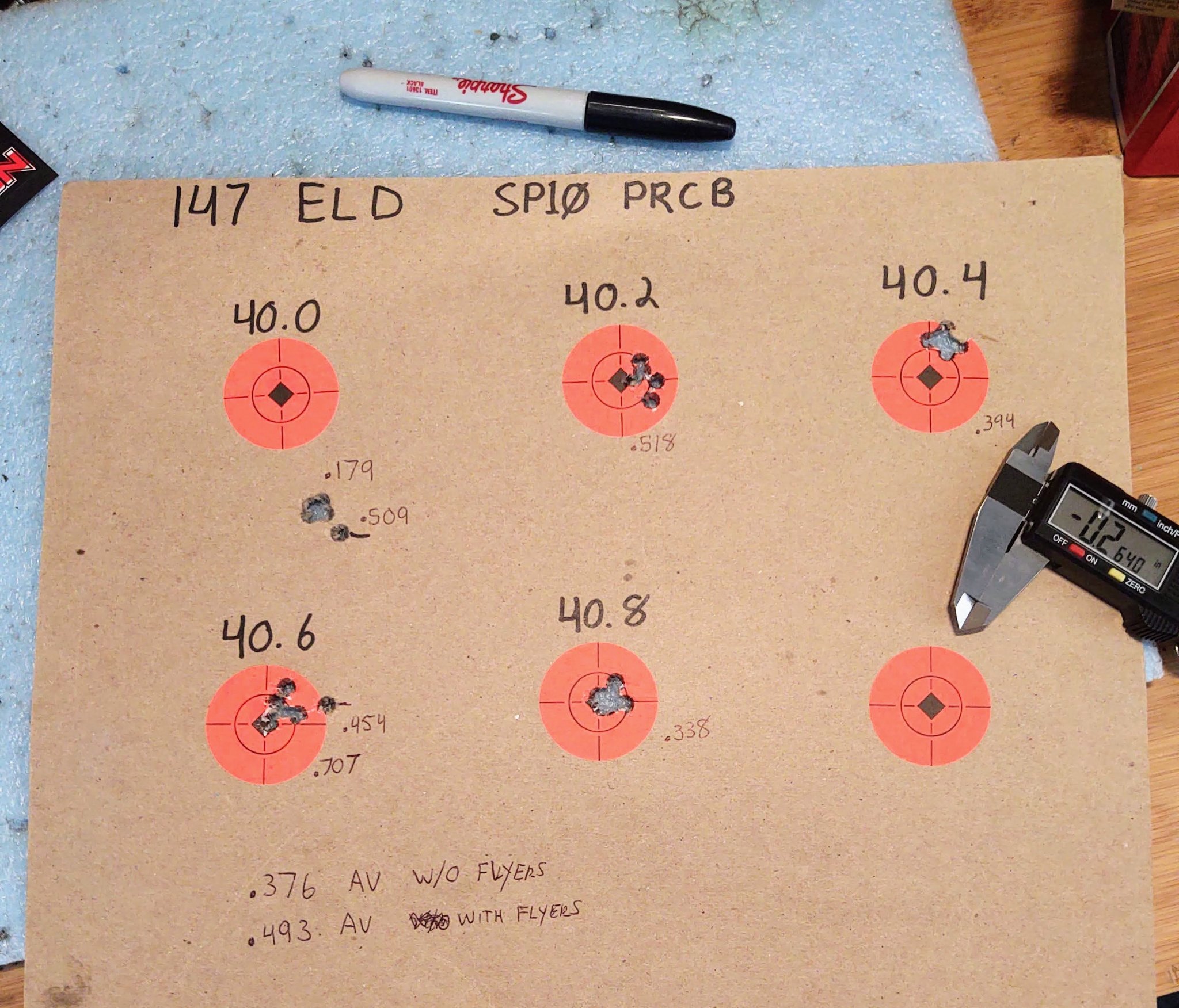

Mine liked the 147 ELD's best but also did well with the 140's.
147 ELD
Starline LR Brass
H4350 (I settled on 40.8 )
GM210M Primers
COAL- FROM THE OGIVE
2.156" (147 ELD)
140 ELD
Starline LR Brass
H4350 (I settled on 41.0 )
GM210M Primers
2.182" (140 ELD)

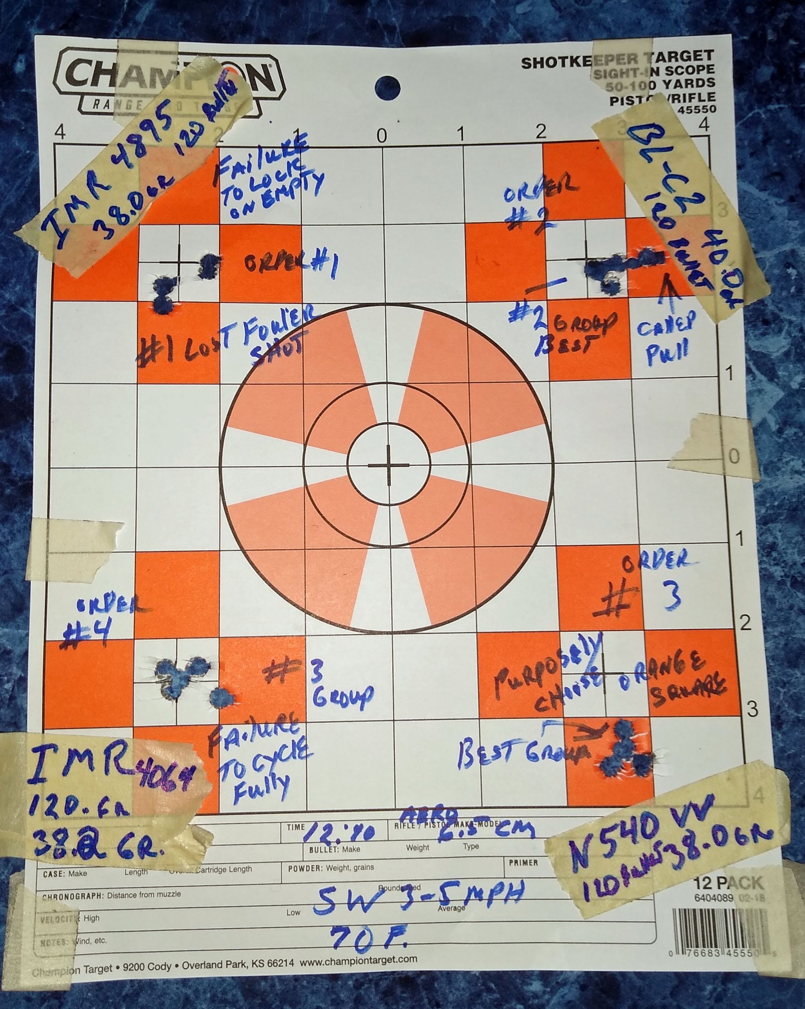

Sorting it out ,step by step . Go figure N540 & BLC-2 front running . NO rest Aero custom 6.5CM @ 200 yd. for got My bags ,so sling & elbow on bench . Glass Meopta Optika6 4.5x27x50 SFP using 8 power .
Purposely ate the orange square W/N540 . I blew off #1 fouler on IMR4895 ,which cycled OK but failed to lock open . IMR 4064 Failed to fully cycle action .

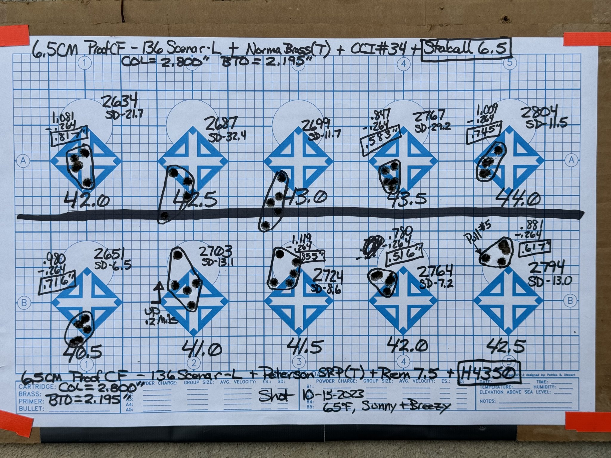

136 Lapua Scenar-L bullets with Staball an H4350. 24” Proof CF….
