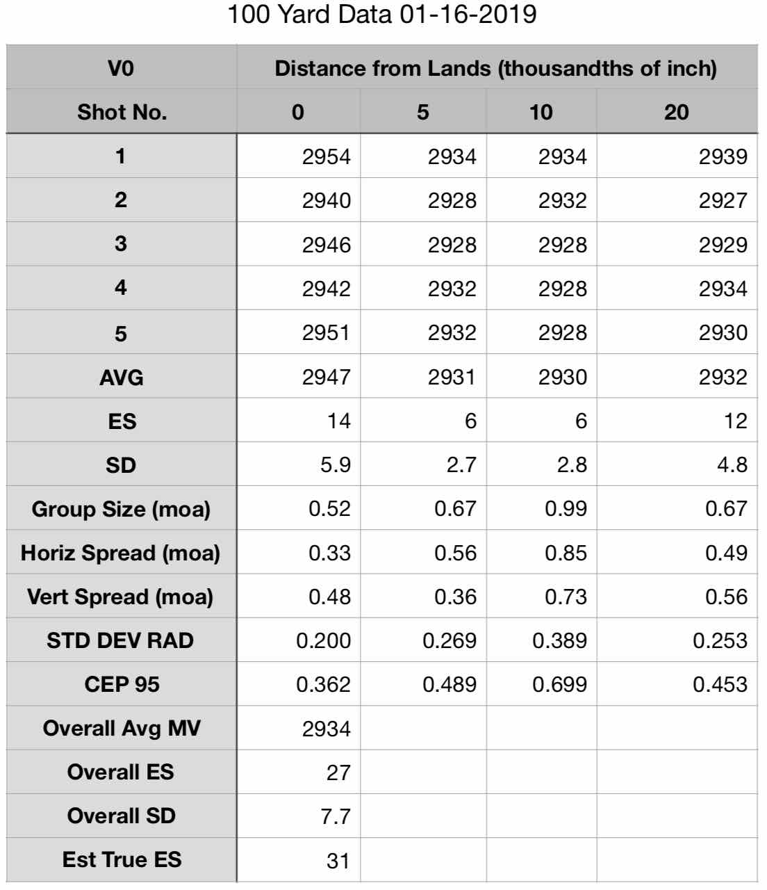

Attached is the data collected today at the range. Only the 100 yard range was open. This is for 41.8 grains of RL16 pushing 130 grain Berger hybrids from Lapua brass, CCI 450 primers, MPA (Spencer) 26 inch barrel. Advice and comments welcome. I think I like the seating at 10 thou off the lands. Thank you.
Why 10 thousands? Excuse my ignorance if I am reading your data wrong. Wasn’t that the largest group?
Does look like that was your best ES and SD. Was it you who pulled the shots?
