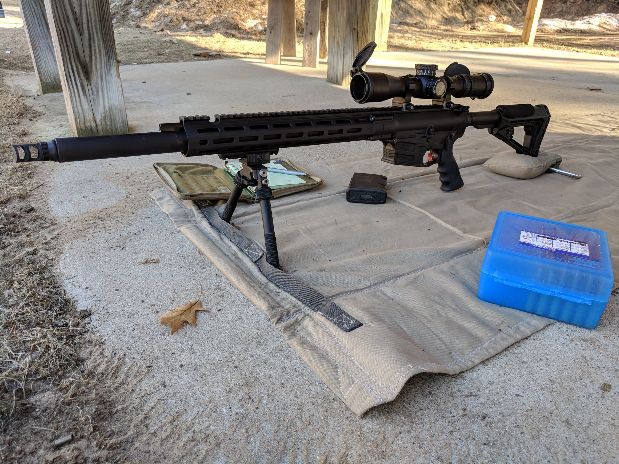

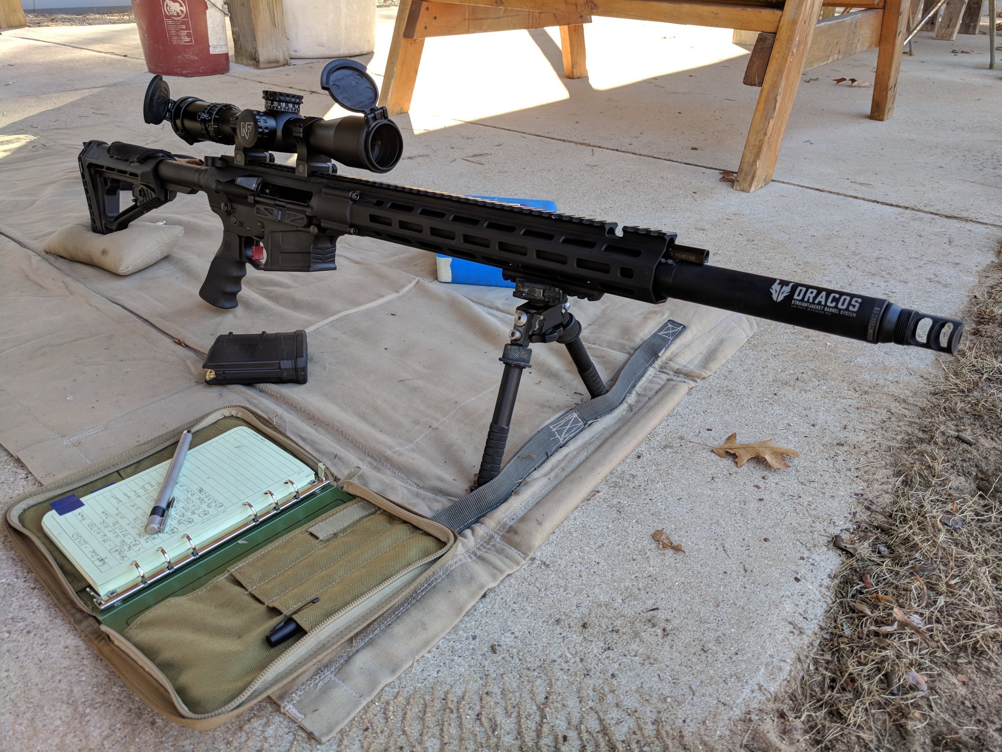

  • Rifle: Savage MSR10 Hunter, Hyperfire Trigger, Nightforce ATACR 4-16x, factory everything else (except barrel of course). Approx. 800 rounds through barrel prior to testing. Barrel scrubbed completely bare/no copper this morning prior to test (separate video/post coming on this topic)
  • 125 rounds in a single session (similar to PRS/Match round count): 5 foulers/sighters to start then 6 separate OCW Tests with about 15 minutes between each 20 round string (including shooting the string). Each OCW was fired in Round Robin fashion (low to high, high to low, middle to middle, then last was random) so heat was averaged out over all charge levels.
  • Field Condition shooting: All rounds fired prone with rear bean bag, shooting mat and Atlas bipod.

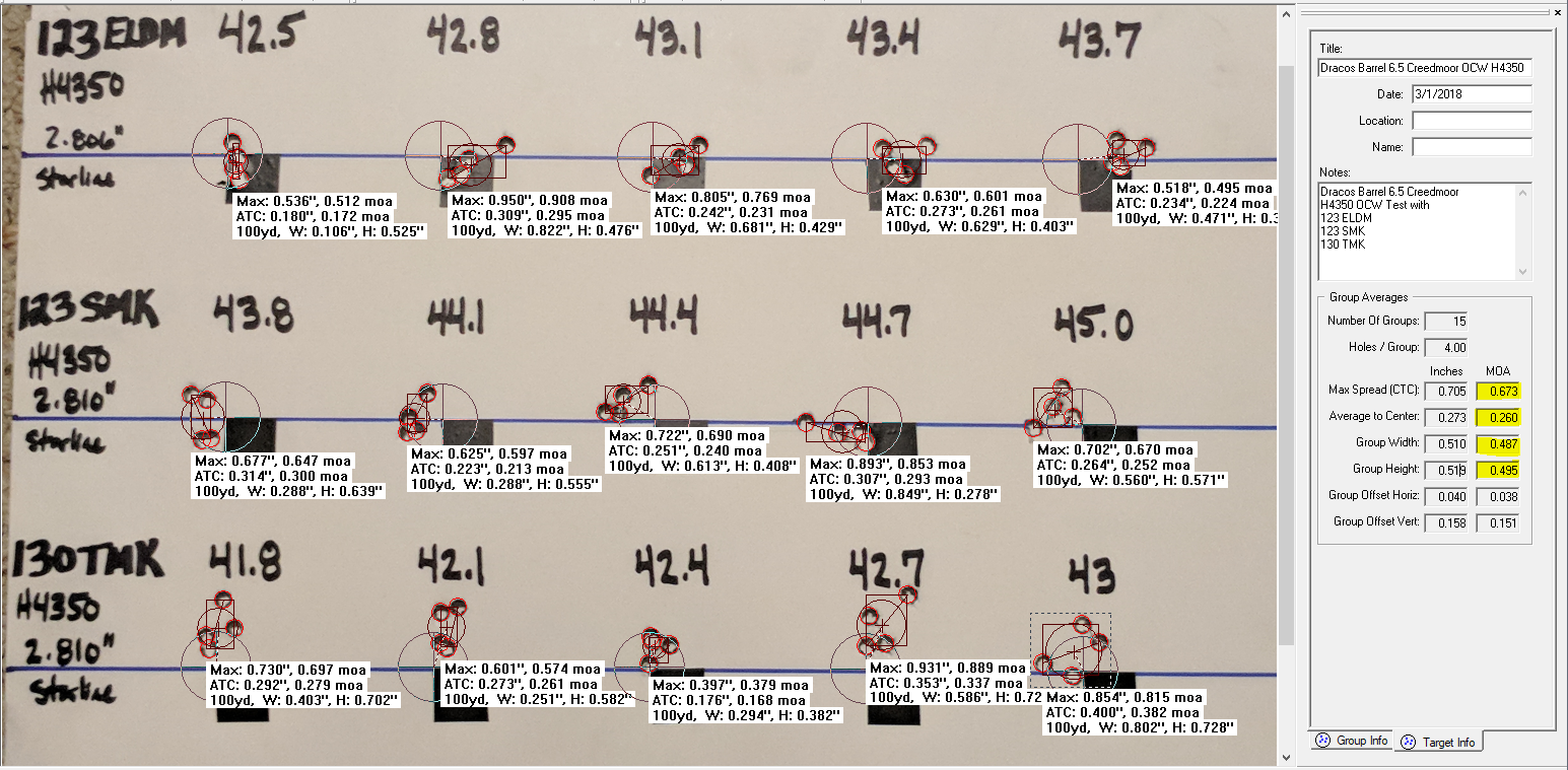

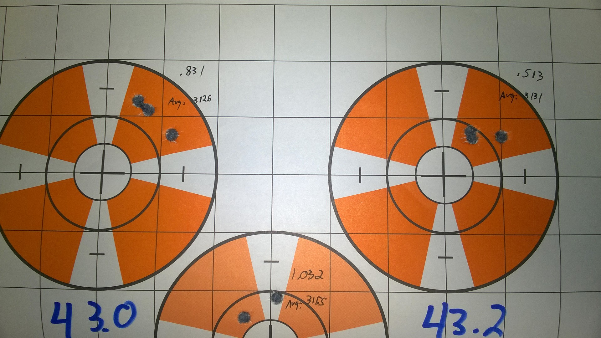

  • Sequence of Fire:
    1. 123 ELDM - Smallest Group: .495 MOA, Avg: .657 MOA, Avg to Center: .237 MOA
    2. 130 AR Hybrid - Smallest Group: .585 MOA, Avg: .666 MOA, Avg to Center: .258 MOA
    3. 123 SMK - Smallest: .597 MOA, Avg: .691 MOA, Avg to Center: .260 MOA
    4. 139 Scenar - Smallest: .641 MOA**, Avg: .855 MOA, Avg to Center: .365 MOA
    5. 130 TMK - Smallest: .379 MOA, Avg: .671 MOA, Avg to Center: .285 MOA
    6. 123 Scenar - Smallest: .582 MOA, Avg: .713 MOA, Avg to Center: .265 MOA
Results are interesting (to me at least). One of the main selling points of this barrel system is their ability to maintain accuracy and dissipate heat. I fired a lot of rounds over the course of 90 minutes and, while it was colder, the barrel would cool relatively quickly. During one of my breaks between strings, I used a different bolt gun firing 10 rounds in about 60 seconds and the barrel was definitely hotter than the Dracos after a 20 round string. Even with 120 rounds down the tube, one of the smallest groups fired occurred when the barrel was dirty and hot.
Another point: Remember that this test represents 30 different loads (6 bullets X 5 charges each) and of all the groups, 30 of 30 four-shot groups were sub-MOA and 20 were sub .75 MOA, all while shooting round robin, breaking cheekweld, rebuilding NPA and starting new between each volley of 5 rounds. Here is another breakdown by # of groups by size:
  • Out of 30 total groups:
    • 2 Groups less than .5 MOA (130 TMK and 123 ELDM)
    • 18 Groups Between .5MOA and .749 MOA
    • 10 Groups between .750 and .999 MOA
    • 0 Groups at or over 1MOA
Overall, is the Dracos system accurate? Yes.
Does it maintain sub-MOA? Definitely.
Sub three quarter MOA? Yes.
Sub 2/3 MOA? With the right load, most likely.
Sub Half? Possibly. With a better shooter, almost certainly a sub-half MOA barrel.
As long as they continue to honor their warranty, I think this barrel system is a winner. It's consistent and has sped up considerably since new; 123 ELD's with different lot of H4350 started at 2870fps and ended up over 2950fps after about 150-200 rounds.

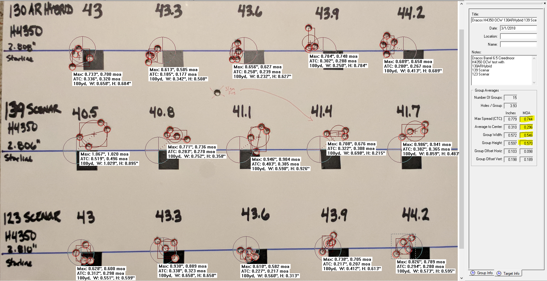

Hope you get some value from this and good shooting! Here are photos of the targets:

And how about some pics of your rig. I plan on picking up the MSR 10 LR in 6.5CM next month....hell of alot of gun for $1700
Just for kicks, I decided to hand measure the largest and smallest groups (to confirm OnTarget set group sizes correctly)and to my surprise, the single largest group (1.02MOA by OnTarget) was ACTUALLY .98MOA! That makes all 30 groups by definition SUBMOA. Doesn't change the outcome but I thought it prudent to at least point that out.
Editing post to reflect that...?

(2) 5-shot groups each at 100yds:
  • Berger 130 Hybrid AR 43.3gr H4350 @2.808
  • Lapua 139 Scenar 40.8gr H4350 @ 2.806
  • Lapua 123 Scenar 43.6gr H4350 @ 2.810
  • Sierra 123 MatchKing 44.1gr H4350 @ 2.810
  • Sierra 130 Tipped MatchKing 42.4gr H4350 @ 2.810
  • Hornady 123 ELDM 43.7gr H4350 @ 2.806
Plus 5 rounds each:
  • Berger 130 Hybrid AR 42.4gr H4350 @2.808 (checking for 130gr sweet spot near the TMK load)
  • Sierra 130 Tipped MatchKing 42.2gr H4350 @ 2.810
  • Hornady 123 ELDM 42.5gr H4350 @ 2.806 (sighters and compare to prior test)
Velocity testing will happen with these after picking best two loads from above. SD on prior ELDM loads has hovered around 4-6 with freshly annealed brass and 12-15 after 3-4 firings. Will post results tonight if I get some time.

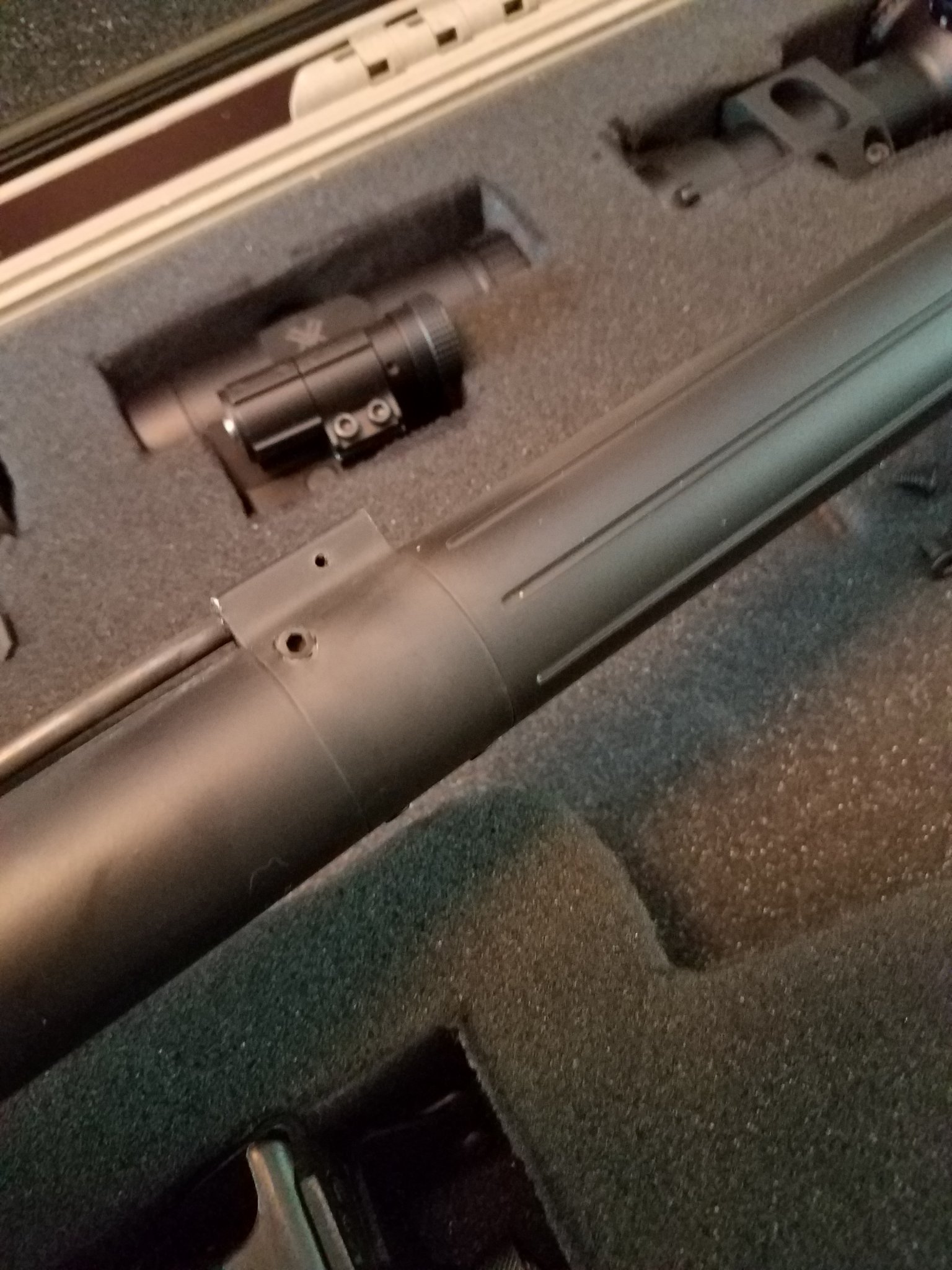

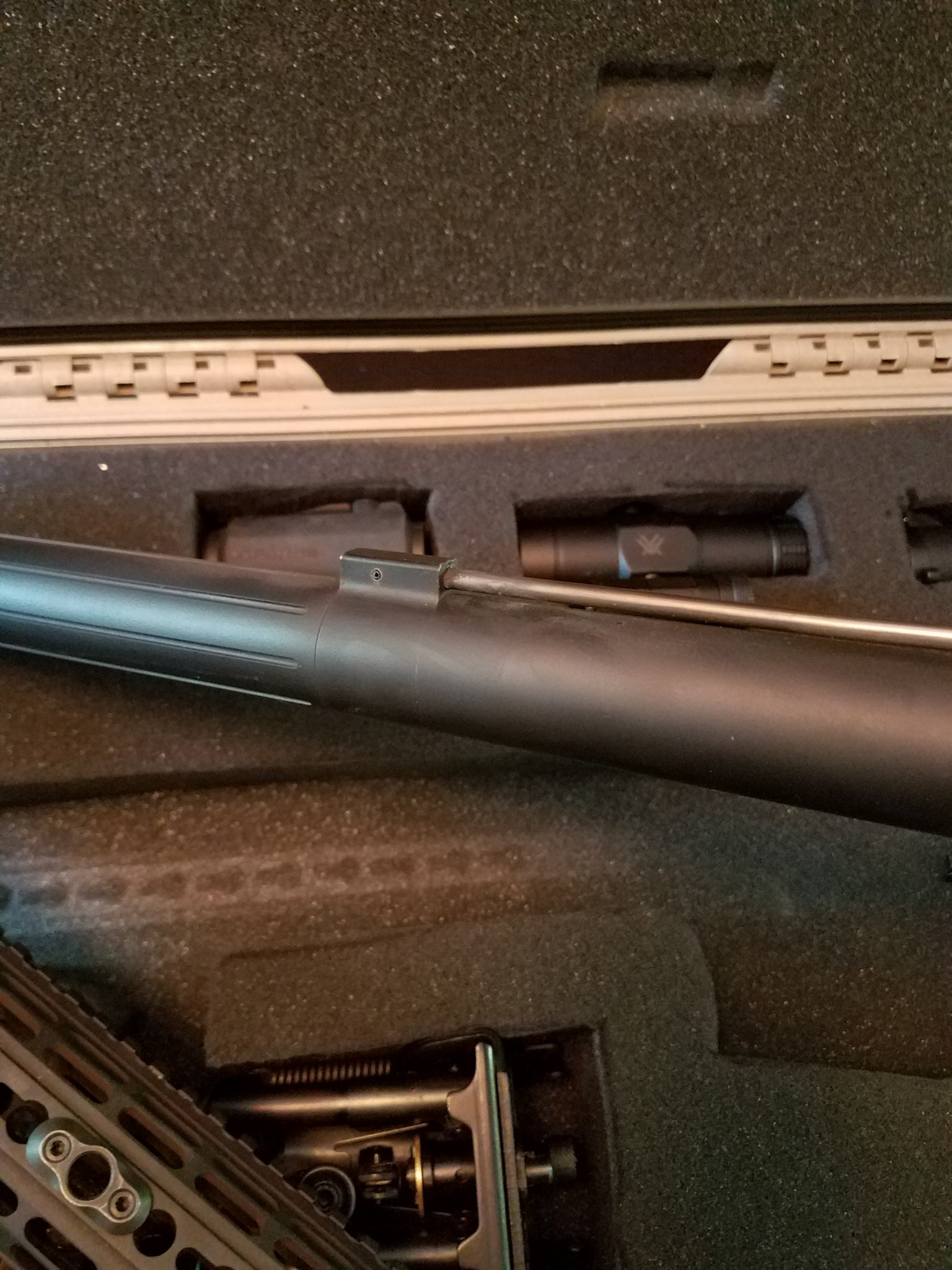

One thing I have noticed about the barrels is the gas block does not sit at 12 oclock so to float the gas tube you need to bend it
Thanks. I have a bunch of mixed hornady brass as well so once I start testing again ill get some new brass when I narrow it down.
Mine sits just off center also. Maybe a millimeter or two. Clears my handguard but only just. I may Dremel out part of the handguard to add clearance. It's a tight fit that's for sure!

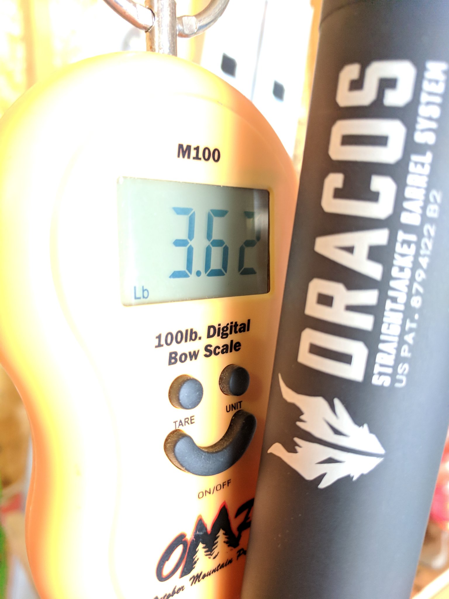

I have one question for you, did you weigh the barrel before installing? I've seen the numbers on their site change a few times.
Please keep us posted as your round count increases. Really looking forward to see if their "5x barrel life" claim has any veracity. Even 2x would be huge, especially with the warranty!
I did actually. I put up a review about a month ago (Review linked here) but here is the photo of the scale. Original barrel was 18" medium contour (.75 through most of barrel with fluting between chamber and gas port. Almost exactly 1lb heavier even though it's nearly twice the diameter and 4" longer. Happy with it so far but I'm am doing my part to test their barrel life claims: 900+ rounds and counting after about a month and change. If it still shoots sub minute after 3000-4000 rounds (July/August at the current rate), I'll be impressed. If not, I'll be testing their commitment to honor their warranty.

The gas block on this barrel is perhaps my single biggest disappointment. I'm very surprised/confused as to why they couldnt add a single set screw to adjust gas volume at the block rather than resorting to an adjustable gas key. Gus runs super dirty and this would likely improve barrel consistency even further.
I've been trying to reach them for the last week to see about ordering a spare gas block to try making a DIY adjustable gas block by drilling/tapping a small set screw to limit gas. If it works, I'll report back.
I agree. I like the small footprint of the gas block, but making it truly adjustable at the block would be a major improvement. IME, the big screw they have on the front of the block to adjust "dwell time" does fuck-all. At least suppressed, I can have it all the way out or all the way in and nothing changes re: gas delivery, ejection, etc.
Agreed, the only thing stopping me from buying one is actually the gas block. I asked if they could retrofit a .936 Superlative or SLR and they said no. I don't understand why this couldn't be done though, maybe the original custom shop Teludyne Tech could do this?
It's because of the way the barrel is sleeved. The gas block on their system is unique in how it attaches to the barrel: slides in from the side like a dovetail and is bolted into sleeve with 3 small screws. I'll find some pictures and post.

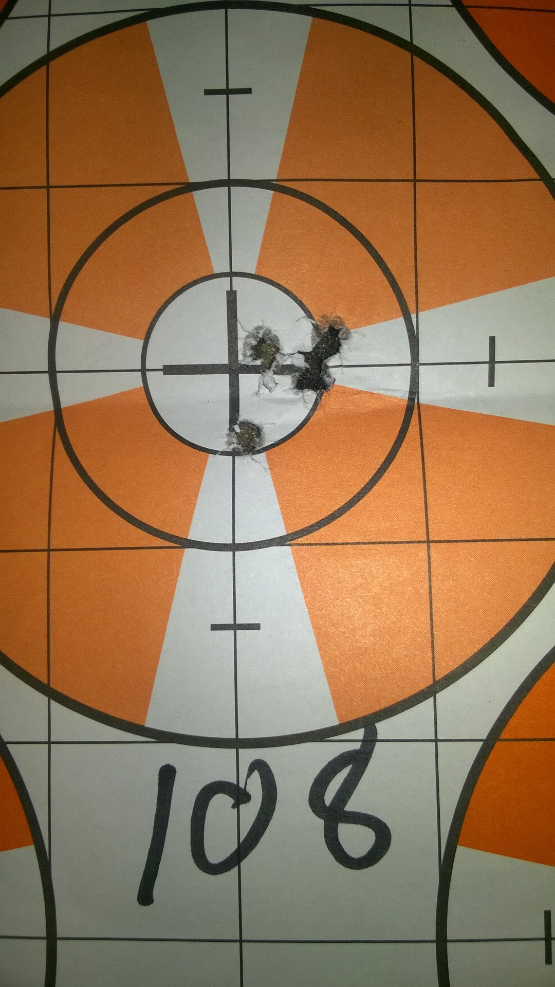

I'm a little over 1300 rounds on this barrel and it's going pretty strong. Will be posting follow-up test at 2000 rounds (May'ish).
Here's a sample across 3 different factory loads (103 eldx, 105 bthp match, 108 eldm) and 4 different hand loads (H4350 and 87 v-max) for my 6mm Creed. It would shoot amazing if not for the consistent presence of at least one flier.
WP_20180302_002 1.jpgWP_20180302_003 1.jpgWP_20180302_005 1.jpgWP_20180309_003.jpgWP_20180309_002.jpg
Unlike @Coyote Kev it doesn't (seem) to be always on the first shot.

Yes, set screw adjustable. Sorry for my terminology. As far as i know, the Teludyne Custom Shop is using the same one I have. My upper was purchased almost 2 years ago, but I still frequent the shop and speak with Glen regularly. Nothing has changed that I know of. Win mag started life as a 1st gen Sendero with about 10 down the pipe when I got it, these days she's creeping up towards 1000. That may be low by standards here, But I've only had that one a year, and 1000 rounds is more than some of my friends firein a lifetime.
Can you snap a picture? If this is the same as the Dracos block, it's not actually adjusting gas flow diameter but dwell time. And in discussion with Dracos (and a few other owners experience including mine) it doesn't offer the range of adjustment that it was designed to for reducing gas pressure at key. That's the reason they are looking to redesign.
It's not that the rifle doesn't function properly, bit that it runs very dirty and stays over gassed regardless of set screw position (with Dracos block.) Falkor version might be different. I'm curious if that's the case.
Very interesting, well keep us updated AMGtuned, especially on the round count!
I will do that. I can say that my 700 tac .308 was built by Alan Adolphsen, the creator of the StraightJacket, and it was used as a demo gun in its early years. Round count on that has to be creeping to 10k, no lie.
I will remove handguard and take a photo for you this evening. Working now.
Reactions: Subwrx300
I know it's been a while and I'm sorry to those following my response. Subwrx300 I've attached a couple photos of my gas block. From what I understand, the screw limits gas flow. I know this is a different system than used on the falkor barrels: that it works for what you're looking for, not certain.
View attachment 6906858View attachment 6906859
That is very different than what is currently on the Dracos Falkor barrels. I like that much more as it seems like it would work as intended to limit flow. Hopefully Falkor figures out a new block that is reverse compatible with older styles.
