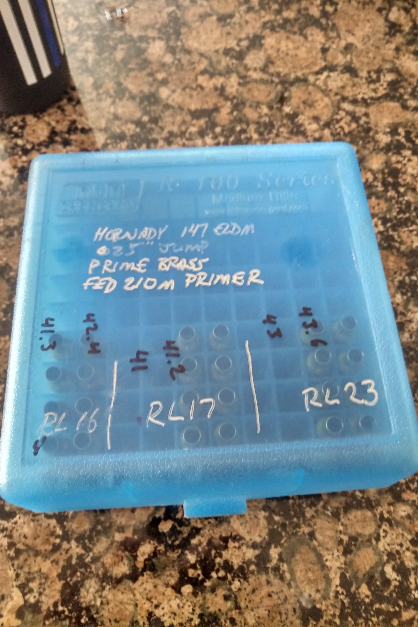

    Because we're in America and we have choices, I decided to do a "ladder" test or whatever people are flaming each other about in assorted threads. My "ladder" was going to be RL 16, 17, and 23.
    7034720

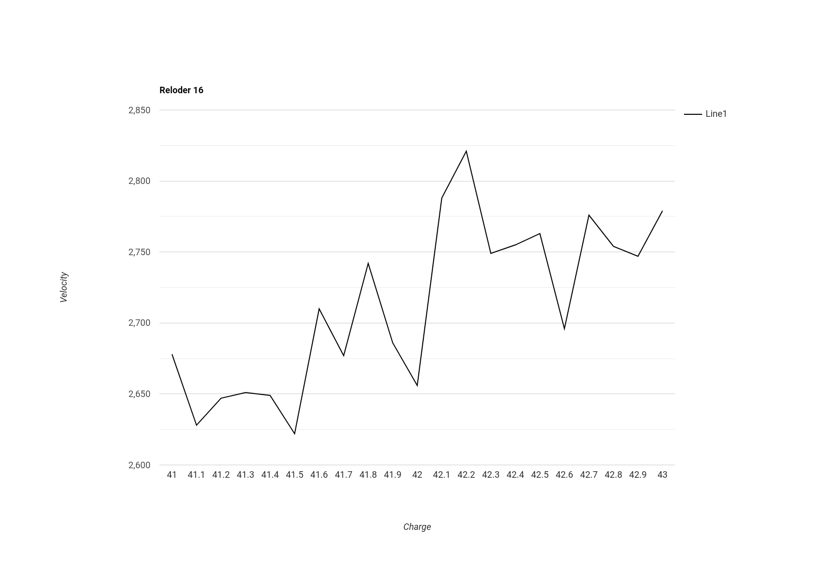

    RL 16. I'm going to try 41.3 (consistency over absolute velocity). Seating the bullets in the casings, there was "crunch" sounds starting at about 42. After seating, there was some room in the cases all the way up to 43 where there was pretty much no powder movement when I shook the case around. I'd say it was very close to a compressed load.
    7034722
    7034724

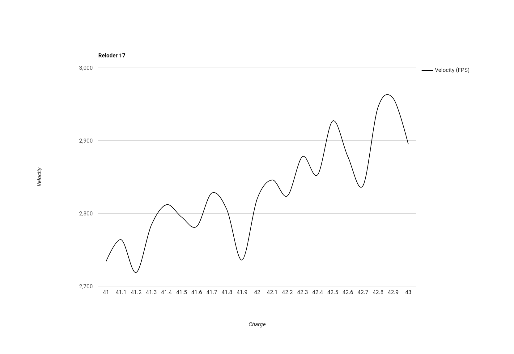

    RL 17 (gonna stick with my 41g Load)
    7034726
    7034727

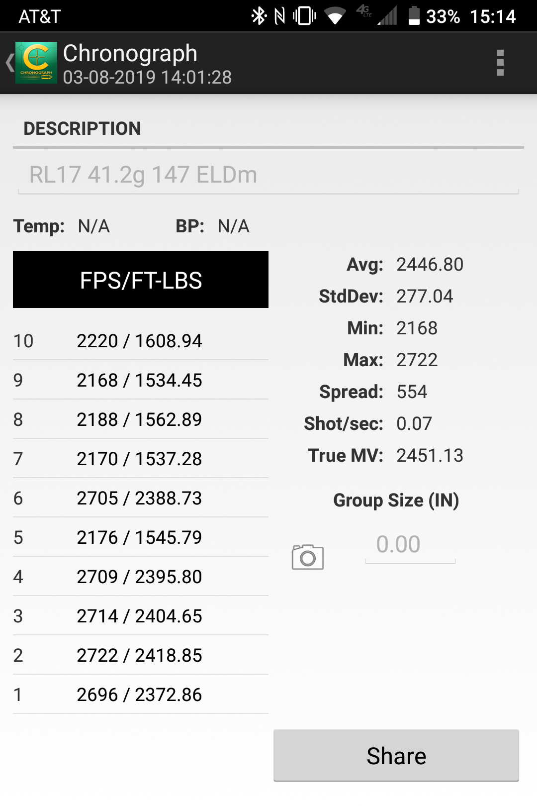

    Long story made short, shot like shit, my chronograph was all fucked up and showing readings all over the place, etc. Total shit show.
    For example, I only shot 5 rounds during this recorded string.... But I think it was recording the muzzle blast's of the guy at the next bench over....

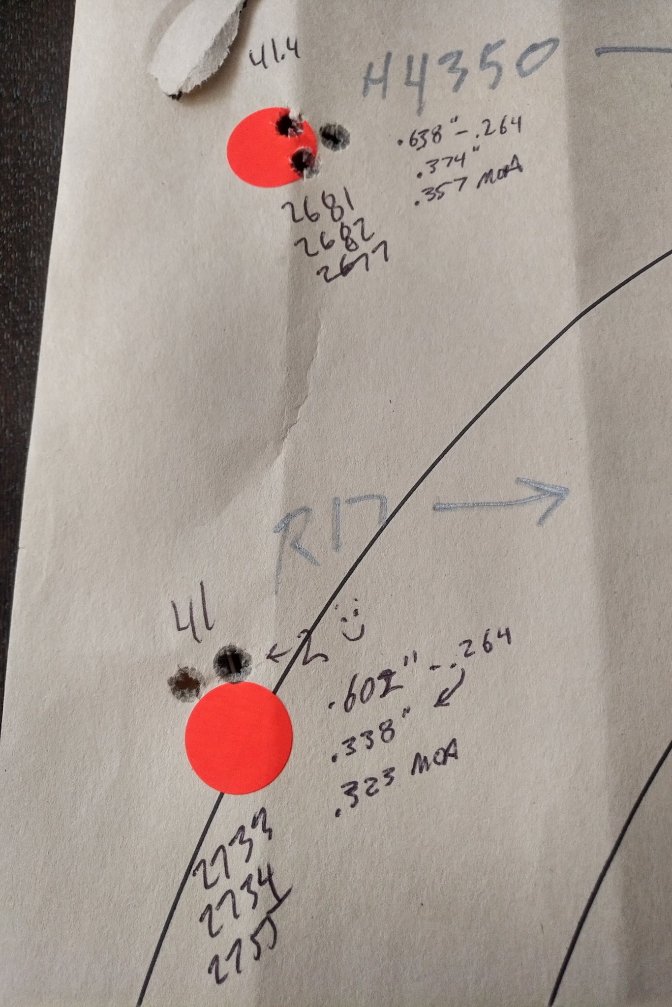

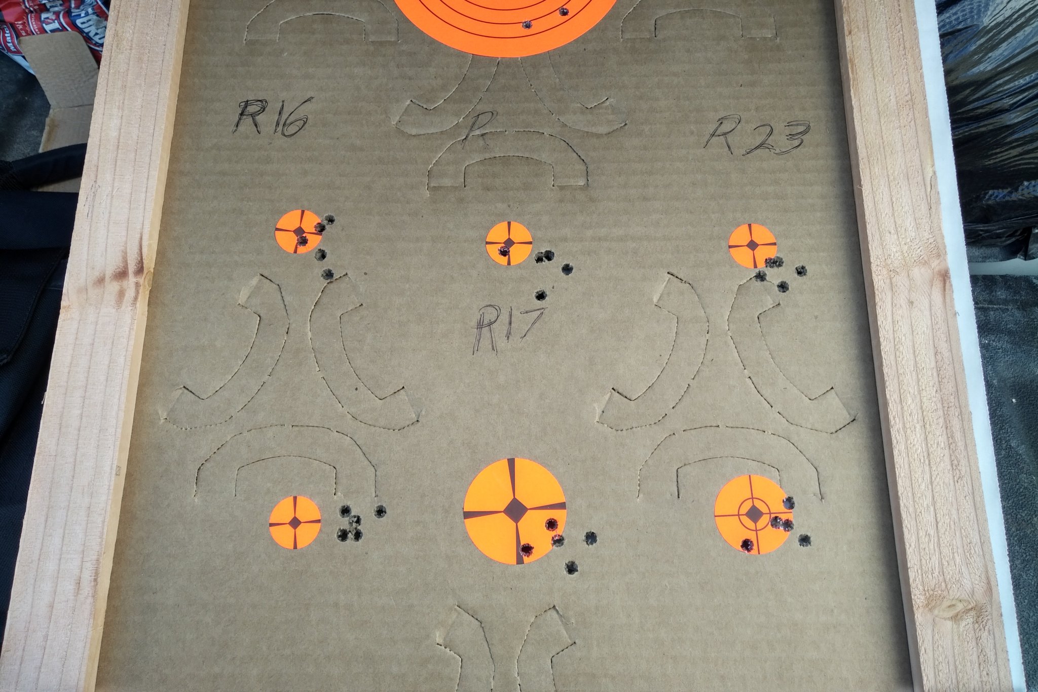

    So..... My disappointing groups...
    Bottom left is 42.3 of RL16. Density altitude was about 4700 which pushed my Average velocity 2830 from 2750 at DA 2400, ES 10, SD 4. 'Murica.
    7039537

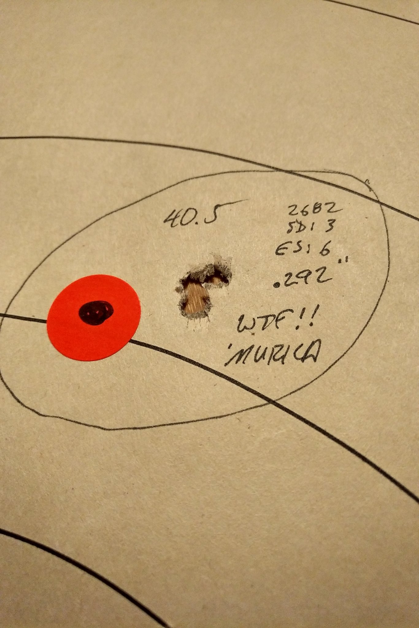

    So.... Here's an update.... Reloder 17 for the win LoL. Got my new Magnetospeed delivered the day prior to my range trip.
    7043662
    40.5g Reloder 17
    7043664
    Notes are Charge weight - Average velocity, SD, ES. There's probably a higher velocity node with R17, but I want my barrel to last a little while! LoL ???
    7043665
    It was a bit windy at the range, not enough to push the bullet at 100 yards, but enough to flop around my target while I was shooting. I'm so happy to have 2 bitchin loads for the 147 ELD Match bullet in my rifle. One with H4350, and now one with R17. Looking forward to validating the loads next week in the desert!
