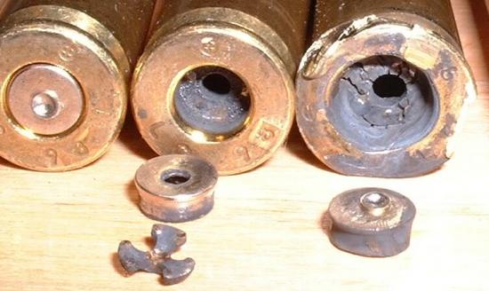

It's mild but not really an obscene load, 40.0 gr varget and Scenar 123s seated 10 thou and it was a cold day (15C) QL gives me approx 57K PSI. first shot was absolutely fine, but a wee bit faster (3050 FPS) than last year (3000FPS). Didn't even felt like a still bolt lift but the ARC Nuke is so good at extraction that you can't really tell until its too late.
Second shot, blew a primer ... like really really bad .... Lucky the ARC action took it like it was nothing, was able to lightly tap the bolt handle and extract and eject but the case was in pretty bad shape. I've never seen anything like this so I immediately stopped and will pull all my remaining LRP loads.

It look like a in-between from the center one and the one from the right ... that's like almost proof load territory and I have no idea how it could have been that hot. I use a ChargeMaster and double check with a GemPro so I'm pretty confident with my powder load.

Are those in the pic yours? I got the impression they were a stock pic.

Why did you post pics of Lake City brass with blown primers? Was it to blow our minds?
That was from Orkan primers page, I haven't had time to upload mine but felt it was similar to
