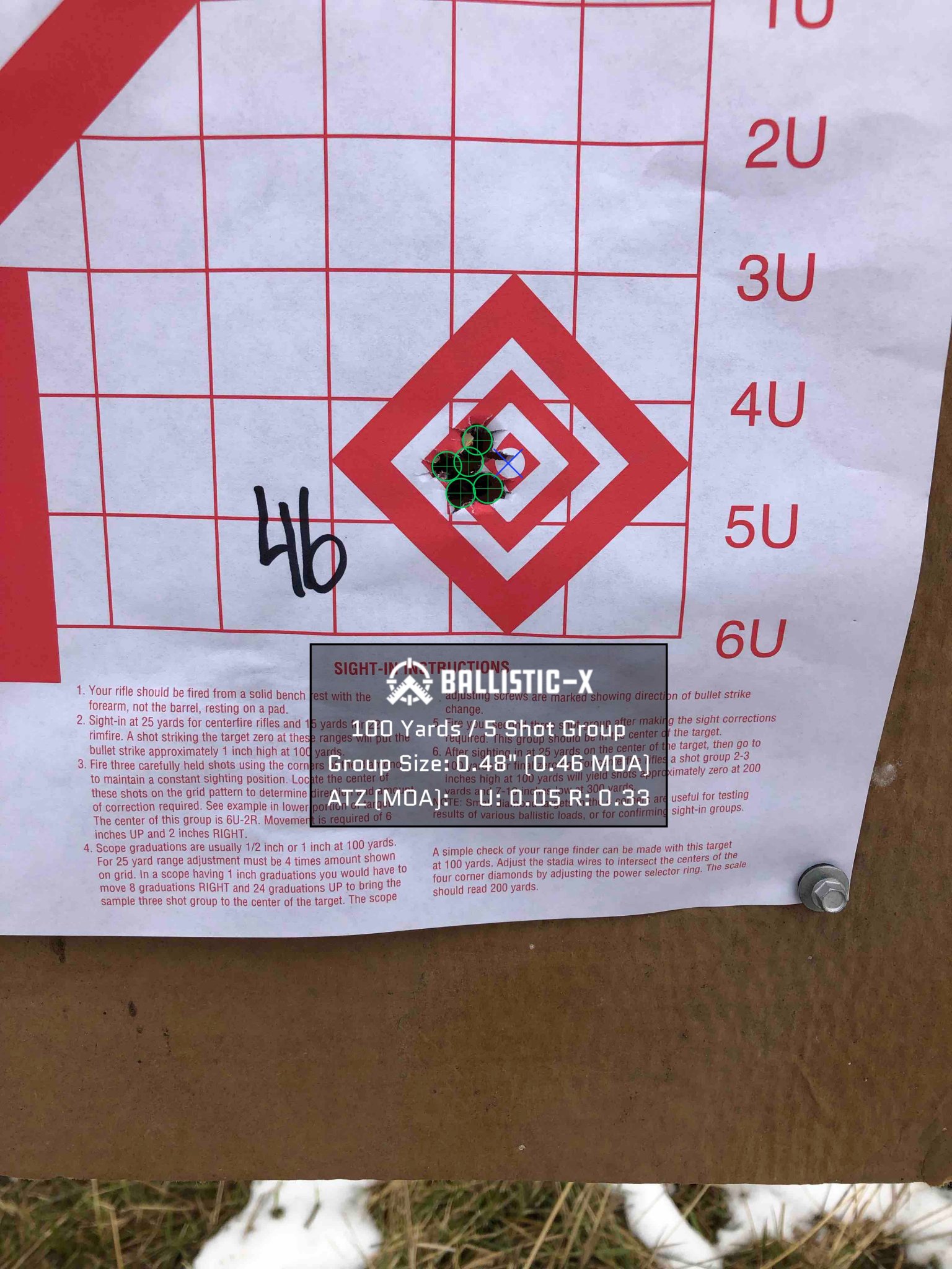

I’m still messing with it I loaded some in Peterson brass 2.82 coal (mag length) .035 jump 46 g powder gave me 2855 avg and 6 for an sd this was only over 5 shots I’m going up with the charge weight until i find pressure. Shot out of the back of my truck it was muddy as shit where I was shooting
