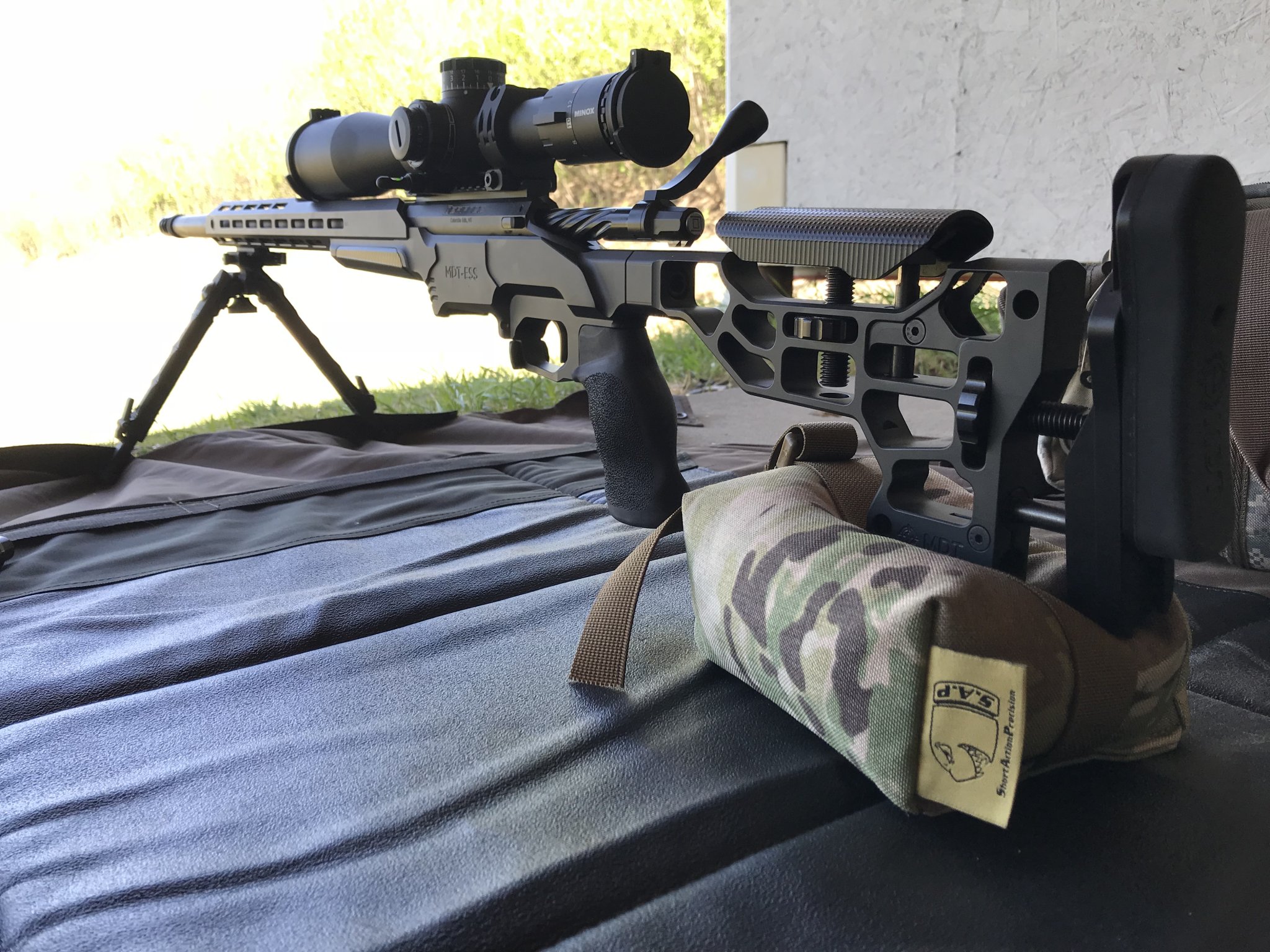

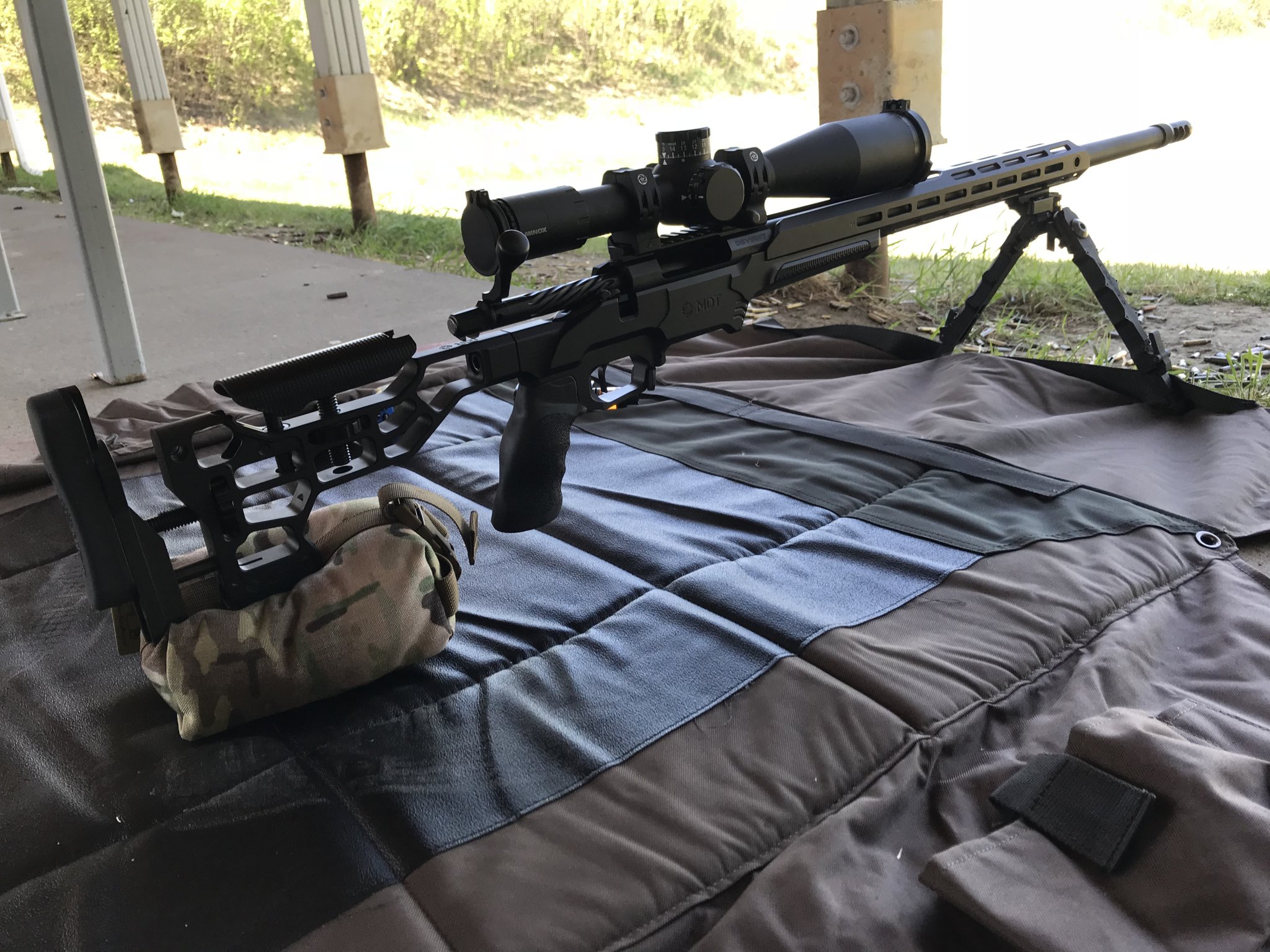

The Rifle
Action - Defiance Deviant
Barrel - 26" Krieger 1:8 MTU
Break - Area 419 Hellfire
Trigger- Timney Calvin Elite 2 Stage
Chassis - MDT ESS
Rings - ARC M10 Medium
Scope - Minox ZP5 5-25x56
The Ammo
Bullet - Hornady 147 Gr ELD-M
Brass- Virgin Lapua Small Rifle 6.5 CM
Primer - CCI 450
BTO - 2.263
.020 Off the lands

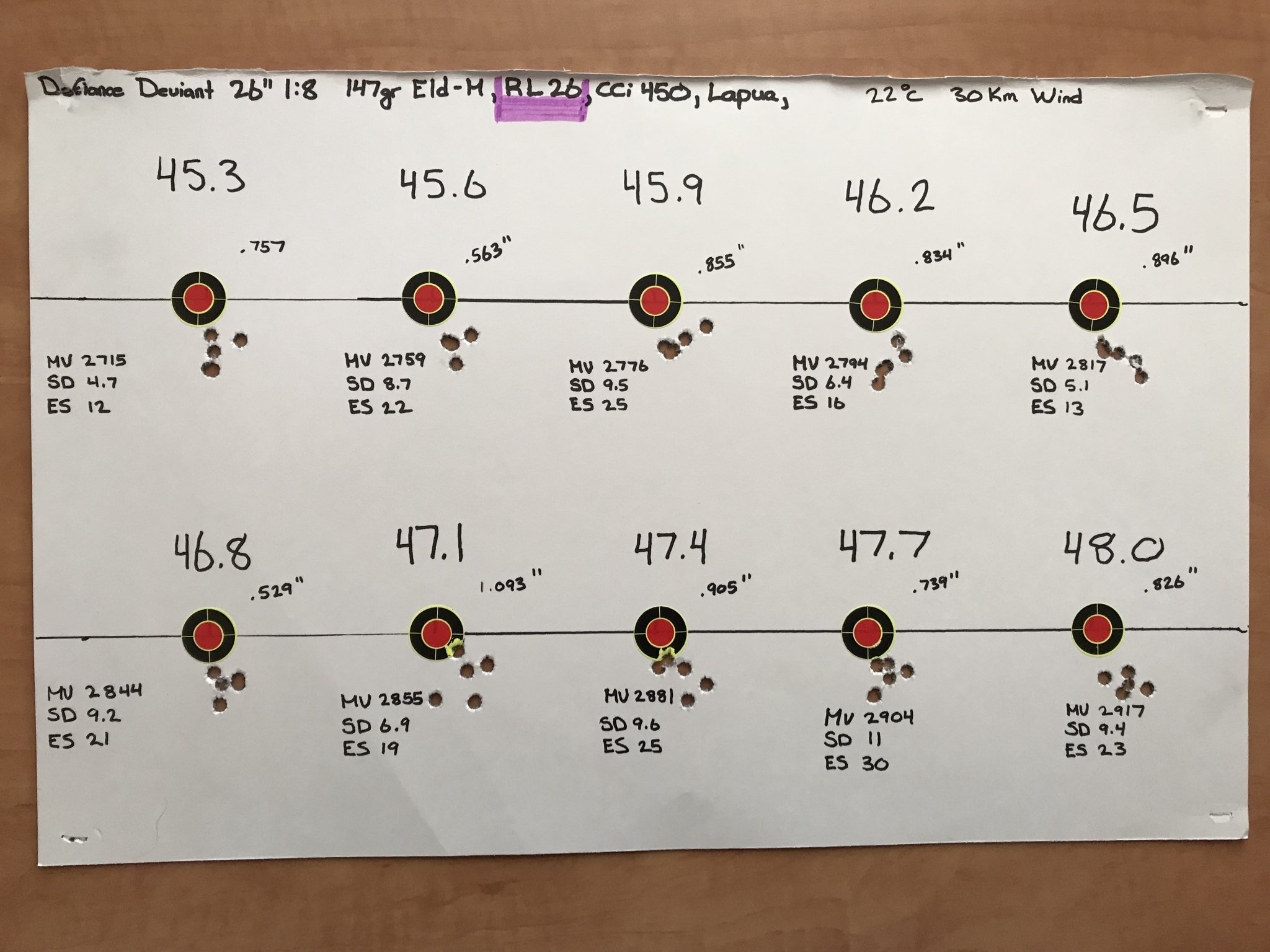

Test #2 - RL26
Charge Muzzle Vel. SD ES Group Size "
45.3 2715 4.7 12 .757
45.6 2759 8.7 22 .563
45.9 2776 9.5 25 .855
46.2 2794 6.4 16 .834
46.5 2817 5.1 13 .896
46.8 2844 9.2 21 .529
47.1 2855 6.9 19 1.093
47.4 2881 9.6 25 .905
47.7 2904 11 30 .739
48.0 2917 9.4 23 .826

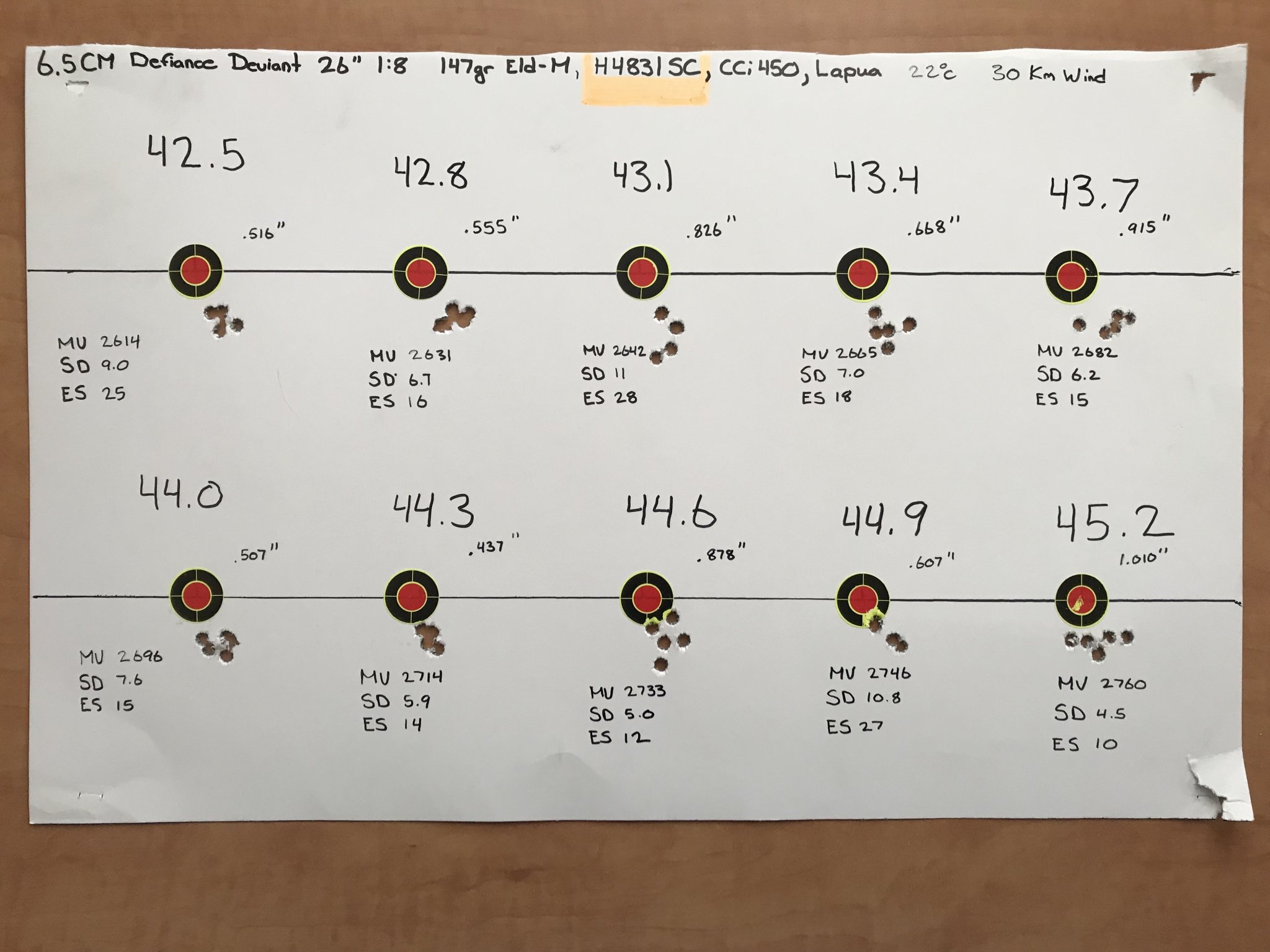

Test #3 - H4831 SC
42.5 2614 9.0 25 .516
42.8 2631 6.7 16 .555
43.1 2642 11 28 .826
43.4 2665 7.0 18 .668
43.7 2682 6.2 15 .915
44.0 2696 7.6 15 .507
44.3 2714 5.9 14 .437
44.6 2733 5.0 12 .878
44.9 2746 10.8 27 .607
45.2 2760 4.5 10 1.010

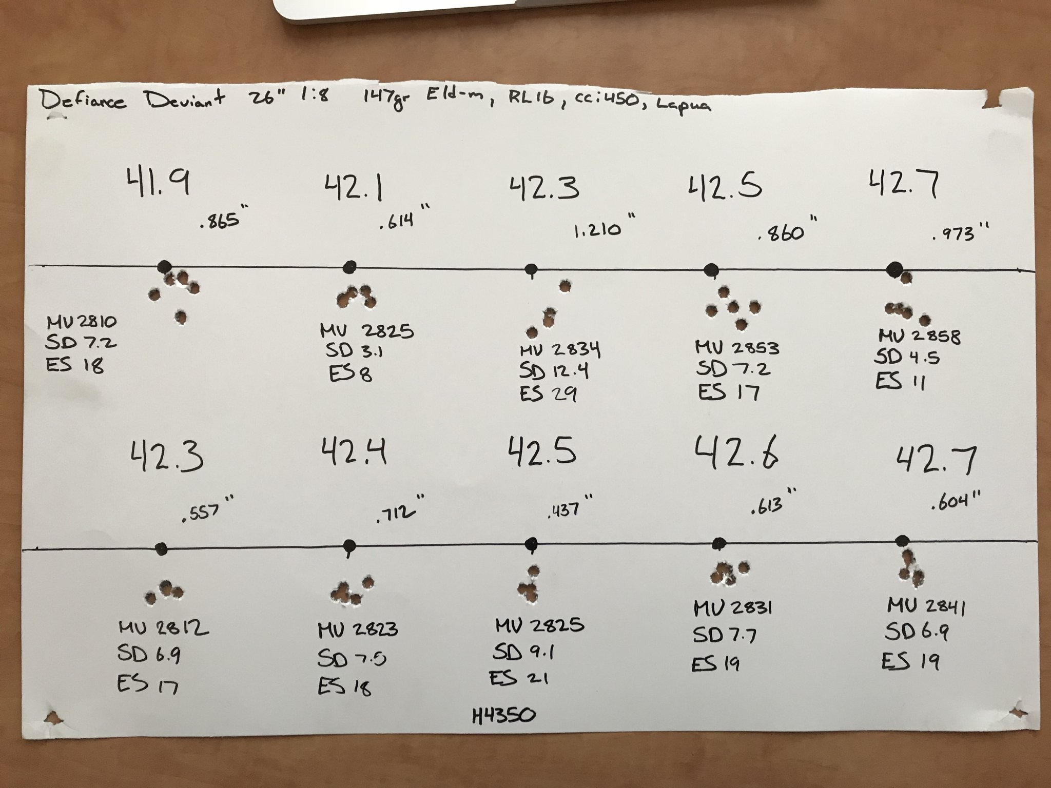

Test #4 - H4350
40.0 2657 7.9 21 .971
40.3 2690 11 30 .888
40.6 2688 8.7 21 .799
40.9 2706 4.0 10 .799
41.2 2719 2.4 6 1.159
41.5 2737 4.7 12 .467
41.8 2750 4.4 11 .742
42.1 2769 9.9 25 .494
42.4 2792 2.6 7 .556
42.7 2806 7.4 19 .806

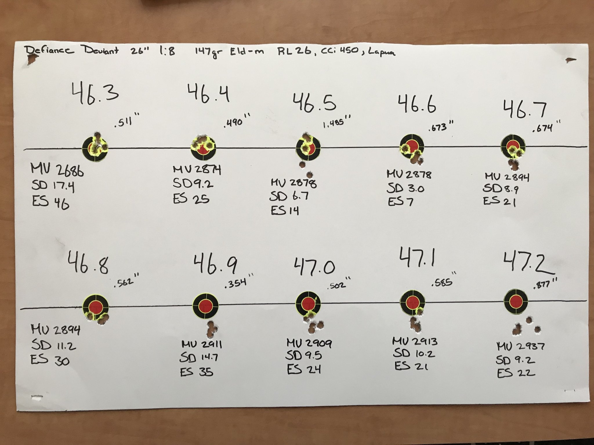

All right, I was able to make up a few more loads and make it back to the range. I wanted to see how much of an improvement I could get with once fired brass. So after de-priming and and cleaning I ran it through my Whidden full length sizer die (expander ball removed) bumping the shoulder .002. Then I ran them through the Sinclair mandrel die using neck the turning mandrel (.002 neck tension). Cases did not need to be trimmed at this time but I did touch up the chamfer and then de-burred them. One more time in the cleaner and they were ready to prime.

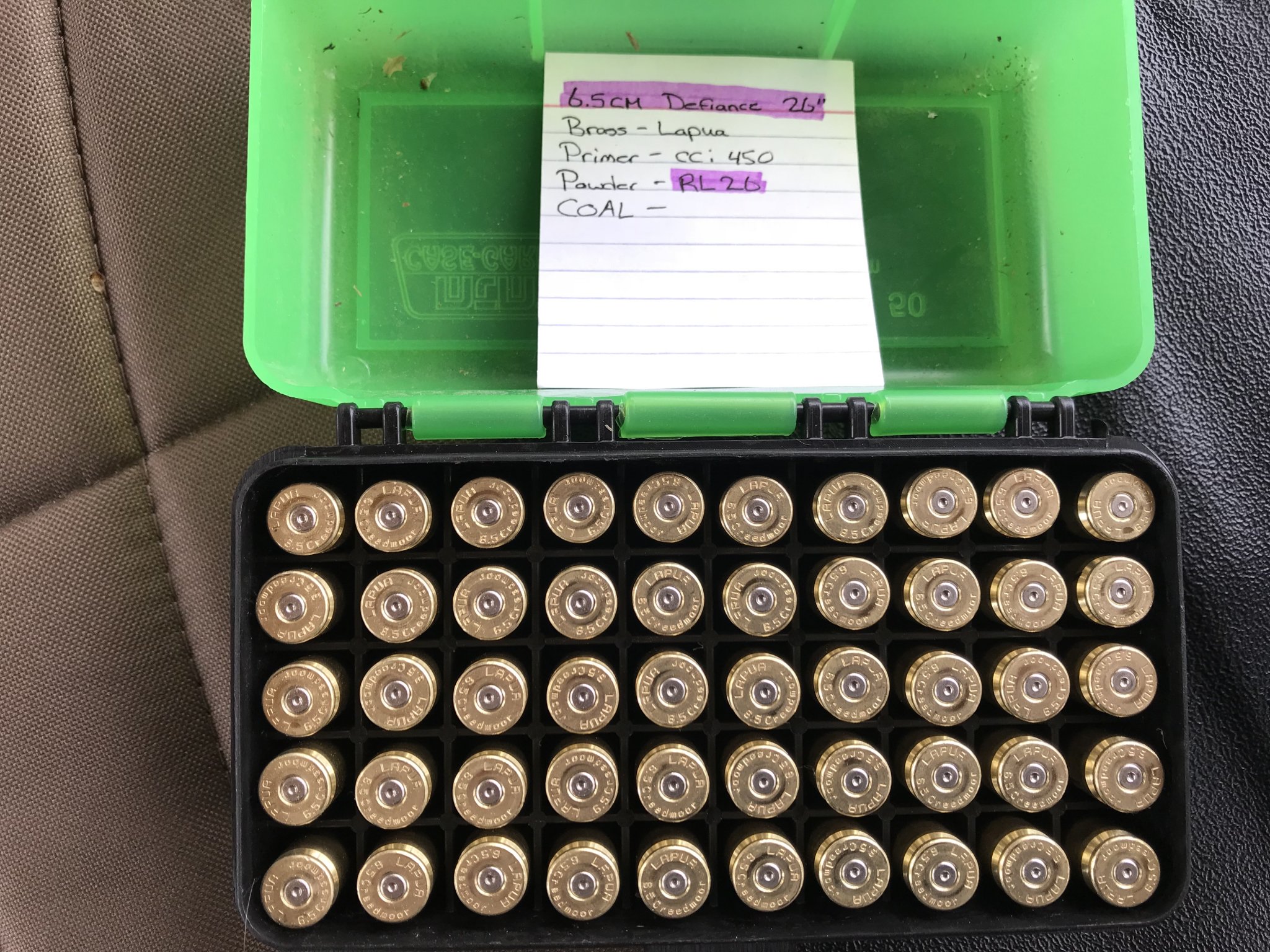

So for this test I really wanted to focus on the RL26 due to the high velocities I was getting in the previous test. If I could Tighten up those groups and possibly get some lower SD's and ES's then I would have a sure fire winner. I also wanted to see what more I could do with the RL16 and H4350. I really wanted to get the RL16 to shoot well, so I thought I would give it one more shot. We all know H4350 shoots well already, but I wanted to see how well I could get it in my rifle. I did not focus on those as much though, seeing as how I really wanted to put my effort into the RL26.
I loaded up 50 rounds with RL26. Starting at 46.3 up to 47.2. I wanted to do .1 Gr increments to see if I could find some flat spot in my velocity and pick something in the middle if possible. In the last test the rounds were seated to be .020 off the lands. In this new test I decided to go a bit closer at .015 off the lands. Below are the results and I would say it was a big improvement in group size but the SD/ES are still a bit high for my liking. I did find 2 flat spots in the velocity which is nice. Temperature was +3 c higher than the previous session and velocities clearly showed and increase due to temperature.
46.3 Is a typo, the MV was 2868.

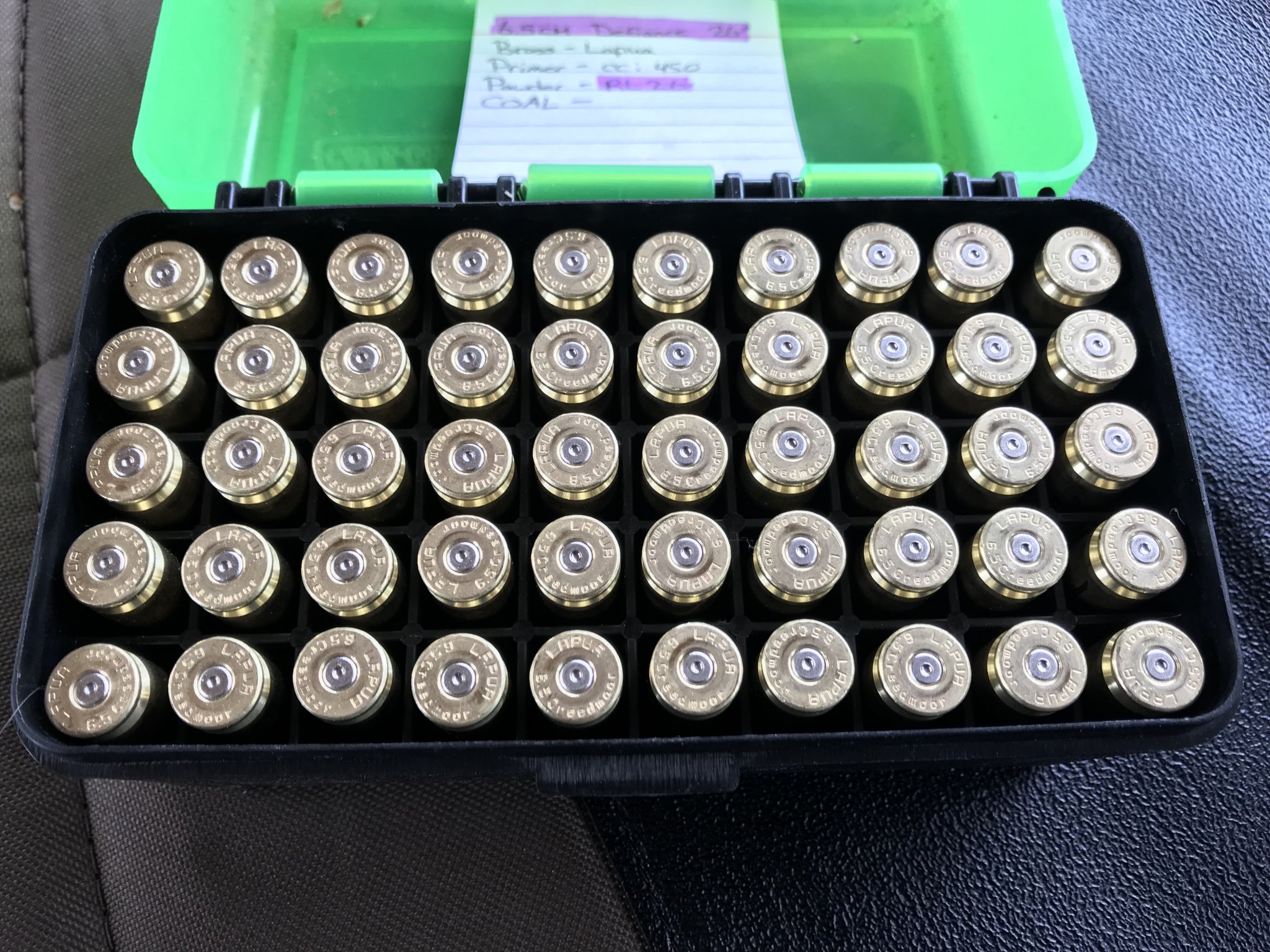

Below are the test I did for the RL16 and H4350. There are some minor improvements and I would like to explore these more as well. The RL16 seems to be promising but finicky in my rifle. I will do some more testing with this in the future and post some more results.

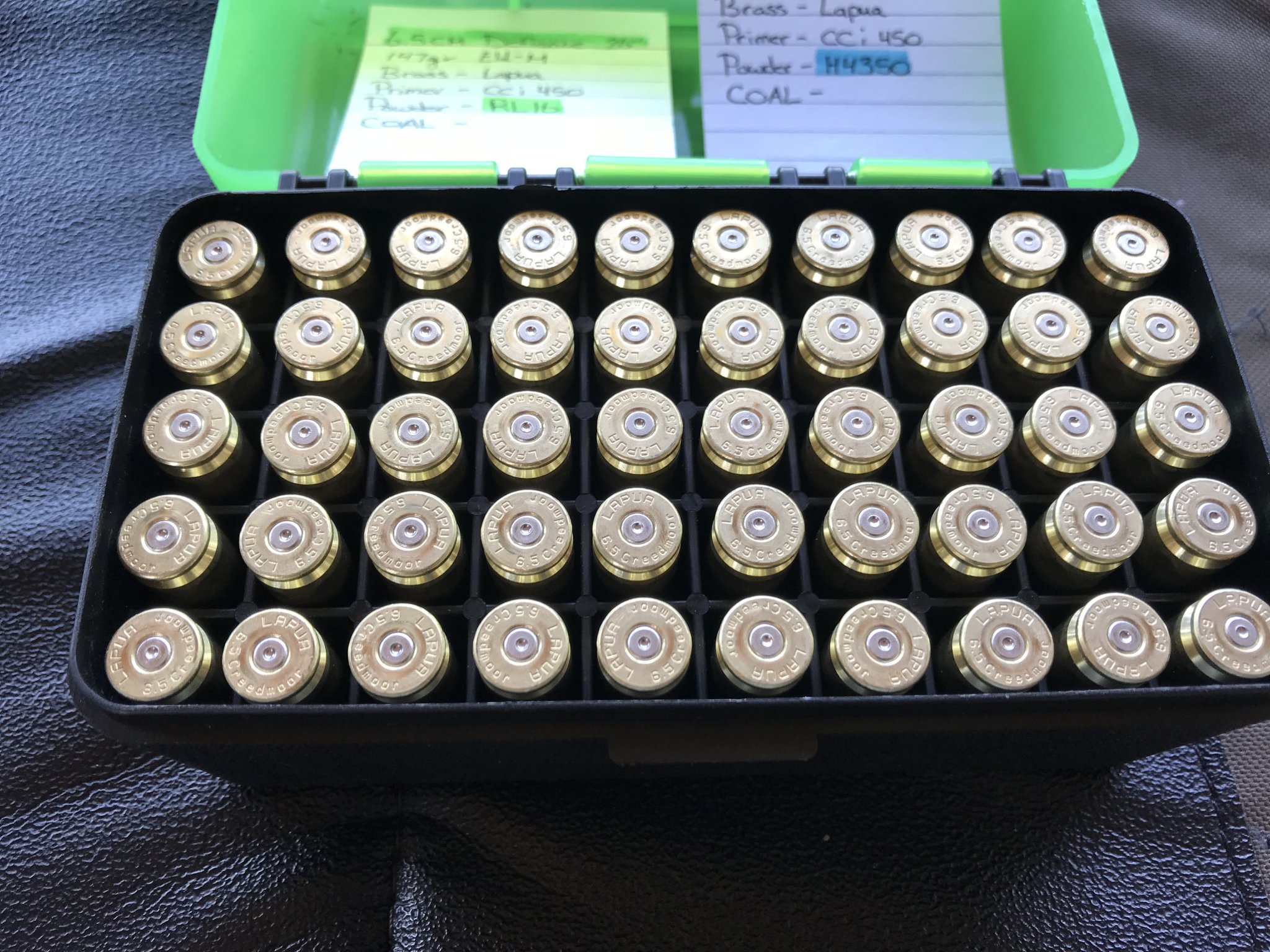

The brass below are RL16 and H4350. The 5 rows on the left are the RL16 and the 5 rows on the right are the H4350. The charge weights are ascending from left to right.

So In conclusion I am very impressed with the results. I never thought I could reach the velocities with a 147 out of a 26'' Barrel. I also took some pictures of the fired brass for you this time, to show you that I was not blowing out primer's and splitting brass. There are some signs of slight primer cratering the highest loads. For myself, I still felt safe and they were in my comfort zone. I will let you guys be the judge.
If any of you have any suggestions, input, or anything to help me out in any area it would be much appreciated. I hope you have all found a use for this data, and that it helps you out when trying to pick a powder for your 147 Gr, 6.5 Creedmoor loads. I know when I was searching, info was scarce and hard to come by. Happy Hunting and I hope this helps you guys out!

I really like the looks of the 45.2 grains of H4831sc myself. I know the group is over an inch, but it has the least amount of vertical stringing of any group I've seen so far. This is the group I would work with personally. It also has a low es and sd, which I like. I would take that load, and continue to play with multiple seating depths, to get your horizontal stringing together. That group has great potential. My 2 cents.
Edit: I always look for the best es and sd group I get with the least amount of vertical stringing. Once I get that far, I take that group, and play with seating depth. Works for me 99% of the time.

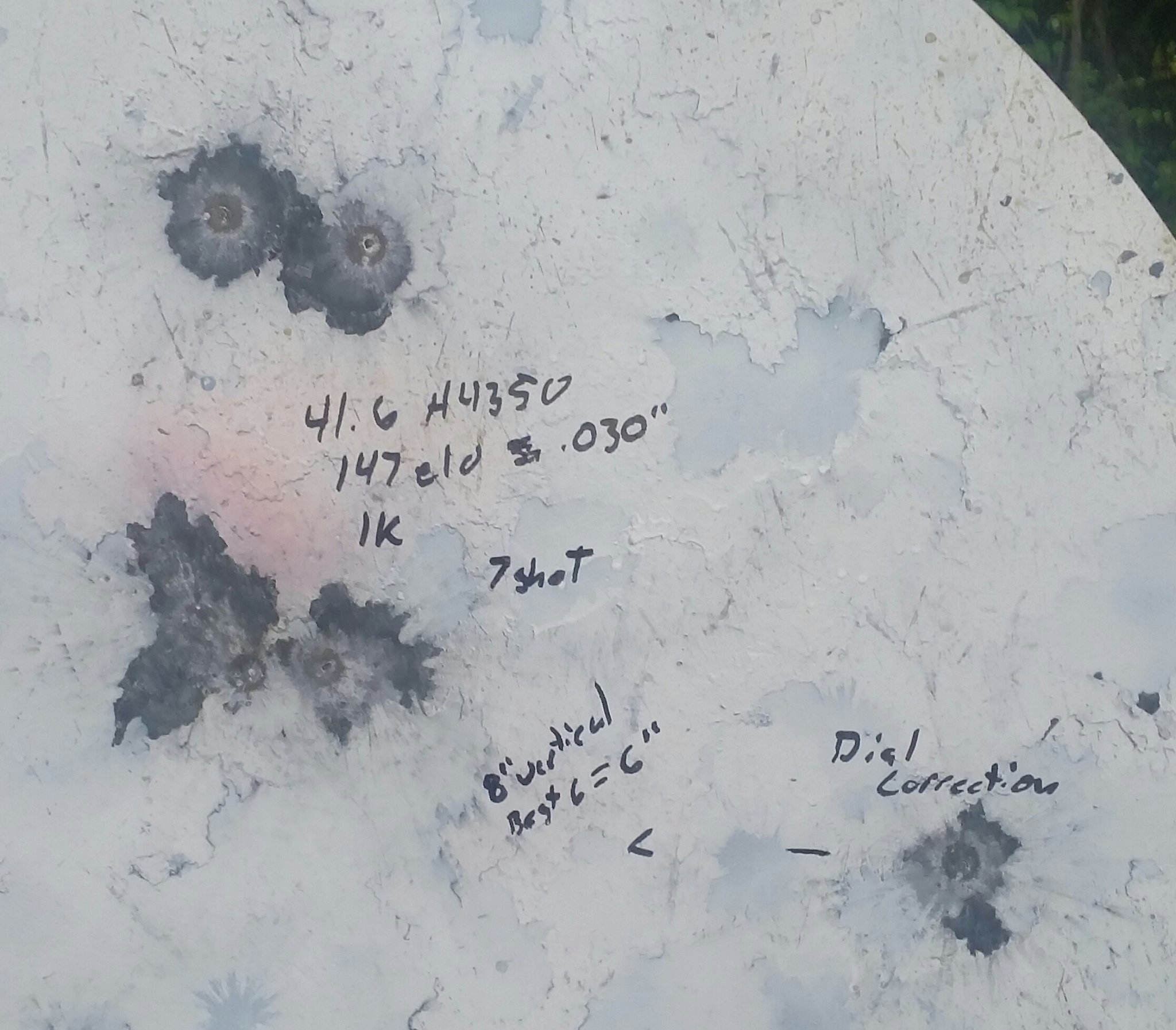

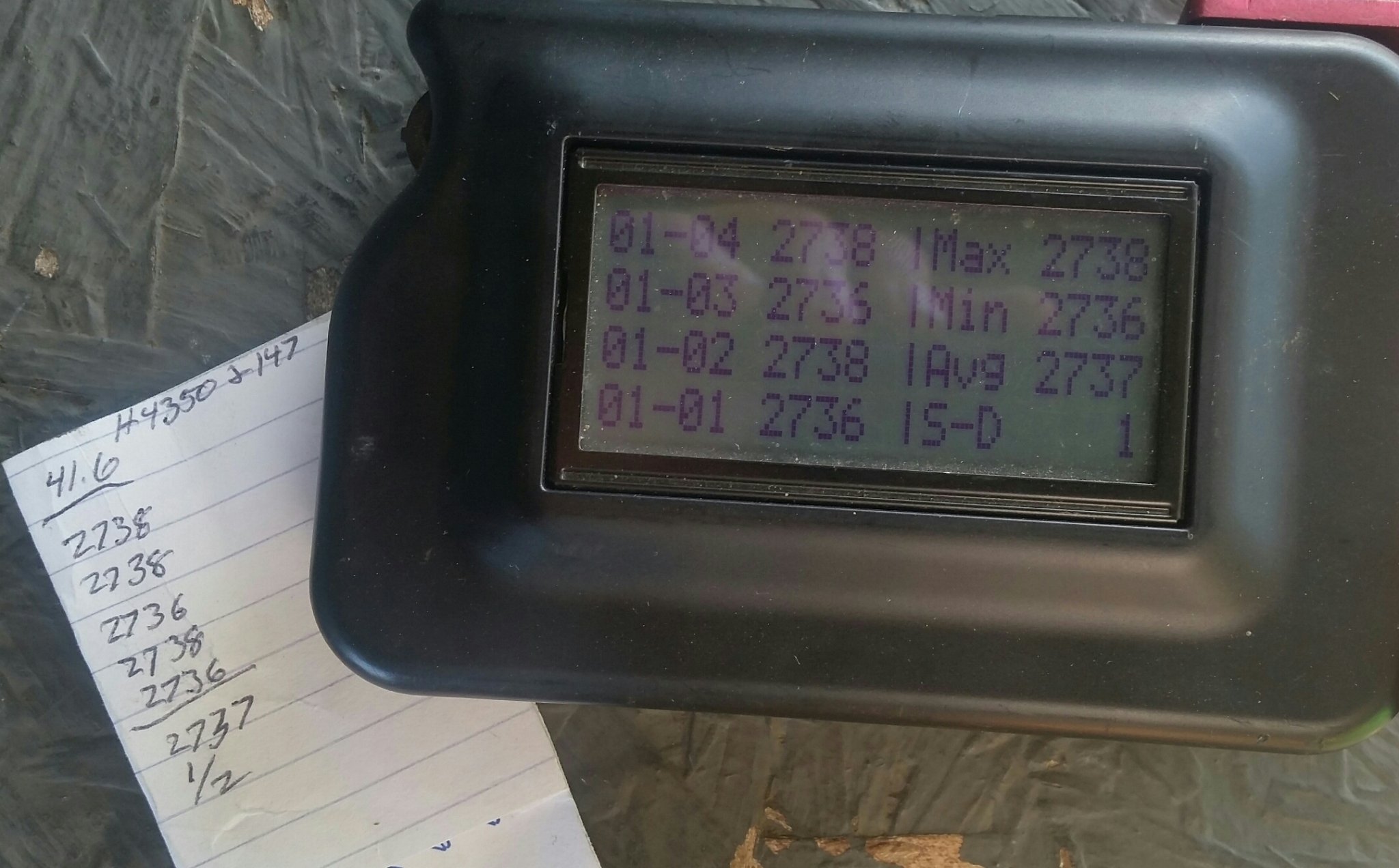

Rob, what load did you settle on that's above 41gr? I am at 41.6... makes me wonder if I'm right in the scatter node. I just started working with this round a little over a month ago and have not run a full load work up yet with H4350. A scatter node would make sense for what I'm seeing down range at times and how narrow the powder charge is.
It shoots well but a tenth either side es goes nuts.
I use 43grns of H4350 in Hornady brass.

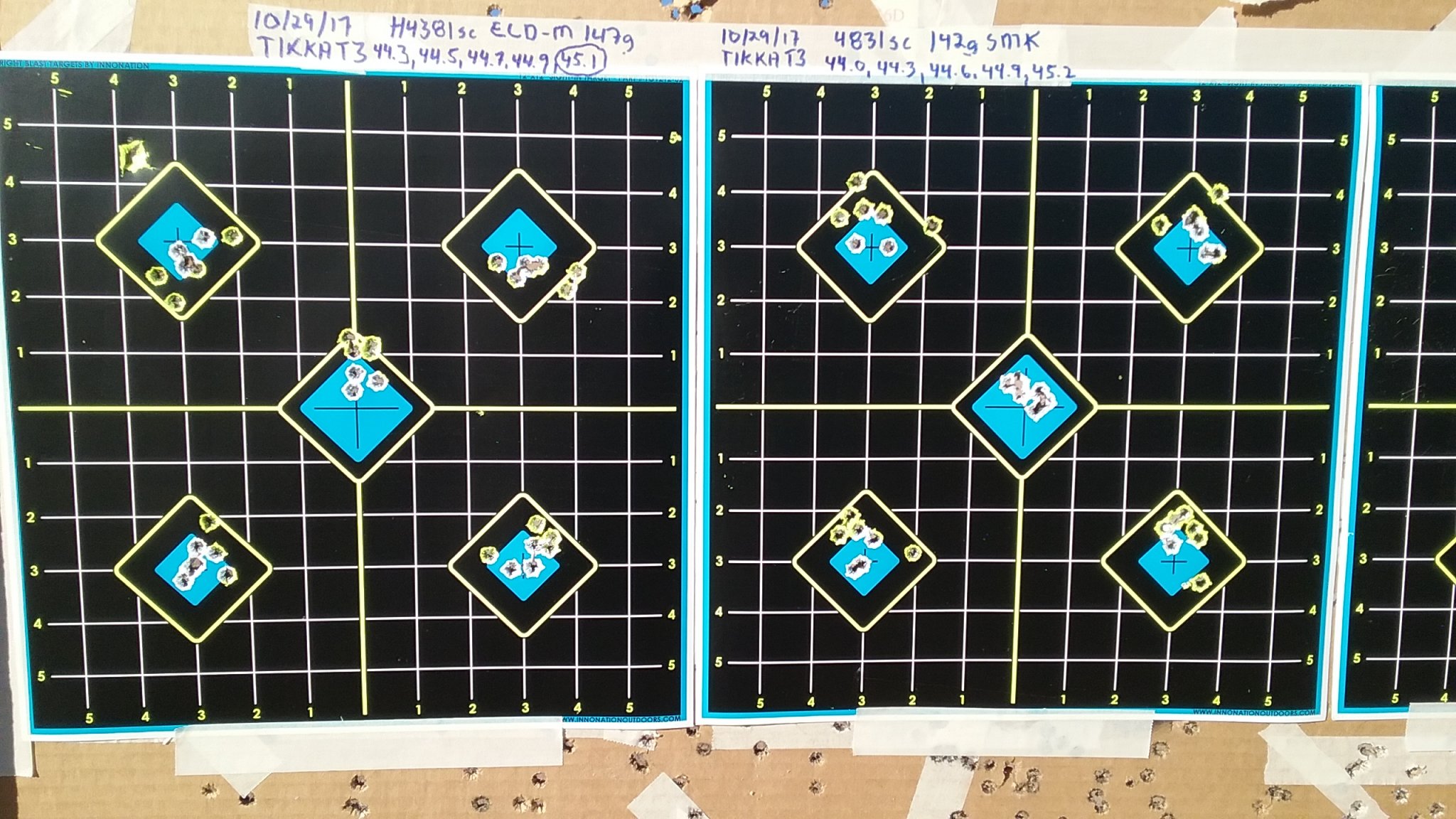

45.2g of H4831sc and 142g SMK's gave me my best results, with 45.1g of H4831sc and 147g ELD-M's. The groups are a bit large as I forgot a front bag and was just using the Harris BP. This gun shoots sub-moa with both factory ELD-M and my handloads.

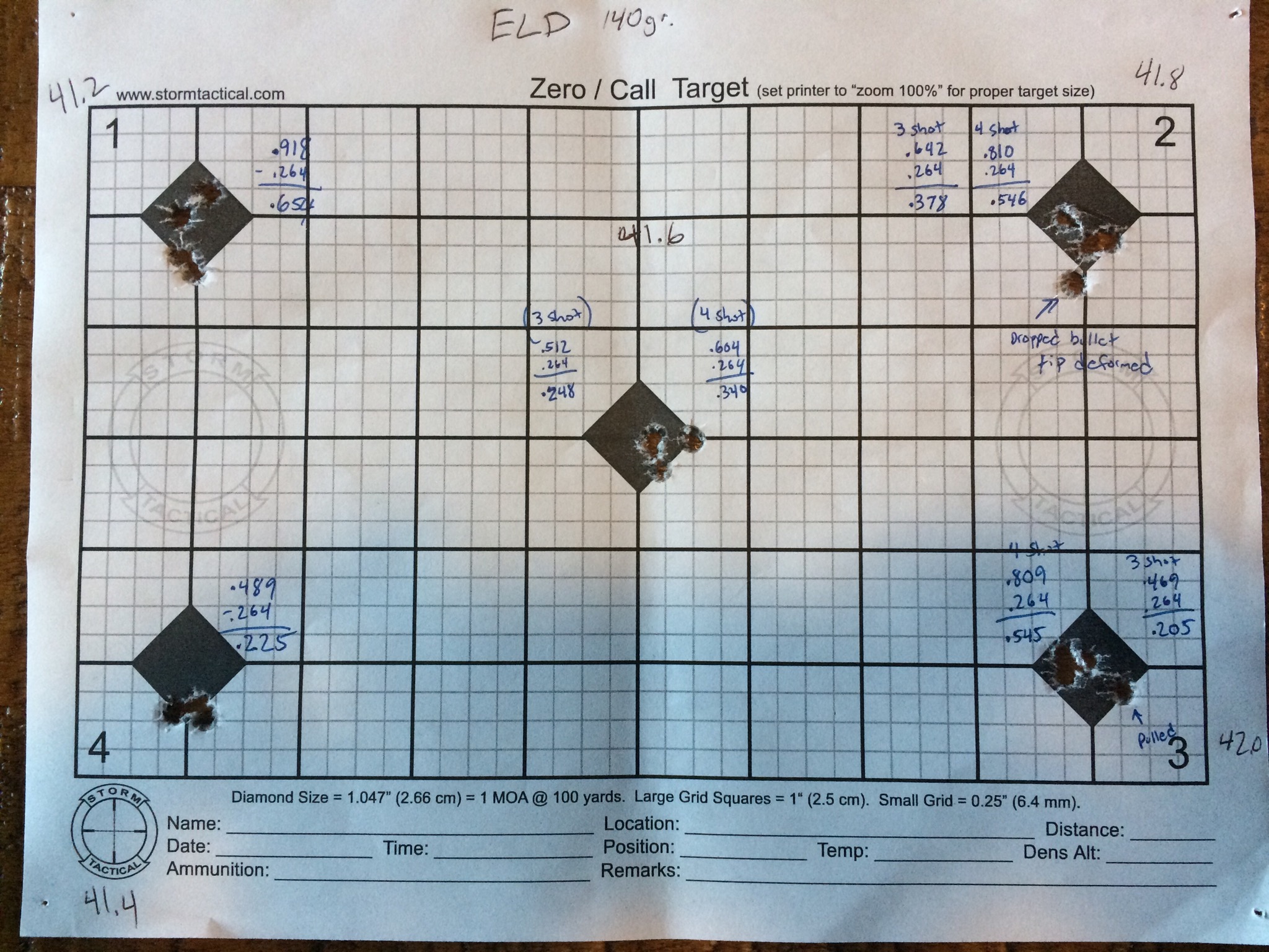

I went with the 140 gr ELD-Ms. Still developing but my rifle likes anything close to 42 grains of H4350. Goal for mine is sub 1/2” MOA.
