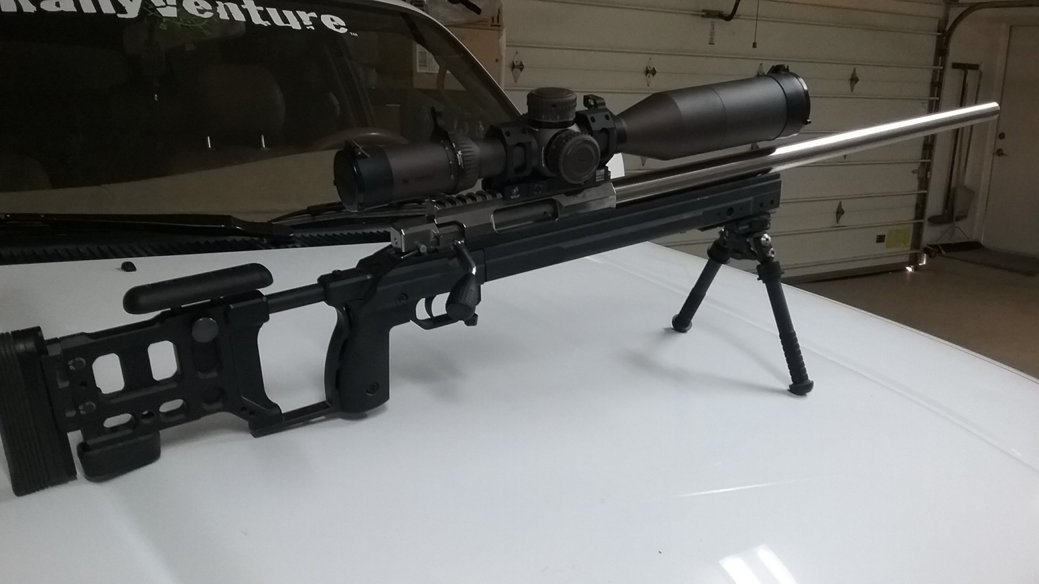

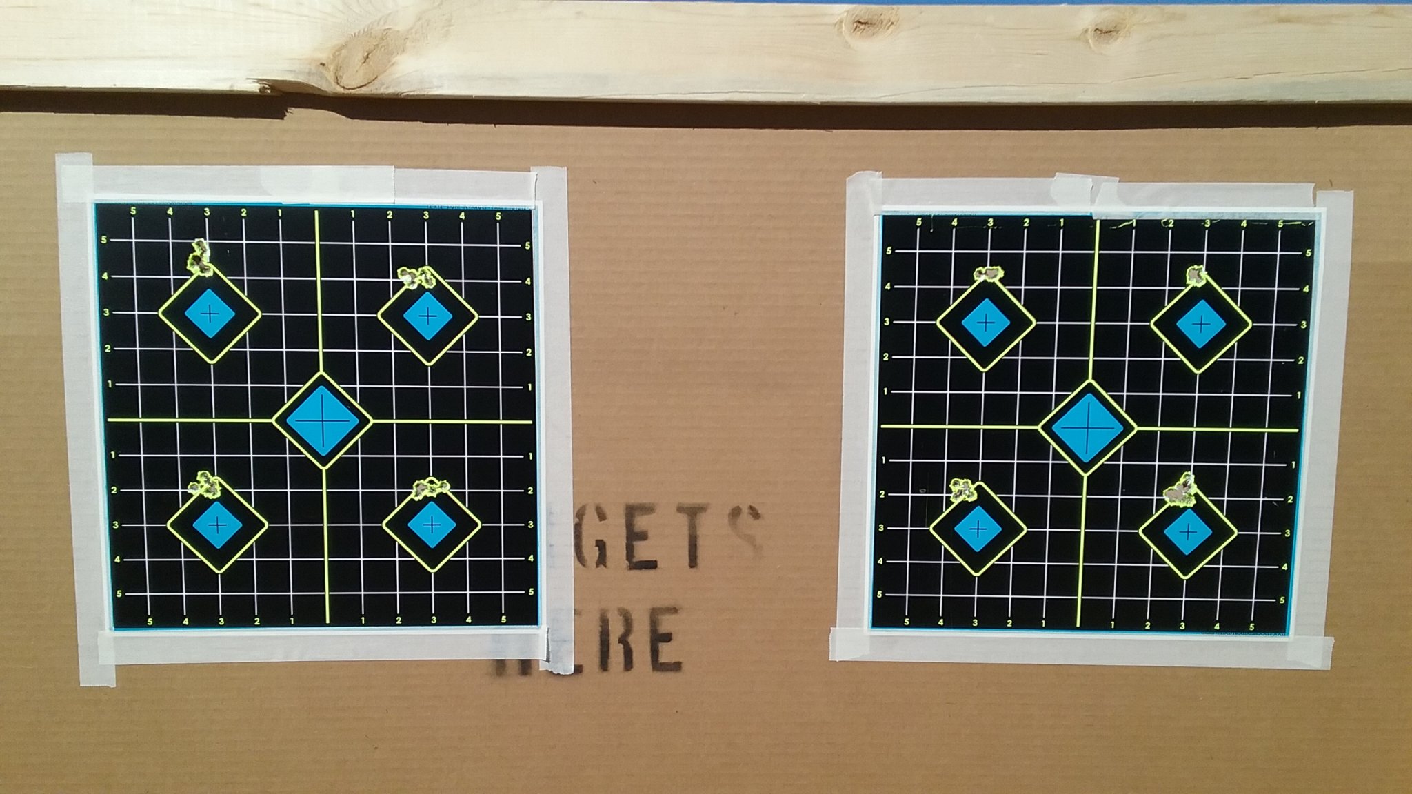

So I have been lurking for a while now, I have made a few posts here and there, but nothing with much contribution yet. Now it is time to put up some meaningful data for all of you. I have noticed it can be hard to find load data on the Hornady 147 Gr ELD-M for the 6.5 Creedmoor. So I did some research and bought a few powders that interested me for this. I chose 4 different powders, loaded up 50 rounds of each, took it to the range and here are the results for anyone who is interested.
The powders I tested were RL16, RL26, H4831 SC, H4350. After testing all four I had great results with all of the in different ways. I will let you all be the judge of what might work for you. This data will hopefully help anyone trying to choose a good powder for the 147 ELD-M.
Use Caution when using any of these loads, be sure start low and work your way up. All these loads below, start high and get over recommended charges. Don't be a fool and blow up your tool.

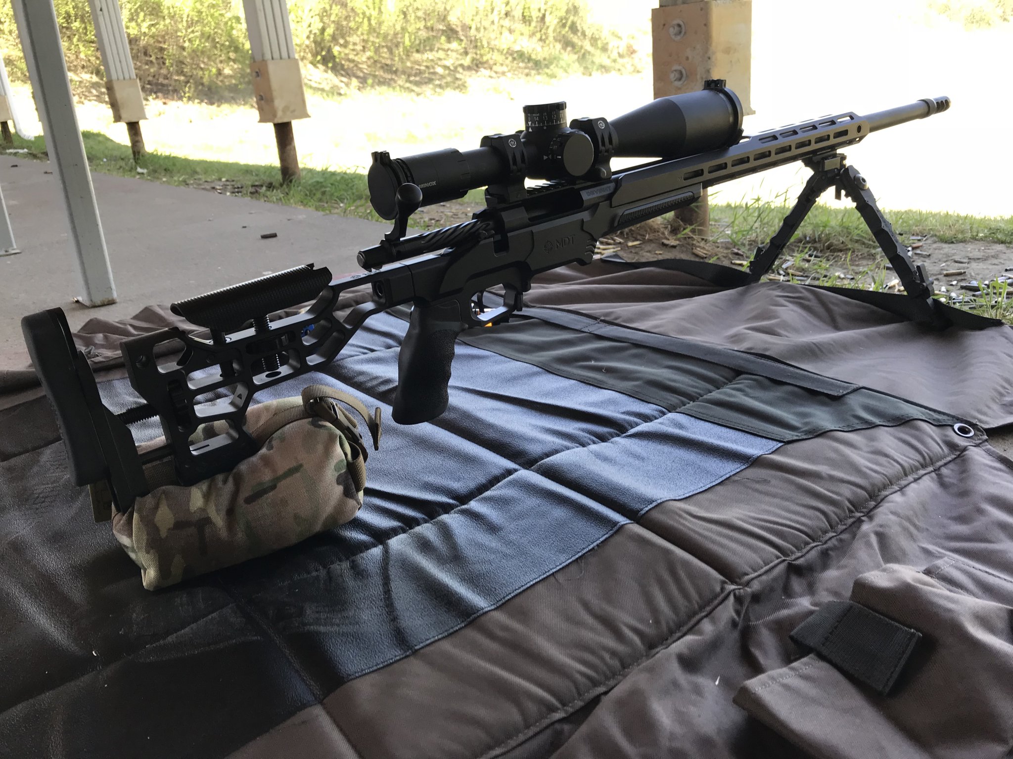

The Rifle
Action - Defiance Deviant
Barrel - 26" Krieger 1:8 MTU
Break - Area 419 Hellfire
Trigger- Timney Calvin Elite 2 Stage
Chassis - MDT ESS
Rings - ARC M10 Medium
Scope - Minox ZP5 5-25x56
The Ammo
Brass- Lapua Small Rifle 6.5 CM
Primer - CCI 450
OAL - 2.263
.0020 Off the lands
Testing was done at my local range at 100m. Temperature was 22c with 30km wind gusting to 60km. Altitude was 805m above sea level. Sorry but all you guys from the USA will have to convert that from Canadian on your own.

After doing these tests I thought I would have a clear winner but now I just want to test these all more thoroughly. So this test has turned into phase 1 now. I will see what kind of fine tuning I can do to these in the future. I will keep you all posted when phase 2 is completed and I will post the results for you all.

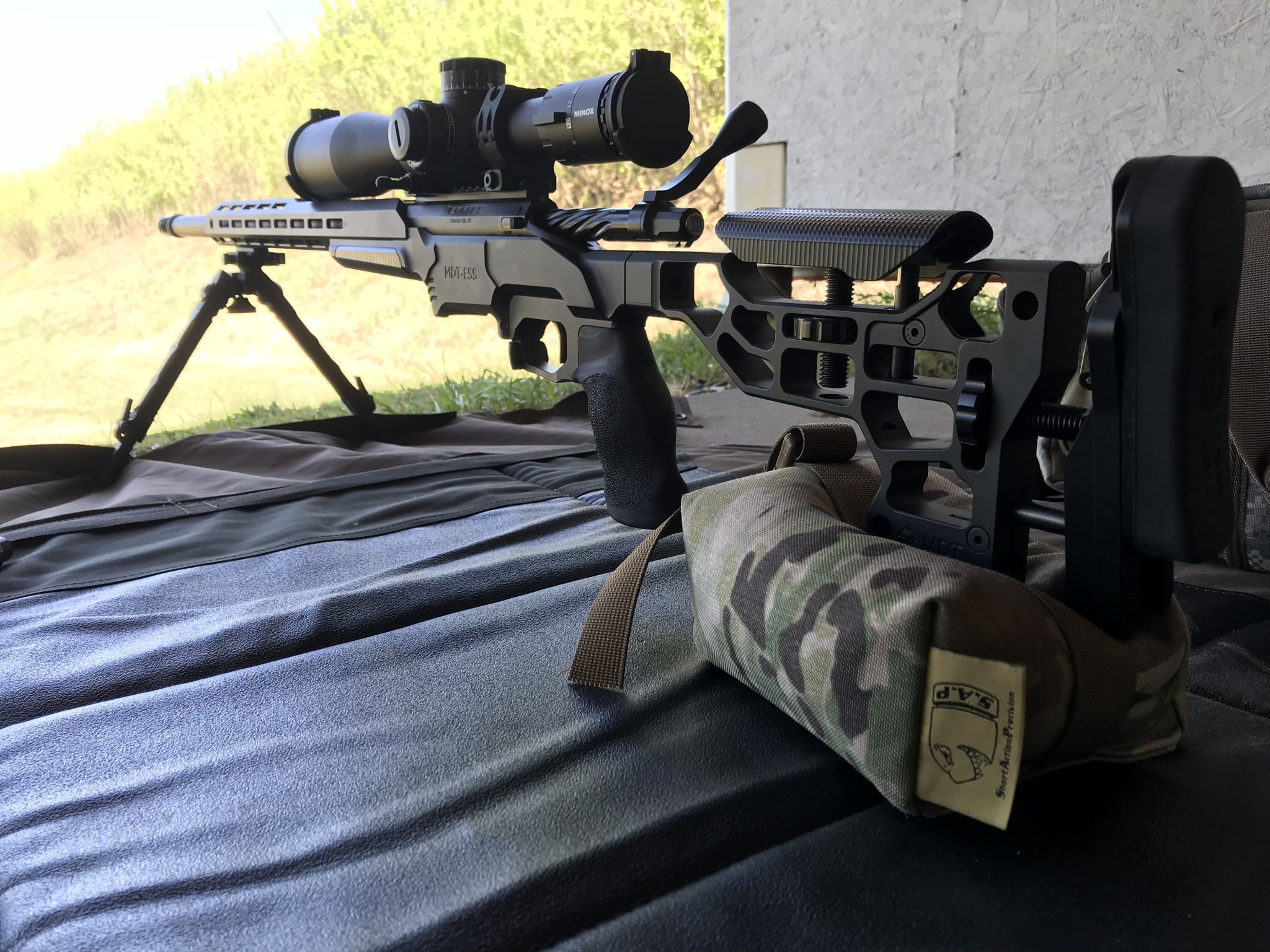

    Here's some results from a 24" Tikka T3x CTR. I started buying H4831sc when H4350 was so scarce, and have now standardized on it for PRS loads. Although the H4350 gave me some good groups with low SD, 45.2g of H4831sc and the 142g SMK's was a sweet spot.
    October 29, 2017 413 PM.jpgOctober 21, 2017 937 AM.jpgr my PRS loads.

    I was getting discouraged with my initial groups, considering how well my other Creedmoor was doing with various loads, but that 45.2g of 4831sc was a sweetspot, been using it ever since.

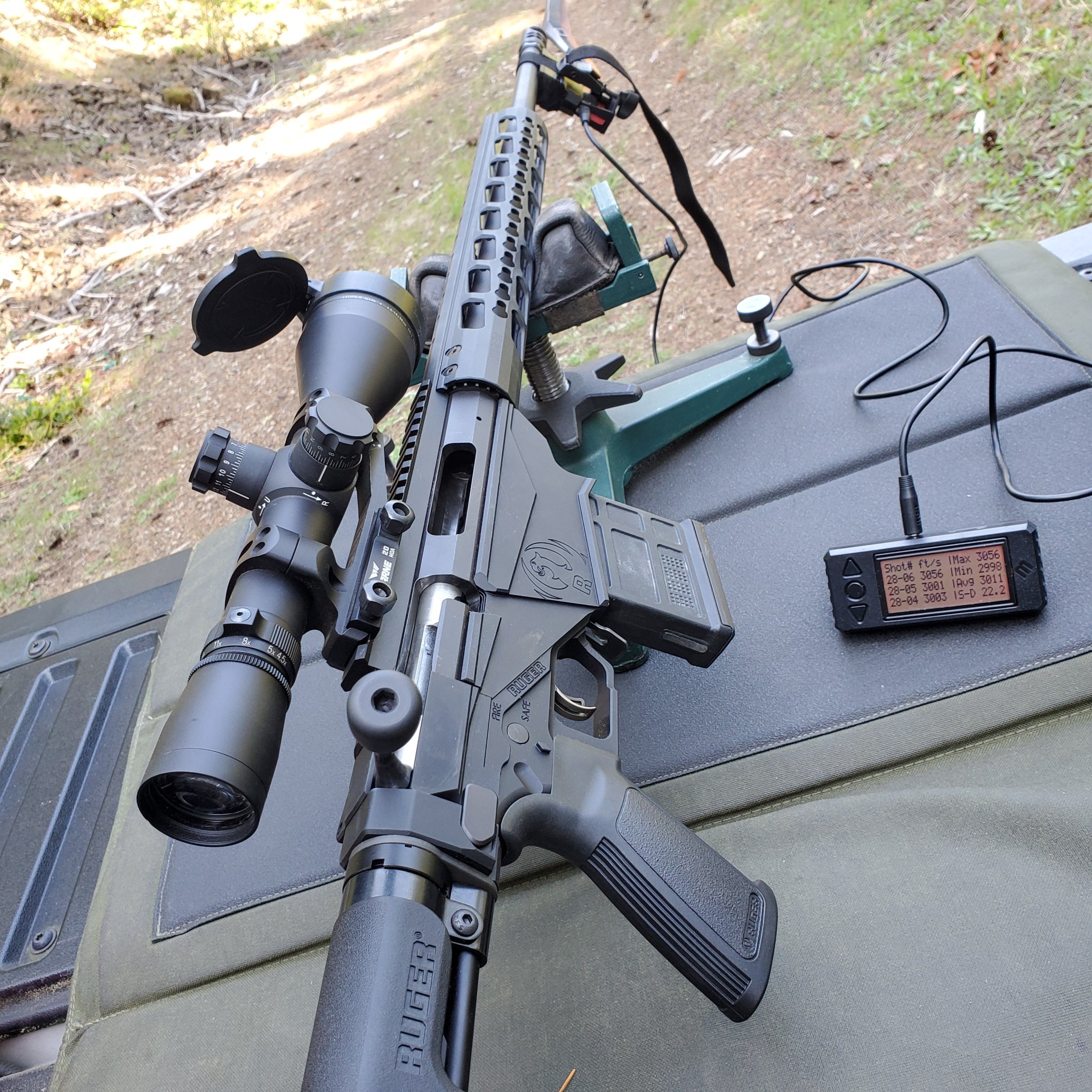

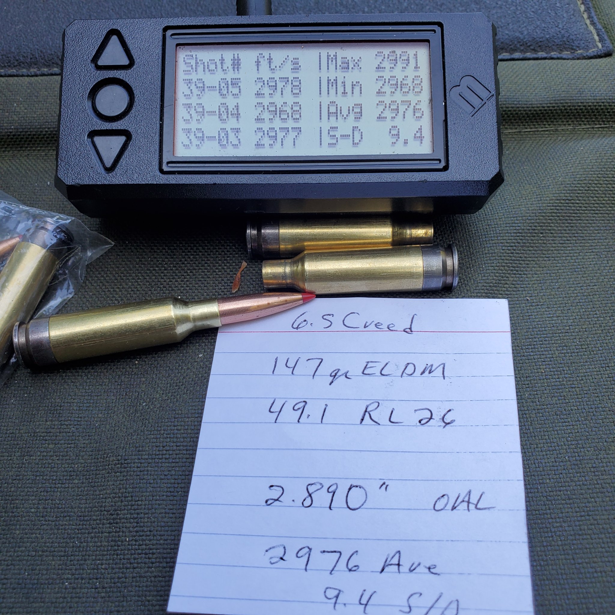

    Just did a pressure test with 147's and RL26 today in my factory Savage 10 - 24" barrel.
    Got to 47.5 and didn't really have anything on the case that'd concern me pressure wise... I just can't stuff anymore powder in the damn case lol
    At 47.2 and 47.5 I got 2836fps for both.
    Going to try 47.3 and see how it groups and how ES looks.
    If I could push 147's at 2830 on regular basis that'd be pretty legit.
