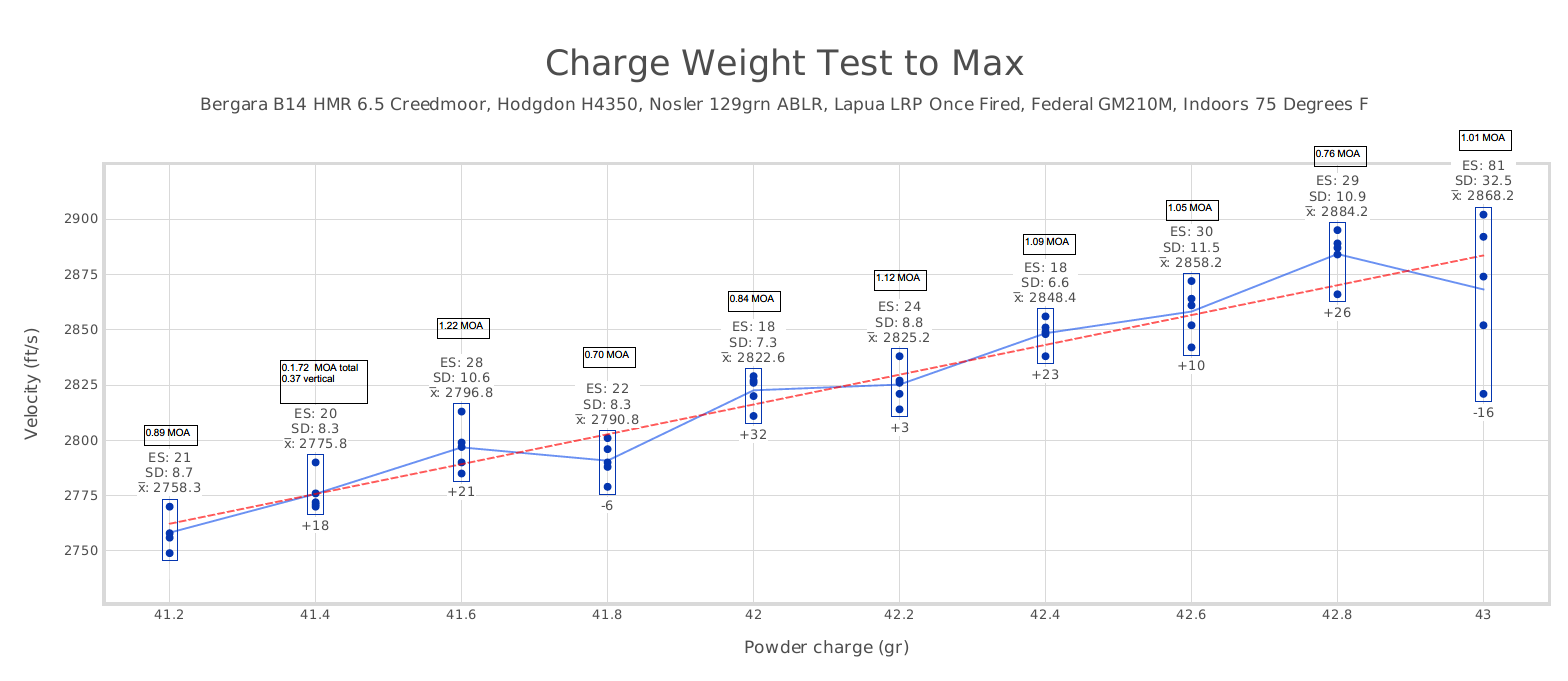

    Watching this as well, am starting with 1x fired 6.5 Creedmoor Lapua brass from a Berger factory load, GM210Ms, H4350, and the 129 grain ABLRs. Will keep you posted if I get around to load development before anyone else replies.

    Sorry for the long delay on this - my initial data on the combination I mentioned earler is below -
    I should mention that I only have polymer AICS magazines and as such, am limited to a COAL of 2.86 (CBTO 2.1400) which has me jumping 0.063 to the lands. The group size is probably right at the ragged edge of what I'm capable of holding, but figured I would include to show that only a few behaved real unruly. From my understanding of small sample size issues, I'll probably do a batch of 50 at 42.1 Grains and see if the numbers stay put over a larger sample, but from what I see so far, totally acceptable results with this combination.
    Hope this helps.
