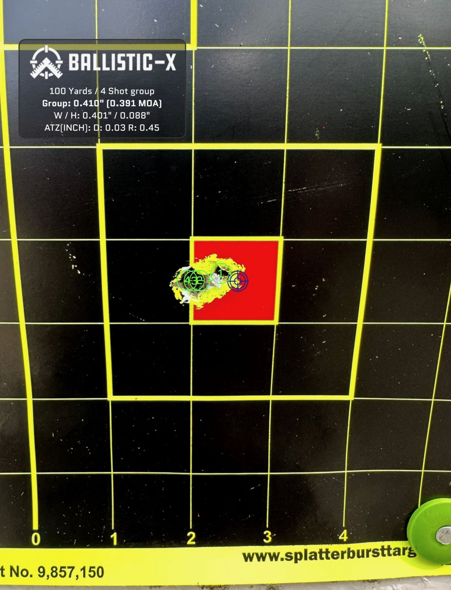

Buy a couple of boxes of FGMM 130 grain. The cartridge uses the Berger OTM bullet. MV out of my 26" barrel is 2950. It is outstanding consistency. This is one of many groups and not the smallest.
Speed kills...hint
Speed kills...hint

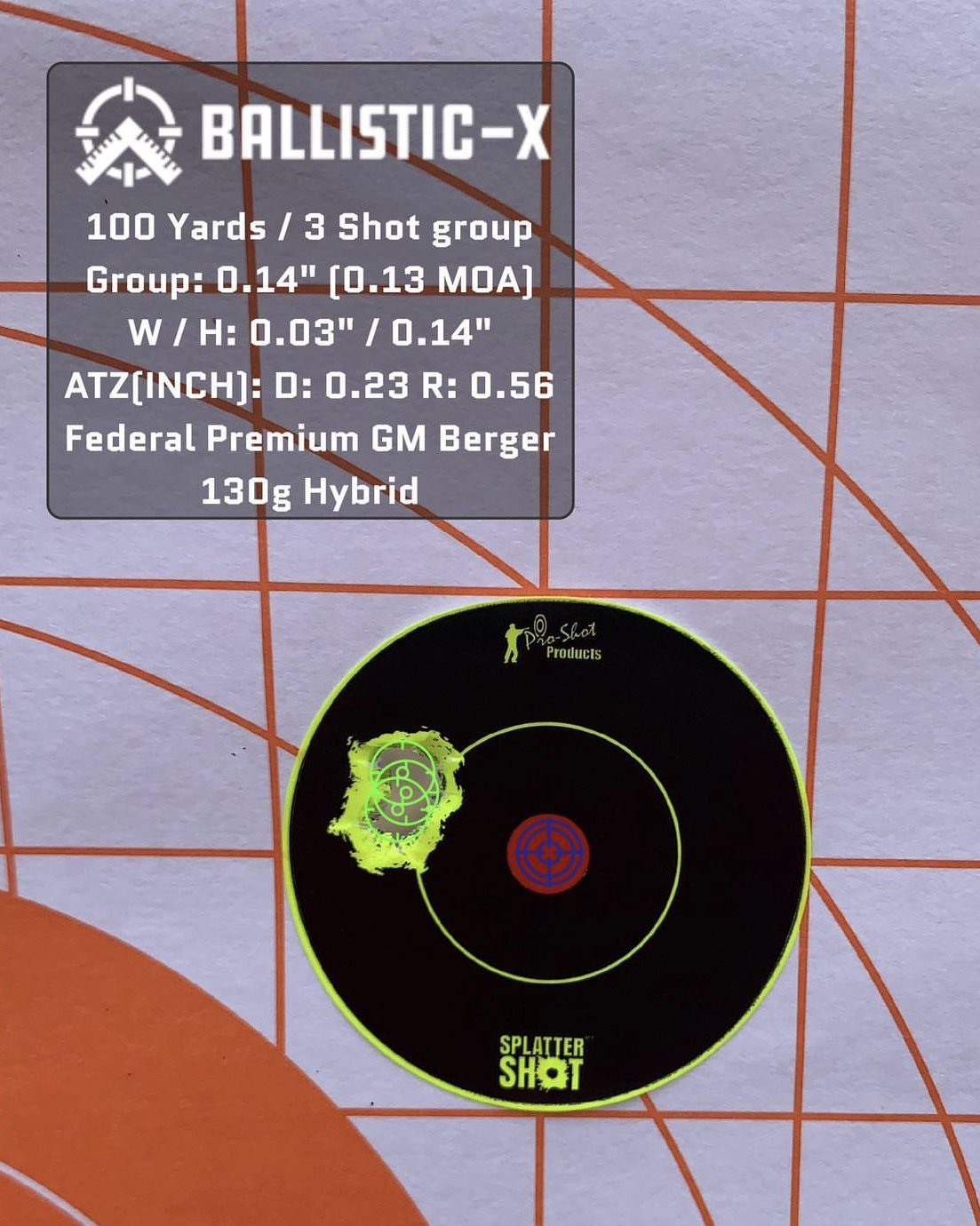

Same same
