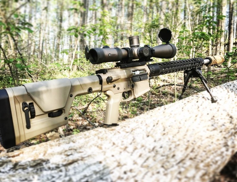

I also have my PST 6-24X50 FFP EBR-2C MRAD scope mounted with a Vortex Cantilevered 20 MOA mount. Here is a pic of my rifle in its current form.

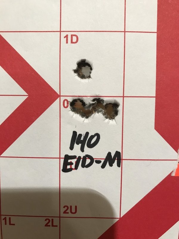

Here is the target from the 140 ELD-M and H4350 load combo. The rounds were shot round robin and the lower right square was one shot from a bullet in the box that was missing it's poly tip. Ejection was perfect @ 4 o'clock about 10-12 ft away. Bolt lock back on last shots all the time. I have had no cycling issues with this combo.
charge / avg velocity / std dev / MOA
41.4 / 2637 / 9.4 / ,65
41.6 / 2650 / 8.4 / .53
41.8 / 2663 / 8,2 / .44

Nice results and sweet looking rifle. How do you like the Gen 3 PRS?
Thanks for the kind words. I'll have the rail coated soon, but I wanted to get it together and try it too bad to wait on cerakote.
I've never used a fix stock before, so no comparison, but it works rather well. I like being able to use an existing carbine buffer tube. Ive ordered a second one for a 223 build that I'd like to try and get a bit more accuracy out of.

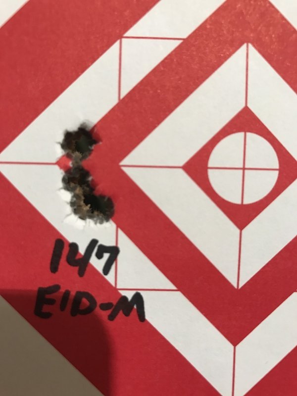

I'll have to do some digging to fine the sd/es but that above load runs about 2690, I tried 147's with the same load on a 30 degree day and it was 2625 and showed a little ejector smear and backing it down to 40.5 it was clocking 2590 and shooting nice and between 1/2 and 3/4" at 100 yards. 41.3 with 140's has shot as tight as 1/2 moa but tends to be closer to 3/4 moa most days... some of which is me for sure, LOL. But I took 3rd place at the Michigan Guardian last fall against some very talented bolt action shooters so it is good enough to win matches.
