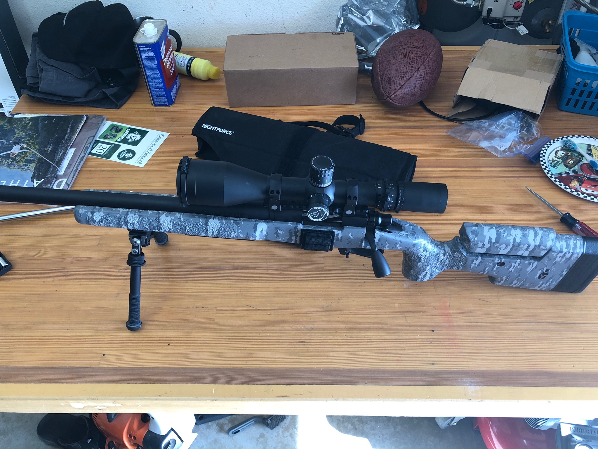

I forgot to add. My 22" Proof CF barrel is running 127gr LRX @ 2997 fps with RL16 and Hornady Brass. 140gr ELD-M @ 2749 FPS with H4350 and Hornady Brass and 147's around 2850-2870 fps (can't recall) with RL26 and Hornady Brass.
I'm sure I can squeeze more out of the 140's with RL16 and different brass but it shoots fine and I have another 6.5cm and extra barrel to play around with and not push it on the Proof.

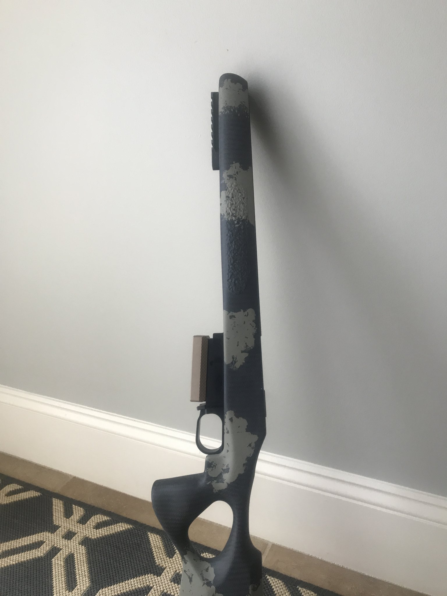

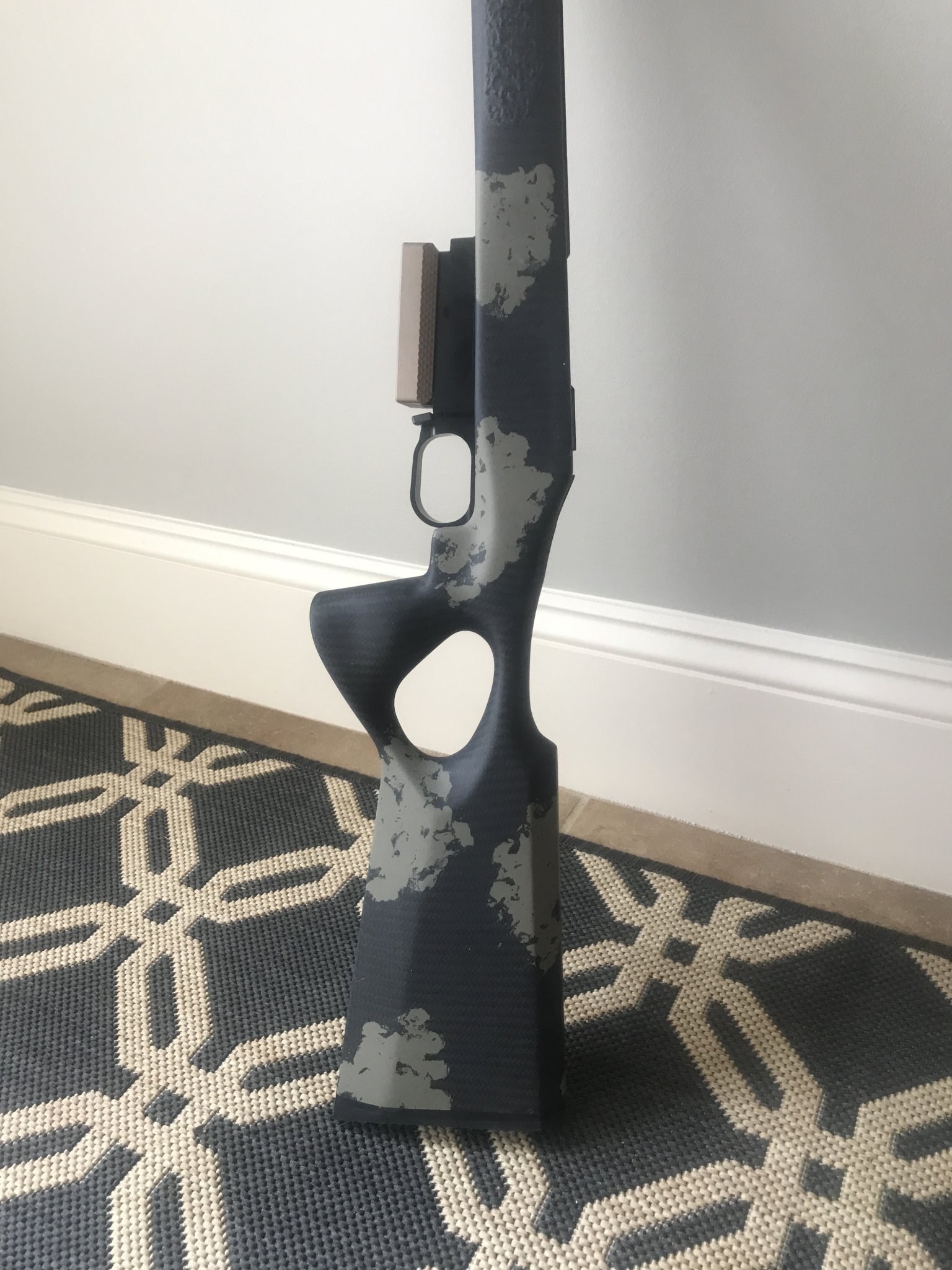

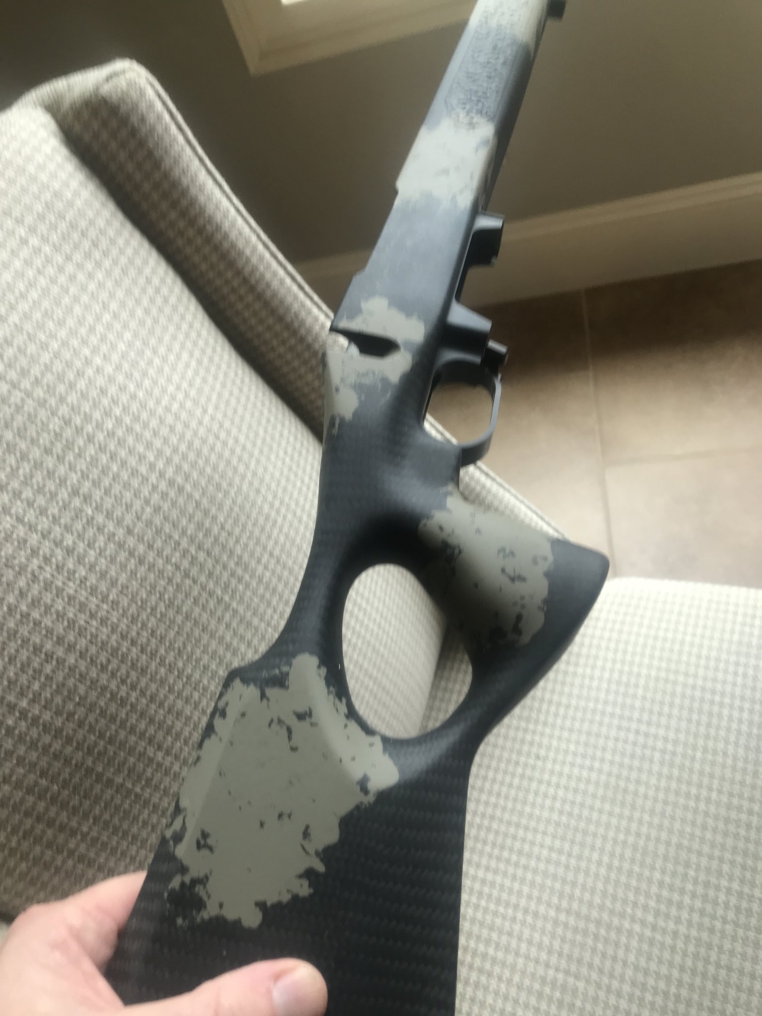

Right now I’ve got a custom Stiller Tac 30 6 Creedmoor with a 22” Krieger light Palma in a XLR Chassis. I’ll be putting it in a Manners HH5 adding the 20” Proof Carbon. Full time suppressed so short barrel is welcome.

This post has been awhile ago but I’m having a barreled action built real similar. What stock is that and what j
kind of weight is the rig? Thanks ahead of time.

Manners PRS2 with the barricade mini chassis. I don’t really remember the weight but I think around 12 pounds or so.
