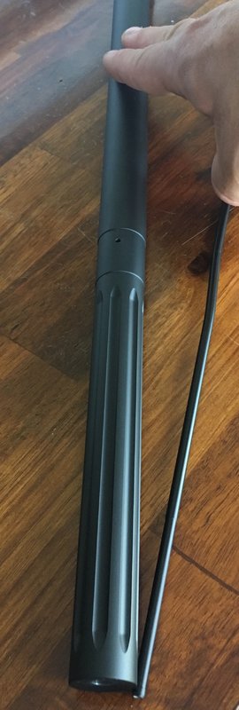

I bought my 6.5mm Bartlein blank from bugholes.com and sent it to Craddock Precision for contouring and chambering. I think for all I still ended up being about the same price as the JP barrels. JP's are good but "I" much preferred a Bartlein for my build. I did use a JP barrel extension though.

IMG_1402.JPG Here's my Bartlein. Craddock didn't do the Cerakote that was done locally by Jon Beanland
