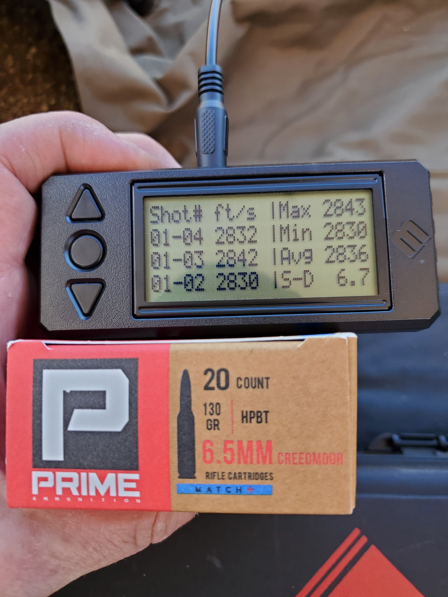

Pretty happy with the Prime today. Groups good and single digit SDs
