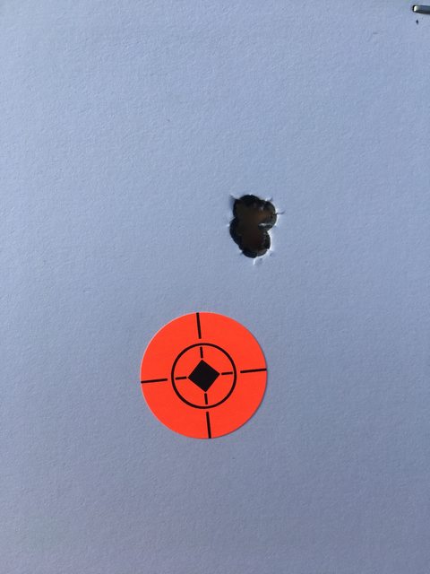

Mitch, I'm new to precision rifles too. I received my John Hancock back in December. I researched, and like everyone here says, H4350 is what most people are using on the 6.5 Creedmoor. I thought, if it works, why screw with it? Soo, that's what I went with. I've thought about trying RL16, but with groups like this...why?
7118774
Good luck Mitch. Work on your loads slowly. Pay attention to what your're doing, and record everything.
Let us know how it goes. I doubt you'll be disappointed.
