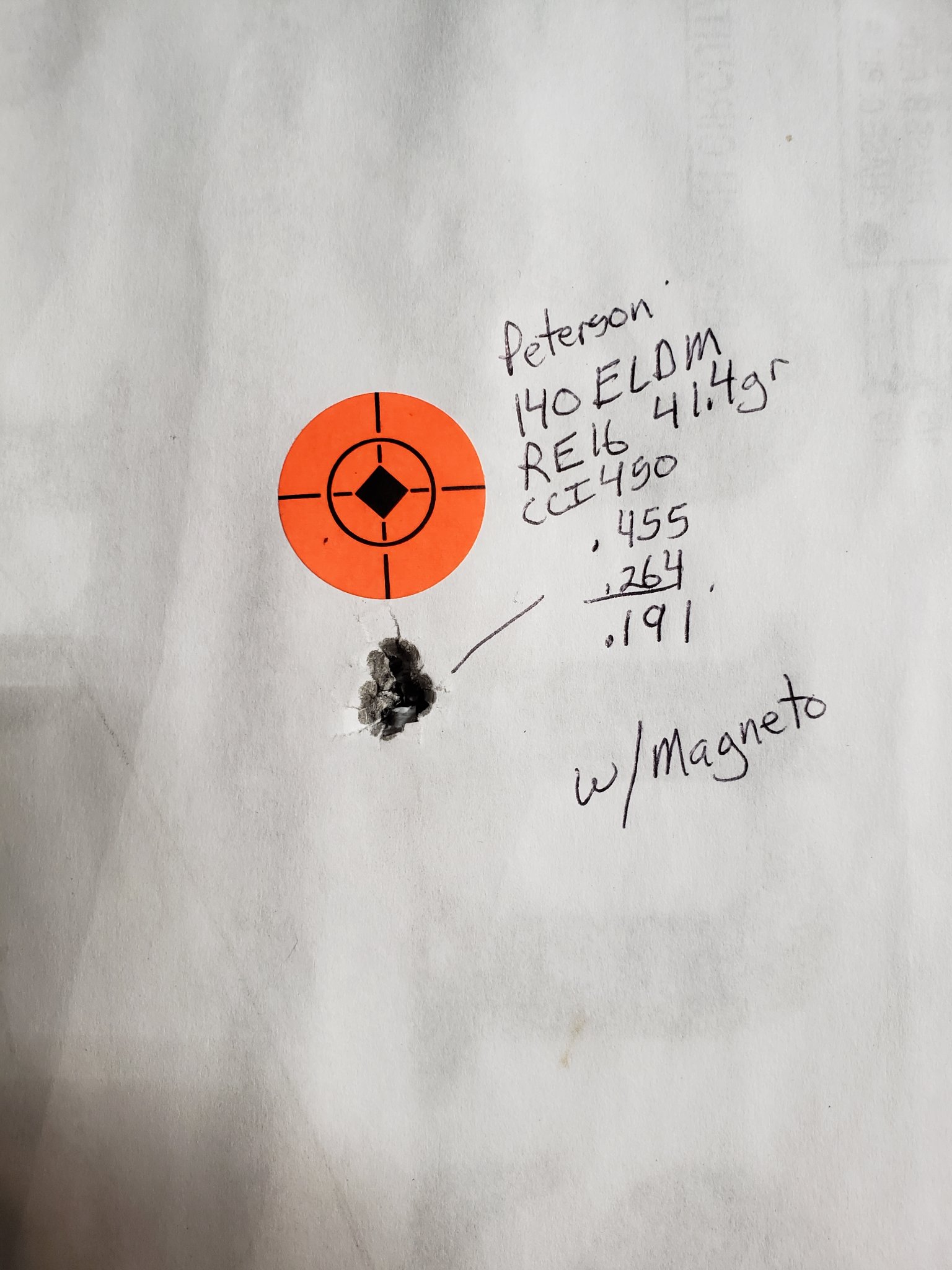

Easy button. Roughly 41-42 gr of h4350 or RL 16, in any brass make, behind any good quality 140 jumped 20 thou.
Yep, 41.4 of RE16 in Peterson brass, CCI450, .020" off the lands = 2830 fps with a SD of 6 out of a 23.5" Bartlein. Attached 5 shot group that was one hole for the first 3.
