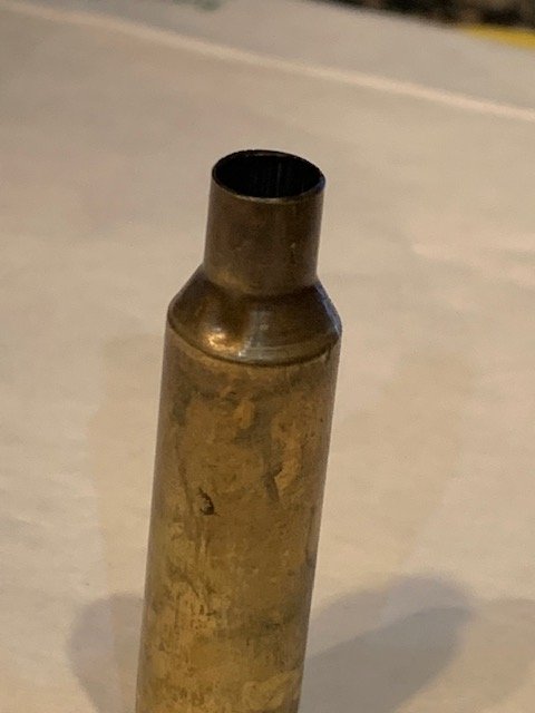

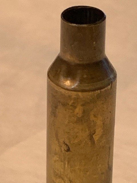

Looking for help trying to diagnose this issue before I trash the die and buy a new one. It's a Redding standard full length sizing die. It's denting random shoulders (about 25%). The dents are similar to if you were to use too much case lube. I've tried cleaning the die multiple times. multiple lubes and even no lube and it still occurs. Brass is Hornady.
Any thoughts are appreciated! Thanks.

Got a pic of these dented shoulders?

Here are some pics. I did add some imperial sizing wax to the base of the case body so I wouldn't stick a case.
If you dont have lube on there then my only conclusion would be that its reducing the shoulder diameter more than the brass can withstand so it buckles.

Definitely no vent on this die. It is shrinking the diameter at the body/shoulder junction about 0.003".

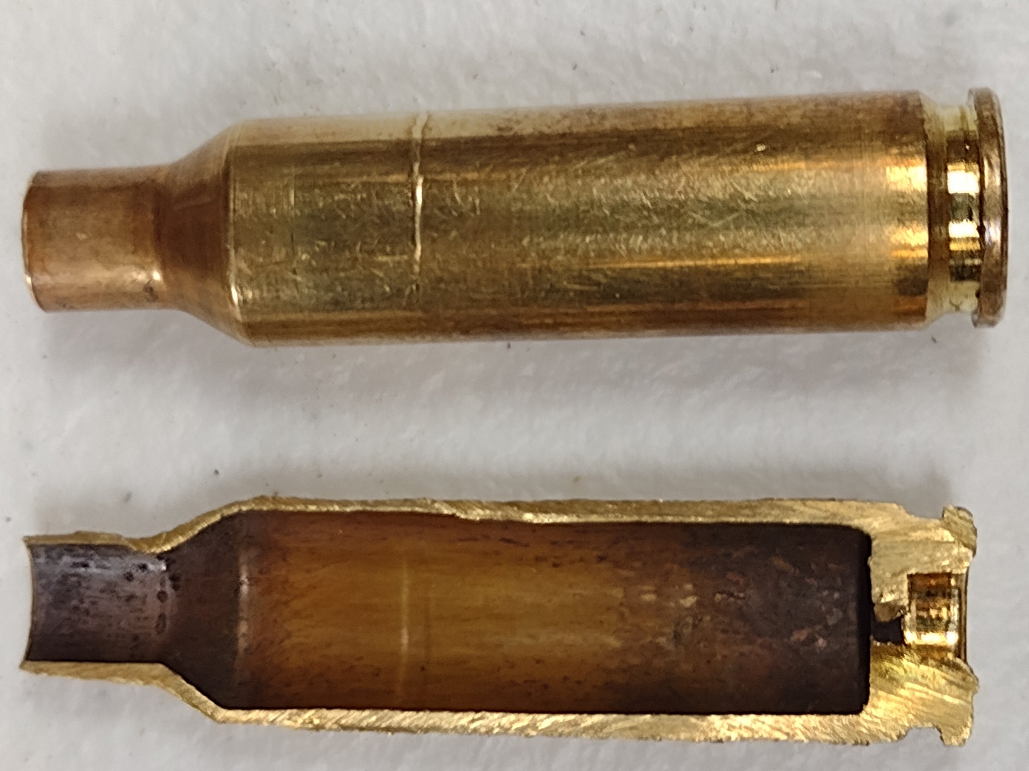

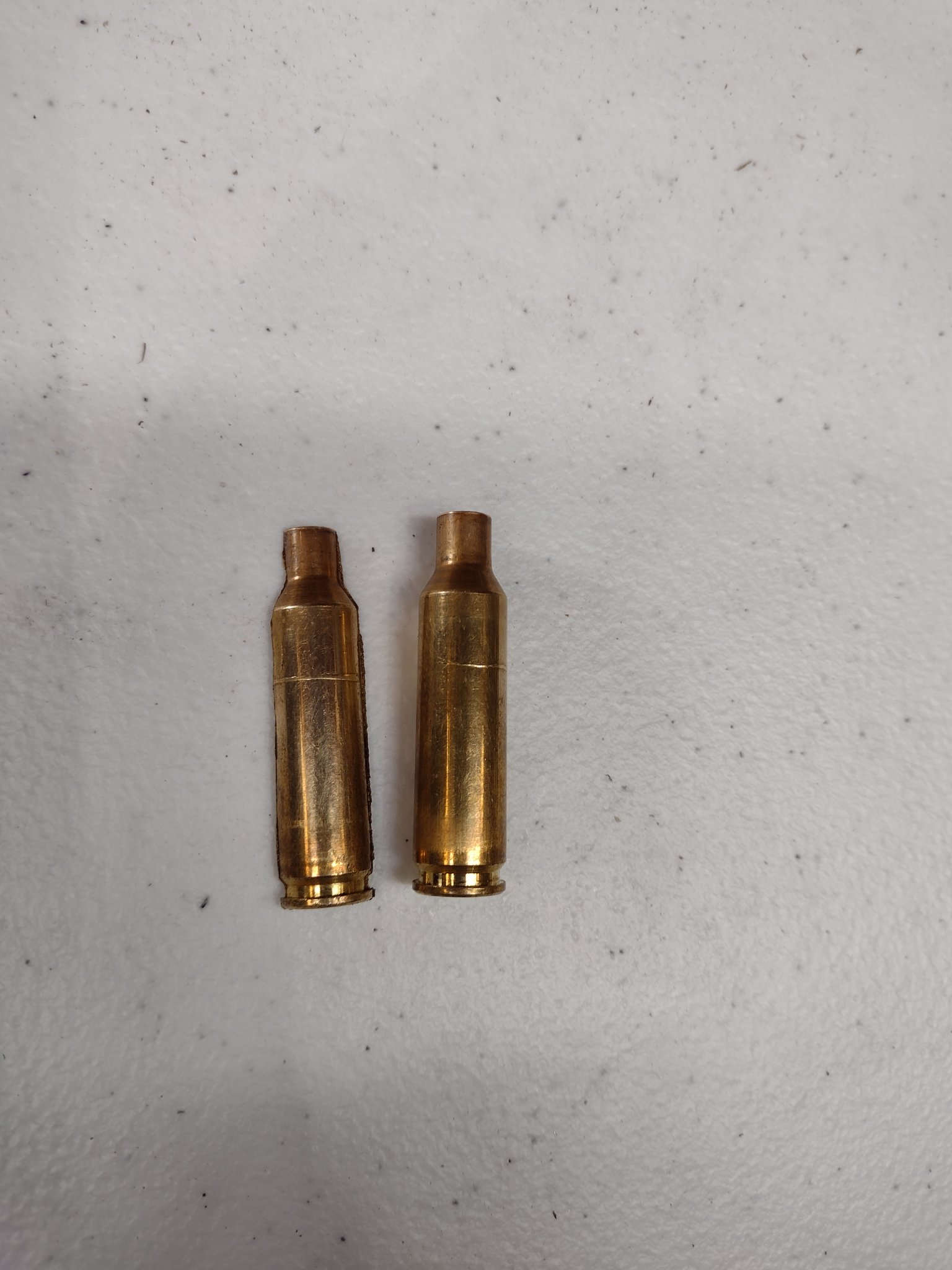

I'm going to add some more questions rather than answers about odd 6.5 cases. Found this is some range brass I bought. There were 10 in a lot of a couple hundred. It looks different than the typical images of case head separation I've seen. Lapua 6.5 creed.
I'm going to add some more questions rather than answers about odd 6.5 cases. Found this is some range brass I bought. There were 10 in a lot of a couple hundred. It looks different than the typical images of case head separation I've seen. Lapua 6.5 creed. View attachment 7844557View attachment 7844558
You ought to make your own thread instead of polluting this one with unrelated crap.
But yes, your cases appear to be separating, toss those and watch the others for similar signs.
