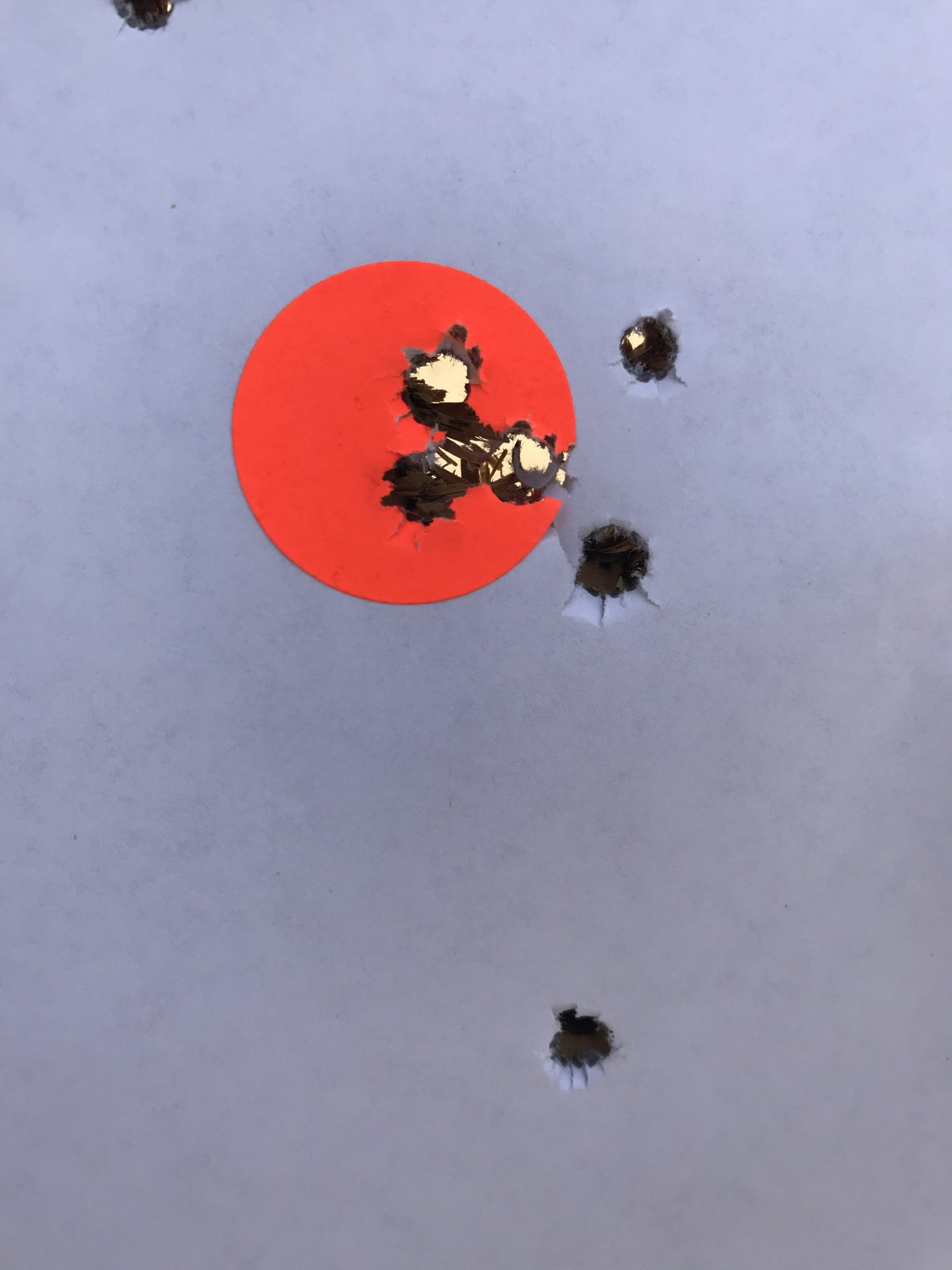

100 yards two on right is me getting it dailed in. Next 3 in the orange dot. Hornady brass, F210M primers, Hornady 140 eldm, 42 grn H4350, .017 thousands off. At 200 group was 1 1/4 inch.

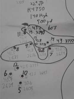

I just started a new round of load development myself. I want to make sure I'm not about to blow anything up before I go to round 2 and chase high end nodes that are not safe/sustainable or will destroy my Hornady brass.
In each case their appears to be a node just around 43gr / 2675fps where factory ammo shot so good when I first put the barrel together that is low and safe. Each bullet also has a high node that is VERY HOT and about 2775fps from a 22" barrel!!!
JP 22" XL Gas barrel. 60F. about 300 or 400 rounds down the tube. The new barrel started out shooting factory 140gr ammo 3/4 to 1 MOA average at about 2650 fps. Since broke in factory ammo is over 2700fps and well over moa on average. Primers are generally flat on all factory ammo, but no other pressure signs. Factory Federal GM 130hybrid made its primers FLAT FLAT FLAT at 2880fps. Labradar for below velocities.
Berger 140 Hybrids. 2.835" COAL - magazine length. 0.110" - 0.120" jump. H4350. Gas cut off for test, manually pulling CH. Entire pattern was 4-1/4" wide horizontal. 500 yds. 60F. Bad mirage left to Right with light wind
grains - fps - height from bottom of target
39gr 2505 chrono @ 100yds
39.5 oops shot the camera tripod down. used windage (in) for elevation (mil)...
40.0 2576 10.7
40.3 2585 8.7
40.6 2608 12.8
40.9 2629 13.7
41.2 2654 16.3 low node?
41.5 2671 16.5 low node
41.8 2676 16.9 low node
42.1 2697 13.4
42.4 2724 18.2
42.5 2735 14.3
42.8 2739 16.9 high node
43.0 2777 17 high node
43.2 2790 18.6 high node
43.5 2815 23.8 !!!! from a 22" barrel. Is this not too fast to be safe????
43.7 oops 23.8 All cases came out of the gun easy. no swipe marks. Just flat primers from about 41gr up just like factory ammo.

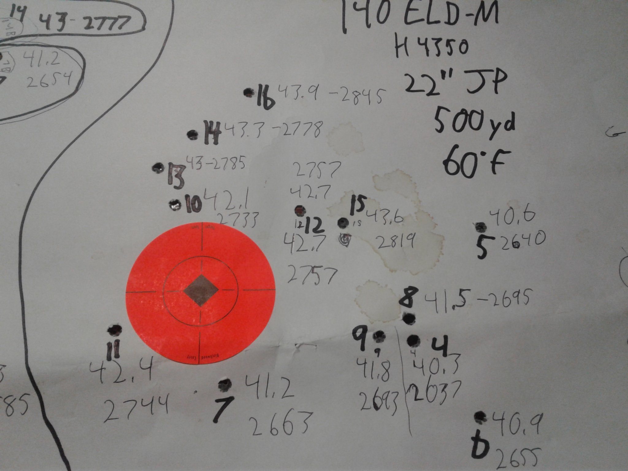

Hornady 140 ELDm 2.835" COAL - magazine length. about 0.035" - 0.040" jump. H4350. Gas cut off for test, manually pulling CH. Entire pattern was 7-3/4" wide horizontal. 500 yds. 60F. Little mirage. Changing wind. Pattern started low right and ended up high left.
39.4 2573 chrono
39.7 2585 chrono
40 2602 chrono
40.3 2637 9.4
40.6 2640 11.7
40.9 2655 8 low node?
41.2 2663 8.8 low node
41.5 2695 9.9 low node
41.8 2693 9.6 low node
42.1 2733 12.7
42.4 2744 10.1
42.7 2757 12.4 high node
43.0 2785 13.5 high node
43.3 2778 14.3 high node
43.6 2819 12.1 high node
43.9 2845 15.4 !!!!! 22" barrel.....how? All cases came out with an easy pull of the Charging Handle. no swipe marks
