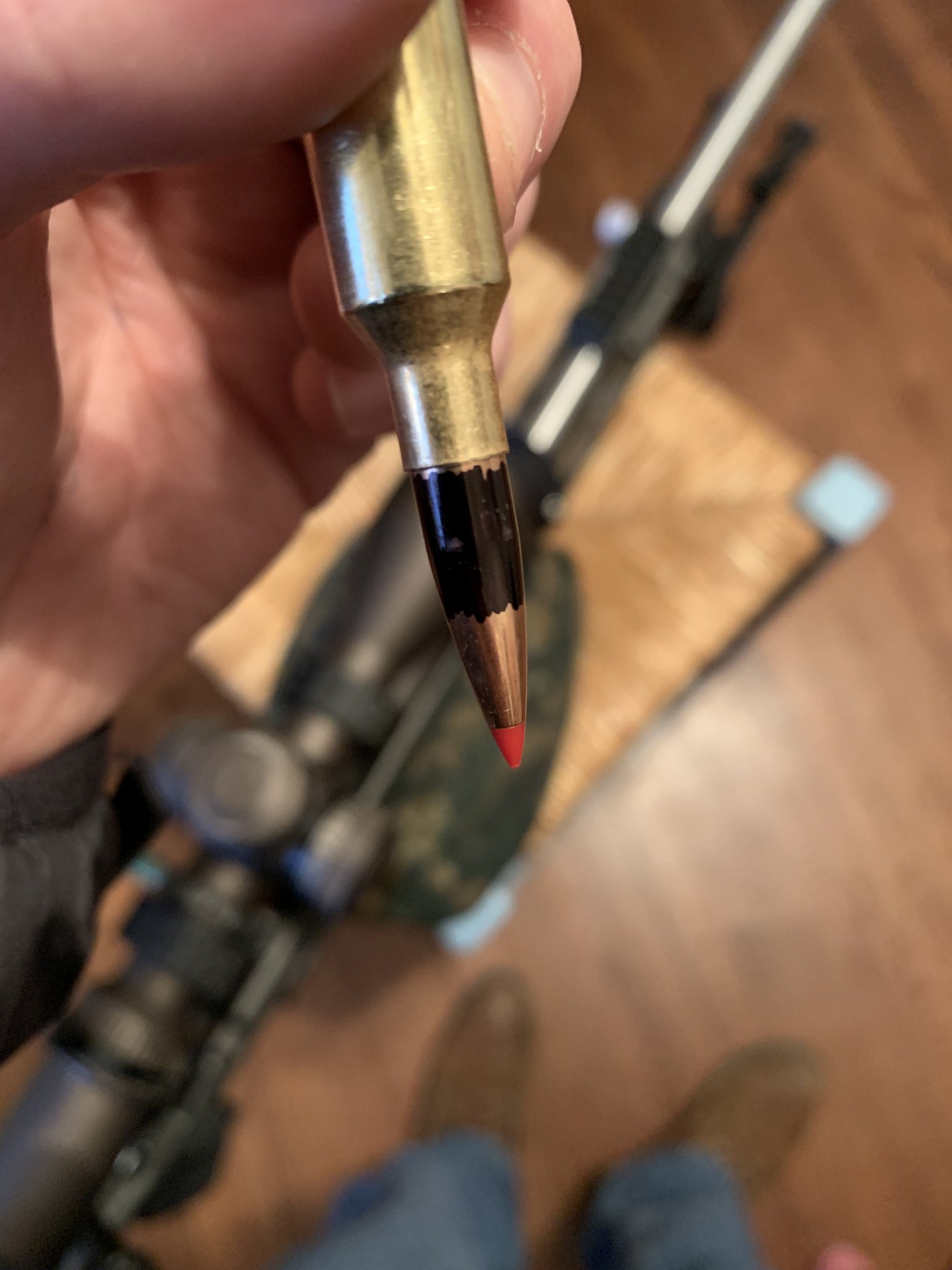

Out of curiosity I stopped and picked up some factory Hornady match ammo today with the 140 eld. The ogive measurement is 2.190”. Using the method of removing the firing pin from the bolt, there is a click as the handle engages the extraction cam. So factory ammo into the lands? Just wanted to get some opinions if there is anything I should be worried about or if this is normal. Any info is appreciated. Thanks.
