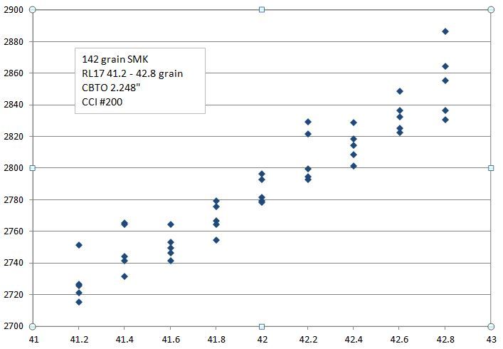

First round of load development for my AI AX 6.5 Creedmoor using 142 grain SMK and Reloader 17. No high pressure signs at 42.8 grains. The groups were all about 3/4 " (+/- 1/8" at 100 yards). I generally pay more attention to the SD and ES. So far I'm impressed with RL17, it is my first time using it. Next round will be in .1 grain increments from 42.4gr - 43.4gr, or until I see signs of high pressure.
Series1 Shots:5
Min2716 Max2752
Avg2728S-D13.7
ES 36
SeriesShotSpeed
41.212722 ft/s
41.222726 ft/s
41.232716 ft/s
41.242727 ft/s
41.252752 ft/s
Series2 Shots:5
Min2732 Max2766
Avg2750S-D14.9
ES 34
SeriesShotSpeed
41.412745 ft/s
41.422732 ft/s
41.432766 ft/s
41.442765 ft/s
41.452742 ft/s
Series3 Shots:5
Min2742 Max2765
Avg2751S-D8.6
ES 23
SeriesShotSpeed
41.612754 ft/s
41.622747 ft/s
41.632742 ft/s
41.642765 ft/s
41.652750 ft/s
Series4 Shots:5
Min2755 Max2780
Avg2768S-D9.7
ES 25
SeriesShotSpeed
41.812765 ft/s
41.822767 ft/s
41.832776 ft/s
41.842780 ft/s
41.852755 ft/s
Series5 Shots:5
Min2779 Max2797
Avg2786S-D8.1
ES 18
SeriesShotSpeed
42.012782 ft/s
42.022793 ft/s
42.032797 ft/s
42.042780 ft/s
42.052779 ft/s
Series6 Shots:5
Min2793 Max2830
Avg2808S-D16.8
ES 37
SeriesShotSpeed
42.212800 ft/s
42.222793 ft/s
42.232822 ft/s
42.242795 ft/s
42.252830 ft/s
Series7 Shots:5
Min2802 Max2829
Avg2814S-D10.2
ES 27
SeriesShotSpeed
42.412819 ft/s
42.422829 ft/s
42.432815 ft/s
42.442802 ft/s
42.452809 ft/s
Series8 Shots:5
Min2823 Max2849
Avg2833S-D10.2
ES 26
SeriesShotSpeed
42.612833 ft/s
42.622849 ft/s
42.632823 ft/s
42.642837 ft/s
42.652826 ft/s
Series9 Shots:5
Min2831 Max2887
Avg2855S-D22.4
ES 56
SeriesShotSpeed
42.812865 ft/s
42.822831 ft/s
42.832837 ft/s
42.842887 ft/s
42.852856 ft/s

I did a ladder with RL-17 and found a similar node around 41.6 grains. All groups were 0.5-0.6 moa at 100 yards, which doesn't really tell much at such a short distance.
My velocities are a bit lower than yours though.
All 10-shot groups.
Hornady 140gr ELD
Lapua brass
CCI #400
24" barrel
41 gr
Avg: 2676.8
ES: 63
SD: 17.6
41.3 gr
Avg: 2693.5
ES: 37
SD: 11.7
41.6 gr
Avg: 2710.9
ES: 13
SD: 3.8
41.9 gr
Avg: 2733.8
ES: 30
SD: 7.8
42.2 gr
Avg: 2759.1
ES: 30
SD: 10.6
I'm hoping to find a second node at around 42.5 grains and I'll be happy.
