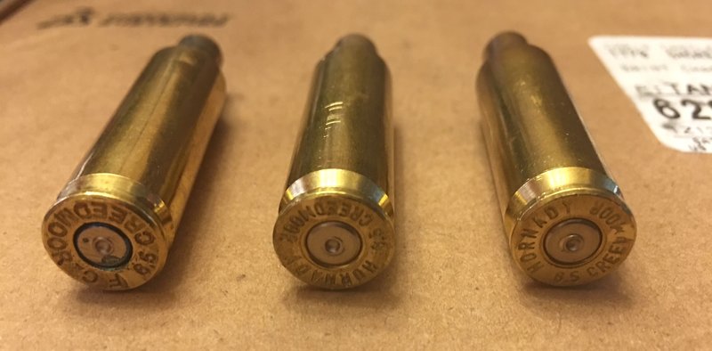

E excess Sergeant Full Member Minuteman Oct 27, 2009 880 104 50 St Louis, MO Dec 5, 2017 #1 Dec 5, 2017 #1 I've never dealt with this before - do the pressure look a bit high on these? Three different factory loads. Attachments photo81505.jpg 47.6 KB · Views: 27
W White Mamba Sergeant Full Member Minuteman Supporter Mar 28, 2011 2,875 617 51 Sonoma county, CA Dec 5, 2017 #2 Dec 5, 2017 #2 If it shoots good , I would run it
padom SuperMod Staff member Moderator Supporter Full Member Minuteman Mar 13, 2013 13,660 10,797 Southeastern, Pennsylvania Dec 5, 2017 #3 Dec 5, 2017 #3 Yes looks like some heavy swipes. JP scs heavy with agb will reduce case damage. Handloads obviously will help tuning for pressure signs. I went from a rifle length buffer and spring to a no SCS heavy which reduced case head damage/swipes big time Last edited: Dec 5, 2017
M mettee Private Banned ! Minuteman Dec 1, 2017 385 459 Dec 6, 2017 #4 Dec 6, 2017 #4 Its a larue gun correct? If you refer back to the 260 thread on arf you will see mention that larue deals with pressure in another way. All the cases in your pic look fine. The case swipes reduce with more rounds Last edited: Dec 6, 2017
