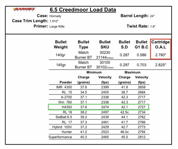

Just looked up the Barnes Data, and I’ve gotta ask, how did you do your seating depth? I typically load to mag length depths of around COL 2.830”, do seating depth tests, and usually land a little shorter, but Barnes is recommending a much shorter COL. Wondering if that’s a typo? Maybe it’s just a much shorter bullet than the ELDMs & Berger Classic Hunters? I’ll try what they recommend, but it seems mighty short. Would think that would put the bullet deeper into the neck, which would prematurely compress a load, or find pressure sooner?
Just looked up the Barnes Data, and I’ve gotta ask, how did you do your seating depth? I typically load to mag length depths of around COL 2.830”, do seating depth tests, and usually land a little shorter, but Barnes is recommending a much shorter COL. Wondering if that’s a typo? Maybe it’s just a much shorter bullet than the ELDMs & Berger Classic Hunters? I’ll try what they recommend, but it seems mighty short. Would think that would put the bullet deeper into the neck, which would prematurely compress a load, or find pressure sooner?View attachment 7650487
If you have a bullet comparator, I would start at the same length to ogive as your other loads and see how that does. Tweak from there.

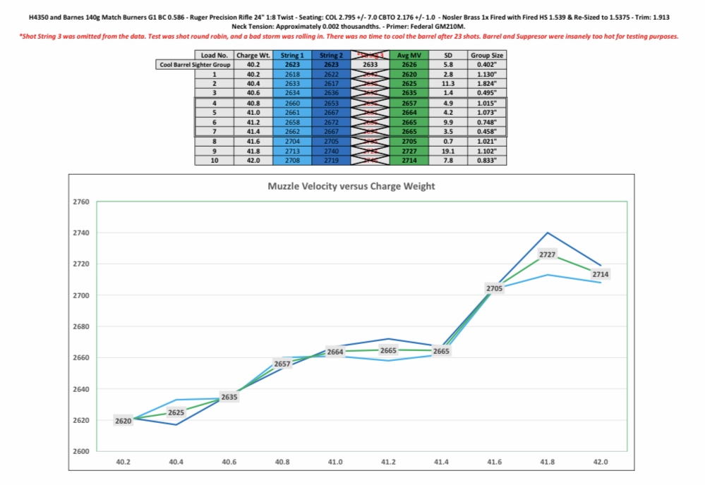

Loaded up 3 rounds each in 0.2g increments, starting at 40.2g, & ending up at 42.0g. Seated them to a CBTO depth of 2.176 +\- 1.0, which has worked well for me on another load, and that CBTO ended up measuring out to an average COL of 2.795 +\- 7.0 (the tip lengths varied a good bit), which is much closer to Barnes’ load data than I originally thought it would be. I did widen my powder search zone a little more than I typically do, bc I recently swapped to Nosler Brass, & my initial findings lead me to believe that Nosler Brass was reaching my old Hornady Brass velocities about .4gr sooner (more testing needed to confirm or debunk that). Really wanted to shoot the test this evening, but it’s not looking good for being able to make it to the range. Will post my results whenever I get the test done.

Well. I managed to squeak in some hurried range time Sun evening. Had a myriad of issues, but it wasn’t a total washout. I shot a 3 shot sighter group, then shot round robin for the remainder of the test. I was pushed for time trying to get the test in before dark, and to make matters worse, black clouds & wind rolled in after string one, so I didn’t have a chance to let my barrel cool AT ALL between string 2 and string 3. I KNOW... terrible idea, but I was hoping to at least get velocity data. The barrel & suppresser got so hot on string 3, that I deemed it essentially worthless, so I did omit that string from my findings. I also had my suppresser loosen up on the first two shots of string 2. Geez, what a disaster!!! For what it’s worth tho, the groups weren’t horrible, aside from the suppresser getting loose, and the muzzle velocity data was actually really consistent across string 1 & string 2, so I think I have an idea of where I want to focus in on the next time I can test. I think I’ll narrow in on 40.8 to 41.4, and take my time there trying to control the tempo/barrel temp a little better. The surprise of the day was my 3 shot sighter group at the beginning charge weight 40.2g to kick things off. It shot a .402” group with a MV of 2626 & SD of 5.7. The muzzle velocity & SD held up when I shot it again on the round robin, but the suppresser fiasco hosed the group. Anyhow, I said I’d post my results, so here they are, the good, bad, & the ugly. 😆

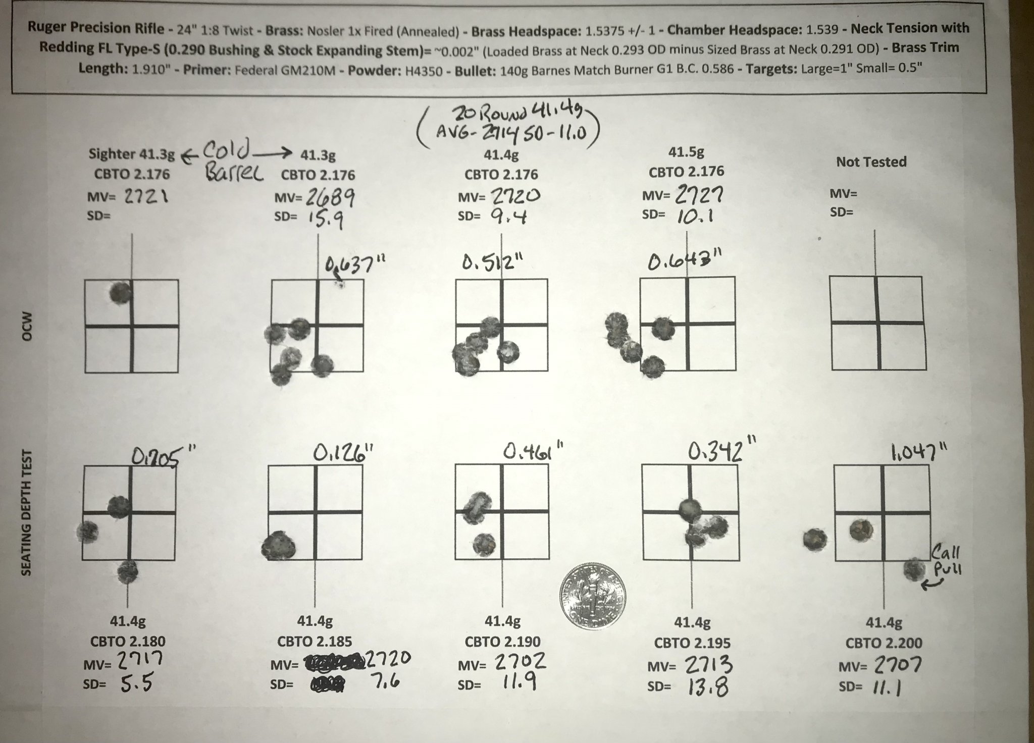

Update: Finally got around to revisiting the 140g Match Burners. Took a closer look in the 41.3 to 41.5 area. Loaded up one sighter at 41.3g, five at 41.3g, five at 41.4g, and five at 41.5g (all at CBTO 2.176). Then, I loaded three rounds each of the 41.4g load increasing 5thou in CBTO with each 3 round string until I reached essentially what I deem to be Max Mag Length for me at 2.825” COL or CBTO 2.200.
My results today were much more promising this go around. I had a little more time today (not a whole lot) and was able to better control my barrel temp, & pace. Plus, some days I just plain shoot better than others, & today was a good day. The pleasant surprise was in the Seating Depth check. Shot the first bug hole group I’ve gotten in awhile now… 0.126” group!!!! Wooohoo! I’m guessing my throat had eroded on me bc 2.176” CBTO used to do great, but it took pushing the round out another 10thou longer to get back on track.
Consensus: These bullets will do just fine. All three of the 5-Shot groups I tested today came in right around the 1/2” mark at 100yds. The MV was where my rifle seems to like em, and although the SDs weren’t impressive, they will do. Of the 20 rounds composite total I shot today at 41.4g, the AVG MV=2714 & SD=11.0.
Below is the target pic from today. It’s small and a little busy bc I somehow managed to cram it all onto one sheet of 8.5x11 printer paper in Excell. 😆 Targets are 1”x1” with the little squares measuring 0.5”x0.5”.

Update: Finally got around to revisiting the 140g Match Burners. Took a closer look in the 41.3 to 41.5 area. Loaded up one sighter at 41.3g, five at 41.4g, and five at 41.5g (all at CBTO 2.176). Then, I loaded three rounds each of the 41.4g load increasing 5thou in CBTO with each 3 round string until I reached essentially what I deem to be Max Mag Length for me at 2.825” COL or CBTO 2.200.
